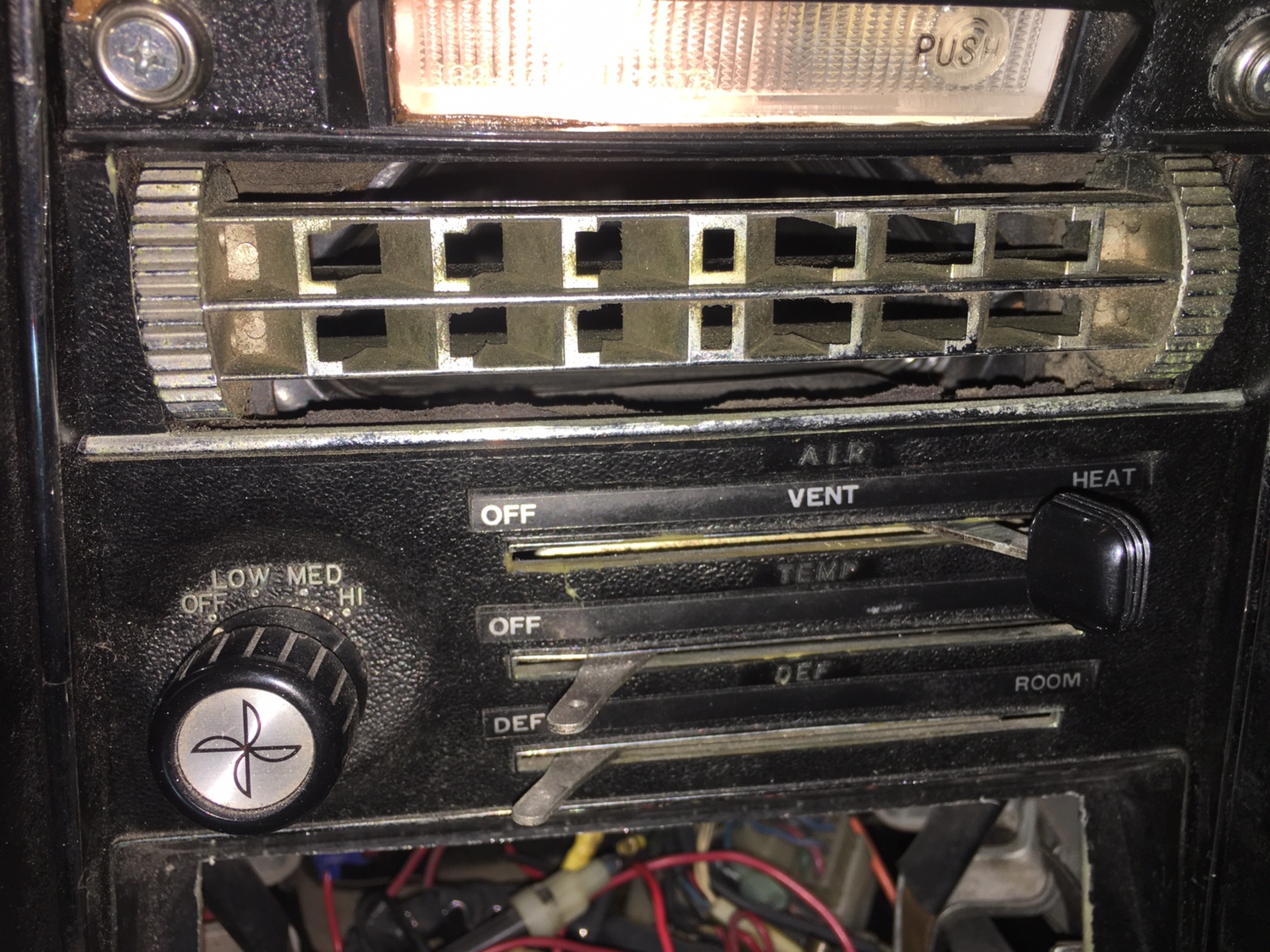

Top lever pushed to the right (heat) and won't move back left. Unsuccessfully tried removing that panel. Anyone encountered this or could provide a solution? Many Thanks!

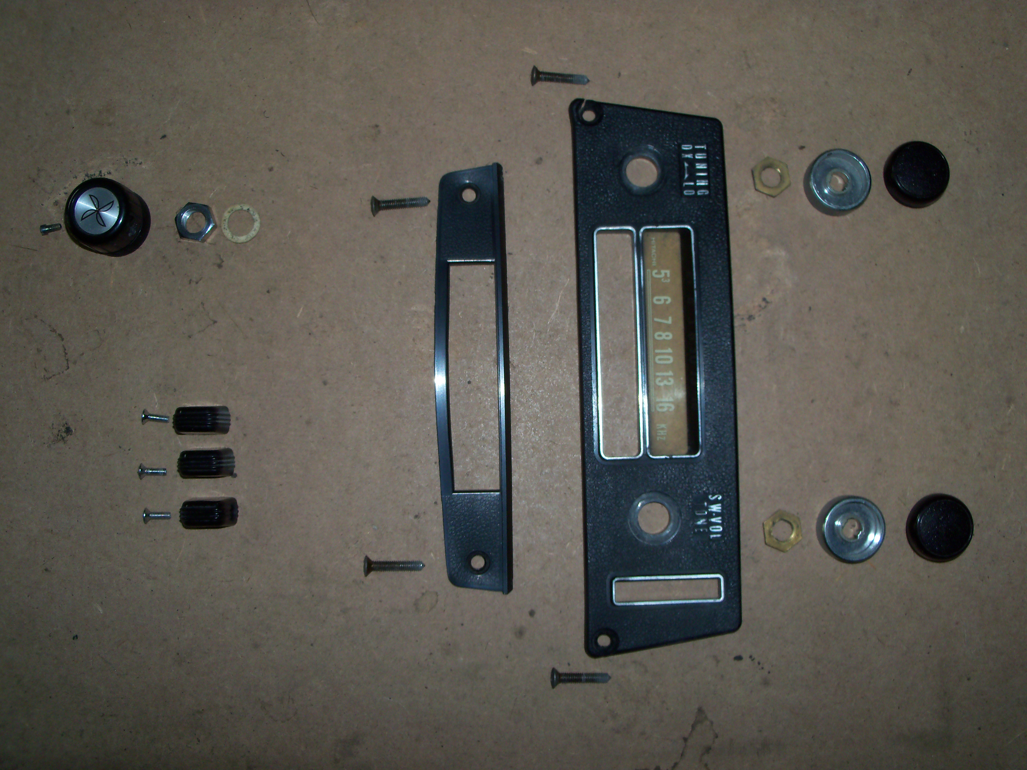

Remove the radio control knobs and fastener nuts, then remove the radio faceplate.
Remove the knobs from the heat/vent control levers.
Remove the Blower fan speed control knob and the retaining nut behind it.
Remove the Map light faceplate and then lever the map light housing out of the heater fascia plate.  If possible, pop the wiring connectors free and remove the map light altogether.

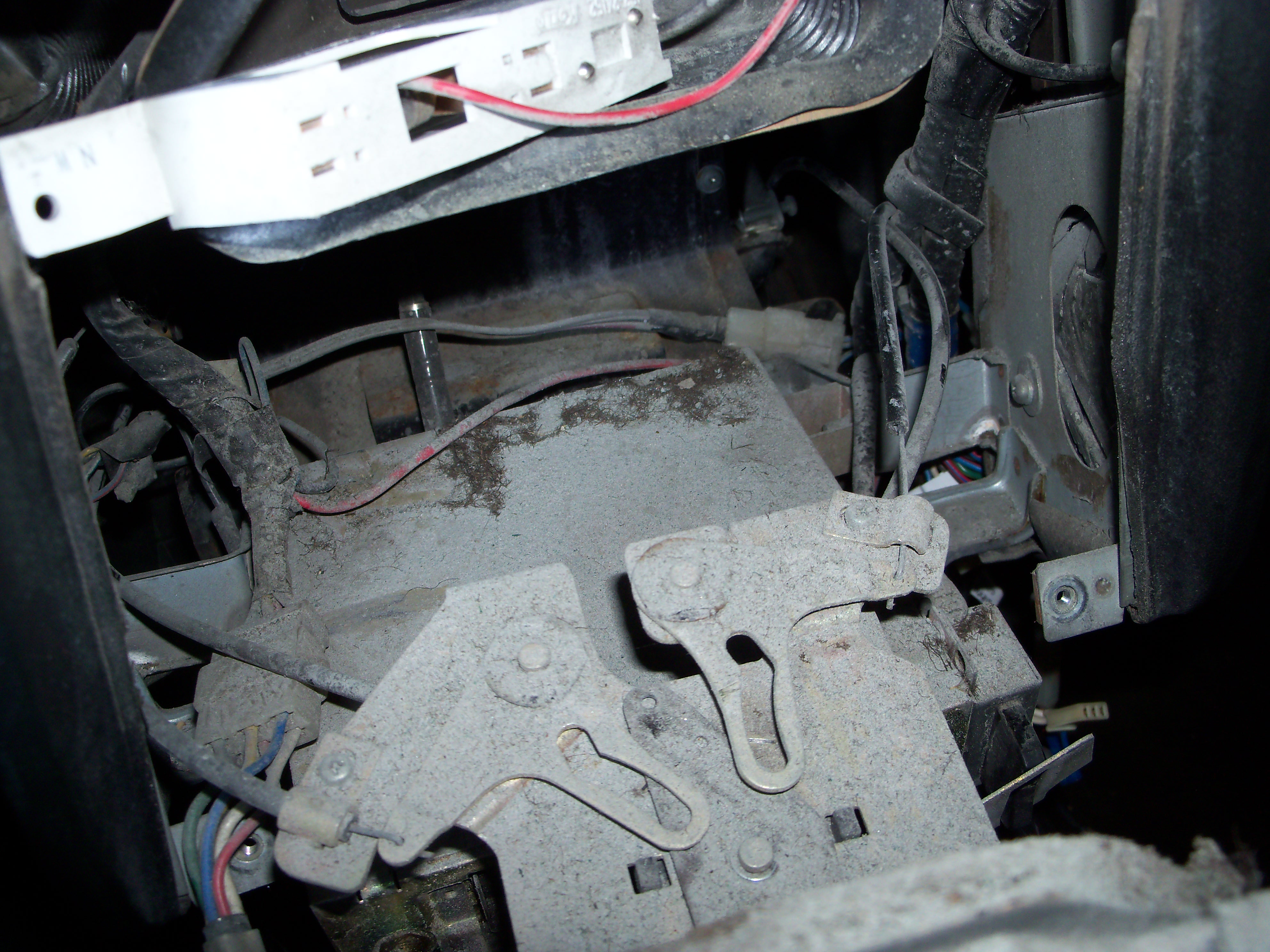

At this point, you should have an assemblage of parts that looks like this (these are from a Series 1 car, so your parts may look a bit different)...

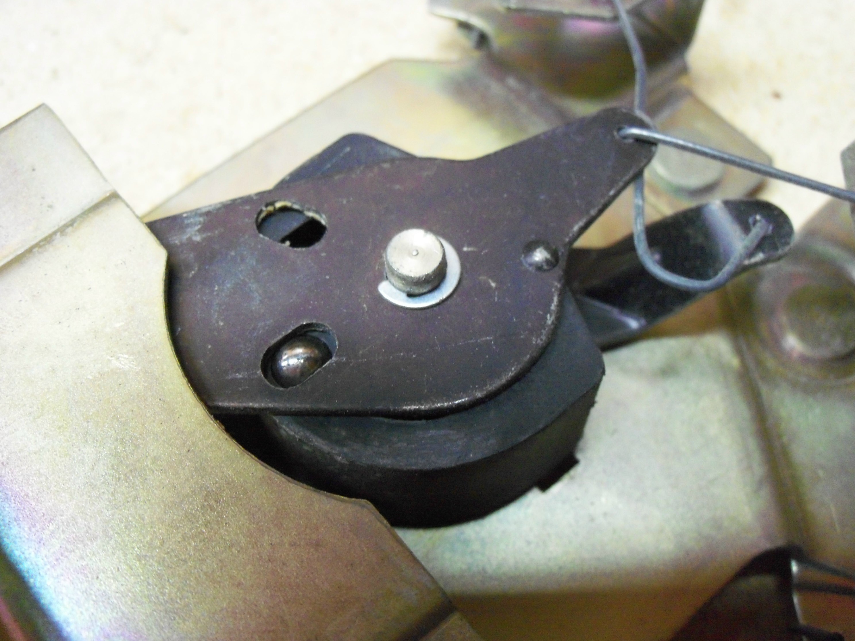

Experienced Z owners will see that my control lever assembly had experienced not just a bent cable (not visible in the photo above) also a mechanical failure of the topmost linkage (a guide pin had snapped out of the lever frame, allowing the top upper lever plates to separate.

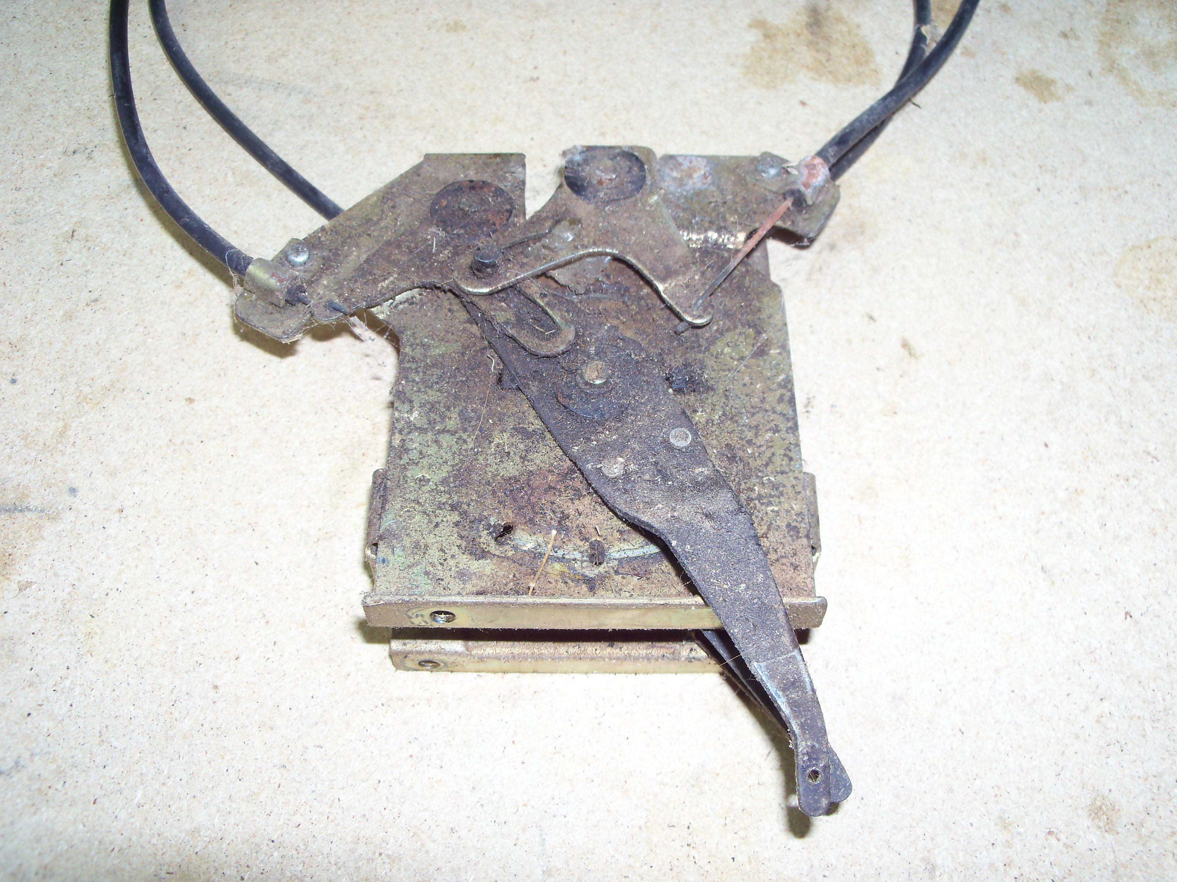

An intact lever assy looks like this (note how the slots in the two top link plates both fit over a common 'peg')...
Here's what a bent control cable looks like this.  On my car, it was the bottom lever and cable (goes to the heat control valve) that had problems.  The cable was bent into a full J-hook shape.  In the photo, the lever asy has been turned upside down, so you're looking at the bottom...

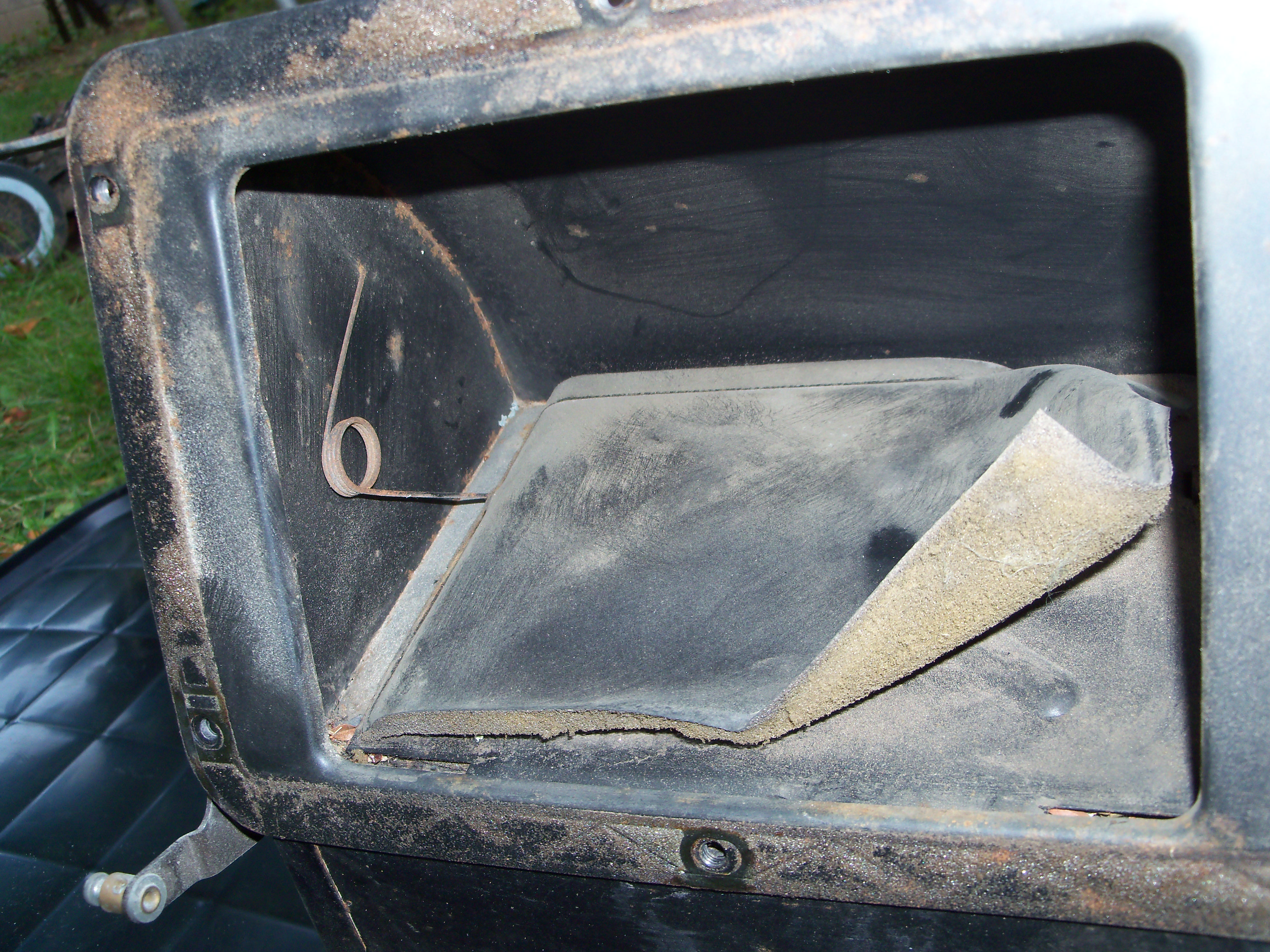

Make sure you find out why your control cable bent and fix that problem too.  Otherwise, your new cable will probably bend just like the old one did.  Unfortunately, the top control lever operates two inner air control flaps that are buried inside the Heater assy.   It's not likely that they've jammed just because the pivot points got a bit rusty.  Instead, it seems more probable that the one of the padded vinyl covers used on the internal control flaps has come unglued from the metal flap plate (common problem) and is preventing the flap from closing fully...
To the driver (or passenger), this would have felt like the control lever wasn't moving all the way to the right or left in its slot, so they would have started tugging on it to try to get the lever to go to the full 'OFF' or (more likely) 'HEAT position'.  If I'm right (and I hope for your sake that I'm not) you're going to have to drain the engine cooling system, disconnect the heater hoses, pull the Heater assy out of the car, and then pretty much fully disassemble it.  Big job. :ermm:
