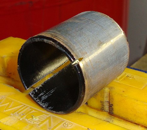

Another and possibly easier way to remove front control arm bushings is to drill or burn out the rubber bushing material and center barrel.  Then to remove the the bushing shell is to take a reciprocating saw aka sawzall, put the blade in the shell and saw outward a little at a time.  Have to be careful as you can start going through the control arm once you go through the shell.  Once you have cut through shell it will have room to collapse on it self and will either fall out or can be tapped out.
Rubber bushing removed and shell cleaned up.  I didn't know at the time I needed to remove the shell to install the new poly bushings
Bushing shell removed.  You can see the line I cut in it.  This one literally fell out once I got done cutting.
