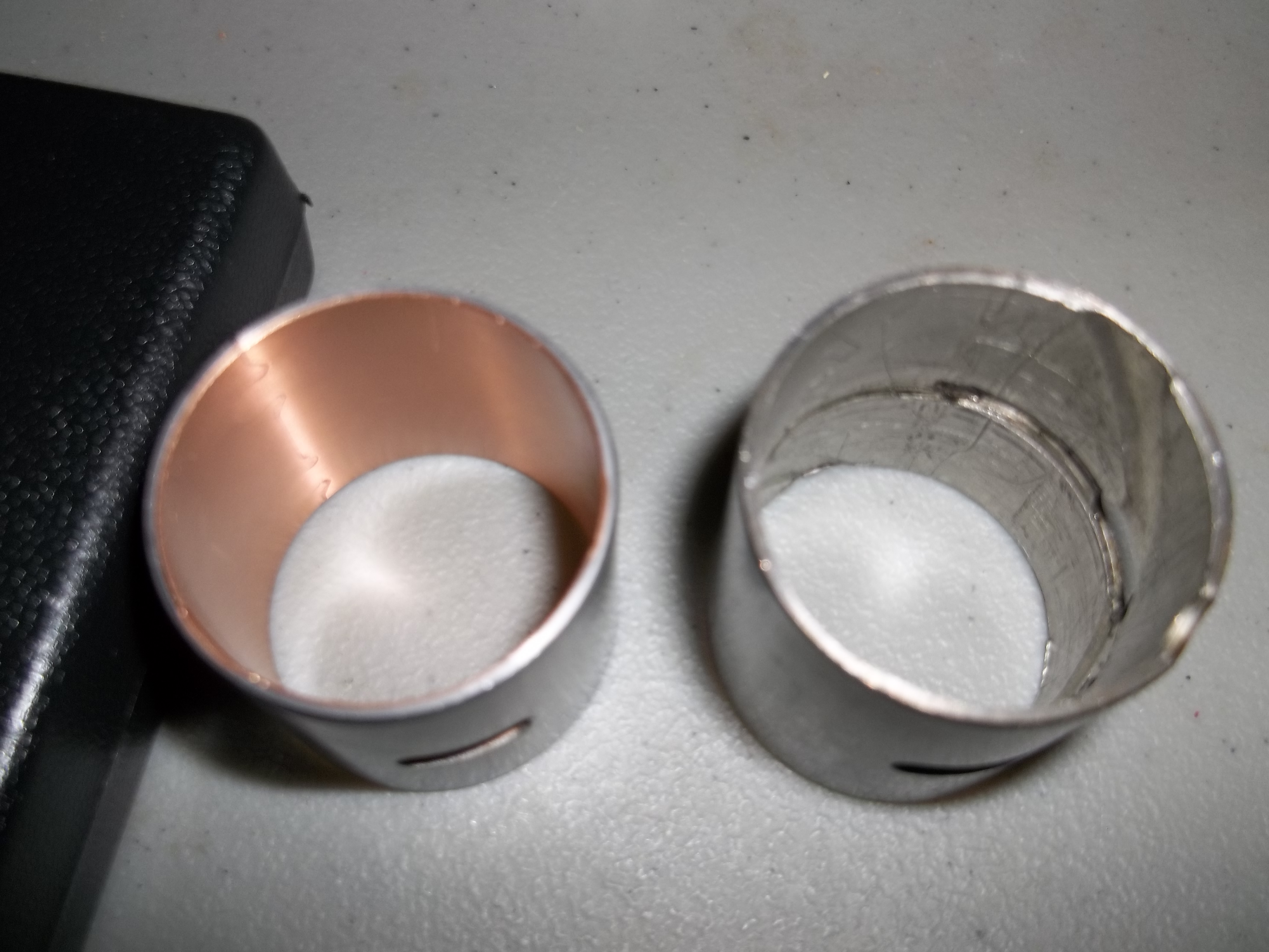

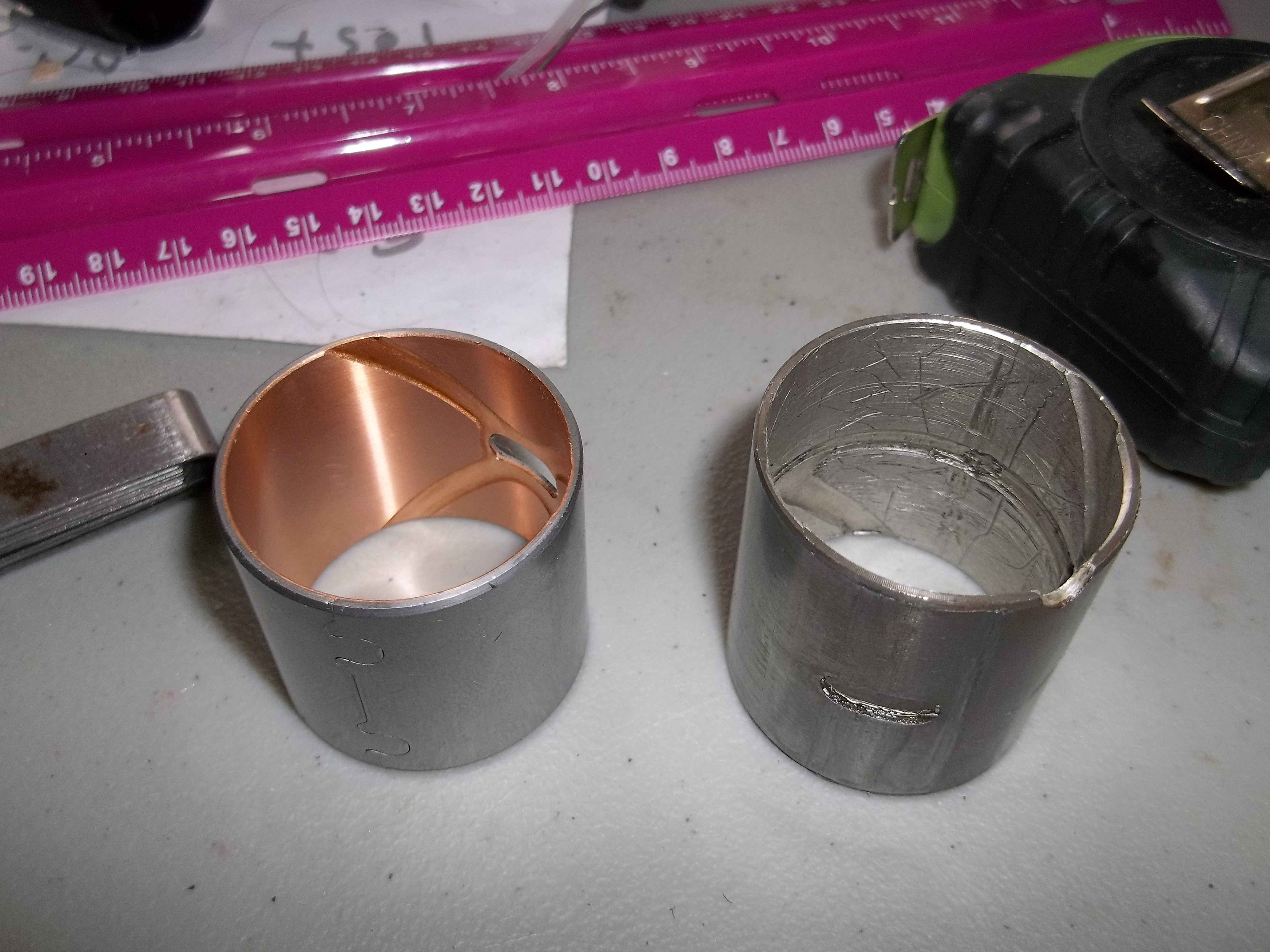

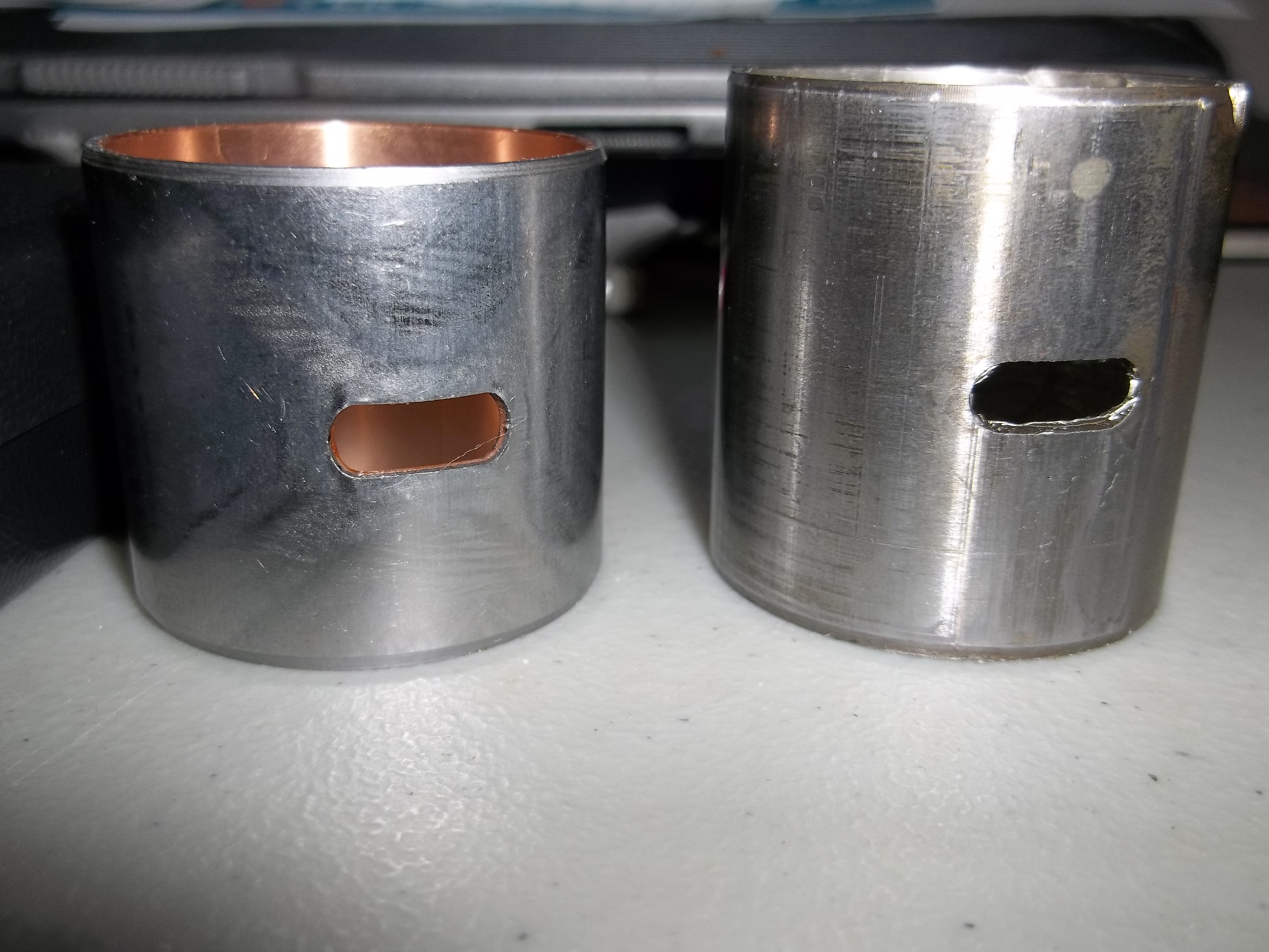

got the omega machines bush for the tail shaft. Seems like a lot better build quality, and the same length as what was in there (40mm vs the 35 for the cheapo one). the old one looked horrible. I don't know if it was due to the oil gutter that was knocked off when I got it, perhaps it had been run with out it for some time, so very little gear lube would make it to the bushing. More good news, I was able to find a new OD gear bush that will not need to be modified (I still have the over size one, just in case the one that comes in is not right). Its being shipped from overseas so may take a while. Got some new needle bears too since the bush is new.

That is the same bush I installed in mine. It took all the up and down movement out of the propeller shaft/drive shaft. I had a couple for an Opal Omega transmission, right size for the yoke, but too big for the extension housing hole. The omega worked well.
When you install it, leave it in the freezer overnight and warm the rear extension with a hot air gun until it's hot to touch. The bush will tap in easily.

that is close to what I did, use a 100watt light bulb set on directly on the housing for a couple hours, then freezer followed up with some dust off from an inverted can. As you say, it tapped right in with a plastic hammer. I followed it up with an oversized socket to make sure it was flush with the alum housing, only light taps needed to set it perfectly flush. I was careful to align the oil hole with the oil trough.
