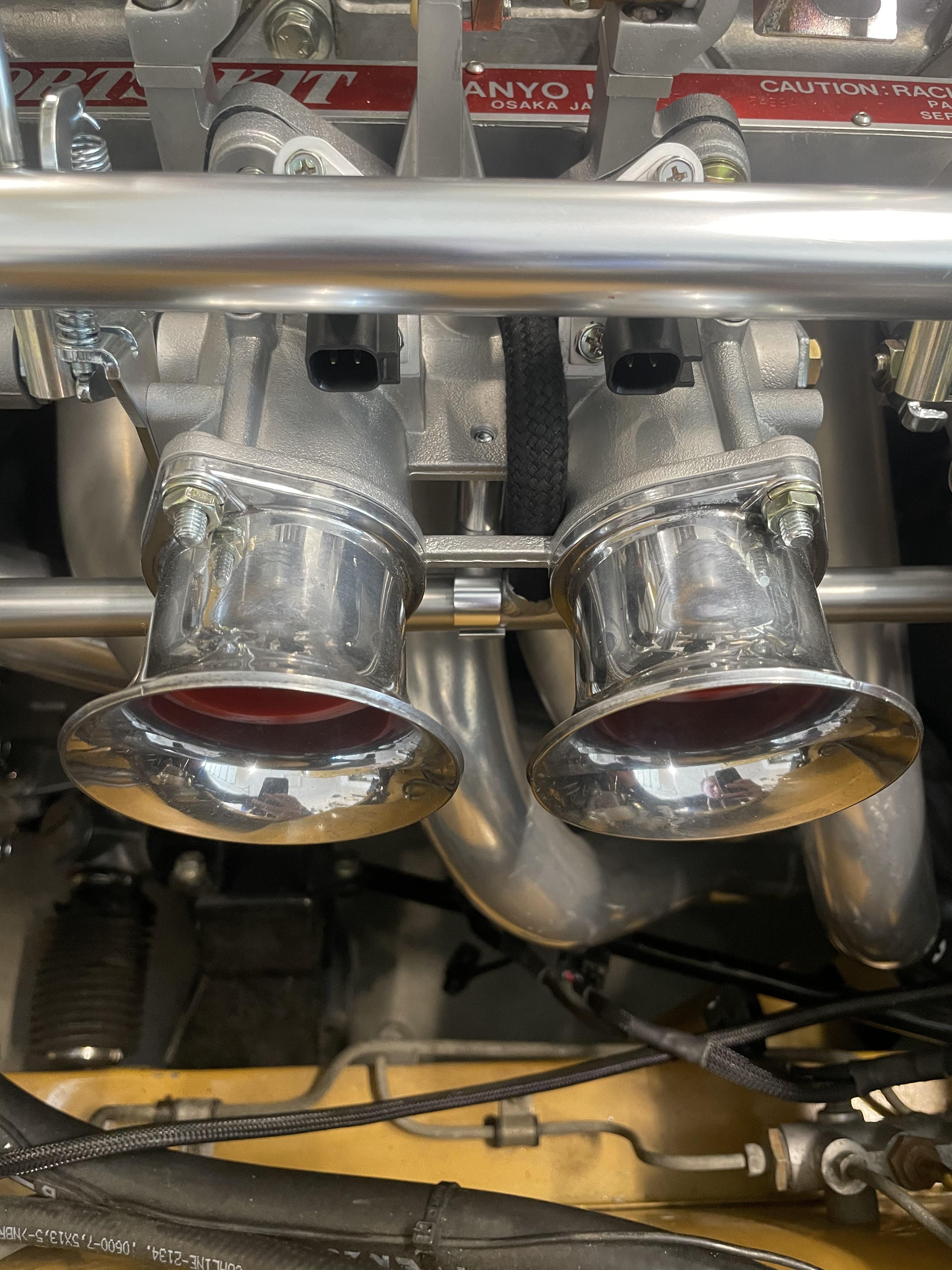

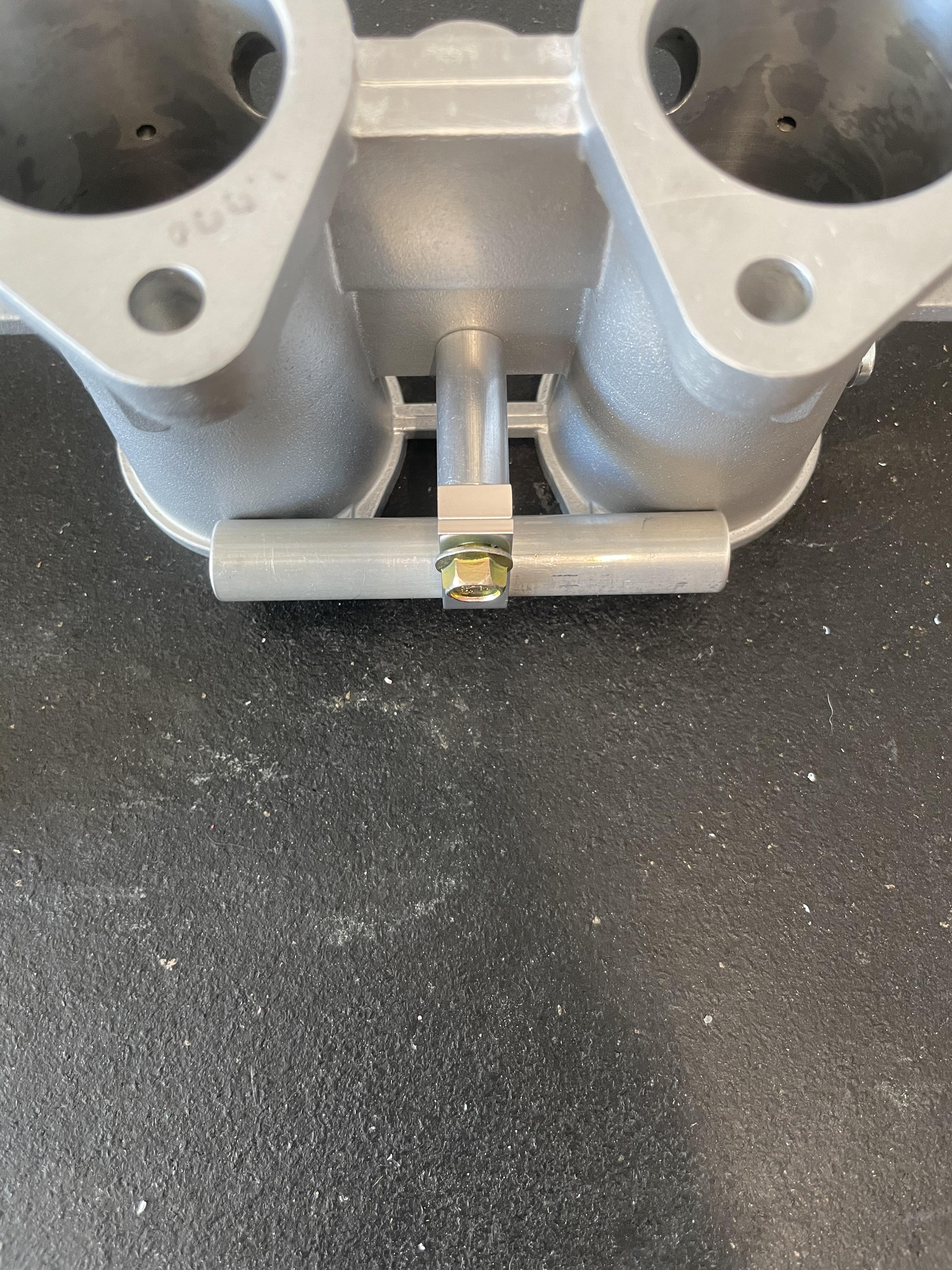

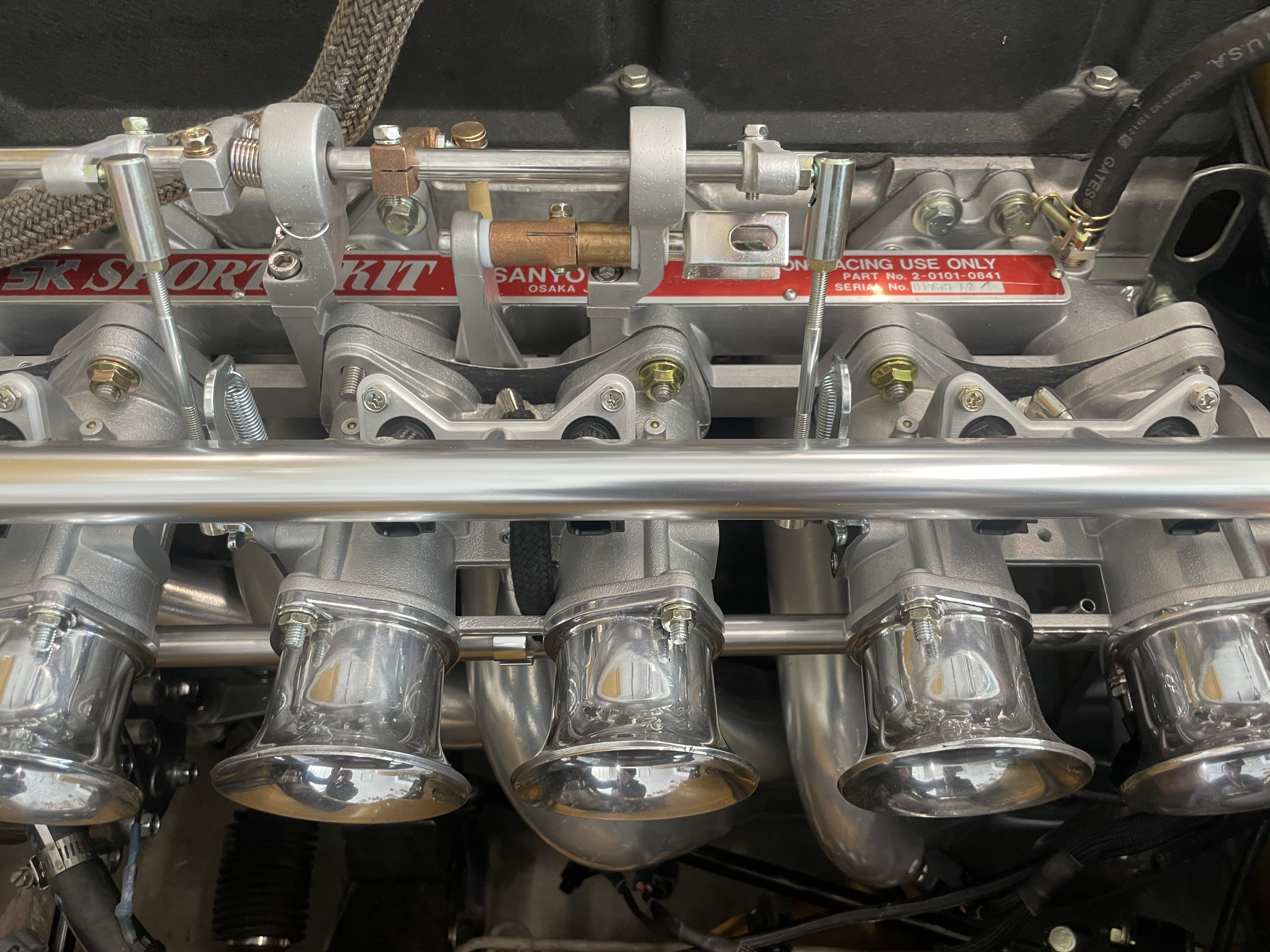

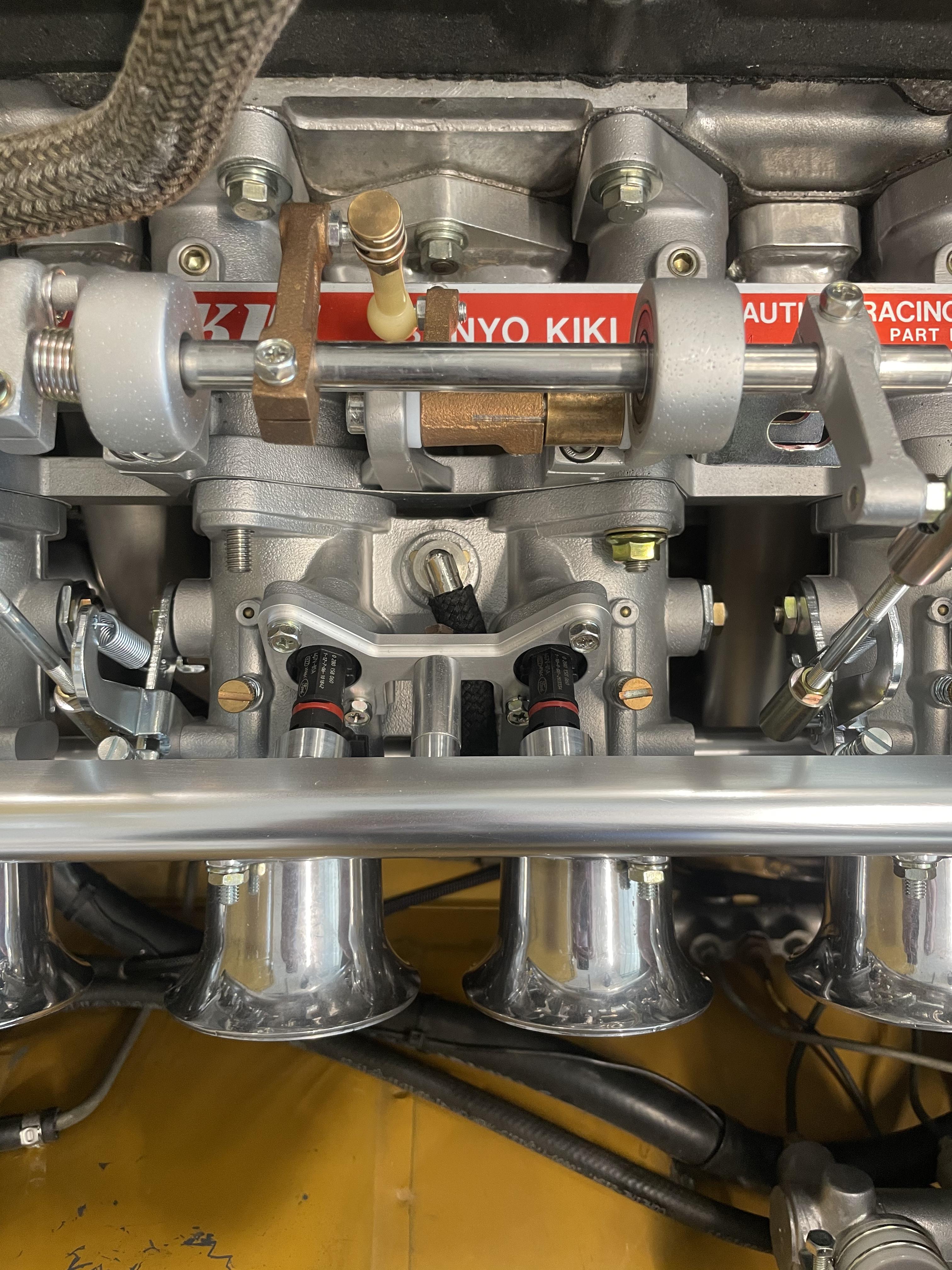

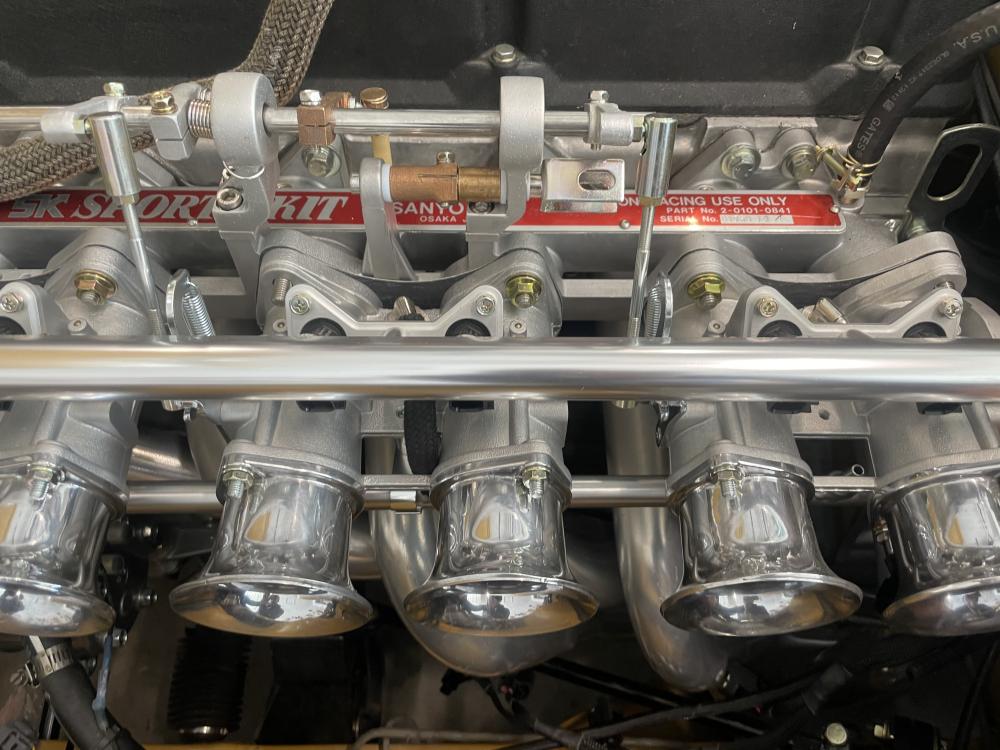

May 2, 20214 yr Author comment_620958 I think this ITB vacuum balance bar will work and look good. It’s far enough way from the header in this spot as well. Link to comment https://www.classiczcars.com/forums/topic/58568-duffys-171-series-1-240z-build/?&page=59#findComment-620958 Share on other sites More sharing options...

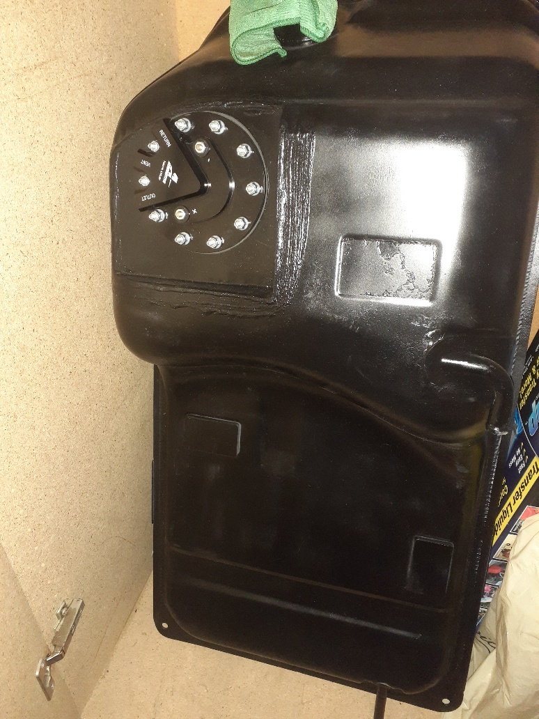

May 6, 20213 yr Author comment_621161 Gas tank looks great!  I got the non terminated harness, I did all terminations and looming myself. So the lengths are all specific to my install. On my last build (classic bronco) I didn't do that, and I would have to coil up extra wiring and I was never happy with it.  Link to comment https://www.classiczcars.com/forums/topic/58568-duffys-171-series-1-240z-build/?&page=59#findComment-621161 Share on other sites More sharing options...
