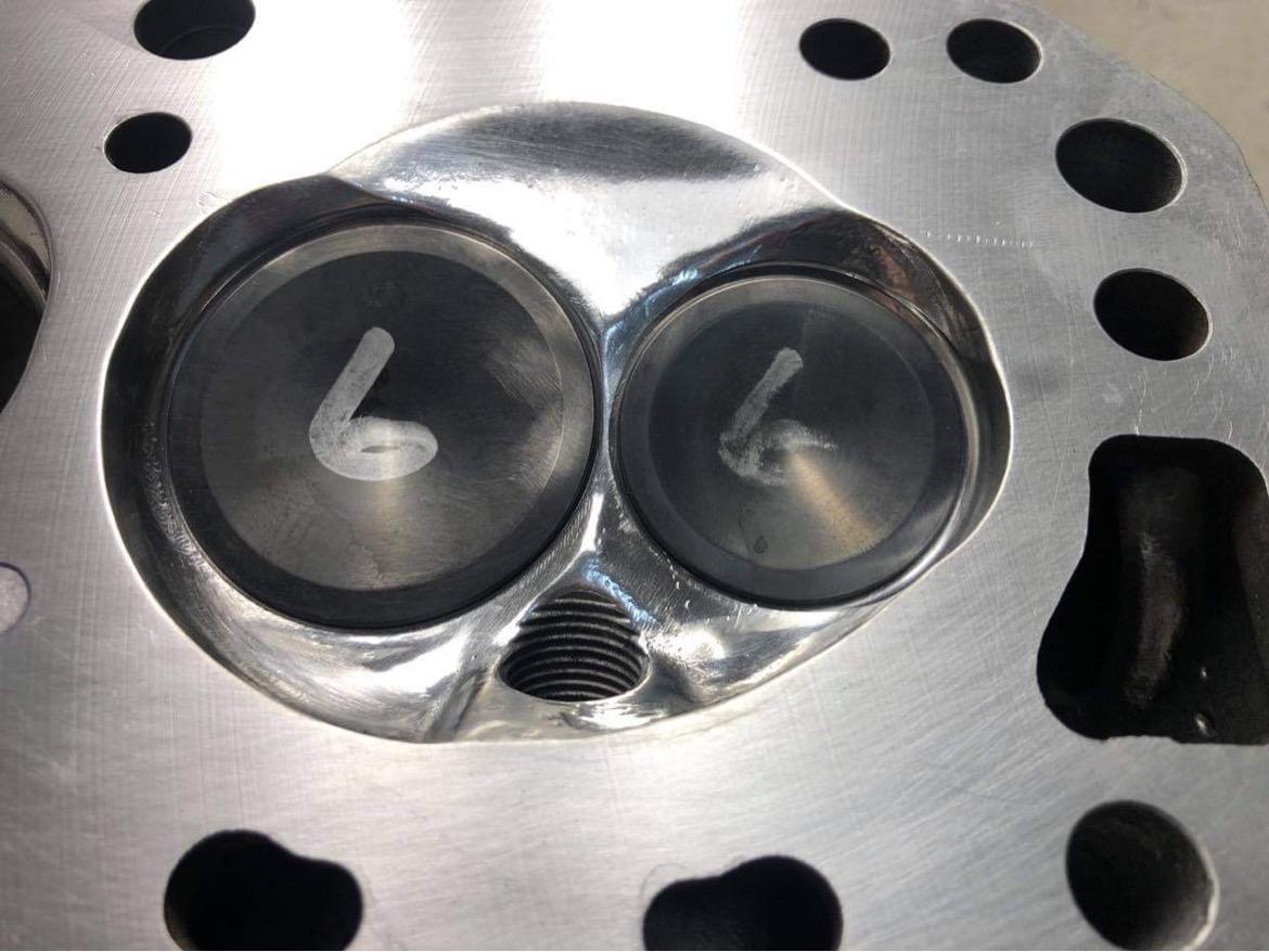

October 24, 20204 yr Author comment_608875 I turned the psi down a little and it’s a way better finish Link to comment https://www.classiczcars.com/forums/topic/58568-duffys-171-series-1-240z-build/?&page=55#findComment-608875 Share on other sites More sharing options...

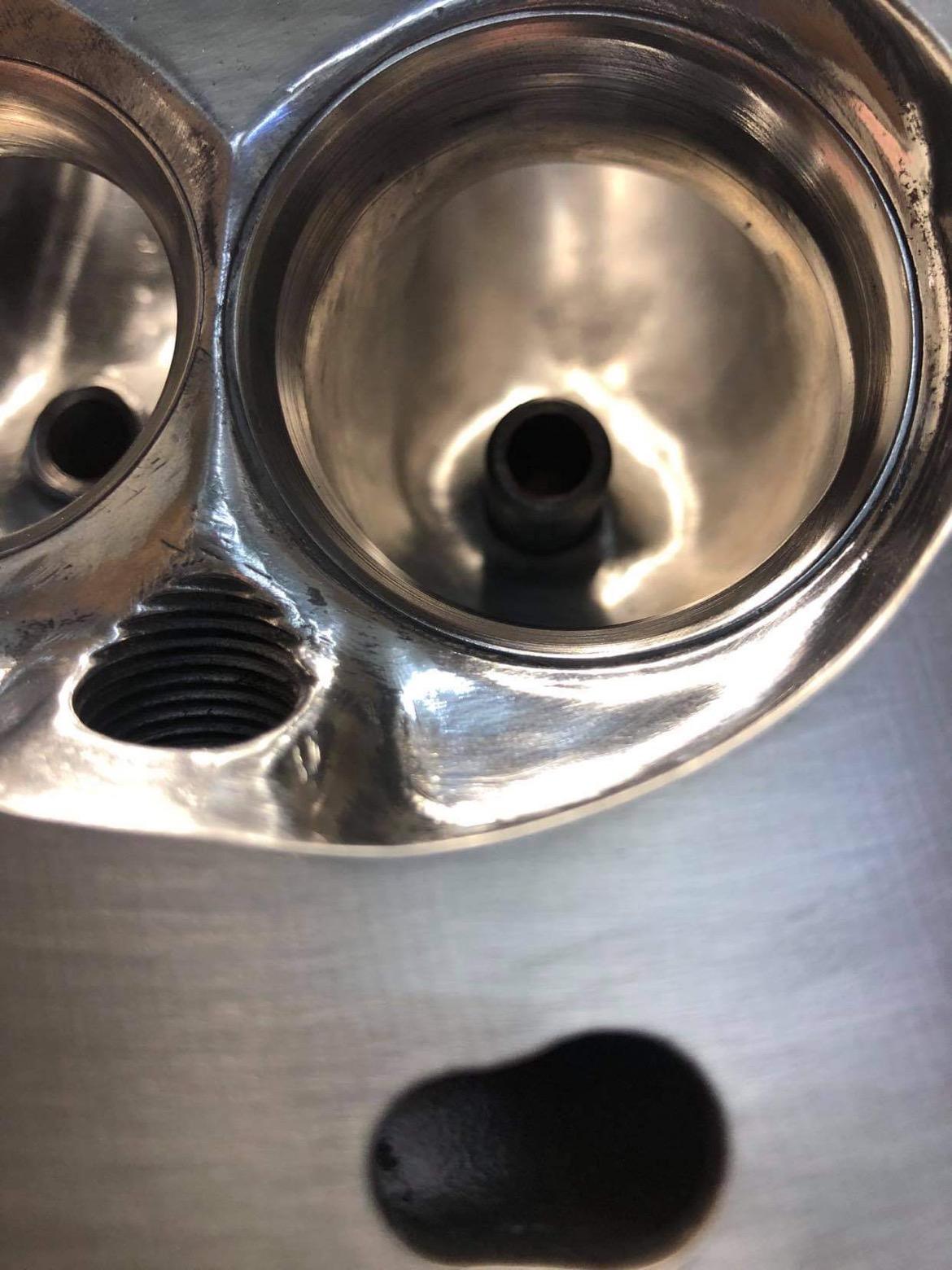

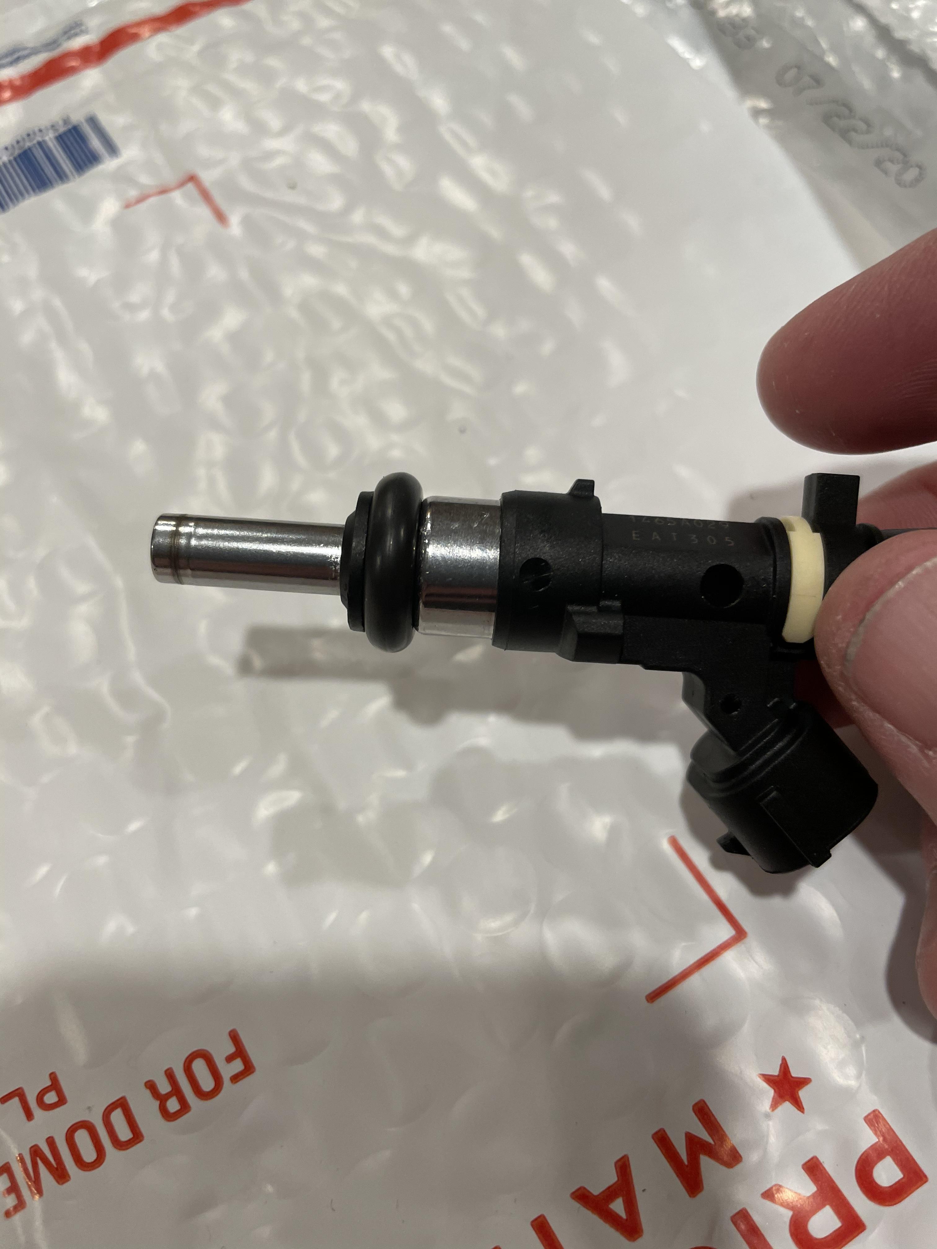

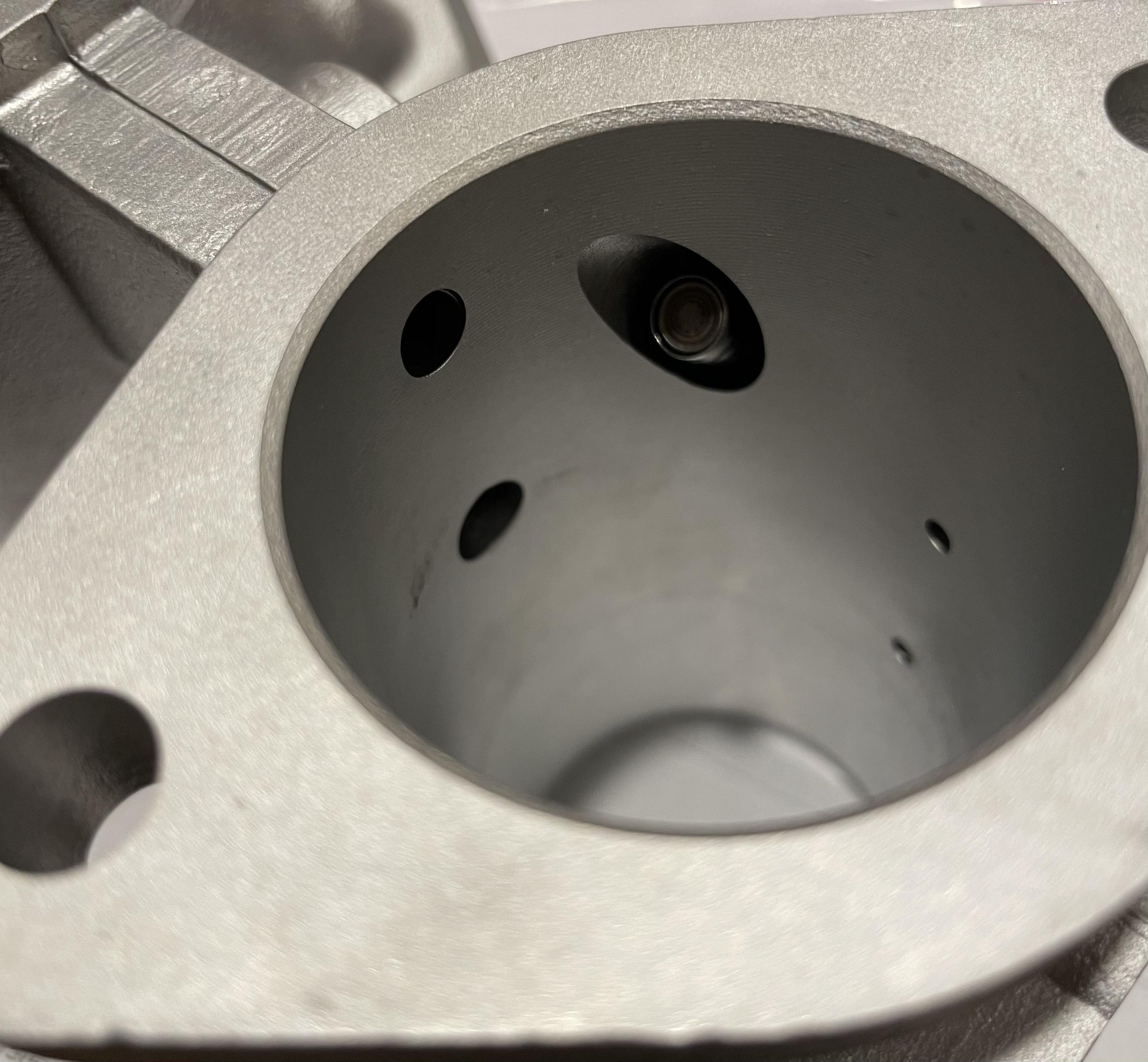

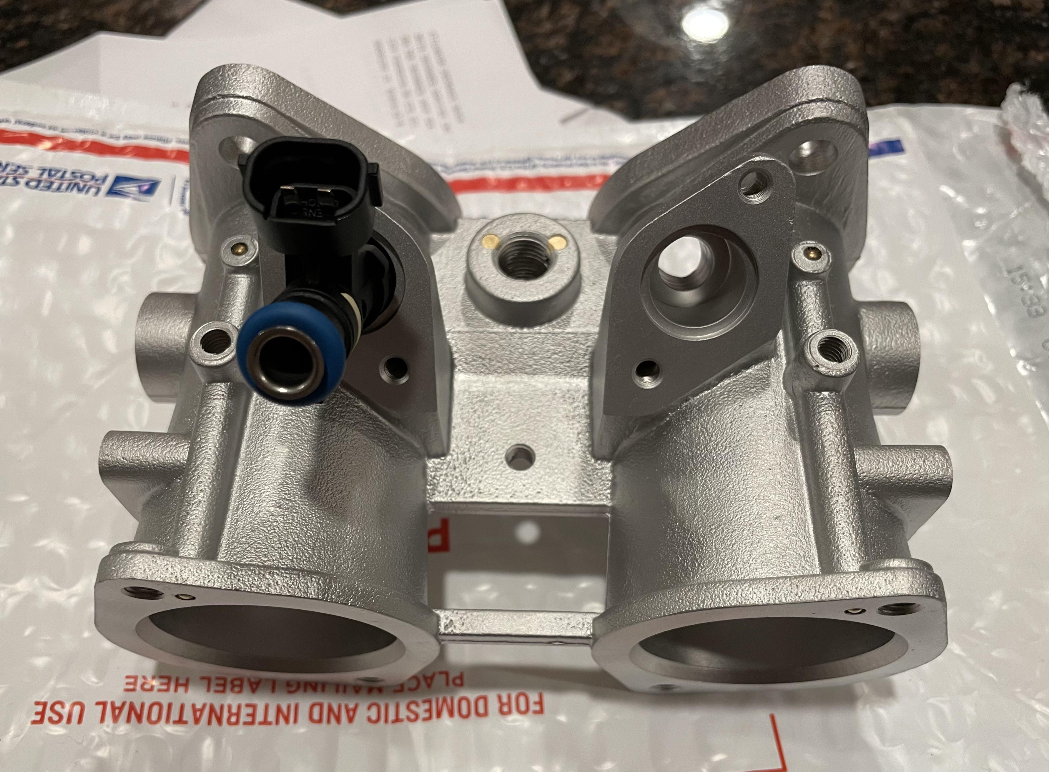

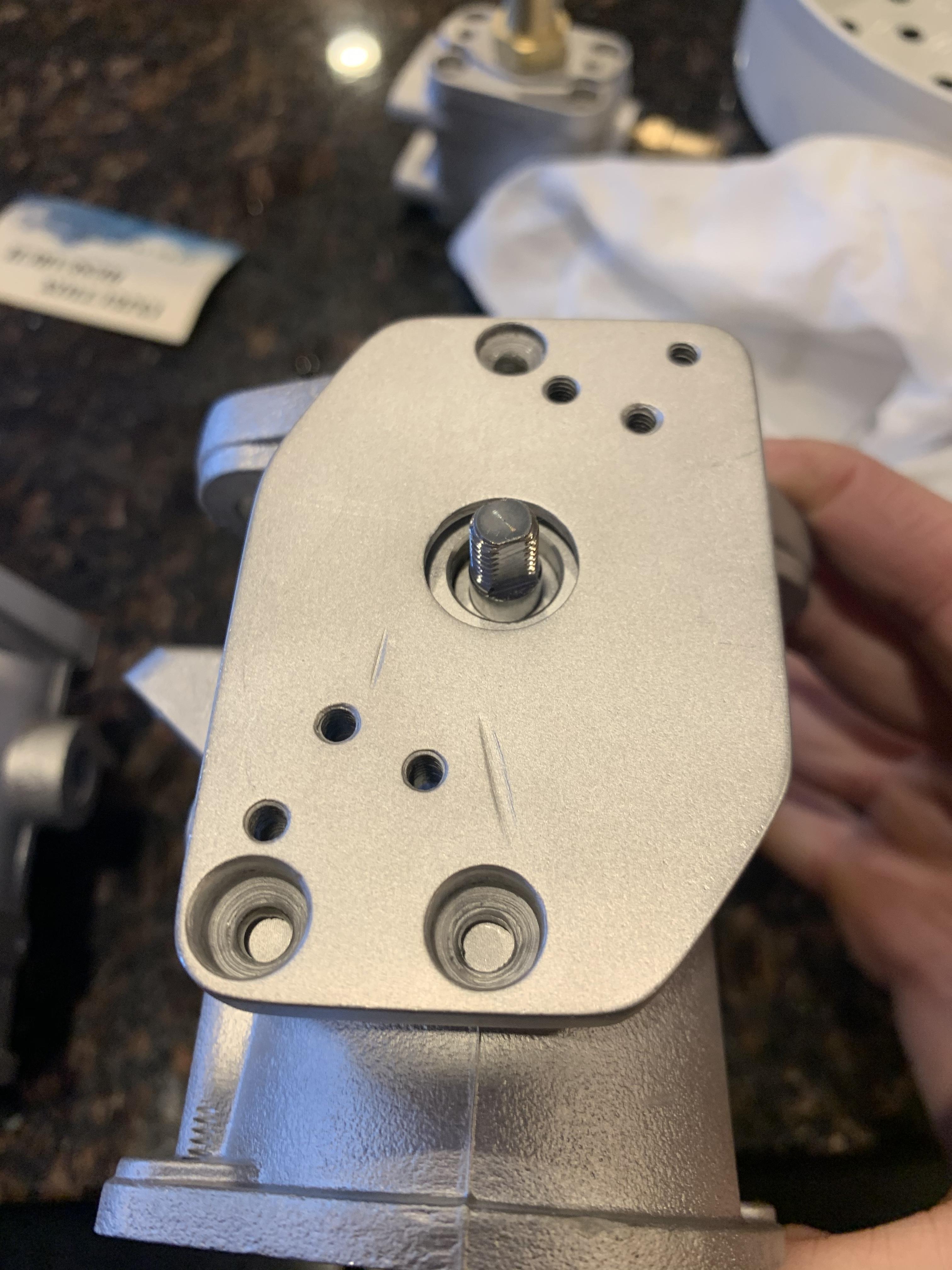

November 6, 20204 yr Author comment_609698 Vintage Sk throttle body update. I think I found a injector style I like and a oring I like. The injector has a long nozzle and 8 tiny spray holes. The O-ring is some  Porsche 16.5mm one meant to adapt newer style injectors, but fits perfectly. Almost too tight, but firmly presses in.  Shouldn’t leak air at all and remain snug. I also picked a fuel rail for my vintage ITB. It’s the stock that Tsumori uses in Japan. I couldn’t find anything I loved. I will be doing clear anodized on the fuel rail parts. Link to comment https://www.classiczcars.com/forums/topic/58568-duffys-171-series-1-240z-build/?&page=55#findComment-609698 Share on other sites More sharing options...

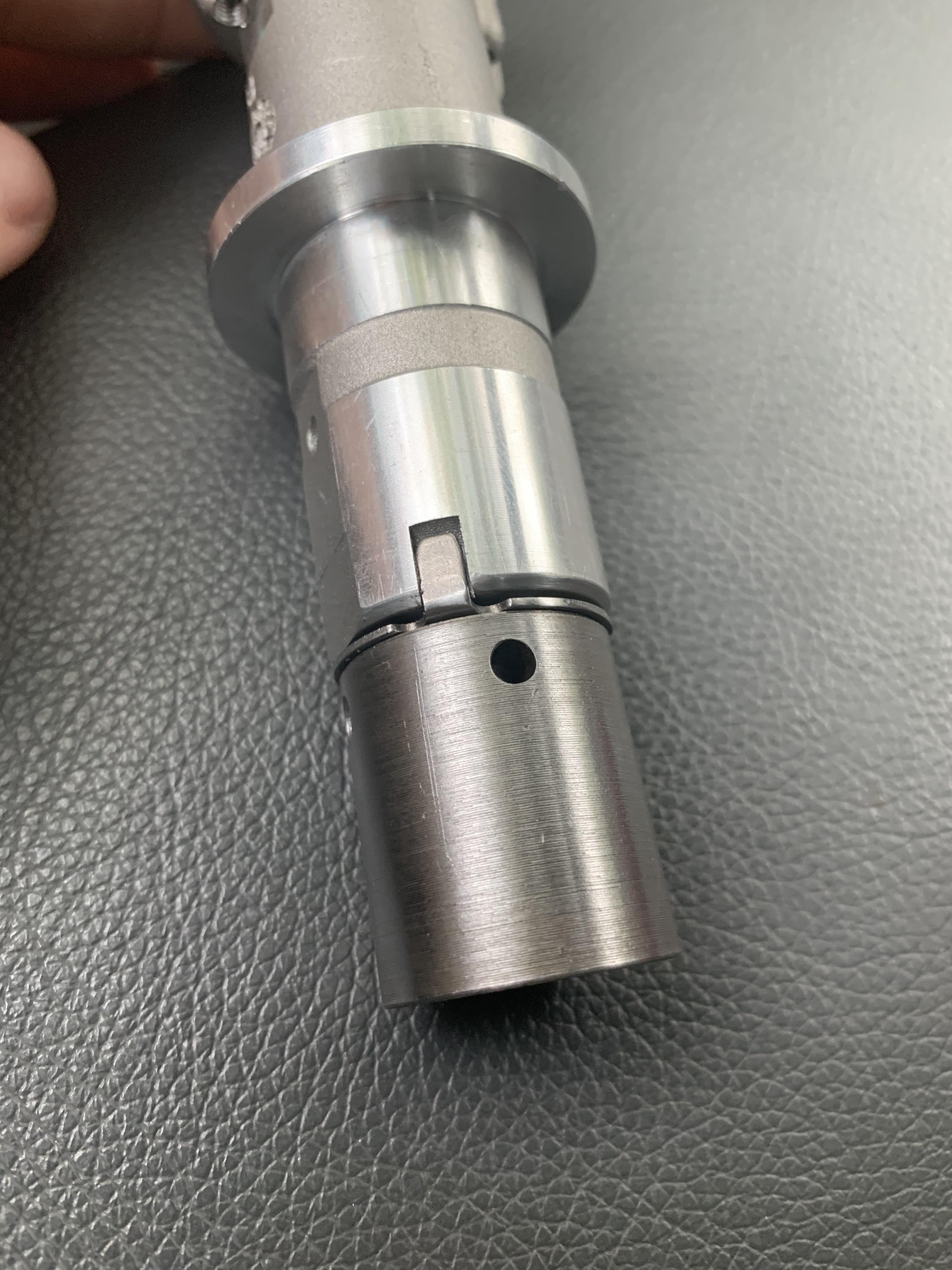

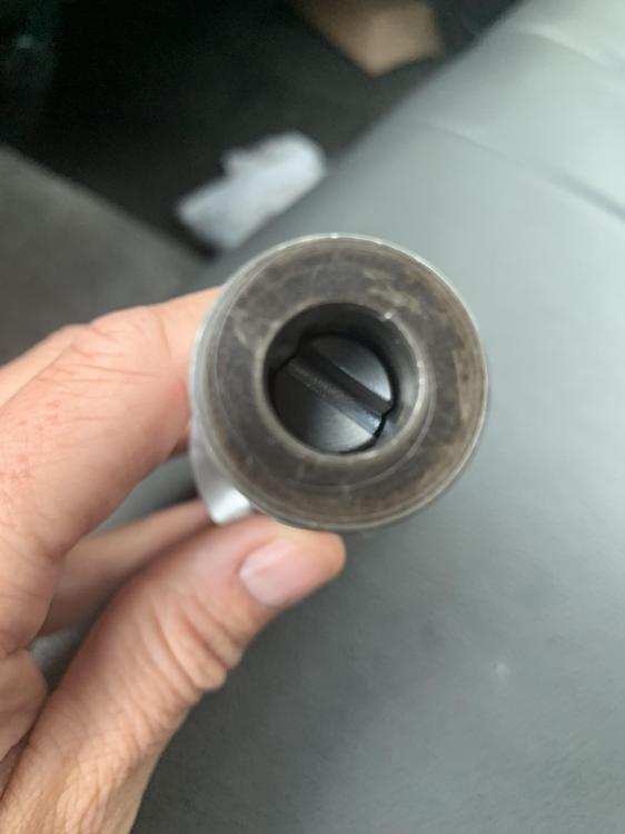

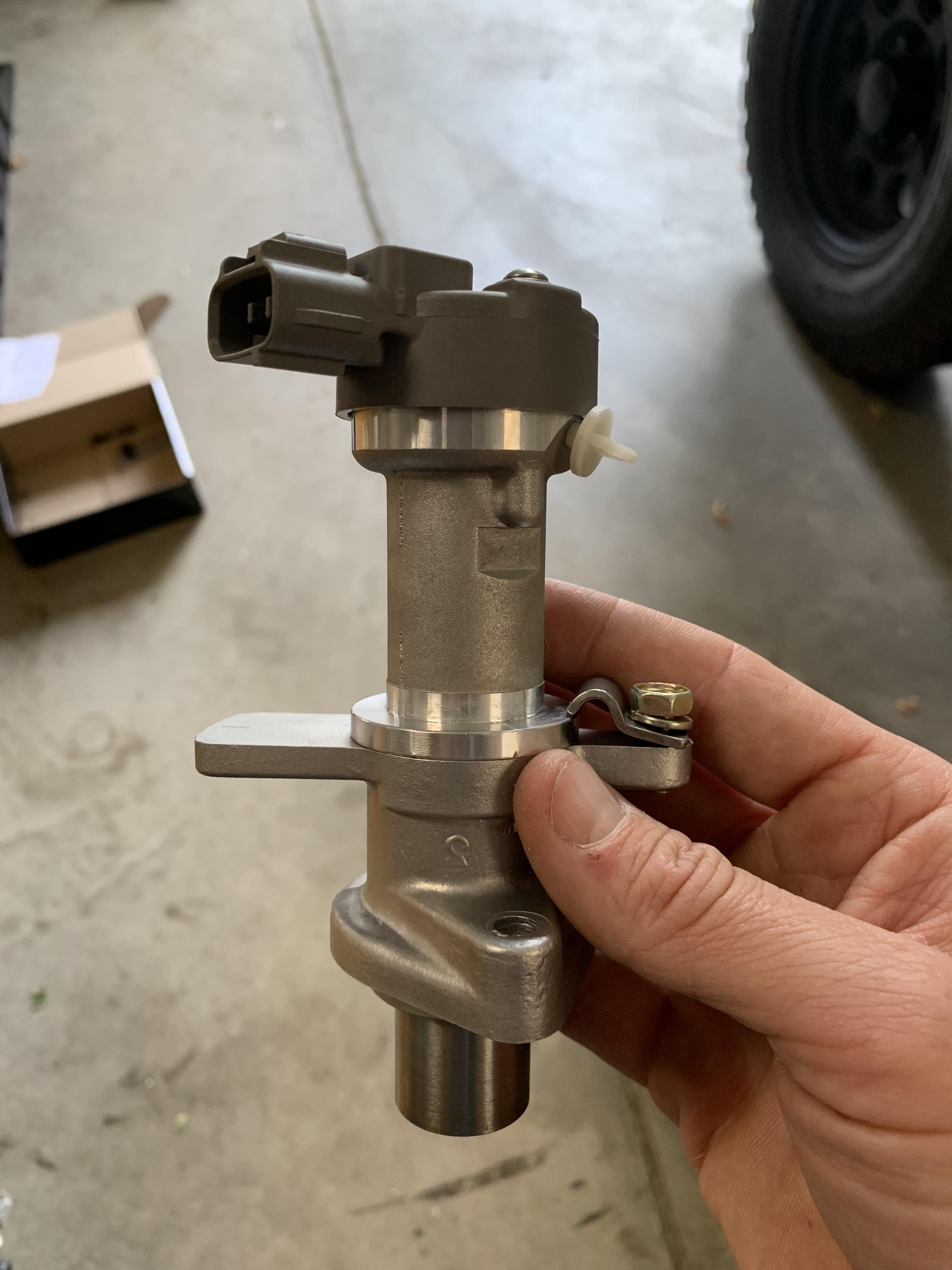

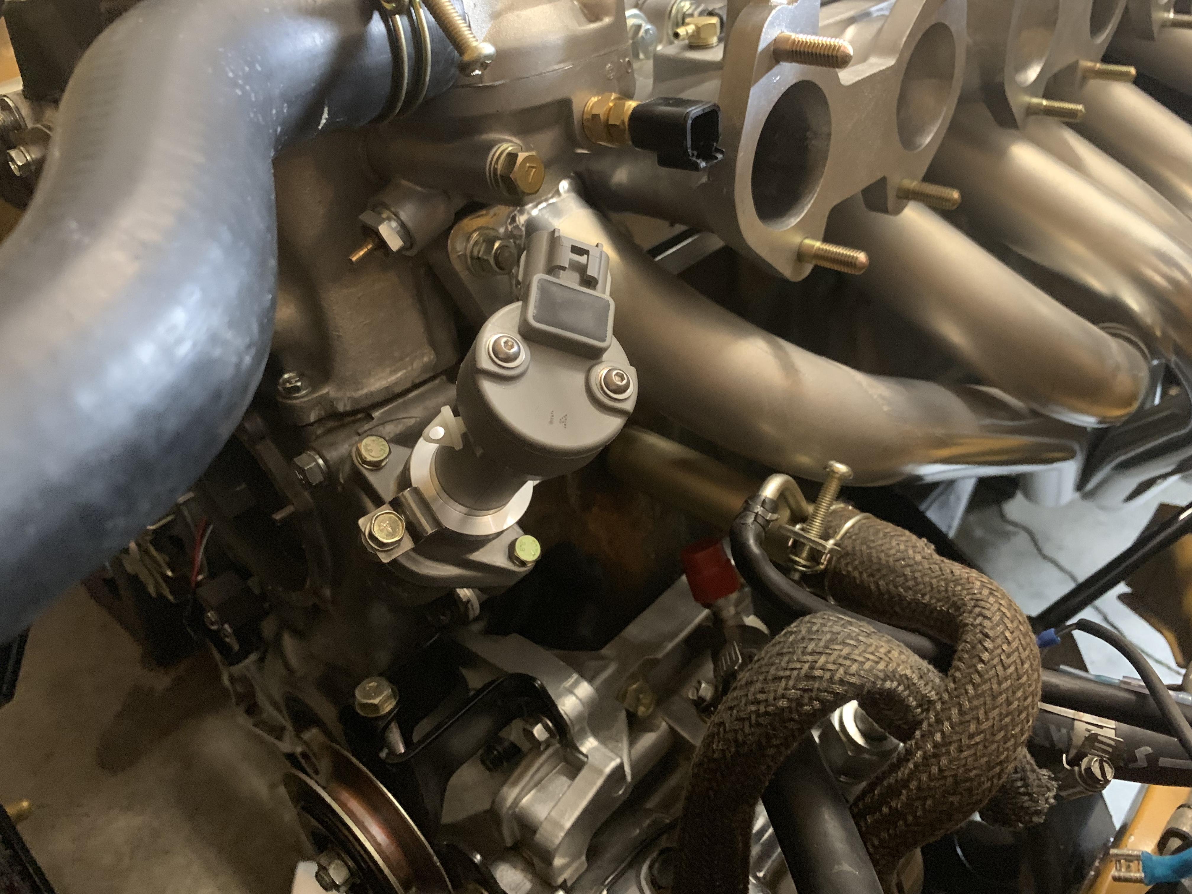

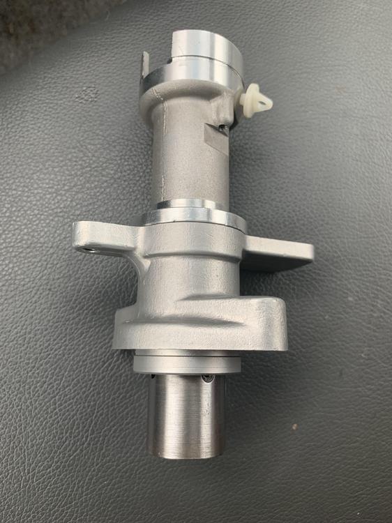

November 9, 20204 yr comment_610002 On 9/13/2019 at 8:04 PM, duffymahoney said: Also got my Jeep cas back from the machine shop. It’s nice and tight on the keyed shaft. Should work perfectly. I used the original dizzy collar as well. Hey Duffy, Can you detail for us what the machine shop did to make this fit? I have heard of this but I didn't know what modifications were needed. Link to comment https://www.classiczcars.com/forums/topic/58568-duffys-171-series-1-240z-build/?&page=55#findComment-610002 Share on other sites More sharing options...
November 10, 20204 yr Author comment_610056 I honestly just gave him an old distributor and then the jeep cas. I told him to make the jeep identical to the stock dizzy. I believe he cut the shaft, then he mimicked the slot. Then drilled the shaft for the stock pin. Then pinned it together.   Link to comment https://www.classiczcars.com/forums/topic/58568-duffys-171-series-1-240z-build/?&page=55#findComment-610056 Share on other sites More sharing options...

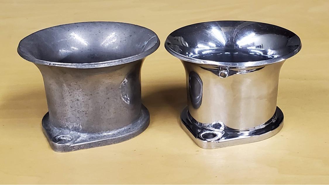

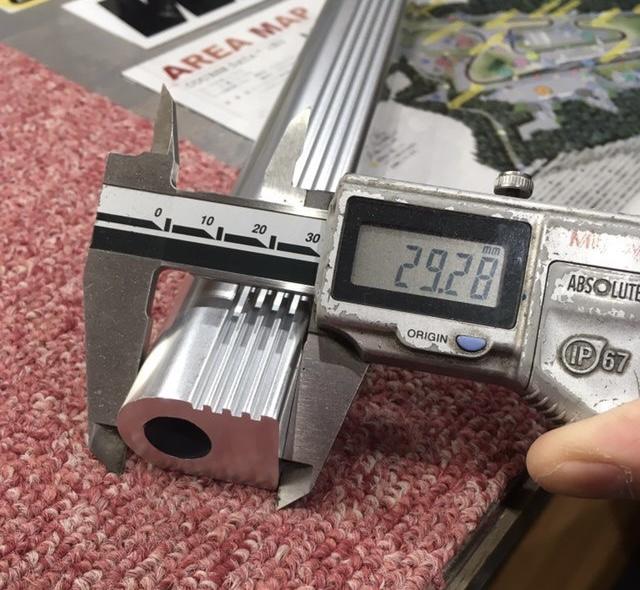

November 13, 20204 yr Author comment_610231 Some sk stack polishing going down. Link to comment https://www.classiczcars.com/forums/topic/58568-duffys-171-series-1-240z-build/?&page=55#findComment-610231 Share on other sites More sharing options...
November 19, 20204 yr comment_610663 I'm having a hard time imagining that the orientation of the slot is not important... Link to comment https://www.classiczcars.com/forums/topic/58568-duffys-171-series-1-240z-build/?&page=55#findComment-610663 Share on other sites More sharing options...
November 19, 20204 yr Author comment_610664 4 minutes ago, conedodger said: I'm having a hard time imagining that the orientation of the slot is not important... You aren’t getting the full signal for the motor. Your just tell the ecu exactly what stroke it’s on. Link to comment https://www.classiczcars.com/forums/topic/58568-duffys-171-series-1-240z-build/?&page=55#findComment-610664 Share on other sites More sharing options...

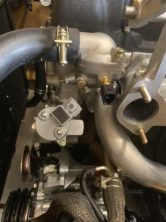

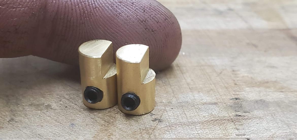

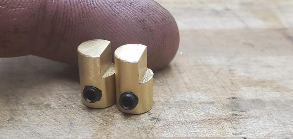

November 22, 20204 yr Author comment_610905 Tps adapter for throttle bodies or carbs. The idea is to turn the stock throttle shaft down on one end to 6mm. Then this threads on. IMG_9238.mov Link to comment https://www.classiczcars.com/forums/topic/58568-duffys-171-series-1-240z-build/?&page=55#findComment-610905 Share on other sites More sharing options...

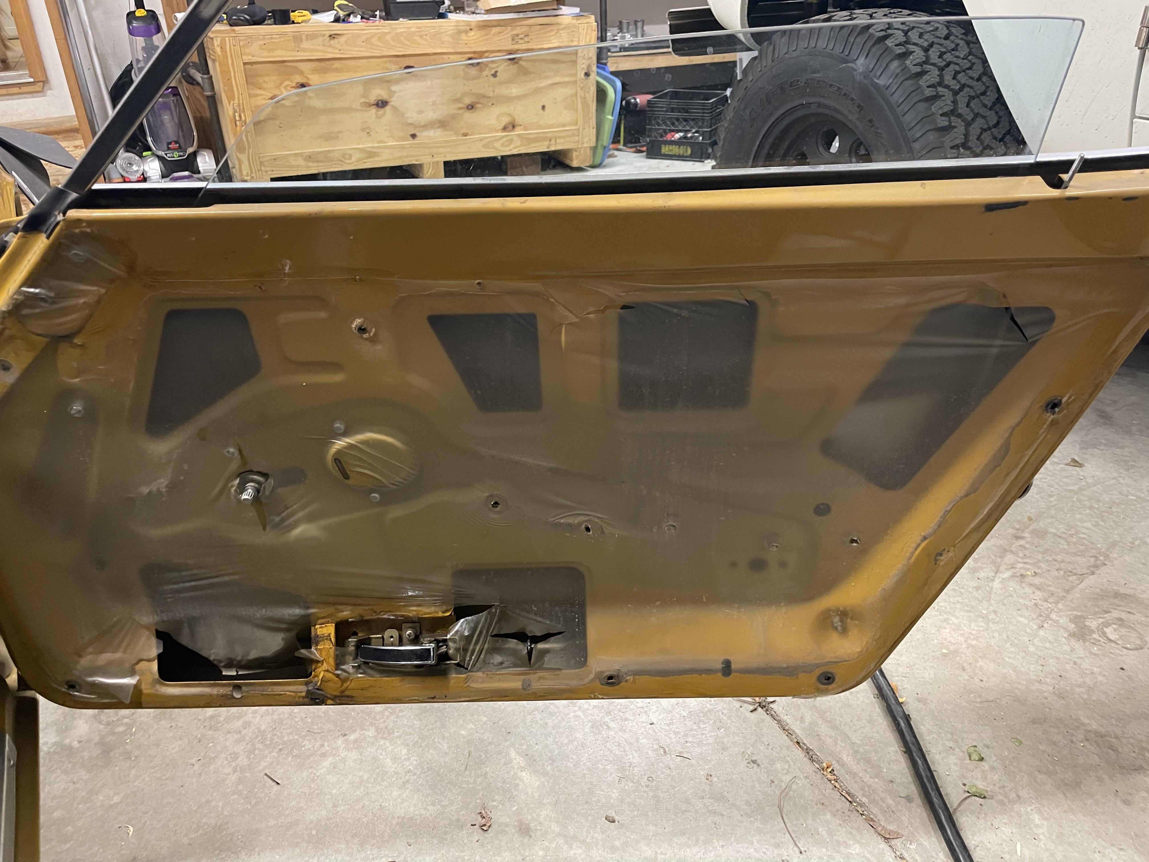

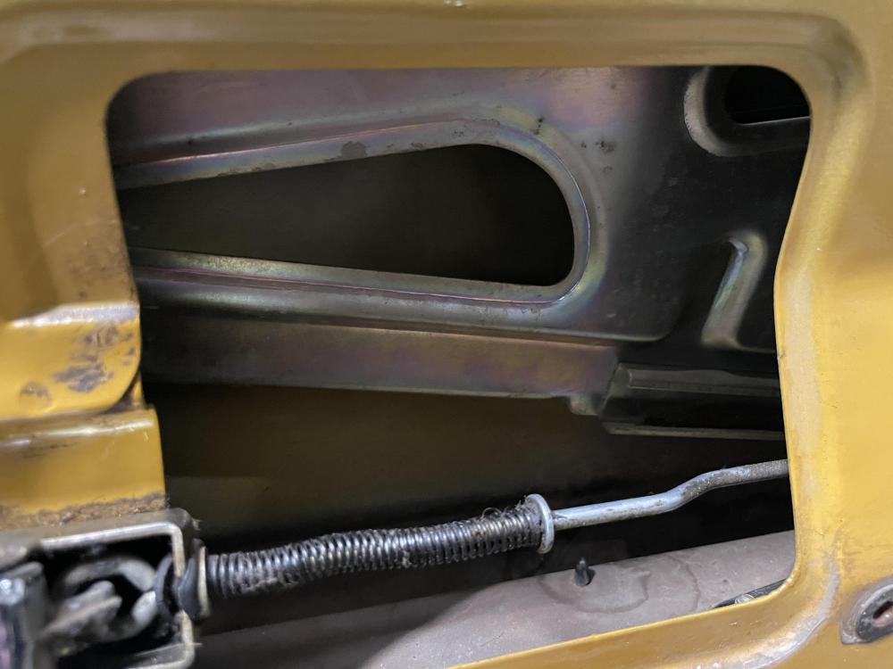

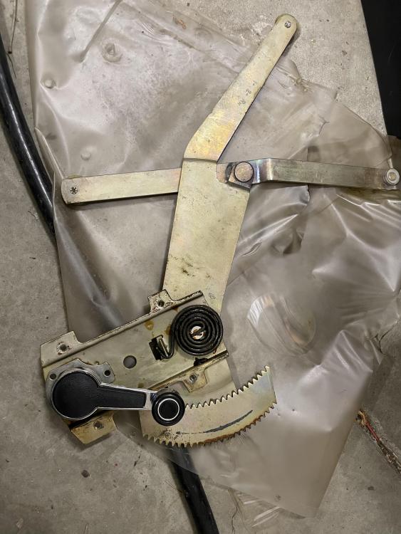

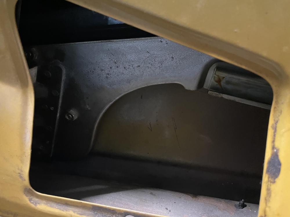

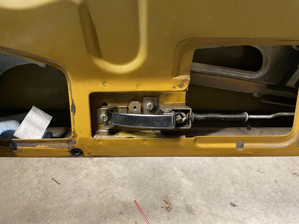

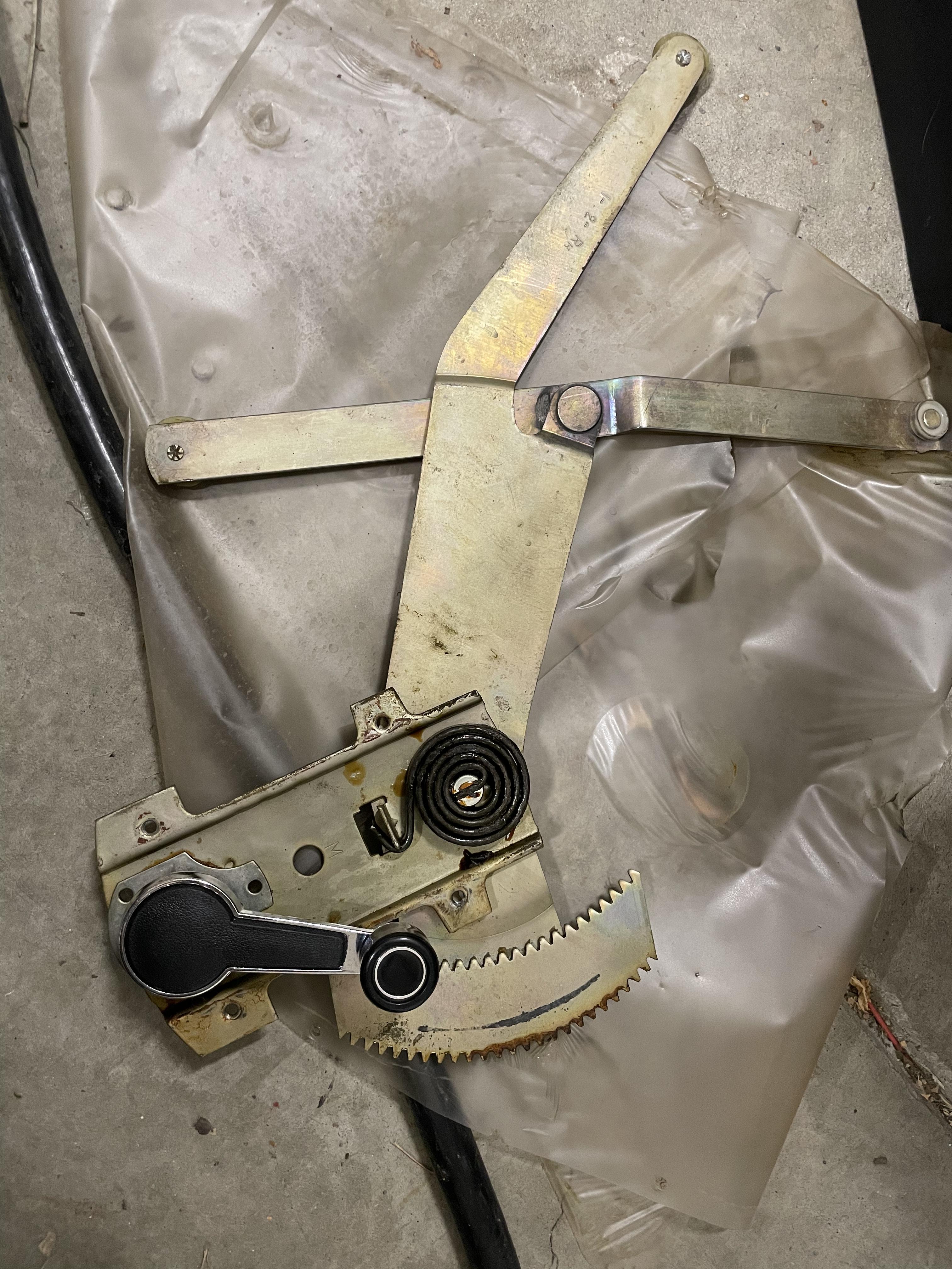

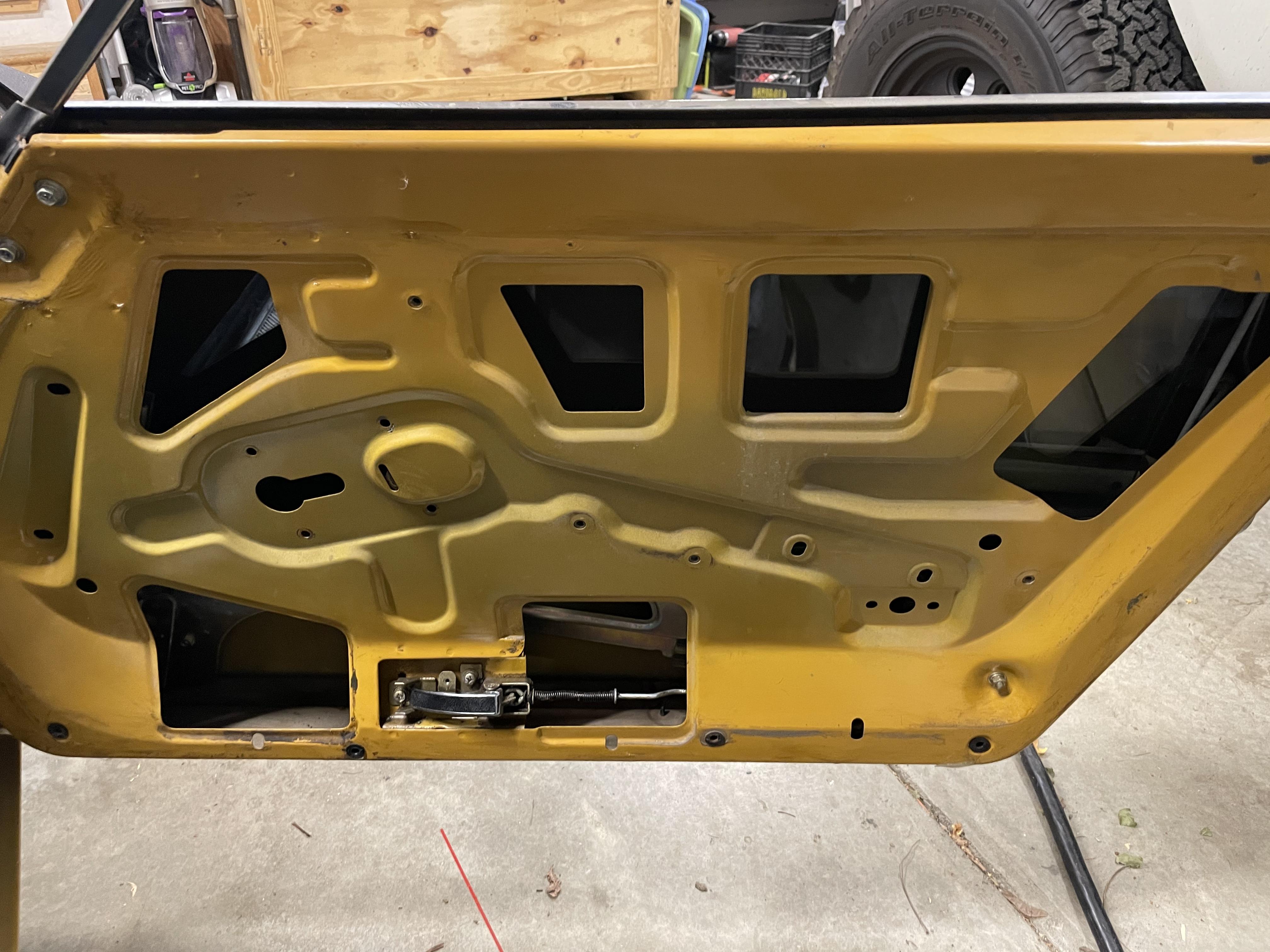

November 28, 20204 yr Author comment_611364 I have been dreading this repair. Trying to figure out why my passenger window won’t roll up. I got so lucky on this car. Zinc is somehow still intact on my series 1 door internals. I can’t see any real rust. I think the front slide is frozen. That’s all that is wrong. Link to comment https://www.classiczcars.com/forums/topic/58568-duffys-171-series-1-240z-build/?&page=55#findComment-611364 Share on other sites More sharing options...

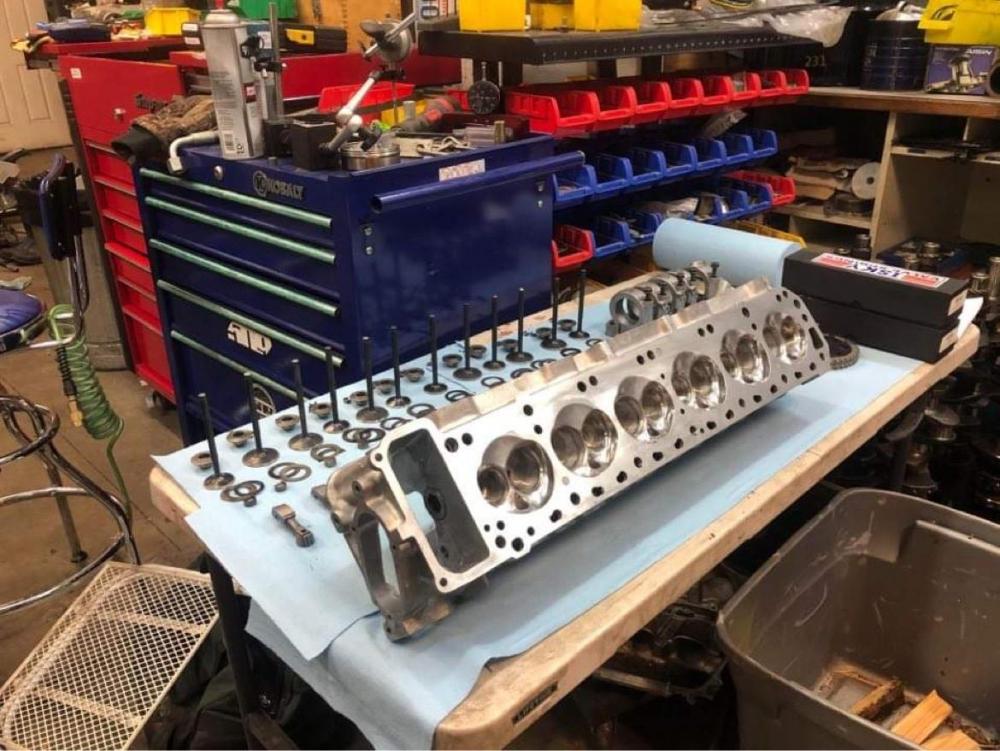

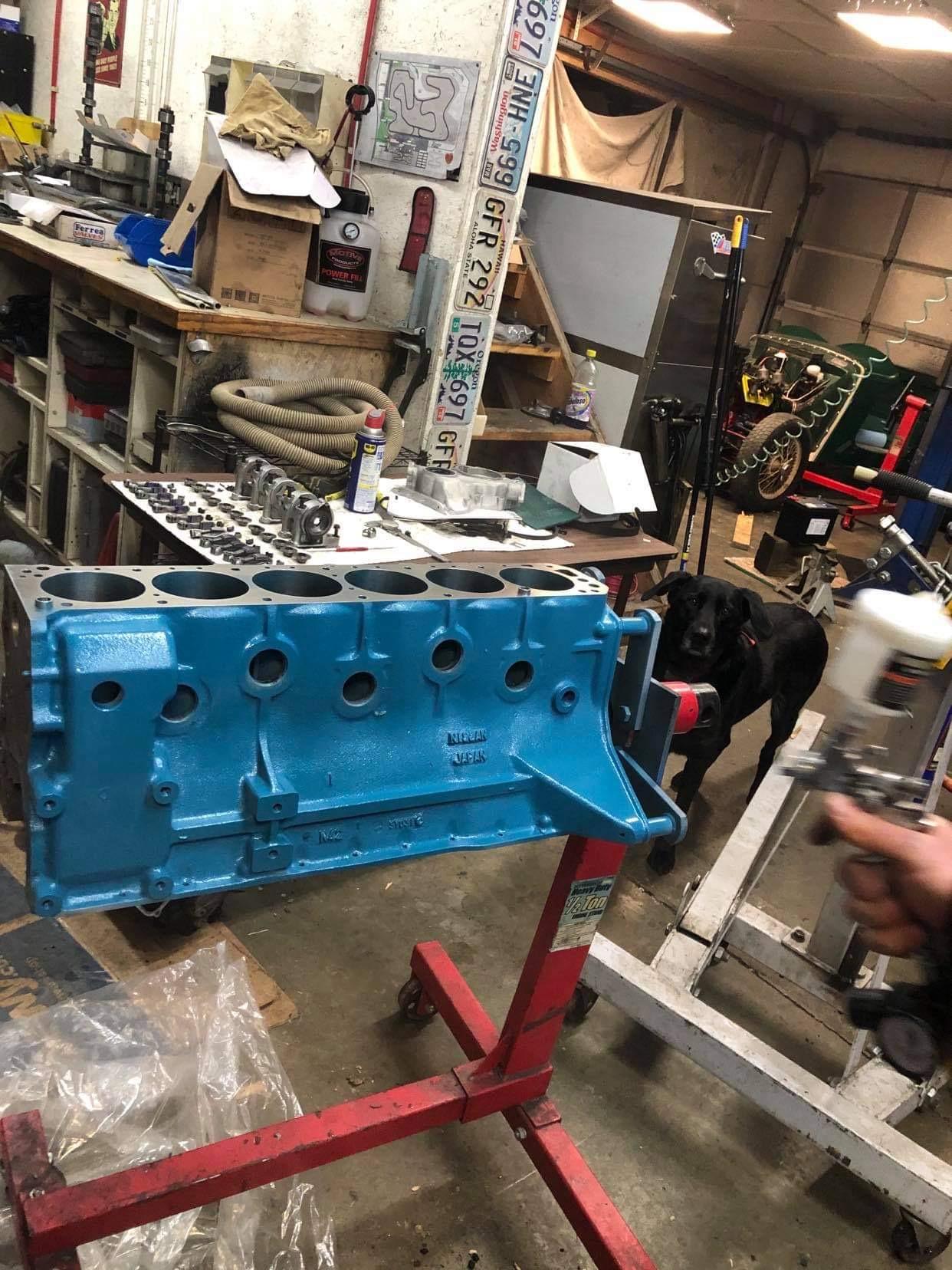

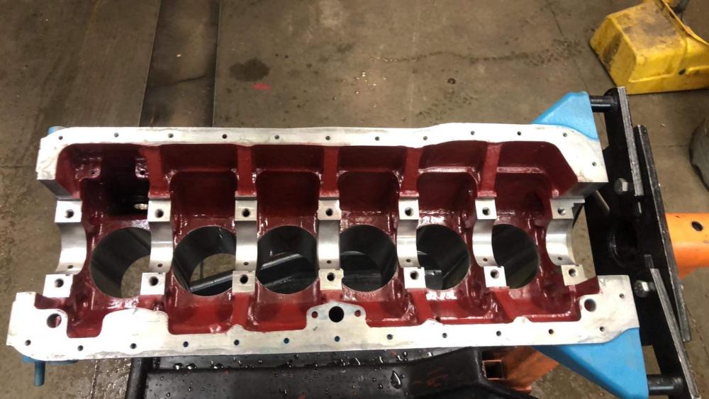

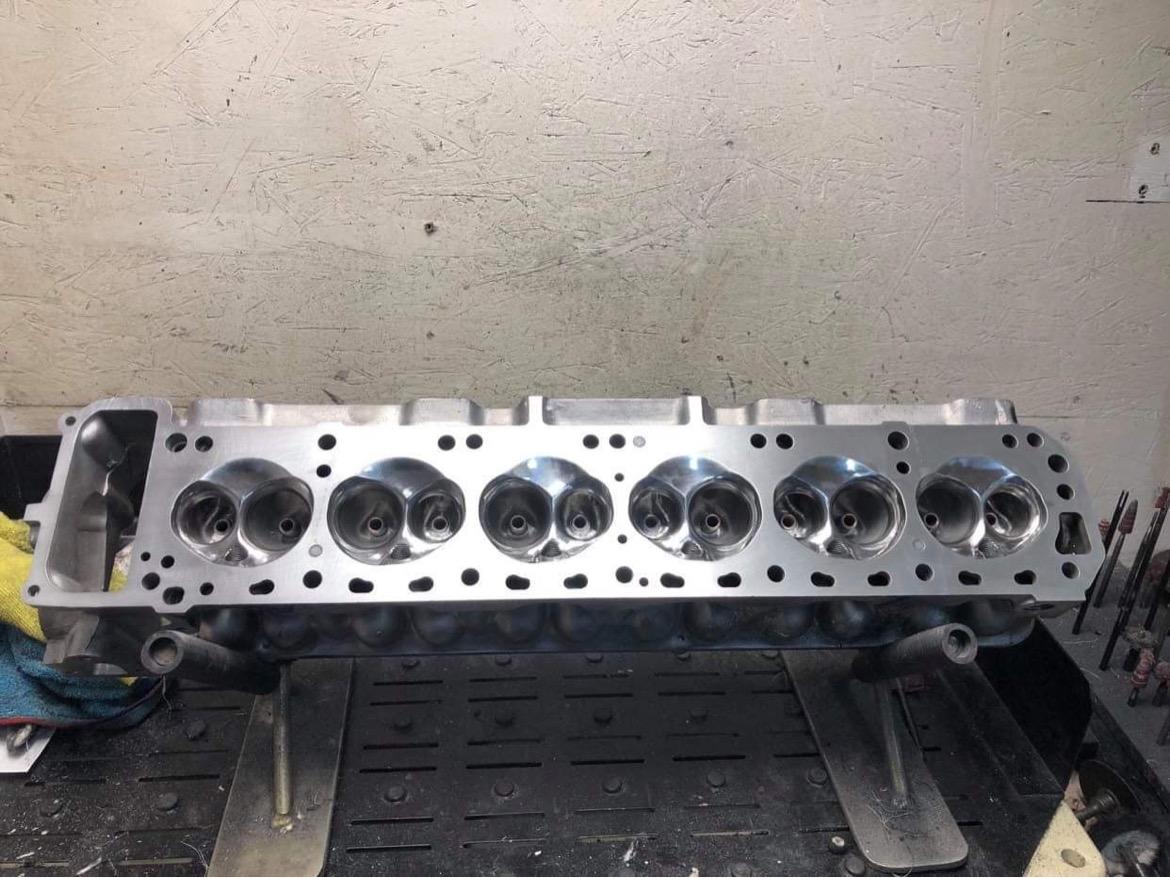

December 22, 20204 yr Author comment_613018 Stroker update!! Final assembly and paint Link to comment https://www.classiczcars.com/forums/topic/58568-duffys-171-series-1-240z-build/?&page=55#findComment-613018 Share on other sites More sharing options...
