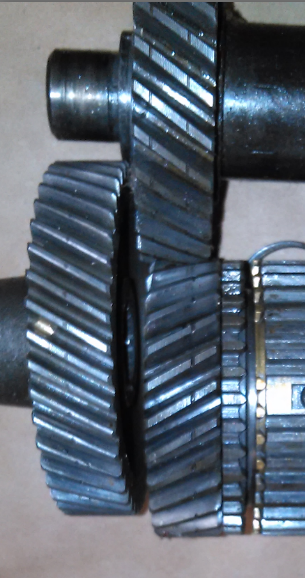

maybe not the right terminology, but has anyone else noted a groove that looks very deliberate on the 1st and 3rd gears? I suppose it could be damage but it sure looks perfectly machined in. Its very shallow, and thin, I will get some pictures later. I have searched google images and sometimes I think I see it on other transmissions.

Not the greatest picture, and i can't remember which gear is which but do they look like these?  One of them is 5th.  Can't hurt, wherever they came from.
Did you check the adapter plate bearings?  Those are the ones that seem to get destroyed most often.
