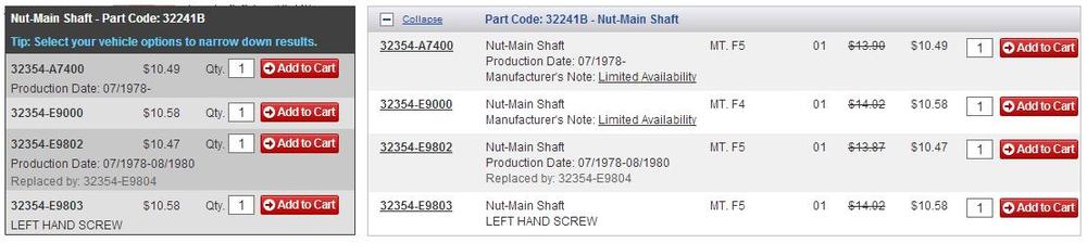

If its a close ratio transmission, it will have the same left hand threaded nut (E9803) as the 71C transmission in the 300ZX etc.
The wide ratio 5 speeds had the right hand thread

The left hand thread nut was used in the 280ZX Coupe NA with the close ratio 71B transmission.
A lot of people fall into the trap of thinking the 2+2 has the same transmission, but it doesn't. The 2+2 has the wide ratio like the 280Z and right hand thread nut.
