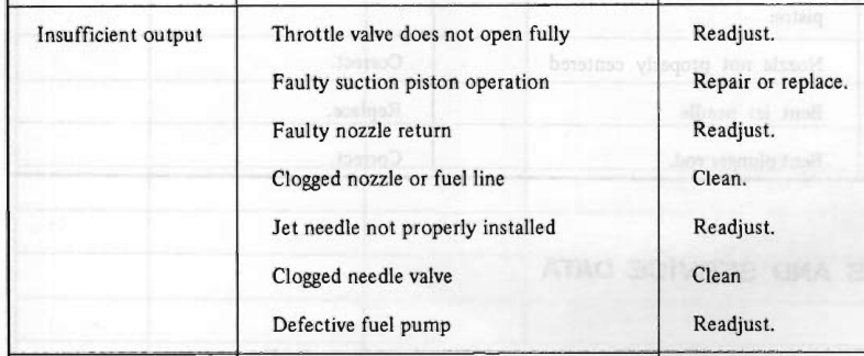

Somebody had a very similar problem recently.
