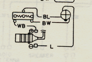

Iam in the process of installing an new ignition coil that came with its own white resistor block. It has a wire that goes from resistor + to + on the coil.
My issue is that the new resistor as two attachment point were as my original resistor has three attachment point. (Early 74/260Z).
The original connections goes like this; the small cylinder (condenser?) is connected to the + of the coil than a blue wire from harness goes to coil negative. White/black wire from resistor negative to + coil
Black/White wire from harness goes to + resistor
Black/Blue from harness to its own pole on resistor.
Black wire from harness to - resistor to positive coil via white/black wire. (Black and White/black connected together at the resistor negative).
My question is how to I attach all the wire to the new coil and resistor which has only two attachment point?

Edit 2 - I screwed up.  You can get the Start resistor bypass by connecting black/blue to the same terminal as white/black.  Black/blue is Start power, black/white is Run power, and white black is just the line from resistor coil positive, to supply coil power.  Looks like Nissan used half a ballast resistance for Start power.
Deleted, realized I didn't understand what the OP was describing.   Edit - found it, attached.  Black/blue and black/white would connect together to one end, and white/black connects to the other.  But you'll lose the Start bypass which will drop coil current during starting.
