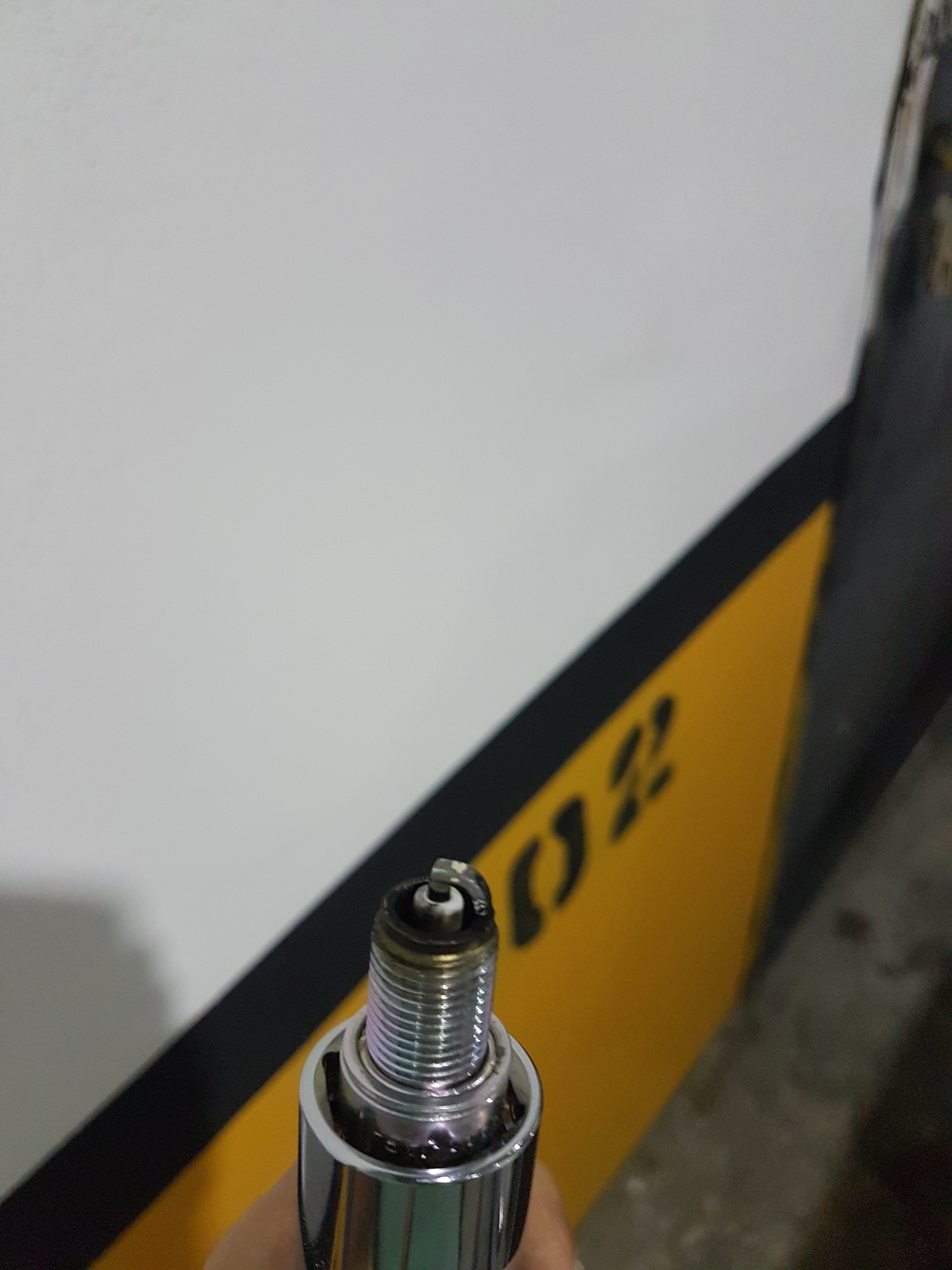

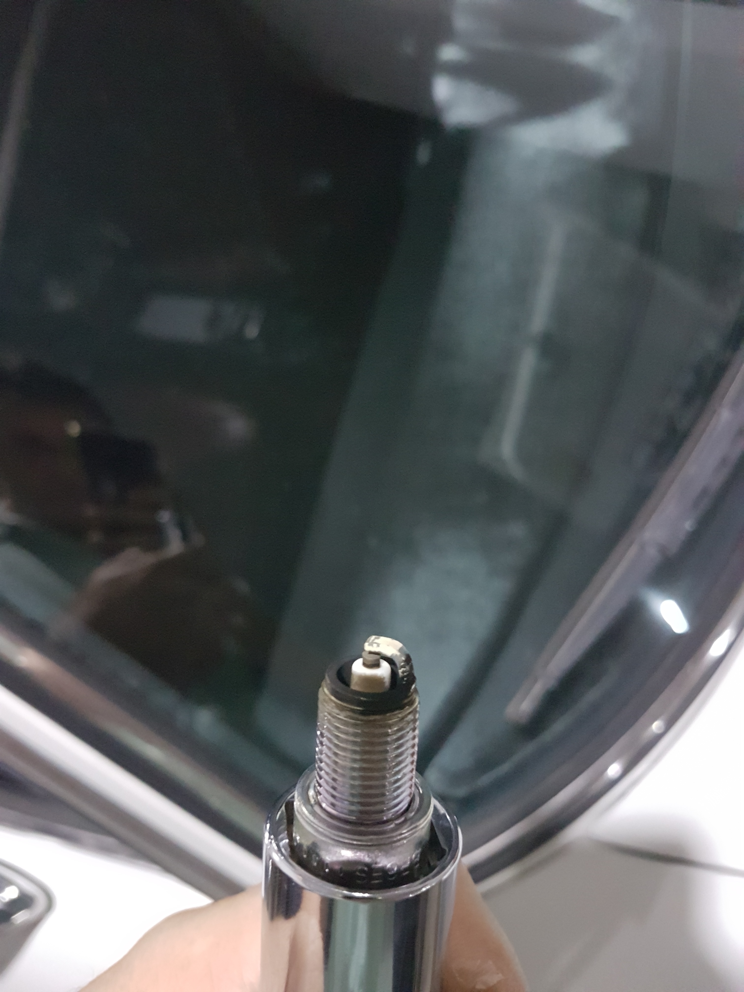

June 27, 20177 yr Author comment_524136 2 hours ago, siteunseen said: Your life will be so much better! 3.5 turns front and rear carb. Spark plug 2 and 5. Still lean??? Car is running fine! If so what color should they be? Or should i let the car idle for 5 minutes and then verify them? Link to comment https://www.classiczcars.com/forums/topic/57947-fuel-mixture-or-jet-adjustment-nut-settings/?&page=4#findComment-524136 Share on other sites More sharing options...

June 27, 20177 yr comment_524154 Keep in mind that bowl gaskets can be glued to the lids to prevent them from Pringling, per Cliff's suggestion. I understand your reluctance to open them up again but it usually takes me several tries to get them perfect. Probably just me. Anyway, CONGRATULATIONS, IT'S RUNNING GOOD. I'd drive it normally for a week or so and check the plugs again. Keep in mind that the Hitachi's are designed to run at 2 1/2 turns down + or - with the fuel level 1/16" below the top of the nozzle for best results. Keep us posted.Sorry for weighing in this late but those plugs look like they were dirty to start with. Not sure you can rely on what color they are now. Beside running the engine for 5 minutes won't tell you anything. If it was mine and I thought I was close I would buy new plugs and drive it for a week or so. Preferrably with some hard runs. Then check them. Ps I think these look lean and at 3.5 turns they should be darker. Does anybody think a valve adjust could be park of this problem???? Don's iPhone using Classic Zcar Club mobile Link to comment https://www.classiczcars.com/forums/topic/57947-fuel-mixture-or-jet-adjustment-nut-settings/?&page=4#findComment-524154 Share on other sites More sharing options...
June 27, 20177 yr comment_524158 Yeah, we discussed the cleaned? plugs before. I agree it's gonna be difficult to get an accurate reading with those. On the plus side, the car is running much better now. Probably due to the floats now being set more accurately than they were. @jalexquijano Did someone try to readjust the floats after they came back from Ztherapy? Link to comment https://www.classiczcars.com/forums/topic/57947-fuel-mixture-or-jet-adjustment-nut-settings/?&page=4#findComment-524158 Share on other sites More sharing options...
