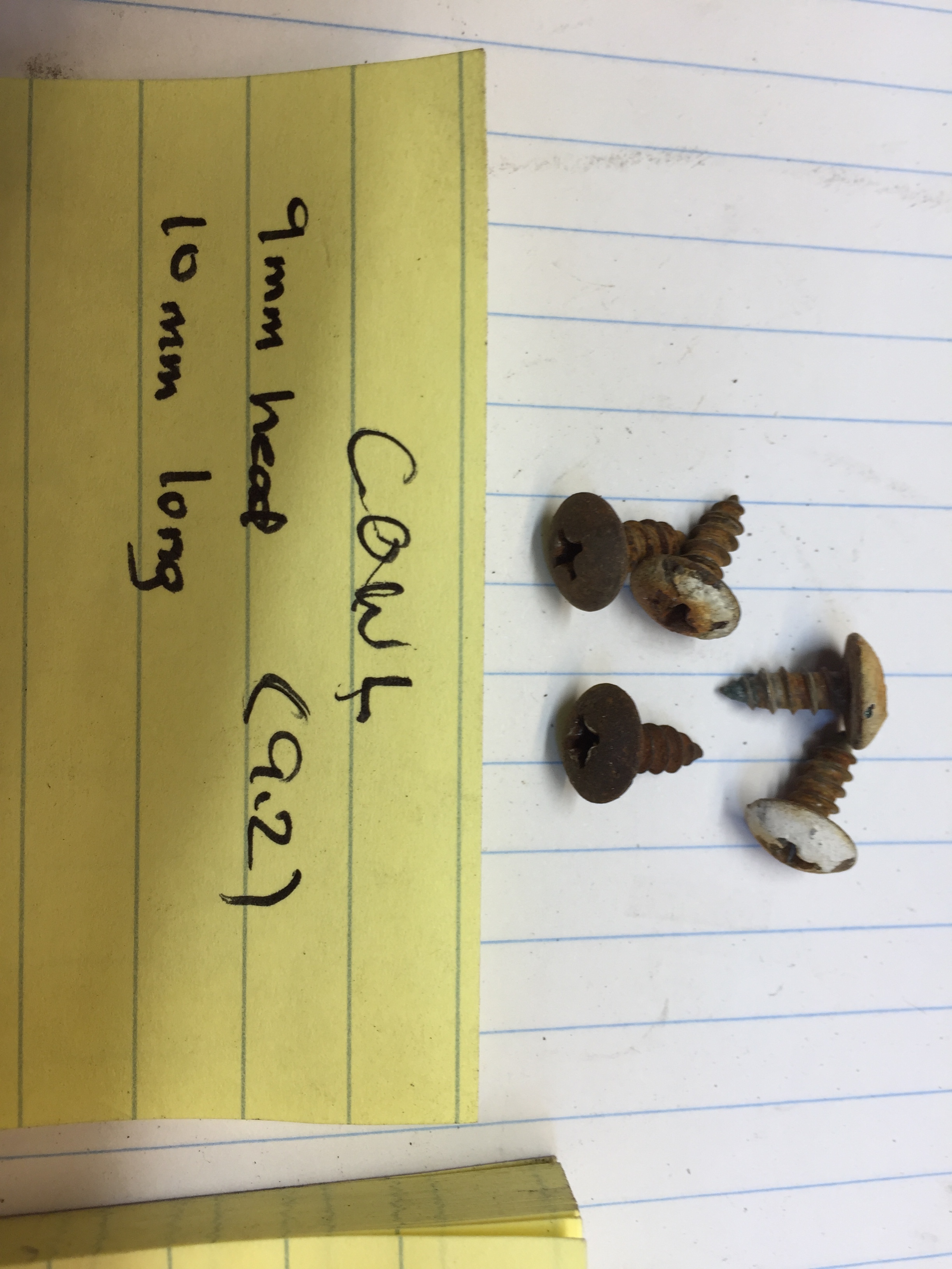

Ok, I have a bit of 510 hardware after my 69 resto, and, well, a LOT of Z hardware.  How perfect OEM is this request? I know have the right 5 cowl screws, and lots of shiny CAD plated 6x1 bolts for the grill.

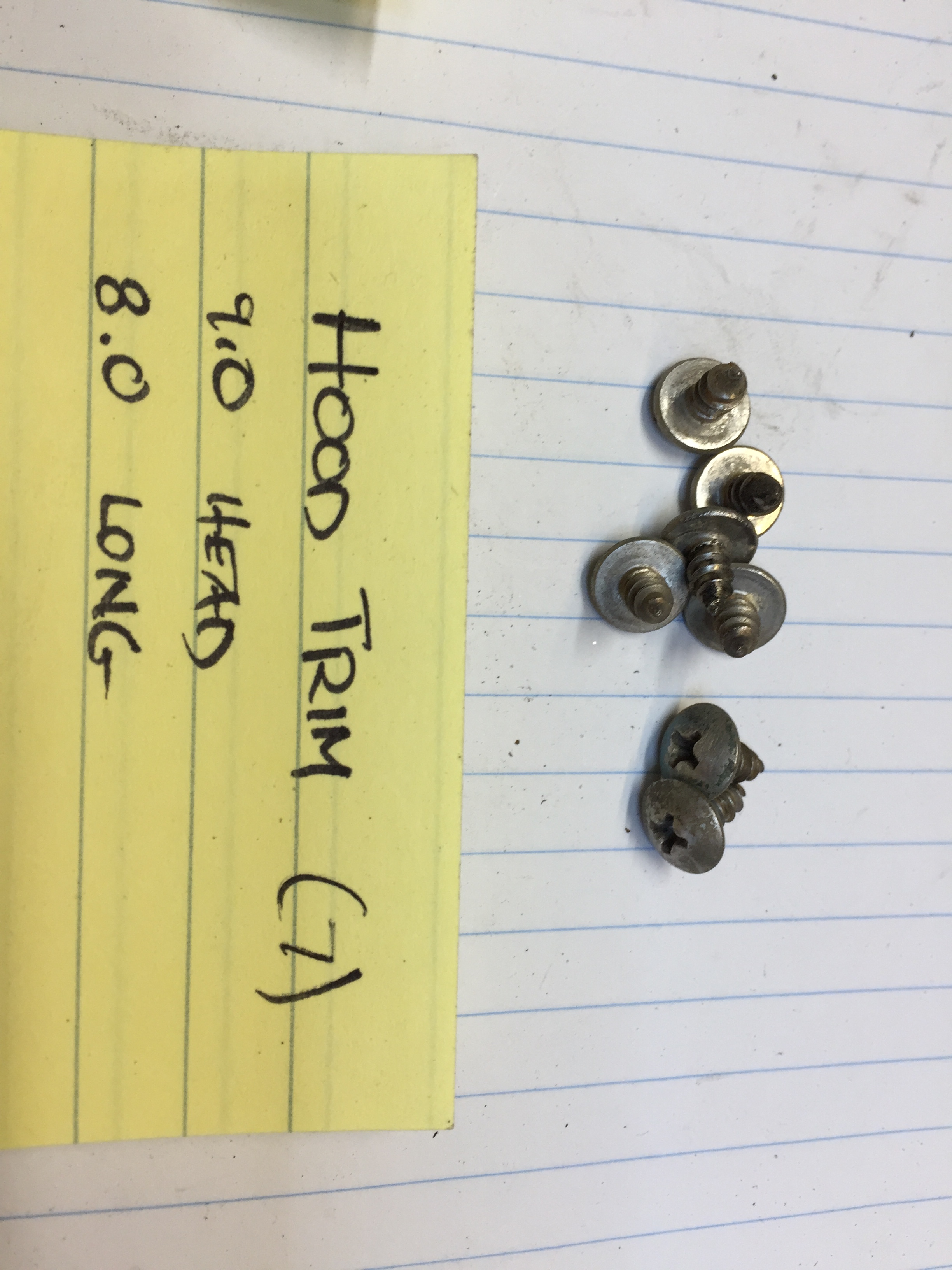

Hood trim screws I have, but not a spare set, just a set that goes with the trim. I can at least measure and take pictures.

The hood trim and cowl screws are remarkably similar.
The hood trim screws are 8mm long, the cowl, 10mm. The heads are 9 and 9.2mm dia.
They look and are the "same" as the door sill trim screws on a Z. I'm seen them on ebay before.
