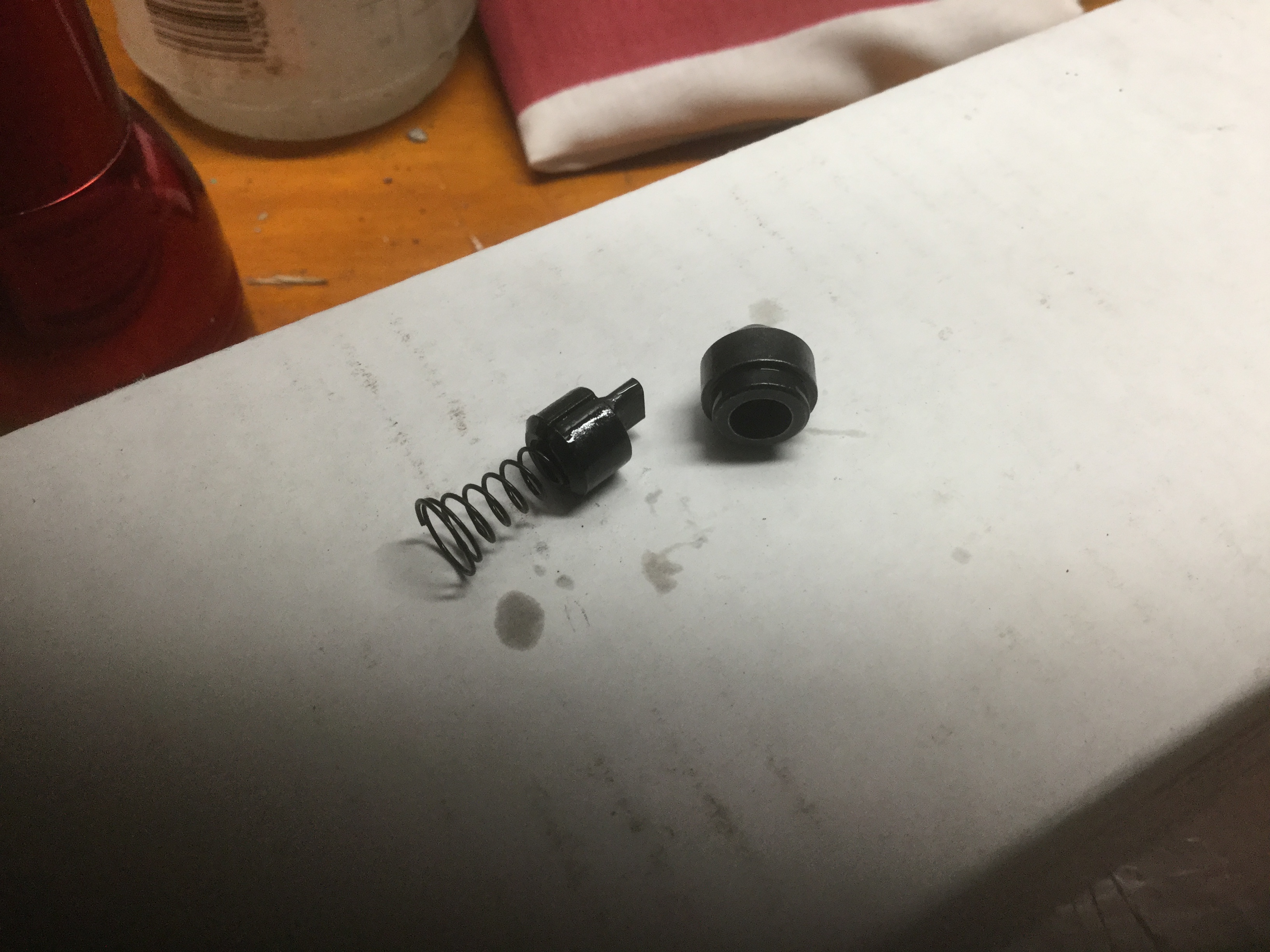

One possible cause not already mentioned is a check valve in the master cylinder output port that is holding pressure in the line. Take the adapter fittings out of the ZX master (where the brake lines attach) and look for check valves.
I got another master installed it, shimmed it out, still same issue as the first go round, system is holding pressure. Here is what I have under the adaptor in the ZX master.
