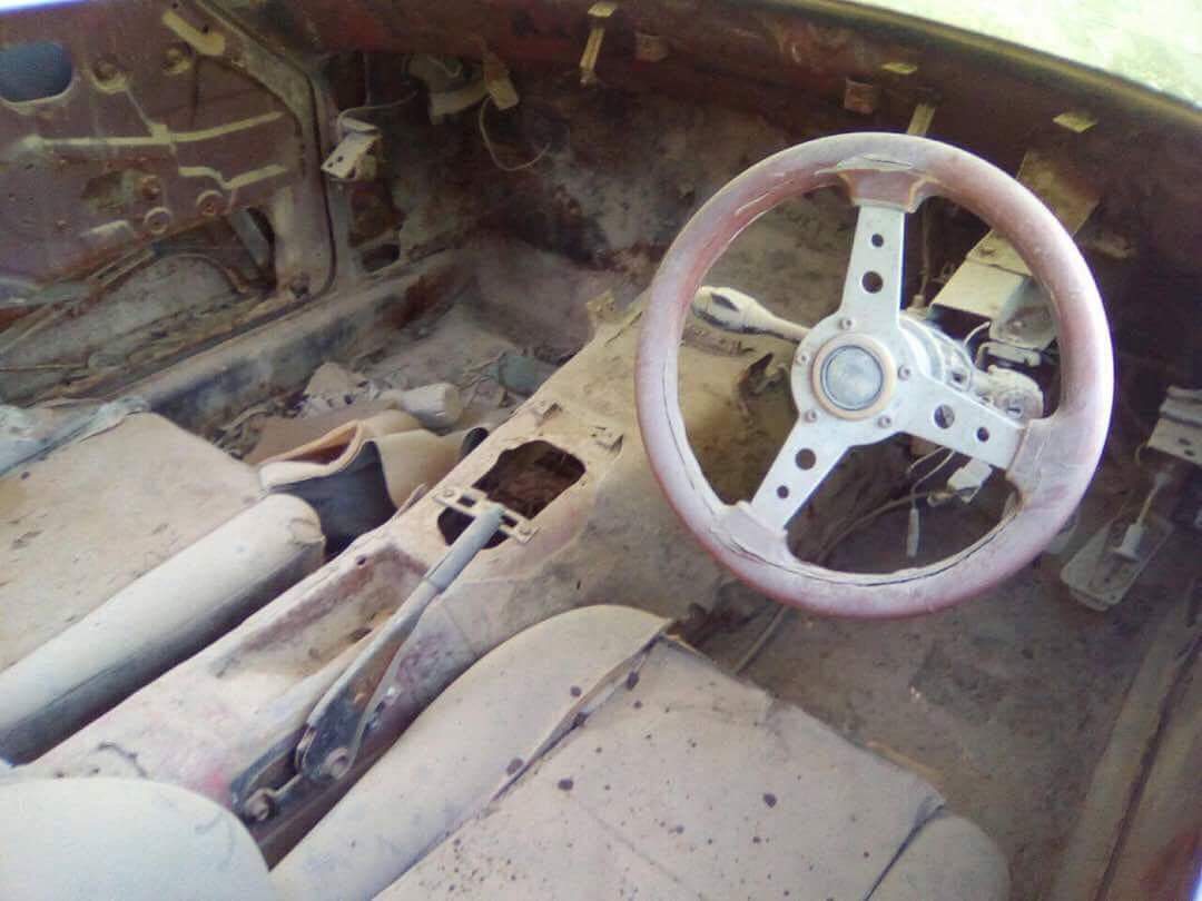

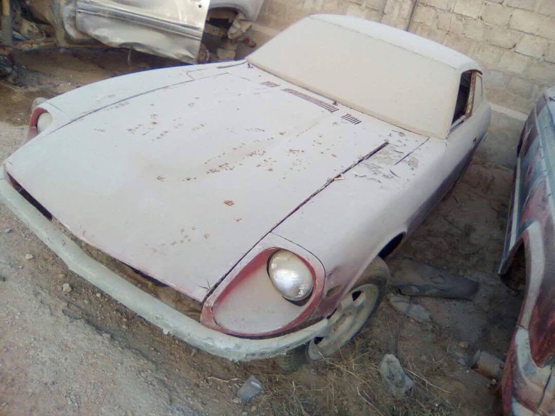

April 27, 20178 yr comment_519276 I have seen photos of the car. @asim has a right-hand drive 260Z, so we do need to know the year. He will need a right-hand drive dash and steering column cover. The car looks to have suffered from years of neglect. Please post the year of your 260Z and the year of the 280Z that you acquired for parts. Link to comment https://www.classiczcars.com/forums/topic/57581-260z/#findComment-519276 Share on other sites More sharing options...

April 27, 20178 yr comment_519324 Wow! Ok we have a project! Gonna need some parts. Might want to learn to use Google Chrome and shop Yahoo auctions in Japan to source some of the right hand drive parts Link to comment https://www.classiczcars.com/forums/topic/57581-260z/#findComment-519324 Share on other sites More sharing options...
