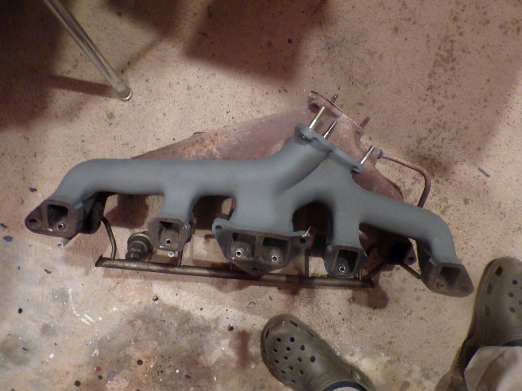

April 25, 20178 yr comment_519069 My 73 had a much larger and heavier exhaust manifold than the earlier models. Thus more heat sitting under the carbs. I changed to the earlier one when I swapped out to round tops. Thanks to Chet Wittel for the idea. The attached photo gives you an idea of the size difference. Link to comment https://www.classiczcars.com/forums/topic/57414-cant-maintain-fuel-pressure/?&page=7#findComment-519069 Share on other sites More sharing options...
April 25, 20178 yr comment_519070 There it is! Link to comment https://www.classiczcars.com/forums/topic/57414-cant-maintain-fuel-pressure/?&page=7#findComment-519070 Share on other sites More sharing options...

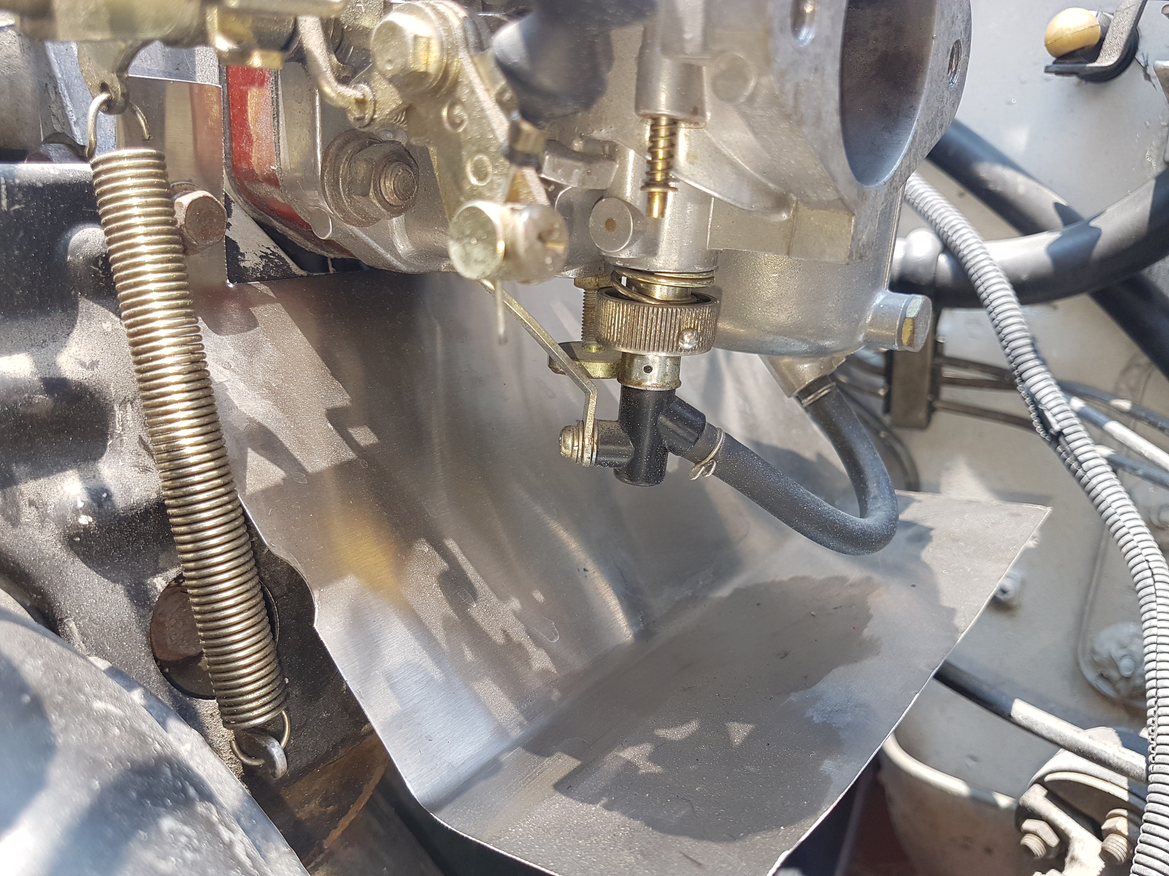

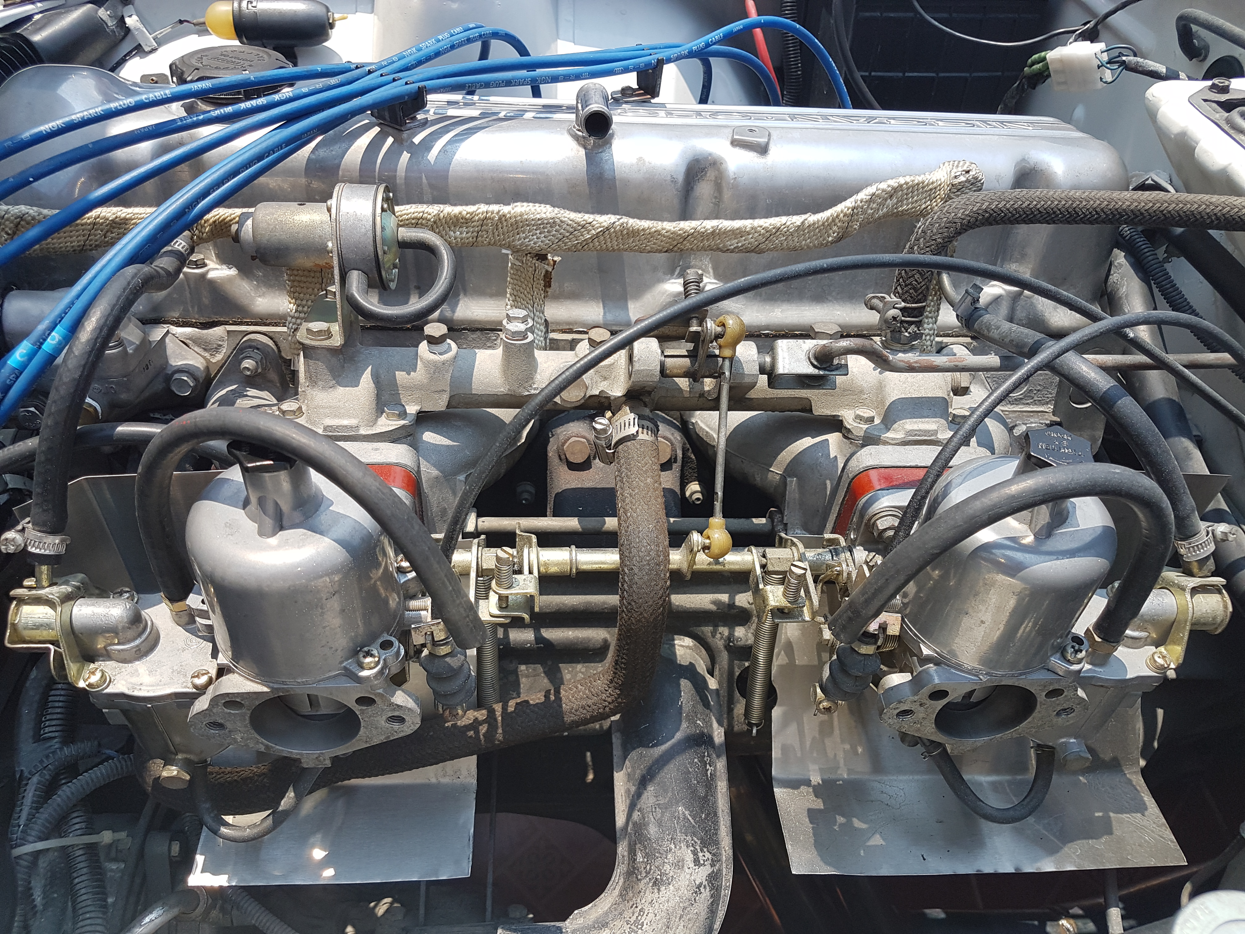

April 25, 20178 yr comment_519123 Steve, I want to know the outcome of your Project. You see in addition to the stock heat shield which was installed in the car by the Factory originally, i have mounted a stainless Steel heat shield extension that reaches the bottom of both 3 screws SU Carburetor float bowls and the percolation is still present. The gasoline in Panama has no ethanol so this should not be happening. The heat comes from the manifold and thus there must be away of lowering that amount of heat so it does not affect the fuel that is inside the foat valves and that will evaporize and consequently shut the engine down. I am hereby enclosing pictures of the heatshield extension and the new downpipe of the MSA PREMIUM EXHAUST that is connected to the stock manifold for your perusal. Some guys in these fórum only throw out ideas such as swapping metal fuel rail with 5 inch rubber hoses or driving with the lid off? Is this really going to help and avoid the car idle becoming lumpy at traffic jams which leads to a sudden shut down of the engine? Wouldnt it be better to put an ice cooler to lower the temperature at the manifold? Edited April 25, 20178 yr by jalexquijano Link to comment https://www.classiczcars.com/forums/topic/57414-cant-maintain-fuel-pressure/?&page=7#findComment-519123 Share on other sites More sharing options...
