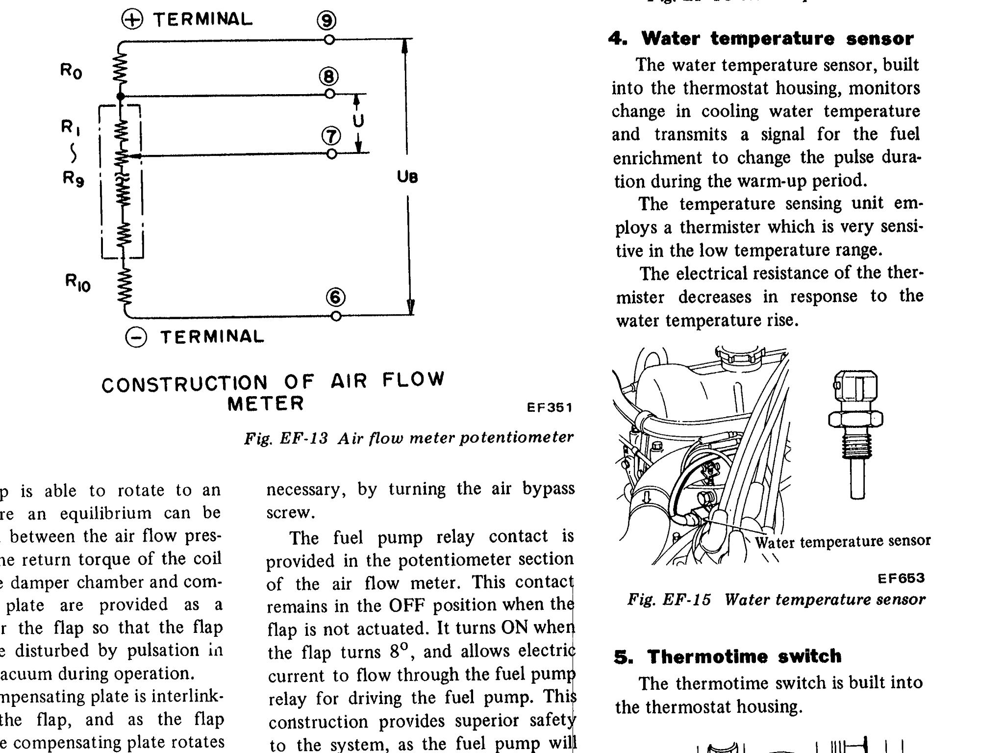

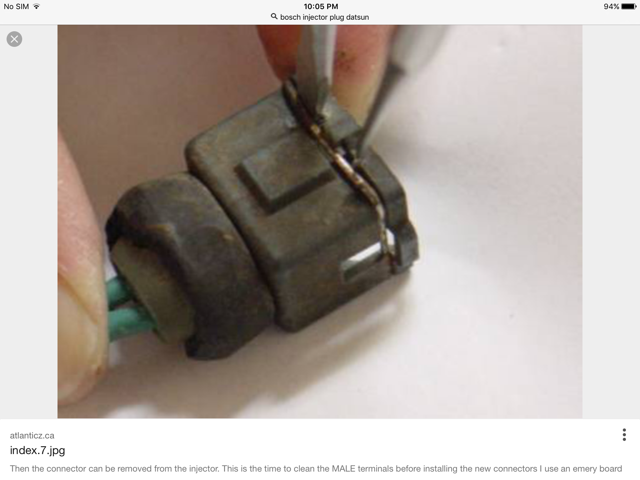

Here is the link to the 77 PDF you can give your mechanic. It has all the checkout procedures for the EFI. The CTS or WTS is on page 95. There is much more diagnosis in the EF section. Here is a snipet of page 95. These cars are notorious for running rich if the CTS doesn't have a good connection to the sensor or ECU. Plus the plug gets old over time. I put a pic of the plug at the bottom. Clean it good with Emory board and electrical cleaner.  Do the sensor too.
http://www.nicoclub.com/FSM/280z/1977/
