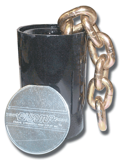

2 hours ago, cbuczesk said:
I also had Champion floor pots installed in the concrete. They mount flush with the floor and have a chain anchor inside that's used to pull frames. Since I race a 240Z and restore cars as a hobby it seemed like a great idea for $250. Have them installed when they pour the concrete. Having holes drilled later costs much more!
Chuck

So what is a "floor pot"?  Some sort of anchoring device?  Can you post a picture or send a link to a website?
Thanks,
Marty

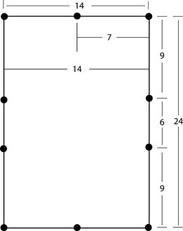

Floor pot: http://www.autobodytoolmart.com/champ-floor-anchor-pot-1600-p-11538.aspx
Plate required for a new floor: http://www.autobodytoolmart.com/champ-instant-floor-plate-new-floors-p-10320.aspx
Check their web site for all of the different attachments. I think Champ's web site shows where to locate the pots. I went with 10 pots. You can use more or less but 10 seemed like it would do almost anything I'd need.
Chuck

Very interesting.  Do you have any pictures of them installed in your floor? I would like to see how you have them arranged.
