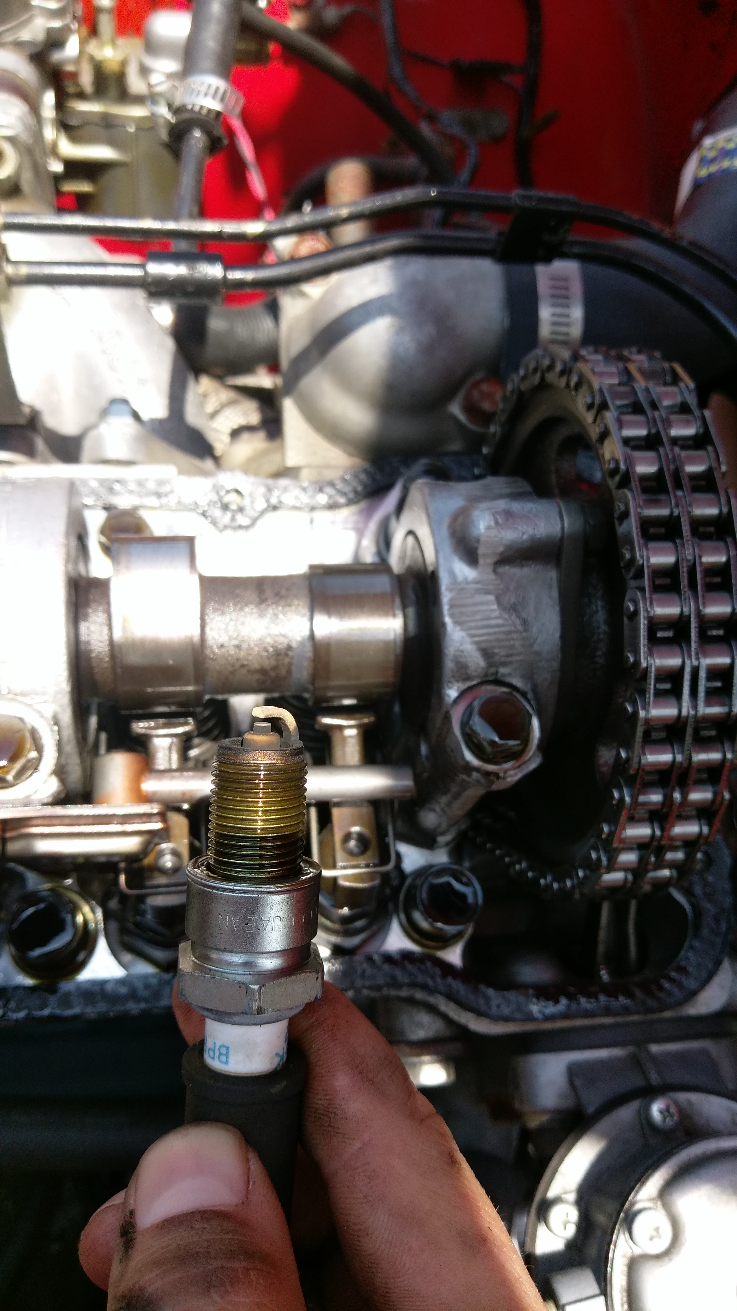

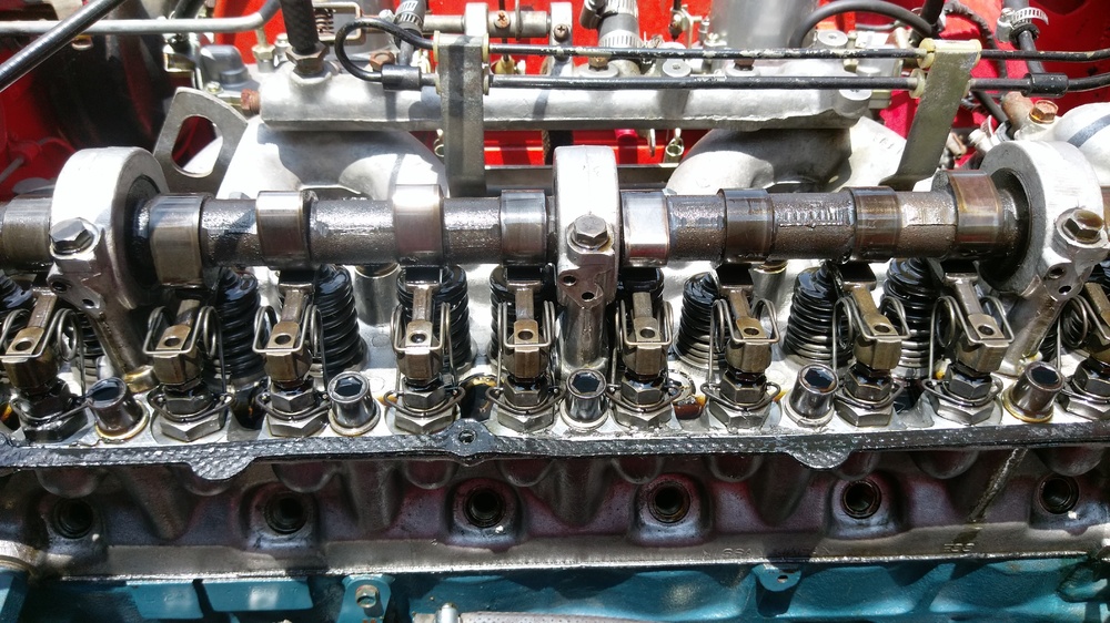

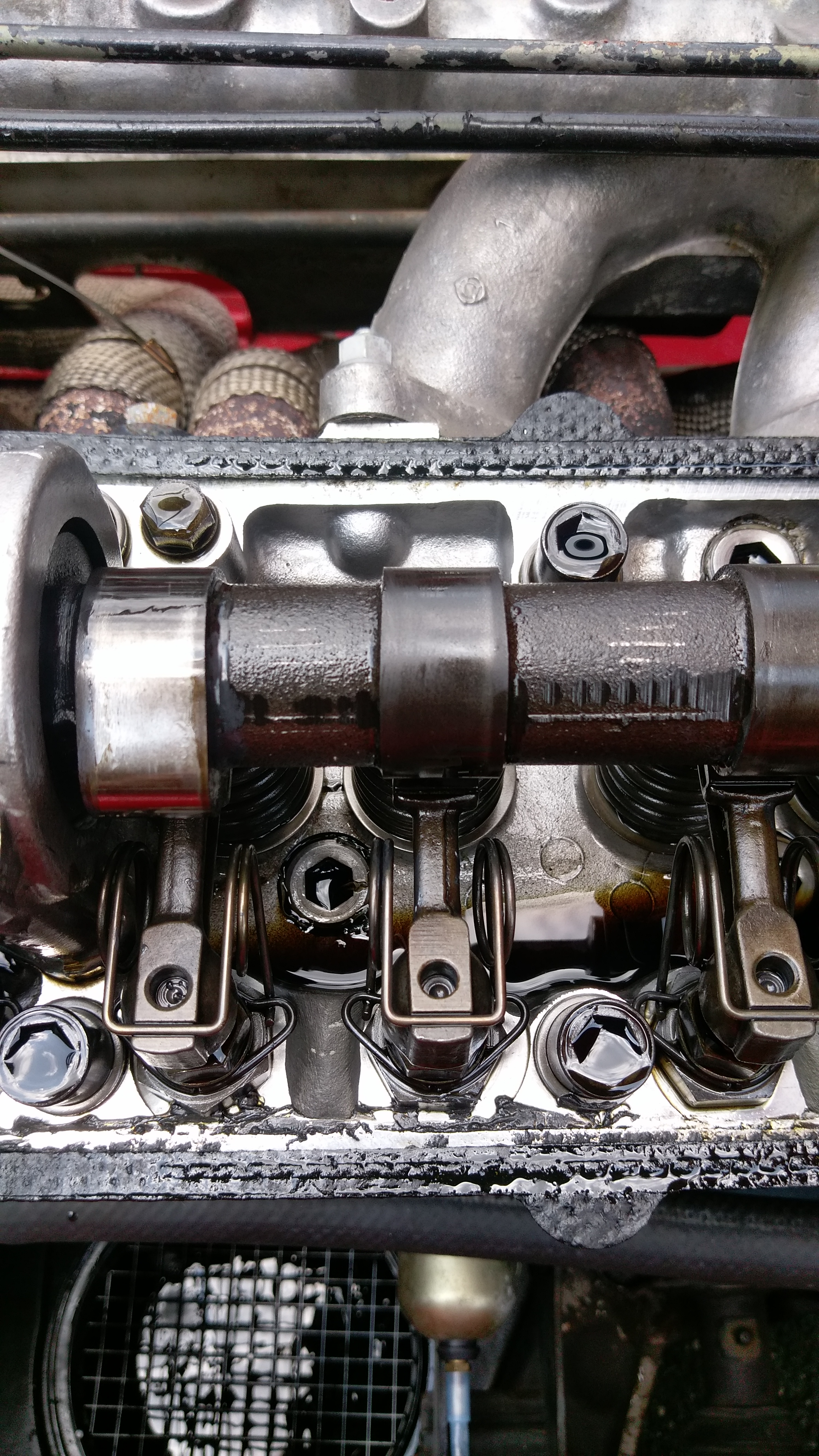

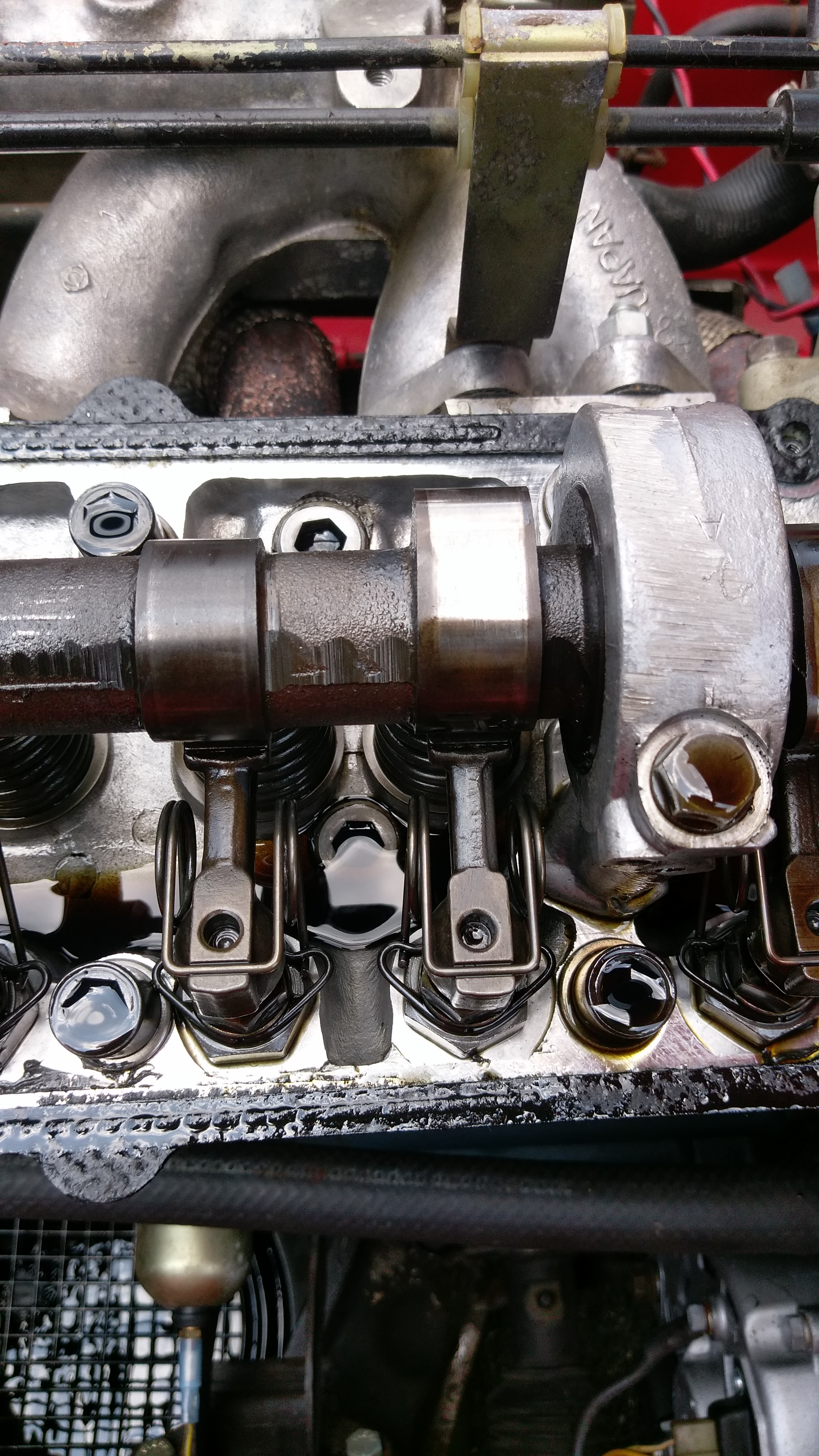

Hello everyone. It's been awhile since I've signed on, and to be honest it's been awhile since I've touched my old Z. I was running the car all last summer, and it ran great. It had great power,  and pulled really strong. I'm running ZTherapy rebuilt SU's which I synced and tuned, pertronix ignitor, and just an MSA 6 to 1 header. I rebuilt the engine but had the head sent out to Mancini machine, where I know they re surfaced it, and I can only assume they checked, repaired, and assembled the head correctly, as this was some years ago.  I was driving the car one day and I thought the valve train sounded louder than normal so I preceeded to pop the cover off and check my valve clearances. I found that a few lobes on my cam are black, not shiny like the others. I also noticed that the oil is dark for how new it is. I'm wondering if I ran the valve clearances too tight on these valves and damaged the surface hardening of the cam. I ran Lucas oil stabilizer in this engine when I was driving the car as well. Also used some ethanol fuel treatment in the gastank. Any feed back would be greatly appreciated.

A picture of the lobes and rocker wipe pads would be very helpful.

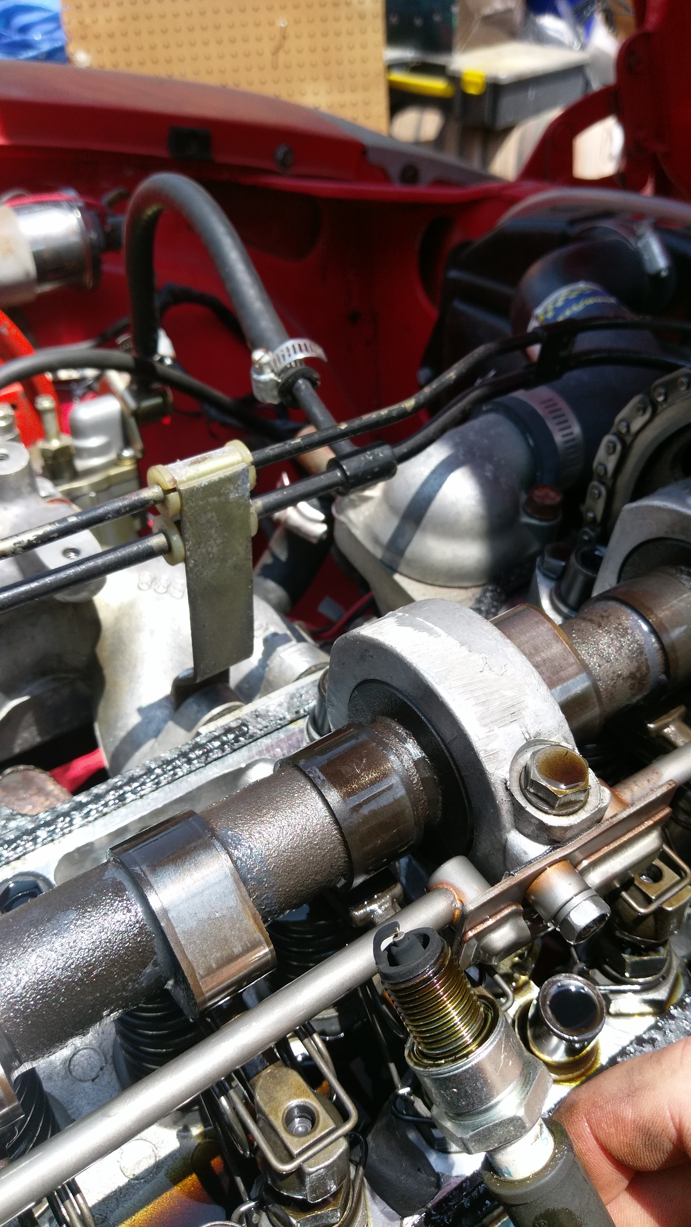

OK so I finally had some time to do some more digging on my Z. It has the original externally oiled camshaft that was in the car when I got it. I set the lash to the spec as per the FSM. I run 10w30 in it with one bottle of Lucas oil stabilizer. I have since taken the plugs out and with the valve cover off cranked the hell out of it. And with the spray bar removed as well I get no oil coming out of the cam towers. But the entire time I was running the car, the oil pressure read fine and the engine never knocked or anything. Is it possible that the oil passages in the head alone could be clogged? Also does the center cam tower supply oil for the entire cam?
Where are you in MD? Did you set the cold lash? The oil passes from the center right side of the block through a passage into the head. That area could be blocked. But if there's no oil getting to the cam and lobes then I couldn't expect it to run for too long. The lobes will wear and the cam might seize in the towers. I think the end towers supply the oil to the front and back halves of the cam.

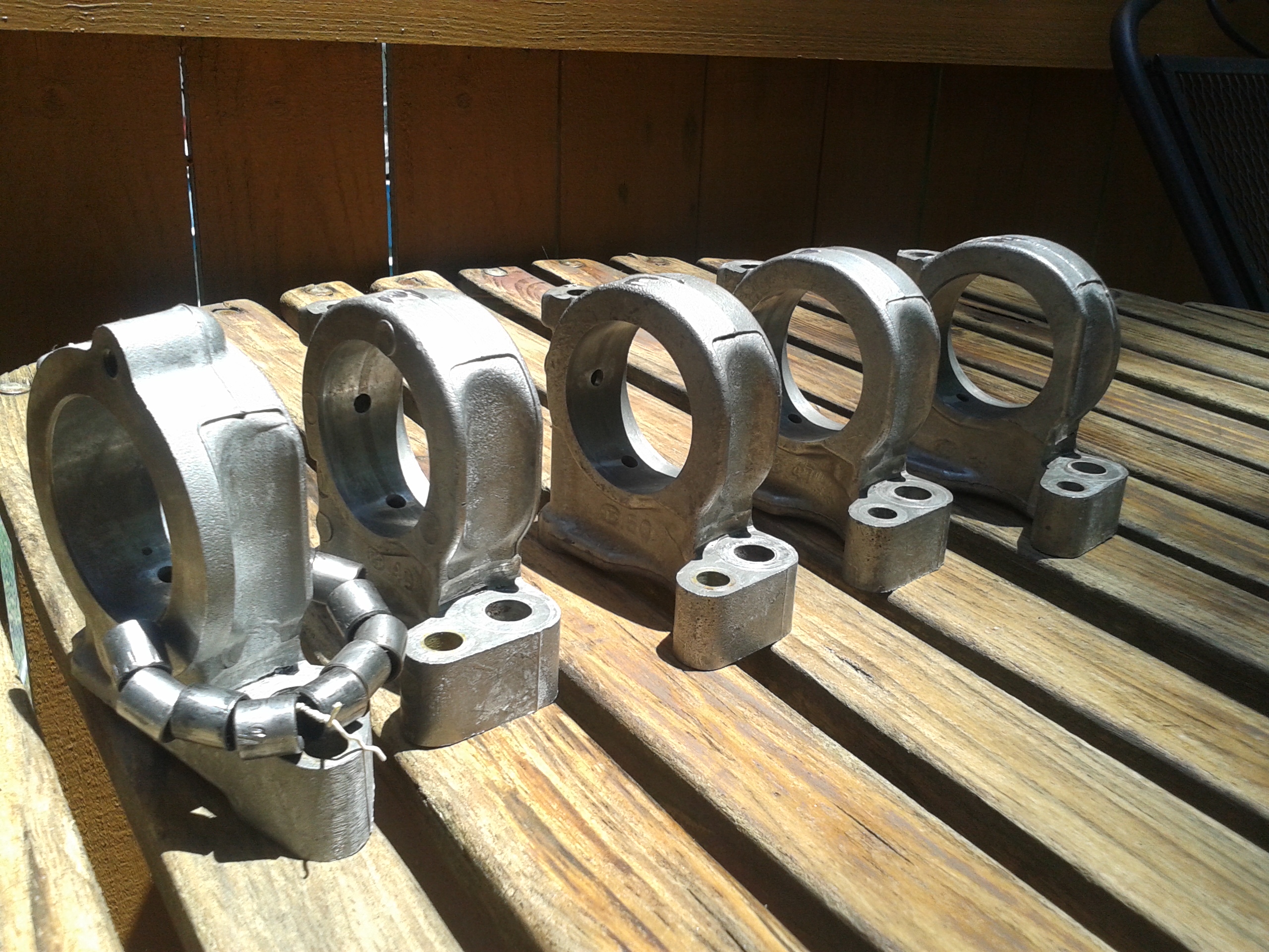

The first and last towers oil the cam. The middle three feed the spray bar.
I think without the spray bars restriction all the oil is coming out the first and last towers. It's too free flowing to come out the middle tower's holes, in my opinion.

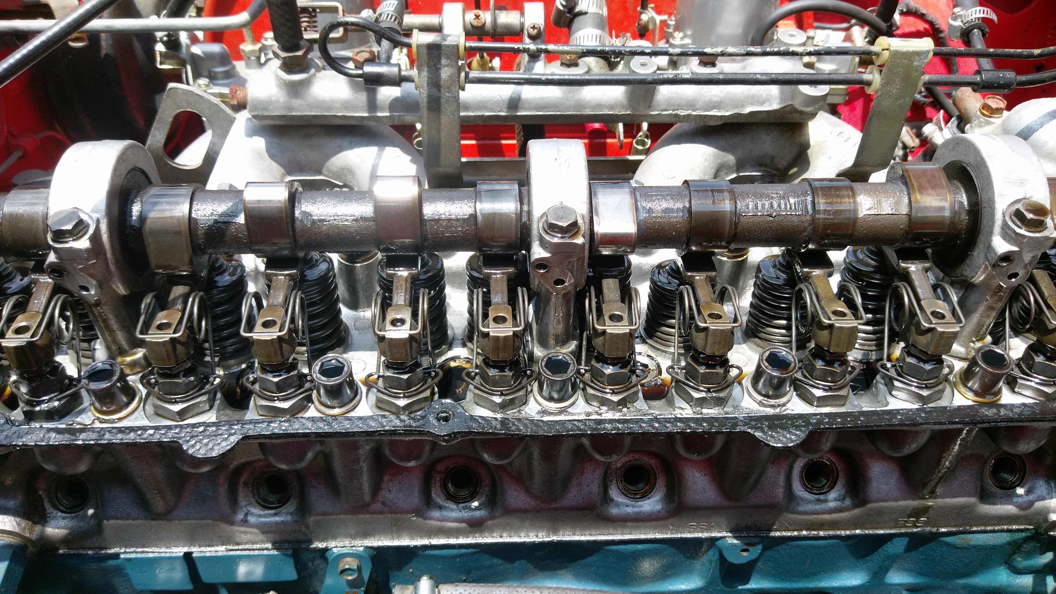

I am about 25 mins north east of baltimore in harford county. I also removed the oil filter and blew some compressed air back through the cam towers and the end ones had no back flow of air but the middle one did. I could see it go through to the cam main journal bit it felt different from the other towers. I might try and remove the cam and the middle tower and inspect it but at that point I might as well just pull the head ?. I am gonna order new rocker arms and lash pads, the cam is a given. I wonder if I should get new valve springs as well at least for the affected cylinders, not all the lobes are burnt. This is cyl 1.
