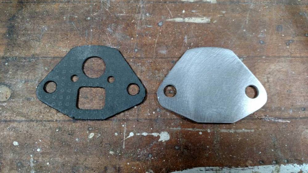

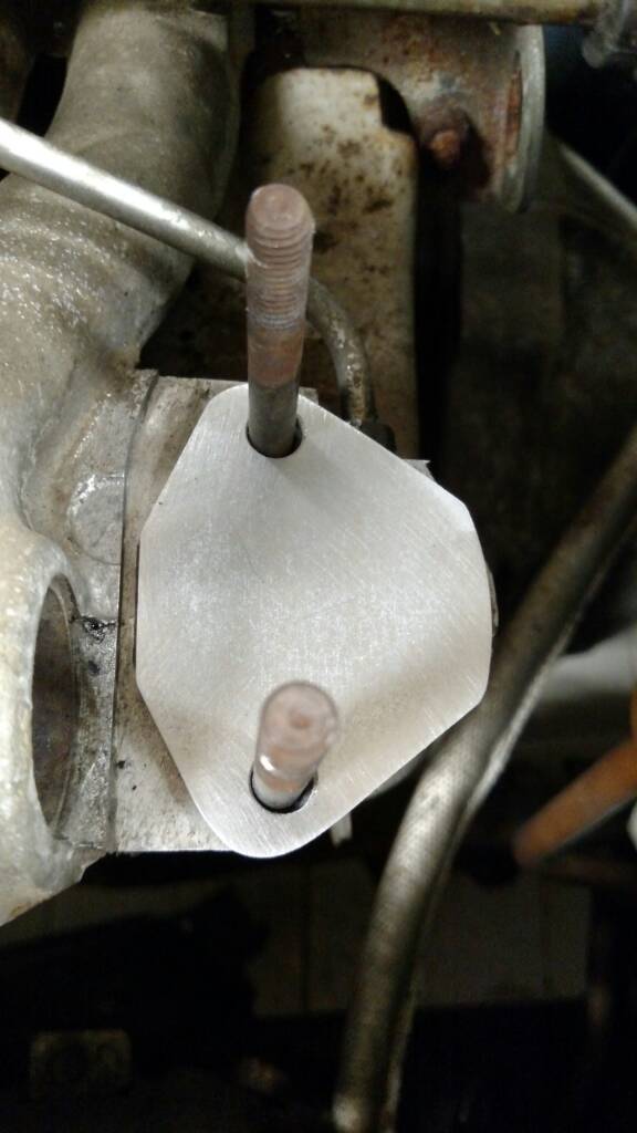

February 28, 20178 yr Author comment_513969 I picked up a gasket and made a block off plate for the EGR. I used a borrowed stud remover to try getting the studs out. But they wouldn't budge. Rather than break them off, I decided to just use the old EGR spacer on top of the block off plate.No change in running, vacuum reading, etc.I found the PCV hose under the intake. But I'll need double jointed elbows to get to the thing. I'll go at it from below on my next foray. But I ran out of time tonight.Sent from my XT1254 using Classic Zcar Club mobile Link to comment https://www.classiczcars.com/forums/topic/56998-engine-rough-running-at-wits-end/?&page=4#findComment-513969 Share on other sites More sharing options...

February 28, 20178 yr comment_513971 Don't install the plate until you examine the inside of the EGR passages. Â The problem that they have is that the metal between the two ports rots out. Â So your plate might not do anything. Â Stick your finger down there and make sure the metal is solid. Â The EGR valve is controlling flow from the round hole to the square hole, gasket-shape-wise. Â If the metal is solid, then focus on sealing the square hole. Â The round hole won't matter if you've sealed off the tube from the exhaust manifold. Â Link to comment https://www.classiczcars.com/forums/topic/56998-engine-rough-running-at-wits-end/?&page=4#findComment-513971 Share on other sites More sharing options...
February 28, 20178 yr comment_513972 Just now, siteunseen said: Â Pull the brake hose off and blow as hard as you can. Â I put my valve cover gasket on upside down, straight side to the passengers side:Â wrong, and when I blew into the hose my hair moved. You might try that and listen for the air. Hair only moves if you're a blowhard? Â Funny, but that test would probably work on the EGR system too, to see if the passages and valve are okay. Link to comment https://www.classiczcars.com/forums/topic/56998-engine-rough-running-at-wits-end/?&page=4#findComment-513972 Share on other sites More sharing options...

February 28, 20178 yr comment_513976 Out of interest, did you try the double nut technique to remove the studs? Â That is what worked for me when I did a lot of manifold work 3 or 4 years ago. Â I did have the advantage of the manifold off the car though. Â Wanted to replace the studs with ss bolts for a cleaner look with the block off plate. Best of luck on your low vacuum issue. Â Will be interesting to know what the ignition timing is currently at, Â when you get to that Link to comment https://www.classiczcars.com/forums/topic/56998-engine-rough-running-at-wits-end/?&page=4#findComment-513976 Share on other sites More sharing options...

February 28, 20178 yr Author comment_513995 I did the yogurt cup test months ago. It would build pressure as it should. But it would probably be a good idea to repeat it. I checked the web between the intake and exhaust ports for the EGR. It's solid. I was careful to clean the surface of the intake manifold so the new gasket wouldn't leak. I did not plug the pipe from the exhaust. So I wanted to make sure neither side would leak. I tried double nutting the studs. But this required using an open end wrench to loosen them, which put a lot of bending on them. The extractor I borrowed uses cam driven rollers to grip the stud all around. I put a big ratchet handle on it and pulled pretty hard to the point where I think I yielded the studs a bit. In another thread I detailed my ordeal with snapped fuel injector screws. Rather than break these, I used the EGR spacer to let me put nuts on the existing studs. At some point I'll use heat to get them loose. But I'm moving on for now. Timing is 10 deg. BTDC at idle. Vacuum advance seems to be working. But working alone I can't reliably correlate rpm and timing.  Sent from my XT1254 using Classic Zcar Club mobile           Edited February 28, 20178 yr by the_tool_man Link to comment https://www.classiczcars.com/forums/topic/56998-engine-rough-running-at-wits-end/?&page=4#findComment-513995 Share on other sites More sharing options...

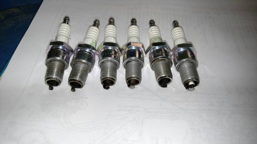

March 1, 20178 yr Author comment_514066 I got one end of the PCV hose loose, so I could give it a good inspection. No apparent issues. I've come up with a plan to use smoke to look for vacuum leaks. But I couldn't do that until a friend brings me his fog machine. So tonight I did a compression test. After warm-up: 1:152psi 2:152psi 3:158psi 4:155psi 5:155psi 6:150psi An 8psi range (5℅) seems pretty good. Here's a pic of the plugs (in order 1-6 left to right): They probably have about fifteen minutes of total run time on them. No time for more than that. So I put everything back together and checked the firing order for the fourth time. Of course there's always something that goes wrong. I have no fuel pressure now. Not sure how since I didn't touch the fuel pump circuit. Sent from my XT1254 using Classic Zcar Club mobile     Edited March 1, 20178 yr by the_tool_man Link to comment https://www.classiczcars.com/forums/topic/56998-engine-rough-running-at-wits-end/?&page=4#findComment-514066 Share on other sites More sharing options...
