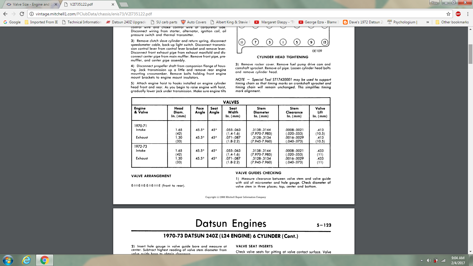

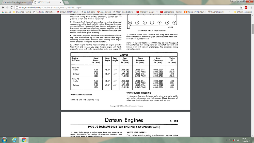

Would it be possible for someone to measure one intake valve and one exhaust valve.  I would like the stem diameter, the overall length and the valve head diameter.
13201-A1100 intake
13202-N0401 exhaust
https://www.classiczcars.com/forums/topic/56990-valve-size/
The dimensions are also in the FSM's, by car and year.  Same info that site provided though.  How many people are going to have some valves, out of the head and available to measure, for which they know the part numbers?
