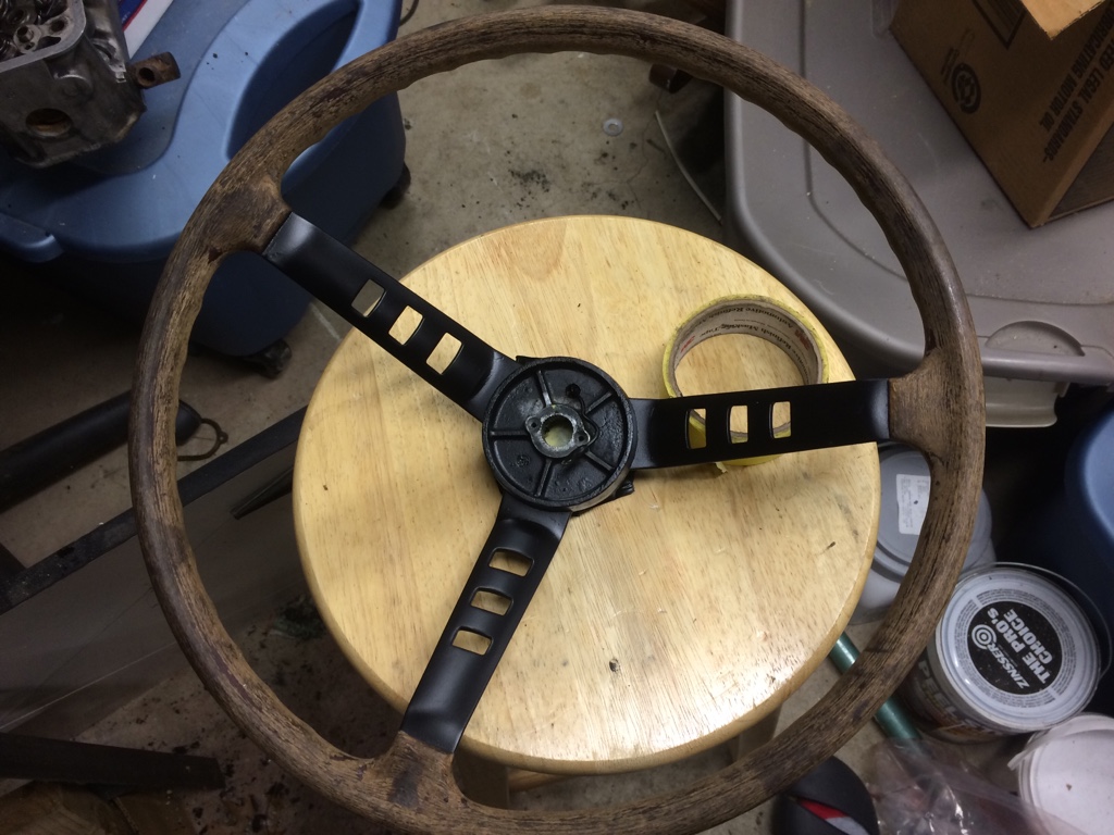

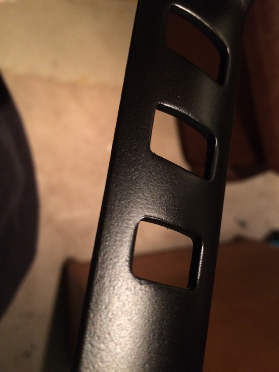

May 8, 20178 yr Author comment_520267 Threw some engine paint on the wheel... I will stain it tomorrow.Sent from my iPhone using Classic Zcar Club mobile Link to comment https://www.classiczcars.com/forums/topic/56981-240z-restomod/?&page=5#findComment-520267 Share on other sites More sharing options...

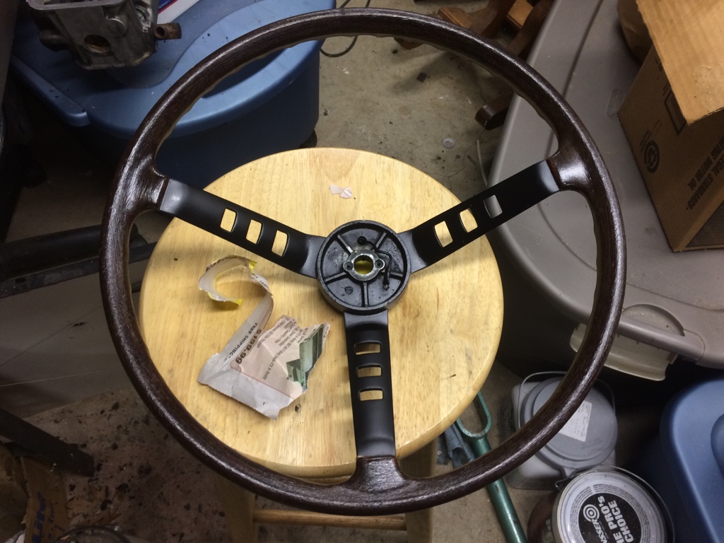

May 8, 20178 yr Author comment_520344 Steering wheel is finished!Sent from my iPhone using Classic Zcar Club mobile Link to comment https://www.classiczcars.com/forums/topic/56981-240z-restomod/?&page=5#findComment-520344 Share on other sites More sharing options...
