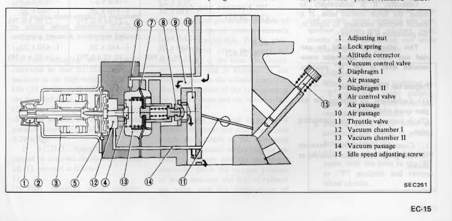

1 hour ago, Captain Obvious said:
So some points of interest...
The further run in the adjustment screw on the bottom, the easier it is to lift #9 off it's seat. That's why the BCDD will operate at a lower vacuum.
When the solenoid is energized (and the pin is retracted) this defeats build up of vacuum in chamber #17. This is because vacuum pulled into chamber #17 from the intake manifold side is just bled off by pulling in air from the upstream side of the throttle body. In order to enable the BCDD, they block the bleed passage on the upstream side of #17 and allow the vacuum from the intake manifold to build up in chamber #17. If that vacuum gets high enough, it will lift the plunger off it's seat.
Keep in mind that I didn't design the thing, but that's my read.  :)
So if the pin is retracted, in it's normal position with the key On (the click you hear when you turn the key On) and at a stop, you would expect a small amount of air to bypass the blade.  But that extra air is normally present and baked in to idle speed adjustment.  If the wire is disconnected the pin blocks the passage and idle speed should drop a small amount since that extra air is gone.  Does that follow?  I should be able to go out and disconnect the power wire and see a drop in idle speed.
If you have an idle, at a stop, that's stuck high, it seems to also follow that it's probably the main air bypass, designated by the arrows in the picture, that is stuck open allowing air through.  Or a hole in a diaphragm, or the main valve n the BCDD is stuck.
Seems like there are two normal ways for air to get through the BCDD, the little control passage and the main bypass passage, and one abnormal way, a hole.  I've never thought the idle hanging problem through completely, I just refer to what other people said.

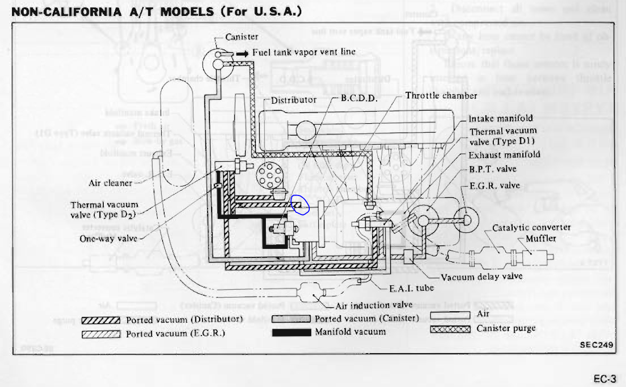

If the 79 turns out to be bad I'm going to try and use the 80. Ideally, I'd like to leave the BCCD functioning and since it works internally I'm going to cap 4 of the 5 vacuum sources as I'm not going to be running any of it (except the Distributor ported vacuum) .

This is from the 80 Emissions section. Going to cap all the hoses but the blue circle:

That's one of those interesting things.  They stopped using the solenoid in 1980.   Looks like they only referenced one side of the blade also.  A new puzzle.
In 1981 they put the BCDD on the bottom of the intake manifold.  Seems like they never quite got it where they liked it.  Some designs last for years,like the AAR.
This is the problem with the BCDD - you can get drawn in and spend a lot of time here, for little value.  Like eating celery.
