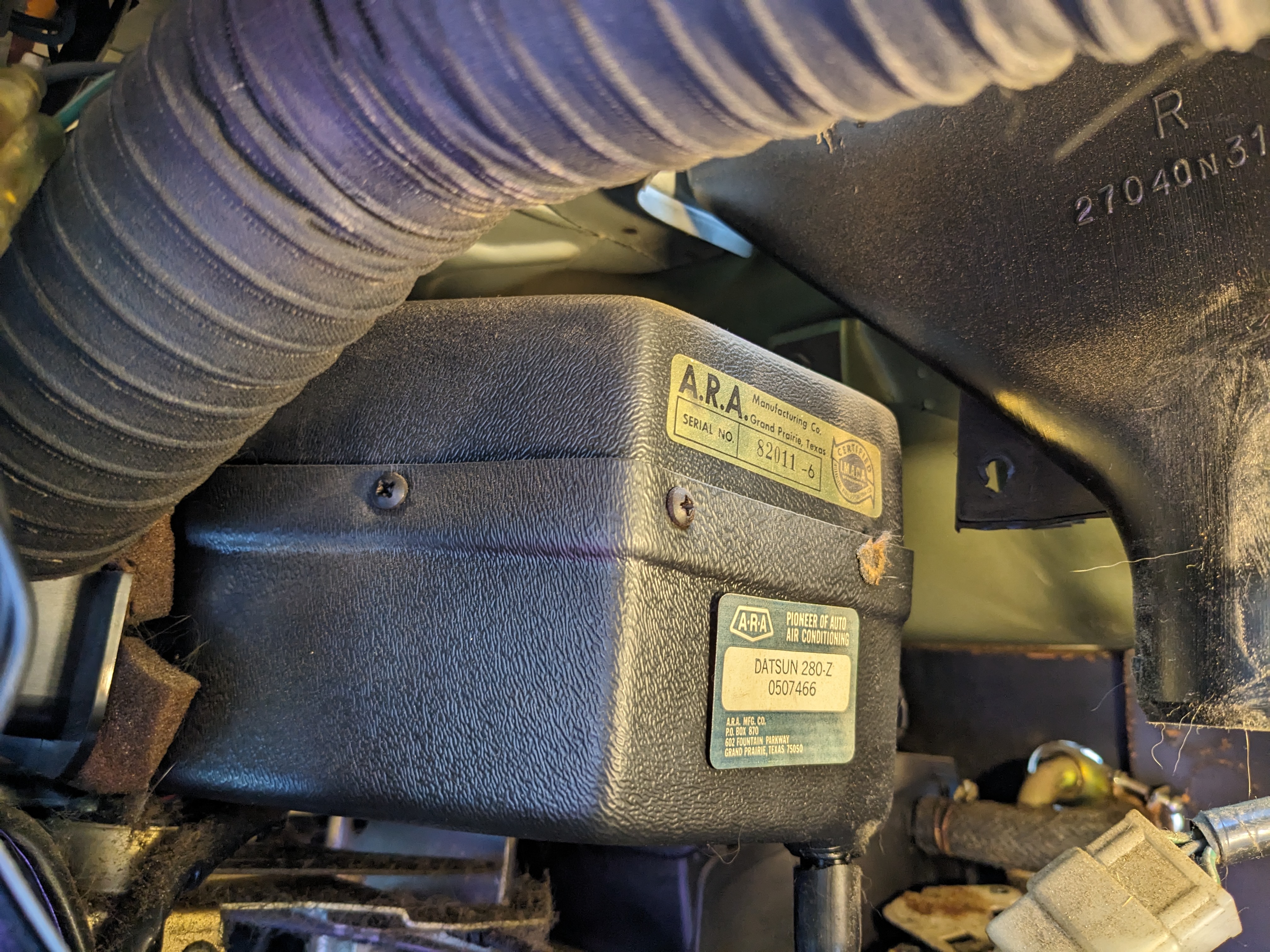

 does this entire box attach to the one in your picture where the foam seal is located

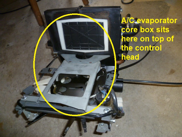

Yes. This whole box:
Goes here:
Now... Since your car came from the factory without A/C, there is supposed to be a simple hollow duct box sitting there, but I don't know what they did for your aftermarket A/C.
Thank you - those make it very clear. I am thinking of buying a used factory AC box with evaporator, since every other part of the dealer AC install is sloppy, I can't imagine the evaporator install is any better. The issue there would be dealing with the factory line fittings. I have no idea if they are standard or some funky metric size/version fittings that will be difficult to find.

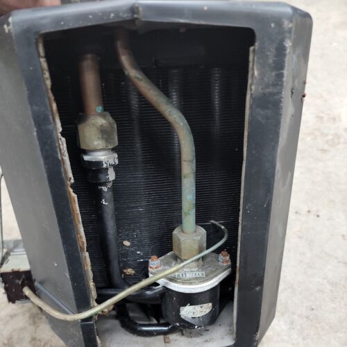

Thank you for the offer. I think what I would need to explore this are the OD and thread pitch of the Male fitting and the ID of the Female fitting, where the lines exit the firewall, and the two male fittings on the Evaporator itself - if that's what you have handy. I took this image from the eBay listing. I need to establish if they are all metric or standard.
Judging from the other pics, the line fittings are flared (JIC perhaps?), which is not standard for any US type o-ring style fitting (MIOR, MOR, FIOR, FOR, etc.,)
This may not be worth the effort if I have to make lines that go into the casing to attach. I don't see any way to convert the outer fittings to o-ring style, unless someone sells repair ends that can be silver soldered to the existing hardlines. There are standard (#6, #8, #10) male & female flare beadlock fittings, but they will definitely be SAE thread, not metric.

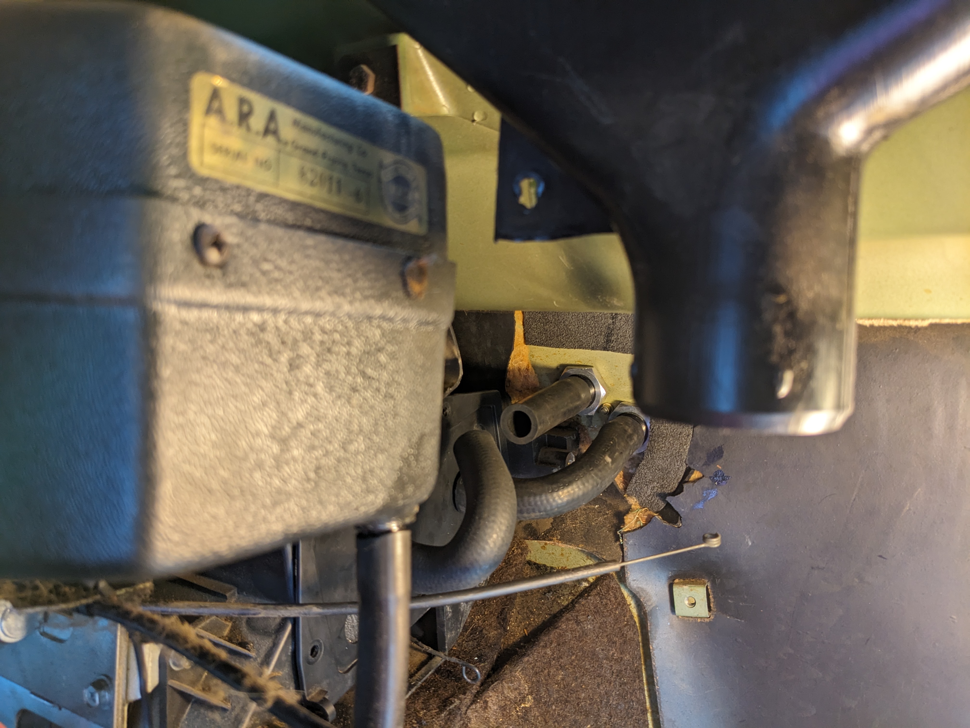

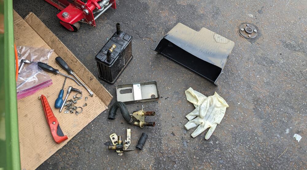

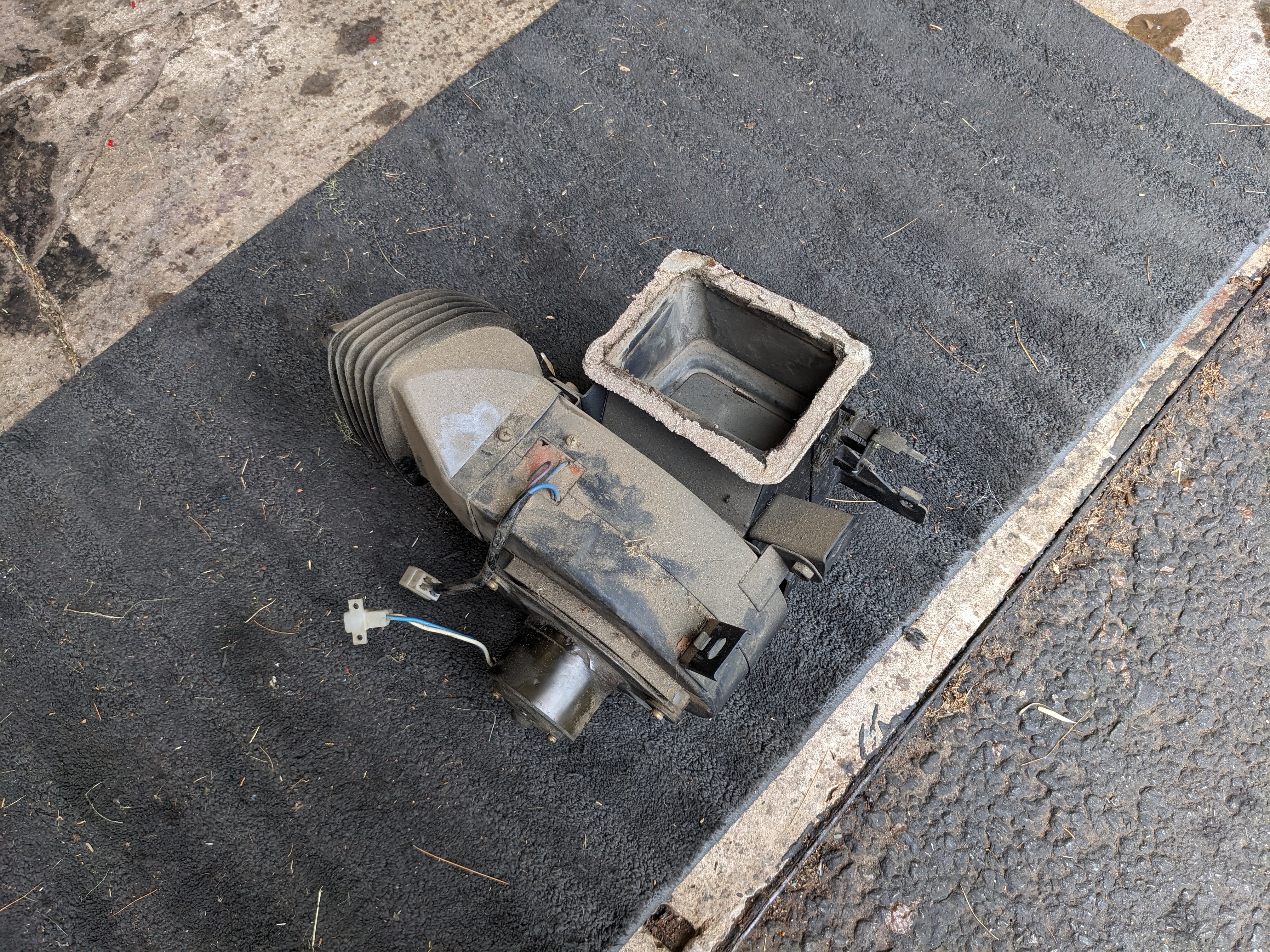

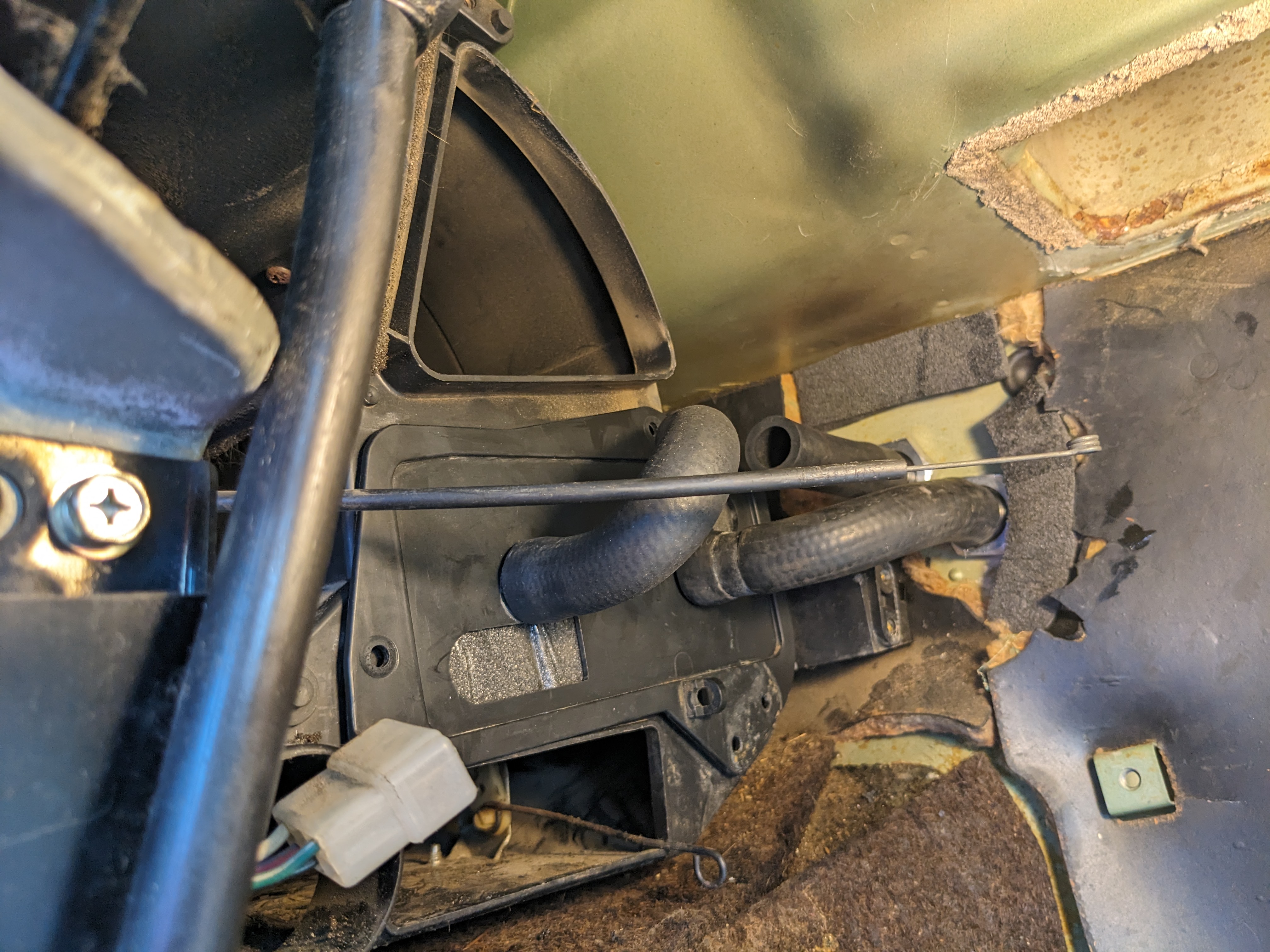

Took out the glovebox today, so I could see what's back there regarding the heater & AC
pulled the blower housing, made it very easy to access all the heater hoses. Needs a good clean anyway.

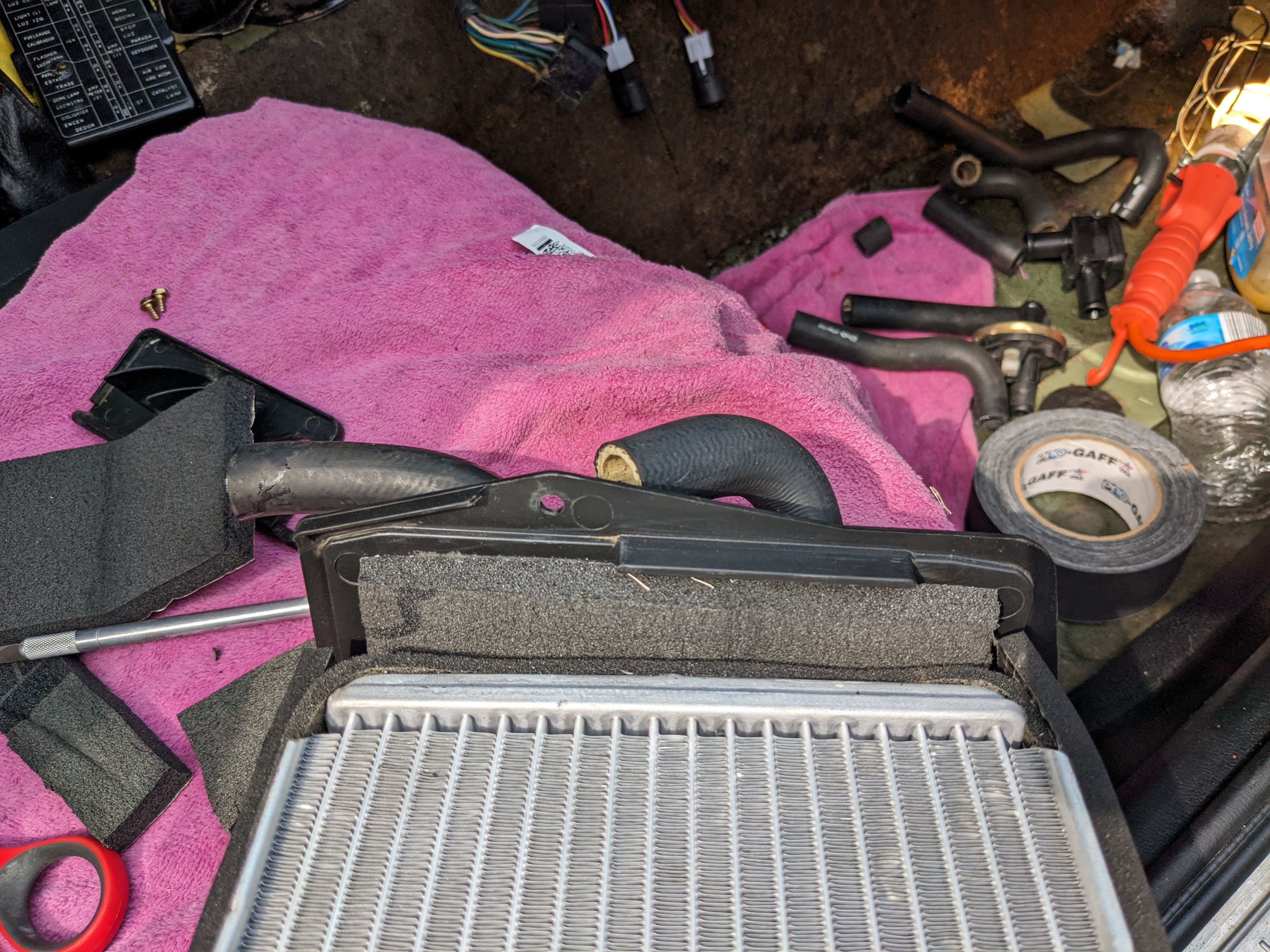

Heater core out.

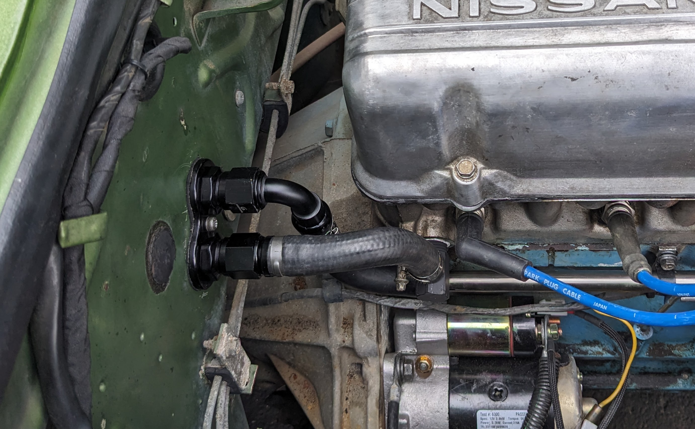

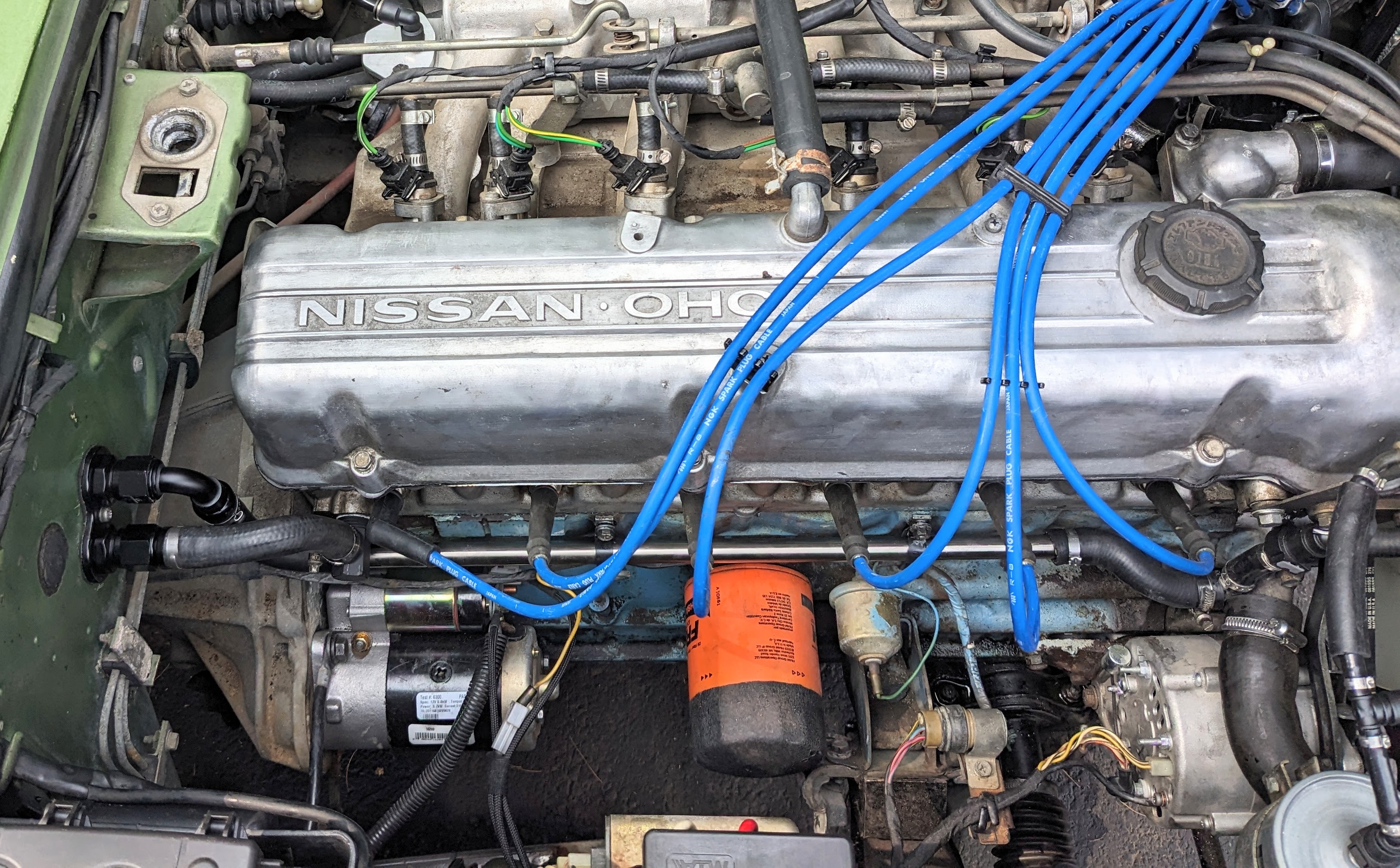

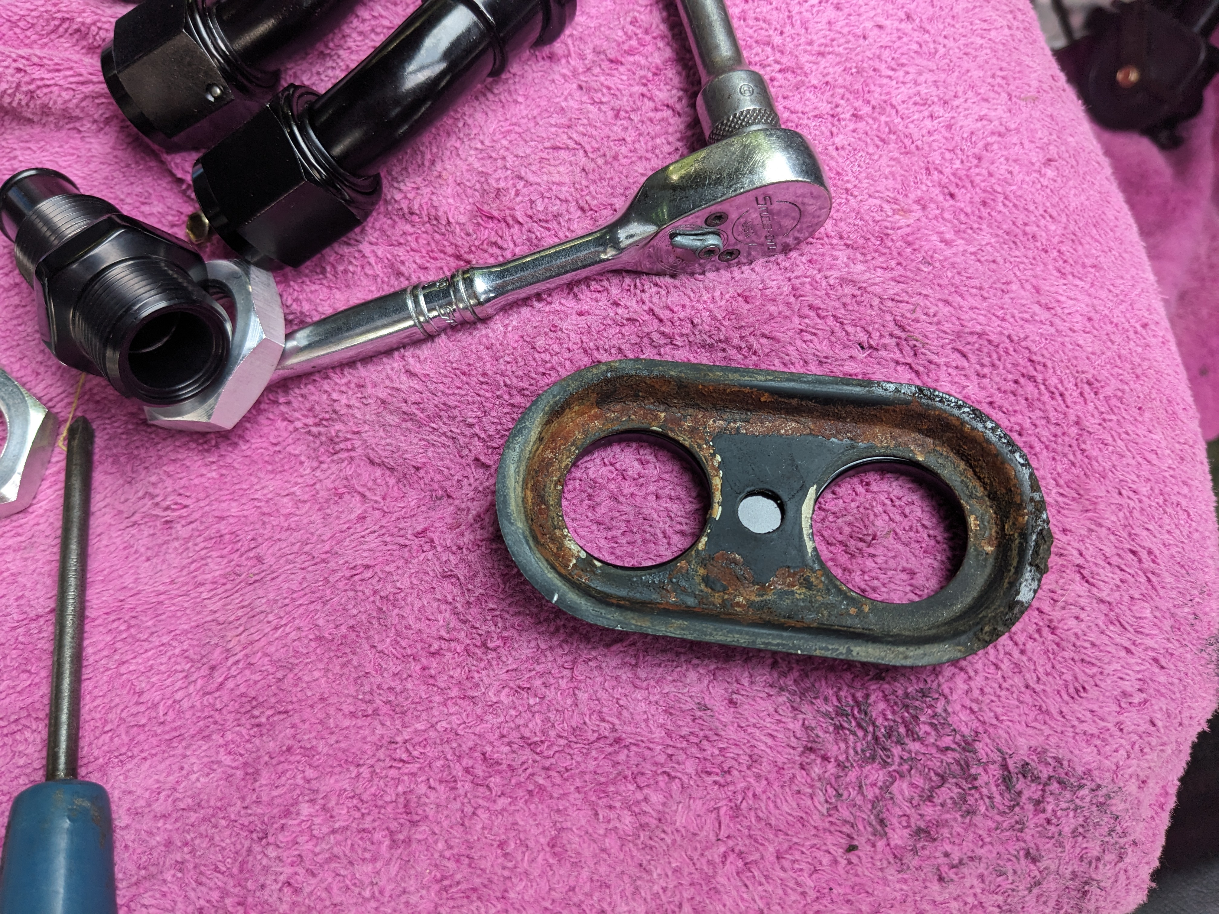

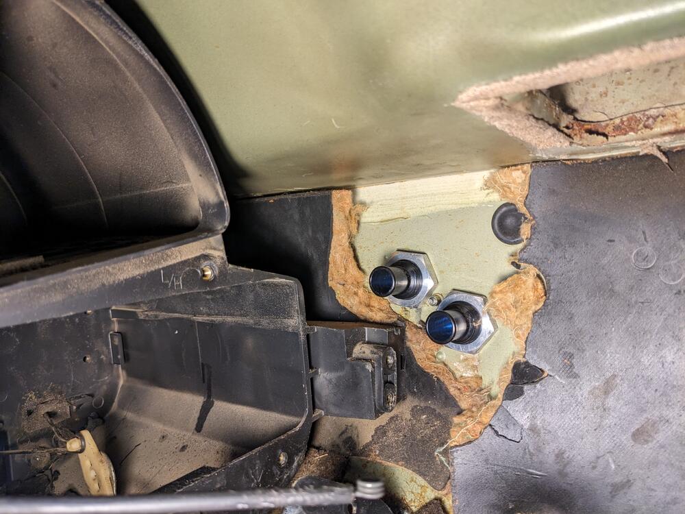

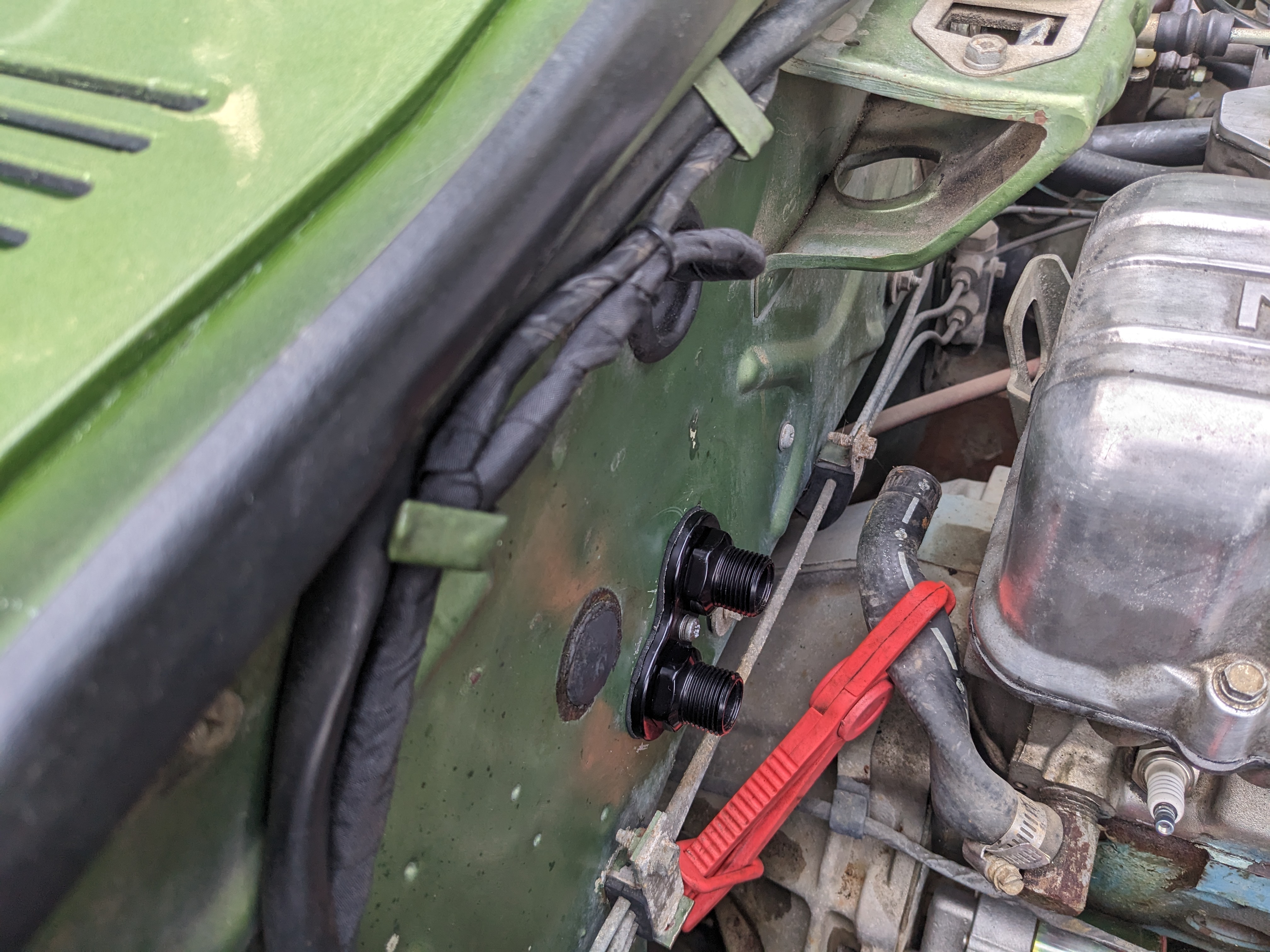

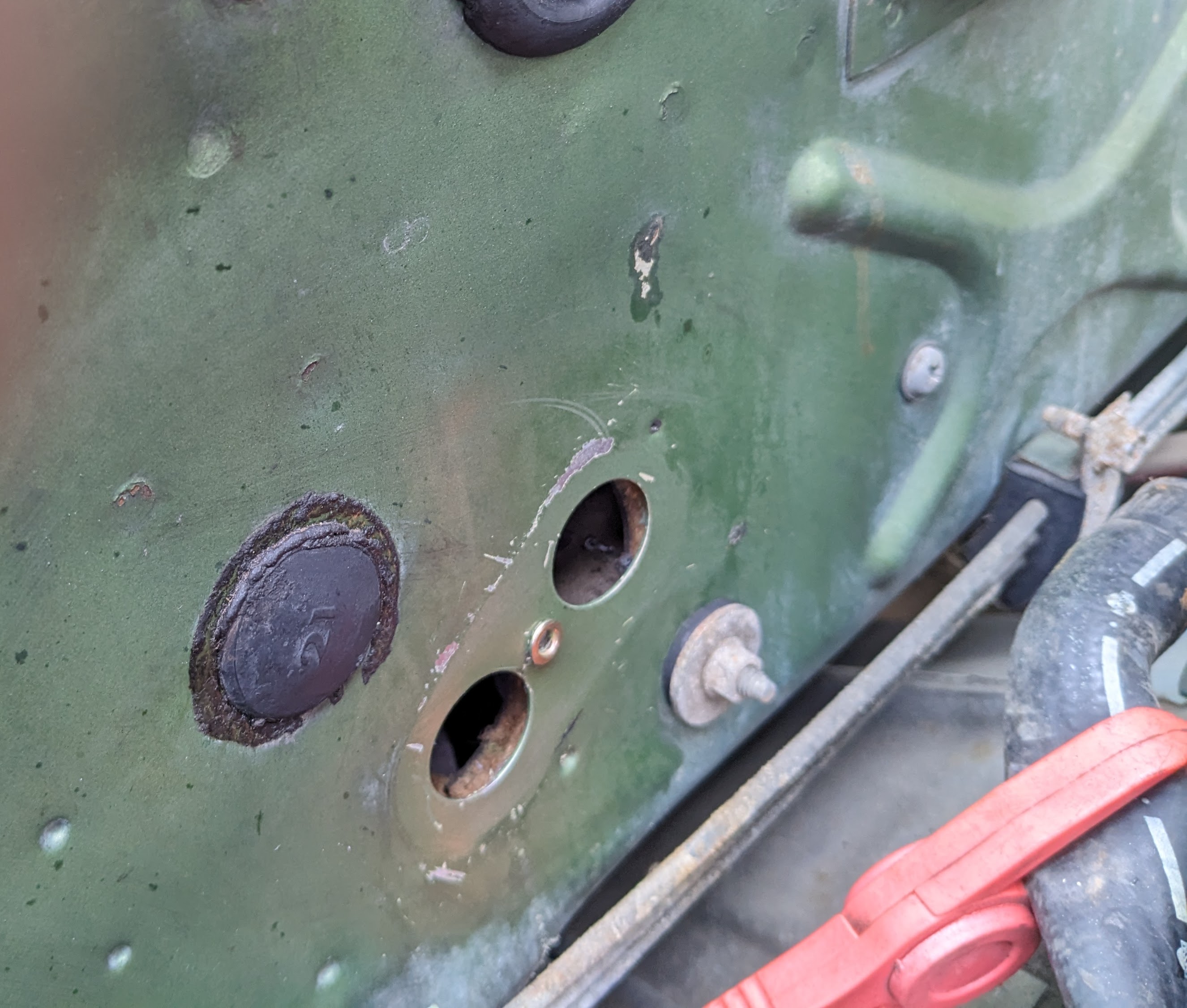

bulkhead fitting removed, M4 rivnut in place to retain the AN line fitting
turns out the aluminum bracket/fitting has identical spacing to factory, makes things easier. Just have to drill the center hole to match the factory cover plate shown
All kinds of crusty 'plastic' laying in the box - it seems the heater core end tanks were encased in it

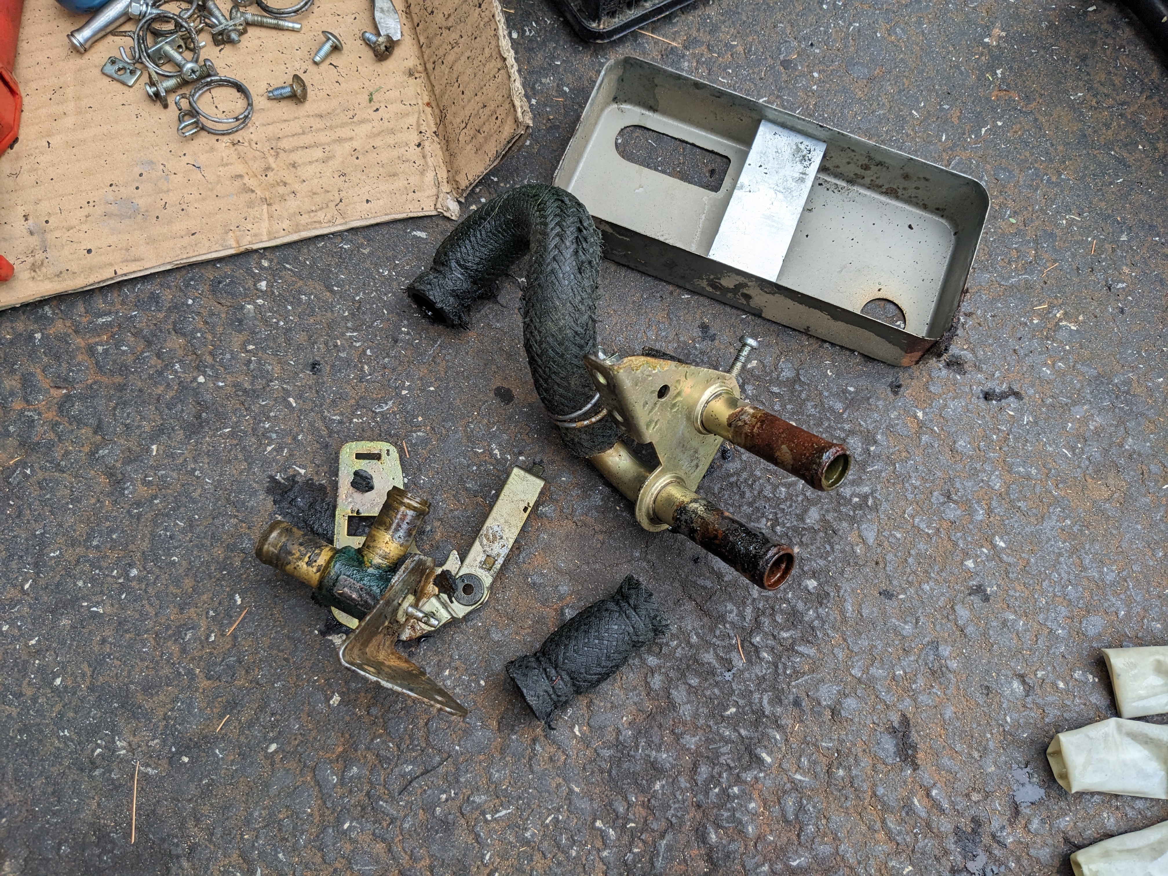

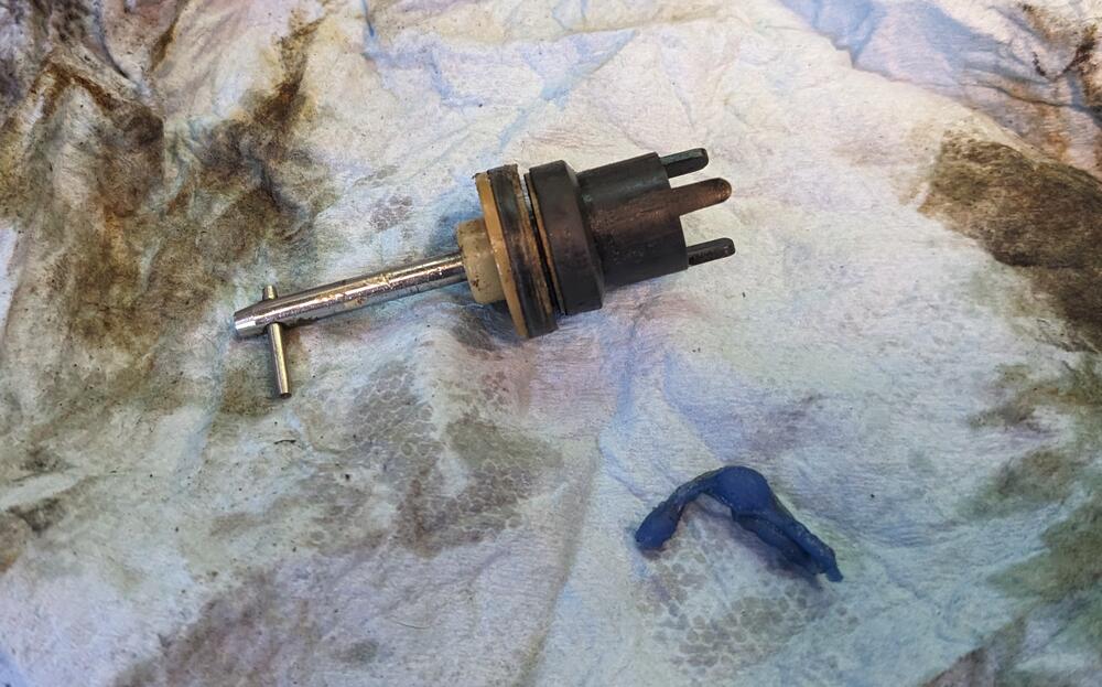

So to continue with my version using the '91-02 Ford Escort heater core (thanks Capt. Obvious!) I ordered the heater valve mentioned by another -4 Seasons 74627 - but it didn't arrive until late this evening, so I dismantled the original & had a go at fixing it following the other thread
Think it's pretty clear why the heat never shut off - large chunk of silicone wedged in there
I forgot to take pics of the re-assembly, I used a Viton o-ring in place of the square cut outer seal, I left the inner one alone. Left it set on an angle filled with fluid to check for leaks.
This is what my phone screen looks like (actually worse now, it's all dark) - so my pics are hit & miss

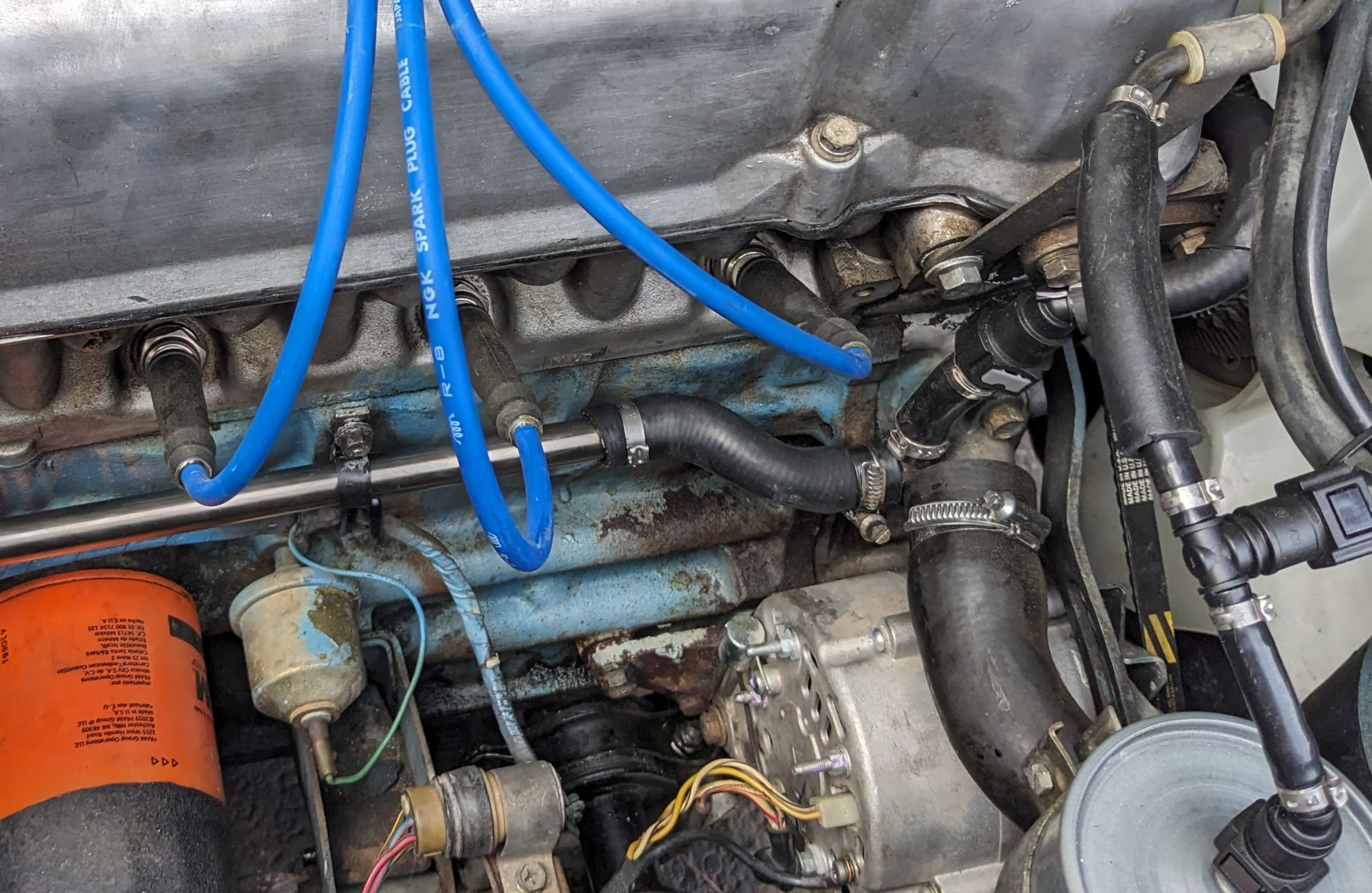

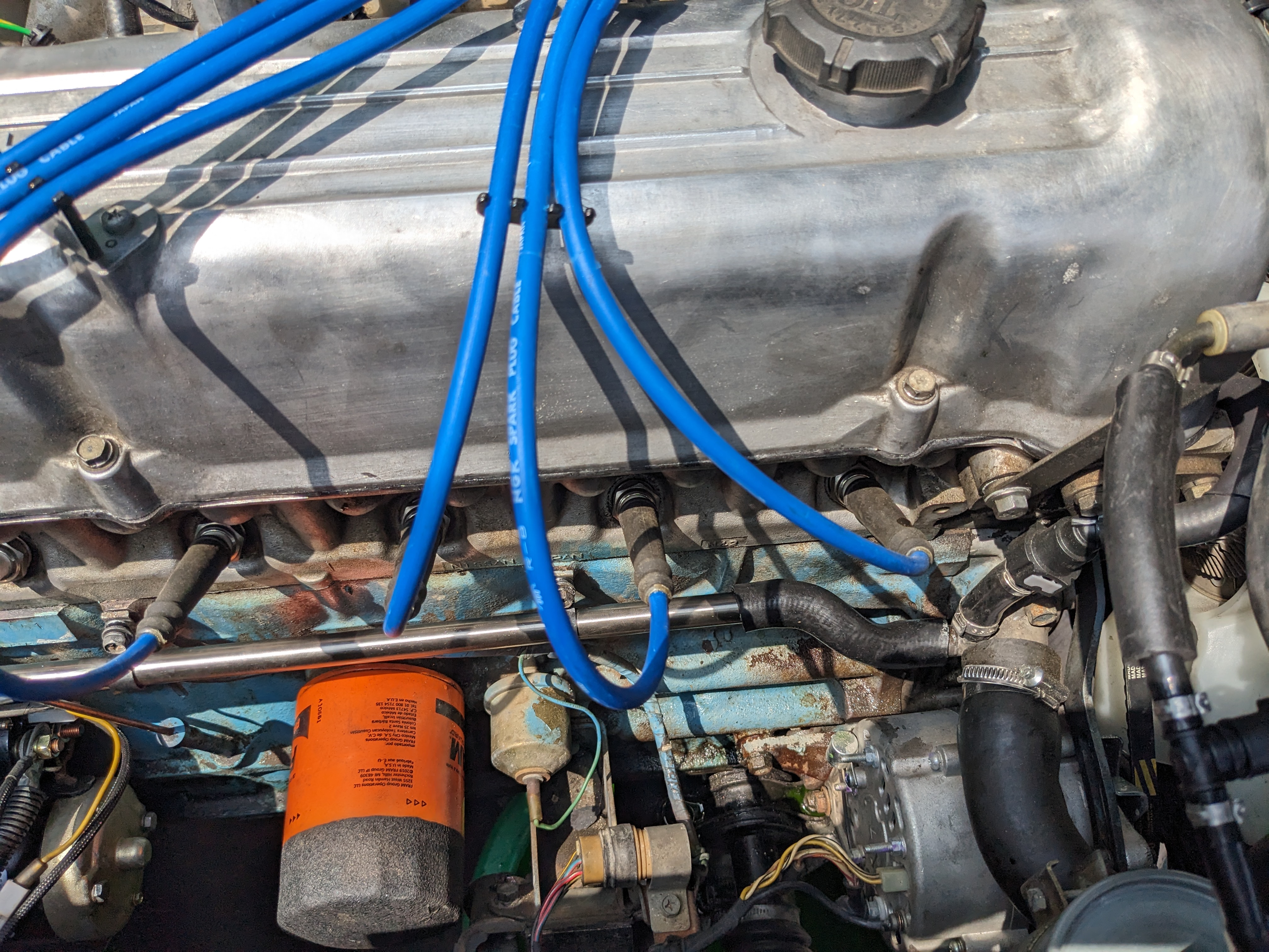

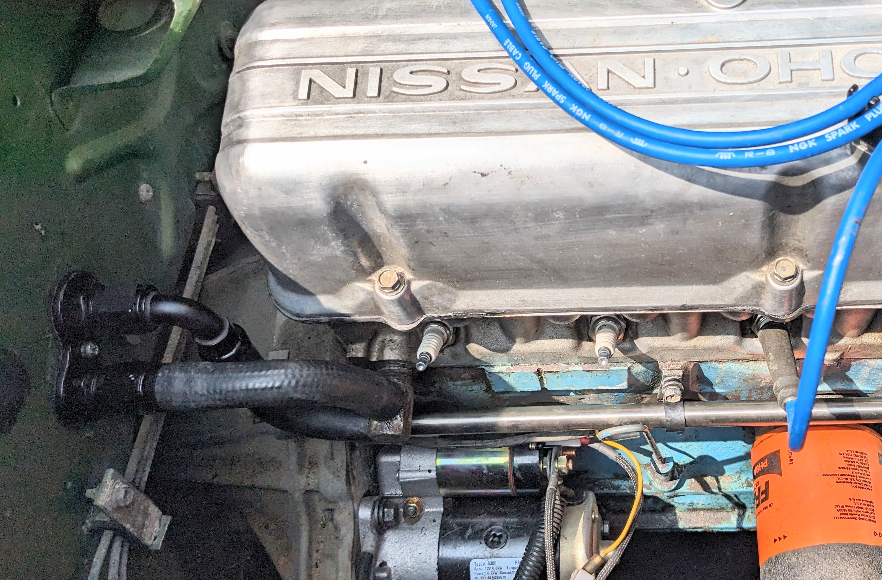

I flipped the I/O for the heater hoses - the bulkhead upper is now the return & the outer/lower is the feed. I did it this way so that the feed is not too short, and the return is a straighter run. and so the inside feed is a plain elbow 90º.  Determining hose lengths (cut from Volvo 700 formed hoses) here. SS tubing is 20.5".
dogleg for the other end, test fit alignment of pipe & hoses
Hoses cut & clamped (head fitting was removed, de-rusted, sealed & reinstalled, slight offset change -more vertical
Far end adjusted & clamped

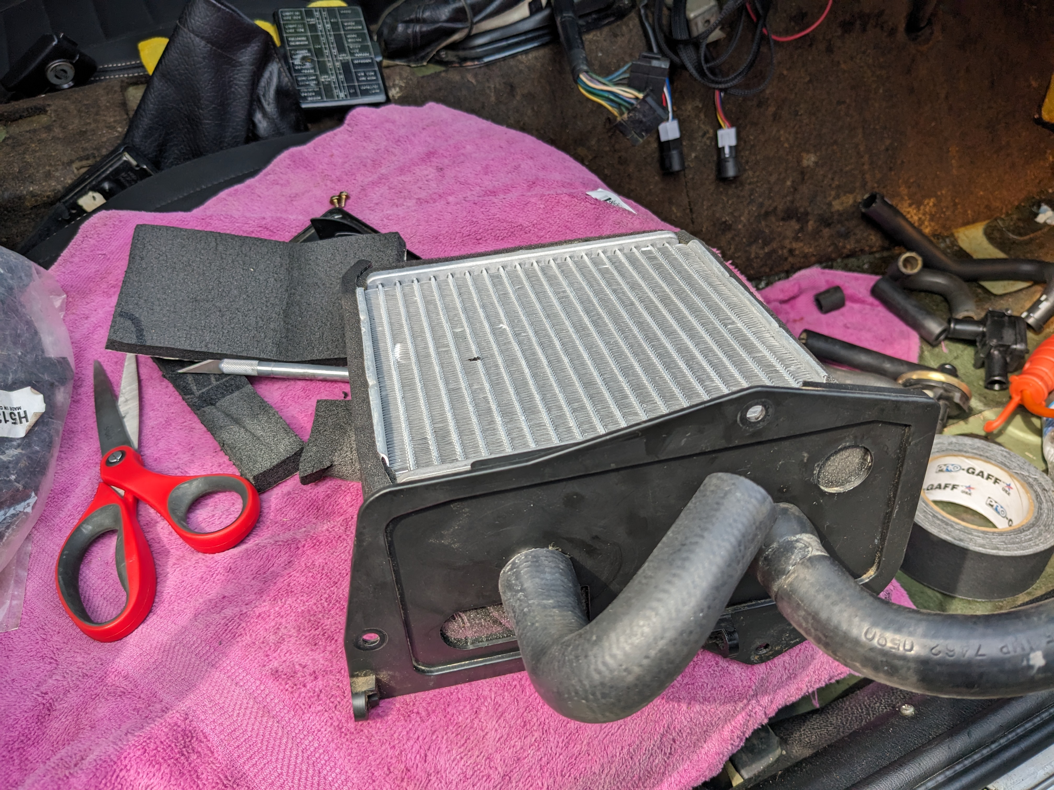

With that end out of the way, I returned to the heater valve & core. Eyeballed holes for core pipes, based on the core being centered. Added closed cell foam on the sides to make it snug, and to the front to keep it pushed all the way in & cover up the old pipe holes.
Was playing with hose routing - this way was to allow the 74627 straight pipe valve to sit above the feed pipe
along these lines
I'll revert to this layout if I need to switch to the 74627 valve

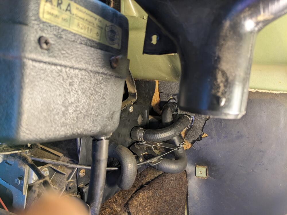

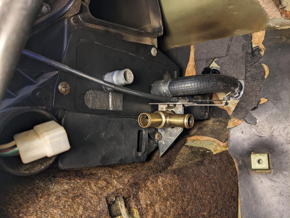

When it became clear that the 74627 wasn't coming , I switched gears & worked on fitting the original repaired valve -

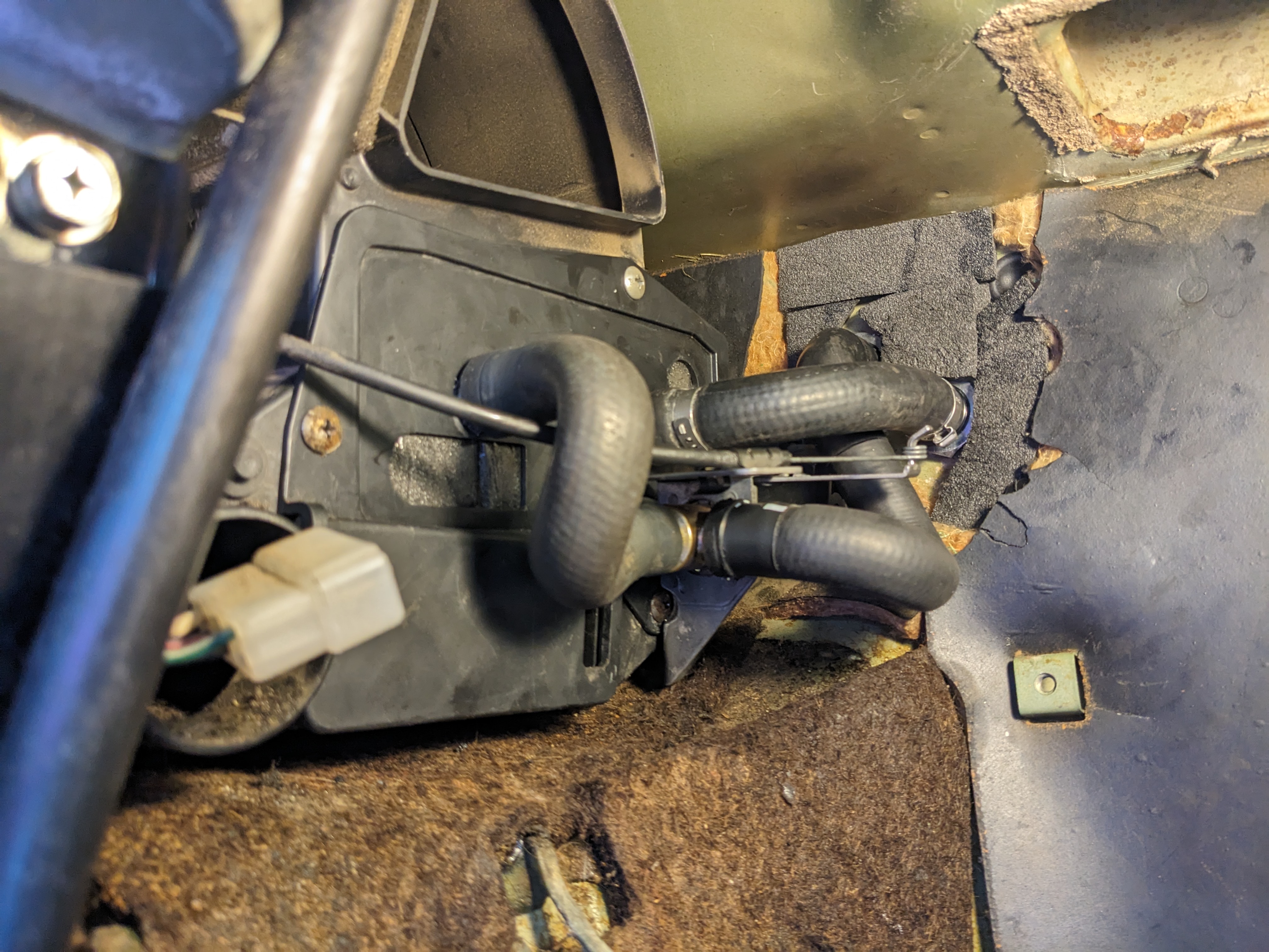

Heater valve fitted using the upper existing mount screw, new hole drilled in plate. Cut a notch in the valve mount bracket to clear the lower screw. Checked that flap can open.
Feed hose clamped. Cable attached & function tested.
Test fitting (formed, Volvo) hoses to & from heater valve
Added oetiker clamps after this. Since I wasn't able to flare the end of the core tubing, I prefer them as the clamping is typically more uniform than a worm clamp of any type.
Edited by HusseinHolland
remove excess pic
Have to switch out the stock valve - it doesn't completely close - the hoses are still mildly warm, so coolant is still passing. Not going to work for me, will interfere with working AC once I get to that.
