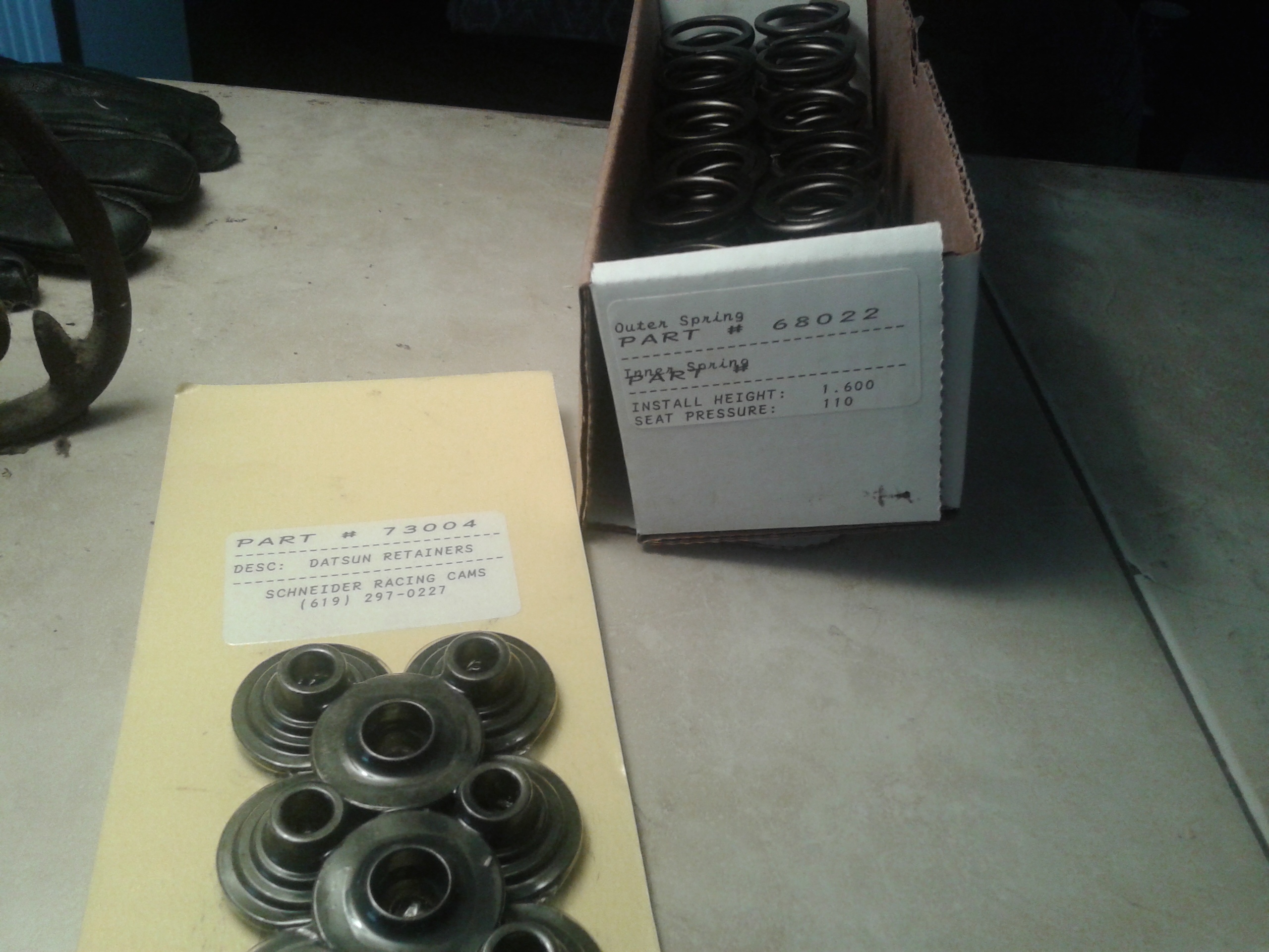

I'll order up a set. Can't hurt. I got a tool to remove the retainer. So I'll do that and just try maybe putting the Schneider spring/retainer on that valve just to try it. Also I'll look for any signs of the guide/valve being messed up.
1 minute ago, siteunseen said:
Those are for a big cam, Schneider 270-90F, so not stock pressure springs.
Retainers back in 2/'15, $77.95 for 12
springs, $96.99 for 12
Yeah, I have a American Custom Cam 500/300 cam. So upgrading certainly won't hurt. Looks like the prices haven't really changed.
I suppose you do not have a build sheet with the springs they used.
Did you notice if the cam towers have been shimmed and if the springs were shimmed to match?
Weather you call Schneider or Isky, either is good, tell them your cam and get their opinion if that cam is even usable for the street.
It would be interesting what they say. Also let them recommend a spring. Do not just buy some yourself and guess.

I wish I had a build sheet. I don't even know the bore of the engine.
I don't see that the towers have been shimmed. Looks like the bolt right down onto the head.
I just sent an email to Schneider to confirm what springs to use. I did order the above parts today, but they won't ship til Monday.
Schneider confirmed that the 68022 springs are correct for my application. I also had to order a differnt spring removal tool as the one I had wasn’t working.
Edited by blodi
