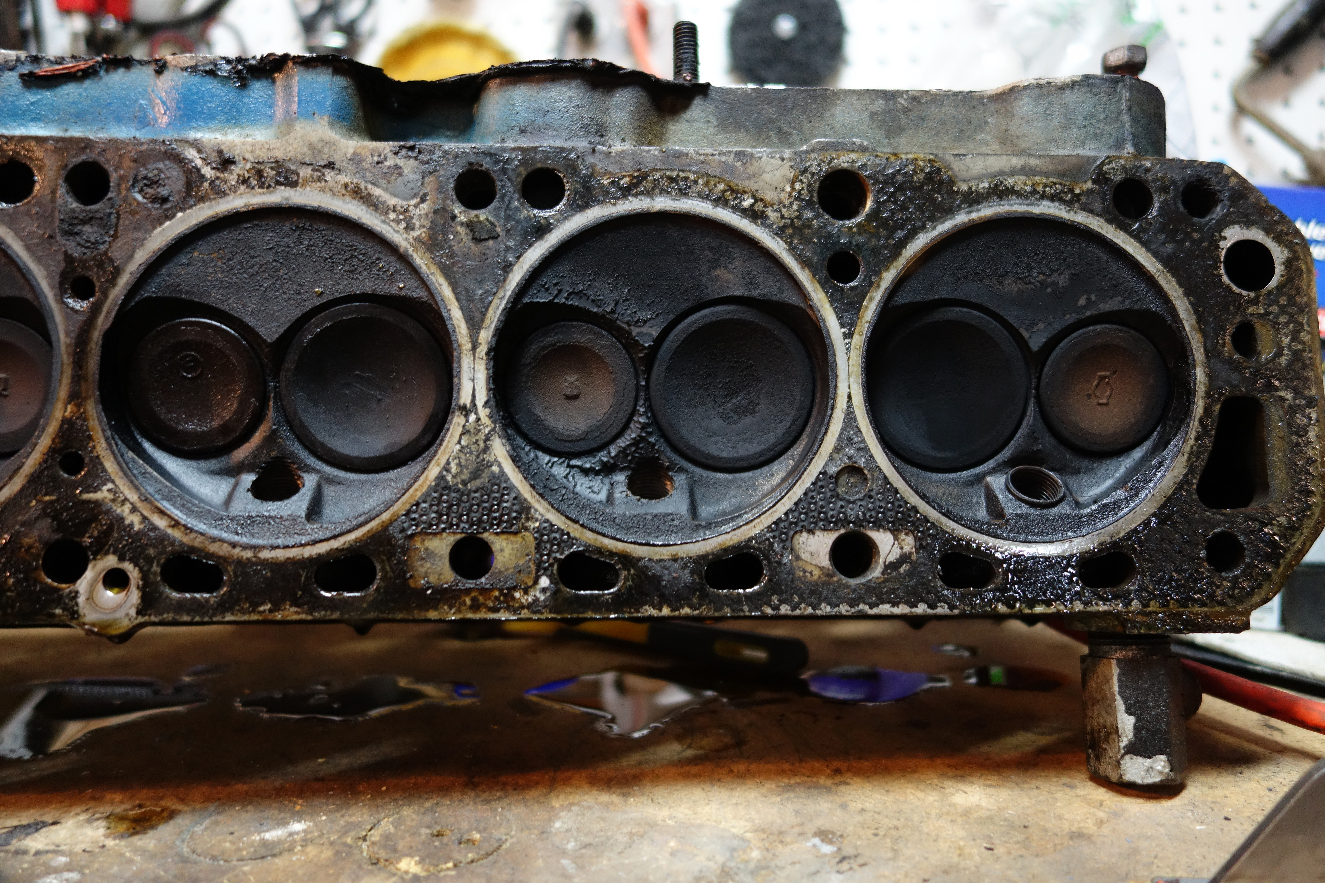

On October 6, 2016 at 2:02 PM, Jeff G 78 said:
Is that corrosion/rot in the #1 chamber between the valves?  I can't tell what I'm seeing.
I guess the dowels were keeping it stuck...
No, not corrosion/rot because it comes off.  I'll guess that maybe it's varnish?  I have run some CRC one tank on occasion and maybe that was some carbon or whatever that was peeling off?  I can't say for sure because the head is in the shop. Looks like something got soaked and wasn't all the way off yet.
I had the same leak.  Also sealed up as the engine got warm.  Interestingly, the head was bowed up in the middle, not the end where the leak was.  Also broke a head bolt and used vice-grips and PB Blaster soaking to get it out.  Very difficult though, it was rusted in.  There was actually a small hill of rust around the bolt stub after I removed the head.
That is a Helicoil.  I discovered it the first time I changed spark plugs and it came out with the plug.  I about crapped when that happened because I had never seen one before. I've since used Thread lock to help hold it in.
