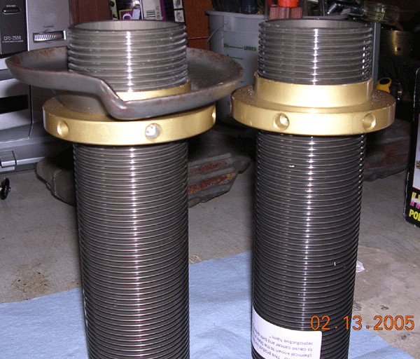

Sounds lik a job for these! I adapted them to take stock and direct aftermarket springs so that I can figure out my ride height and move the perces on another set of struts to coinside-and appear authentic!

So as not to hijack this thread, check out this link(the last post), an dPM me with questions!
http://www.classiczcars.com/forums/showthread.php?t=16361&page=2&pp=15
Will
