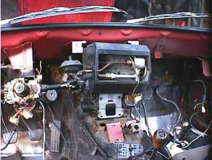

Check out a video of a guy installing a vintage air evap. Notice he drilled holes up into the cowl where water can leak through. He also had to fab a bracket for
the bottom. It's not a plug n play system. https://youtu.be/QDksgw4MVIo

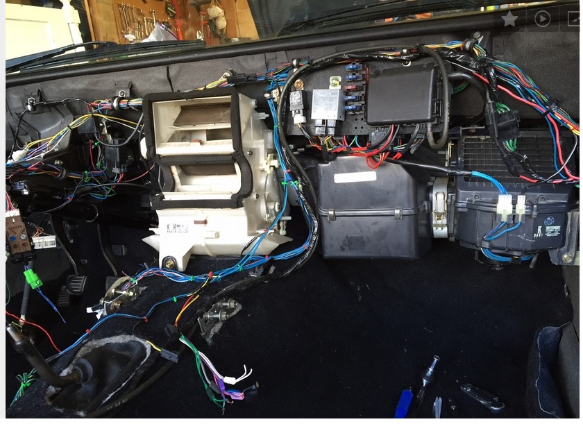

Not sure if you've seen this or how much help it'll be, but here's a guy on HybridZ that put in the HVAC from a Miata.  If you give a mouse a cookie... http://forums.hybridz.org/topic/124965-frankenterior/
Really like how this miata system appears to fit. Other issues are,  can the 240z cable system be adapted to it and how does it fit with a 240z dash over it?
And, can you integrate the fresh air duct in the cowl into the fan housing?  Vintage air has you block this off for their install.
It's nice to have a little outside air coming in if you've got an exhaust leak and how many of these cars have one of those?

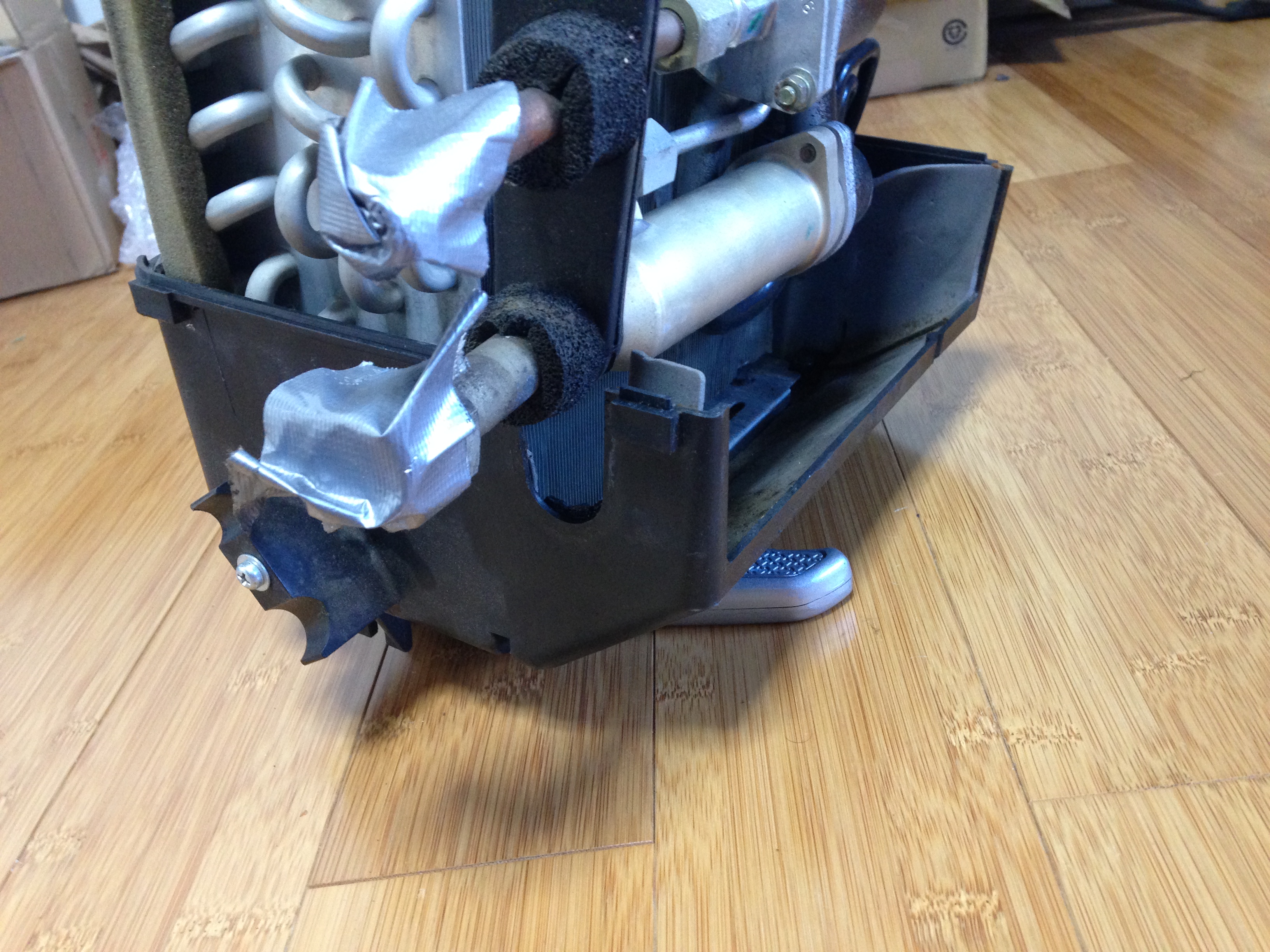

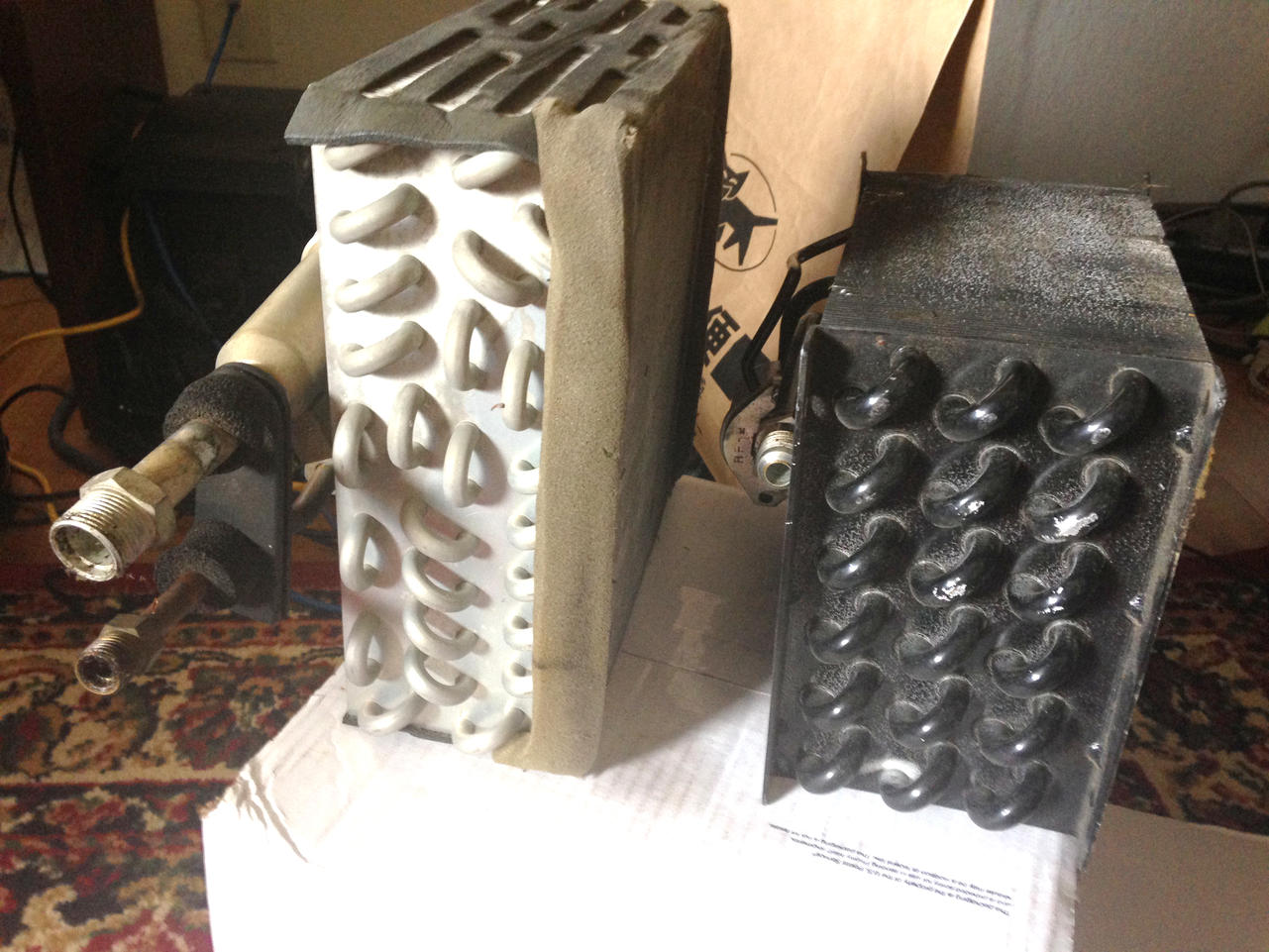

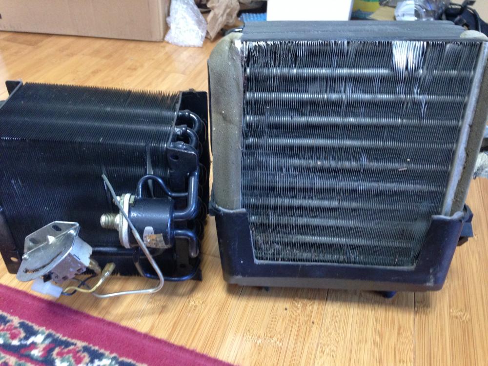

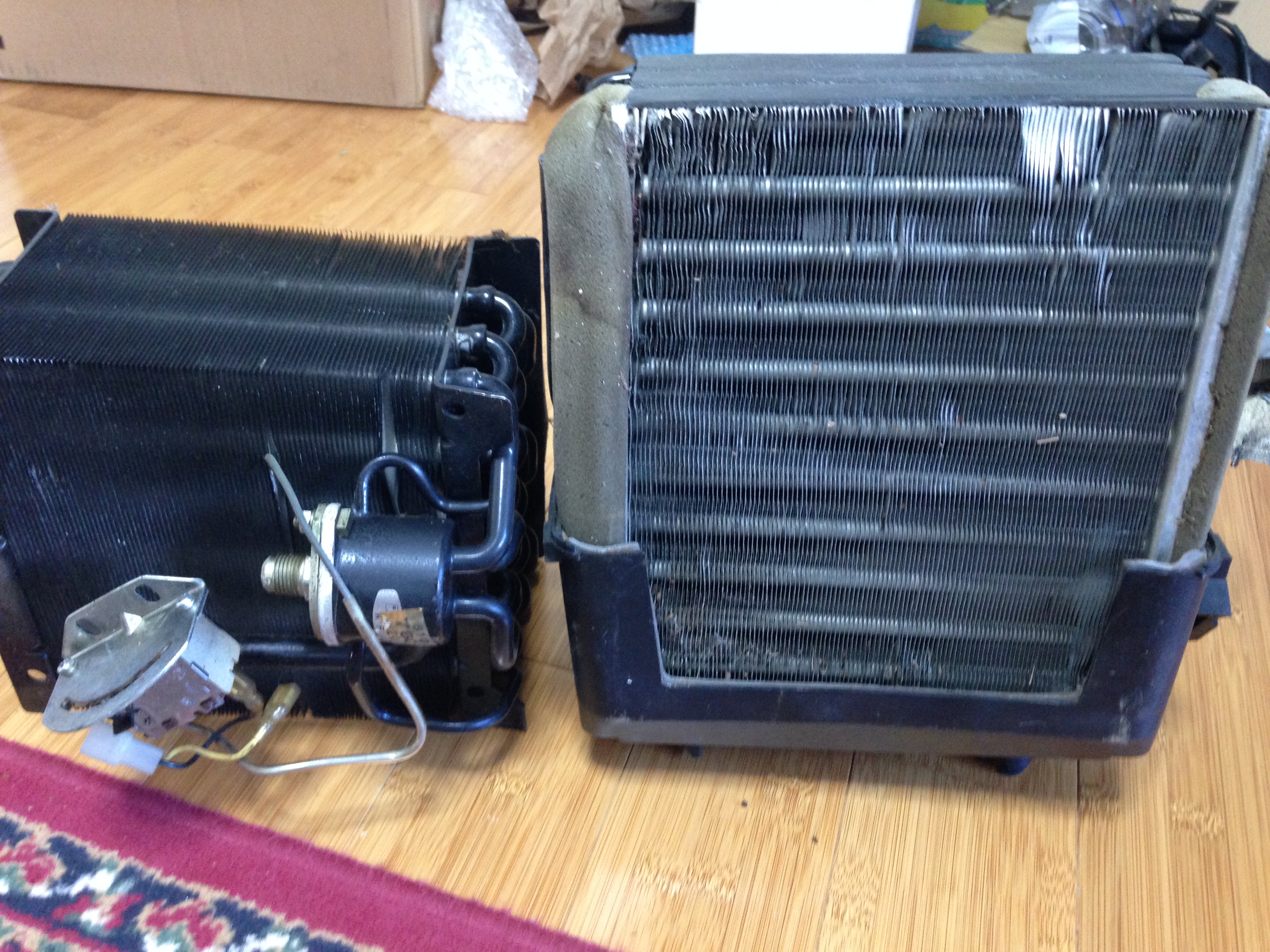

Yes, good idea. The zx evap is on the left. The profile is thinner which may help in fitting it behind the dashboard better. I've researched this before by tring to fit it inside a modified 280z evap case. Too tall as you can see. Probably a better idea is to get a zx evap case, I don't have one, Best to get a pre o-ring zx evap. The 79-81 i believe is flare fitting. I have the o-ring
version in pic.
Edited by hr369

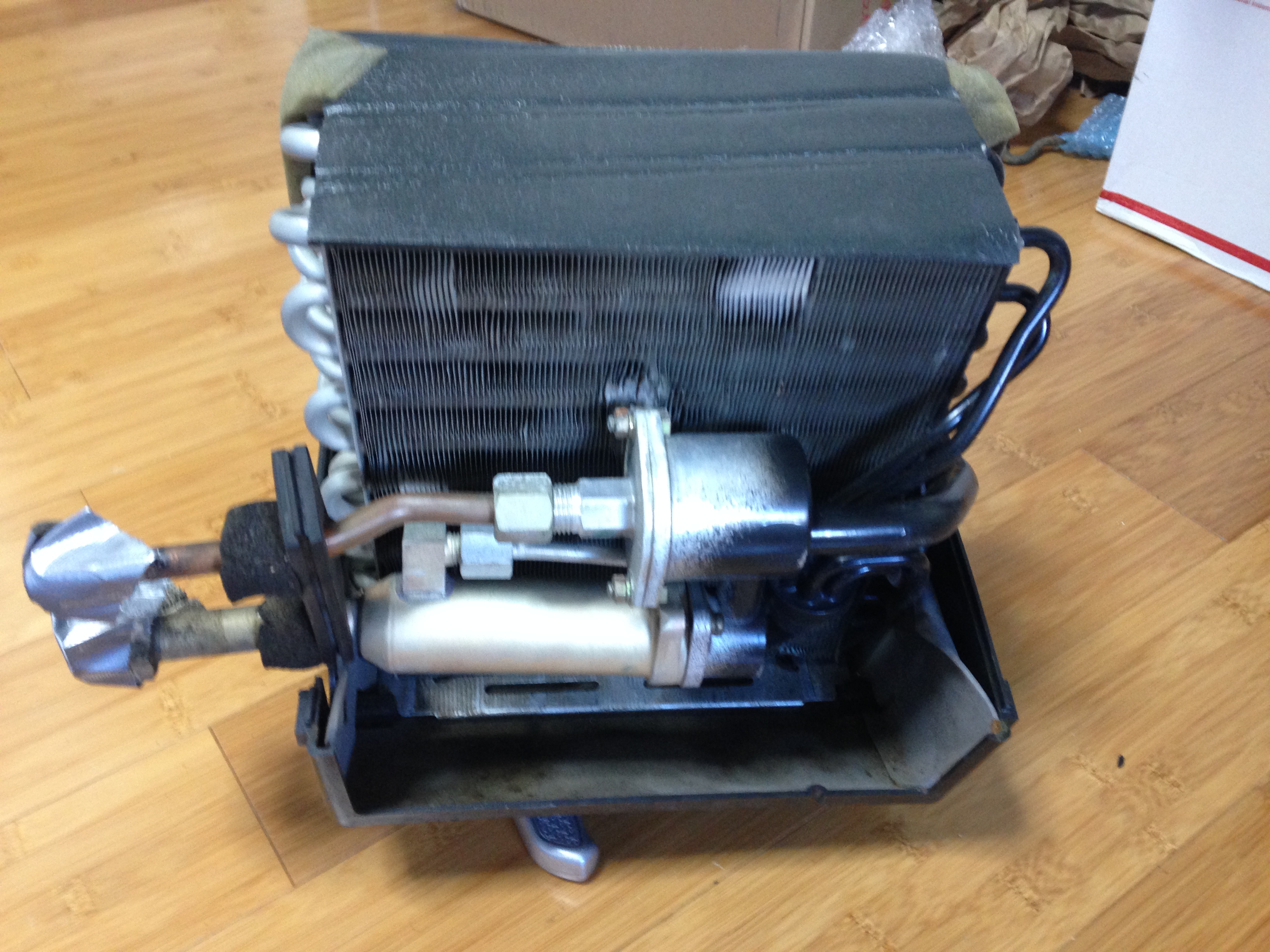

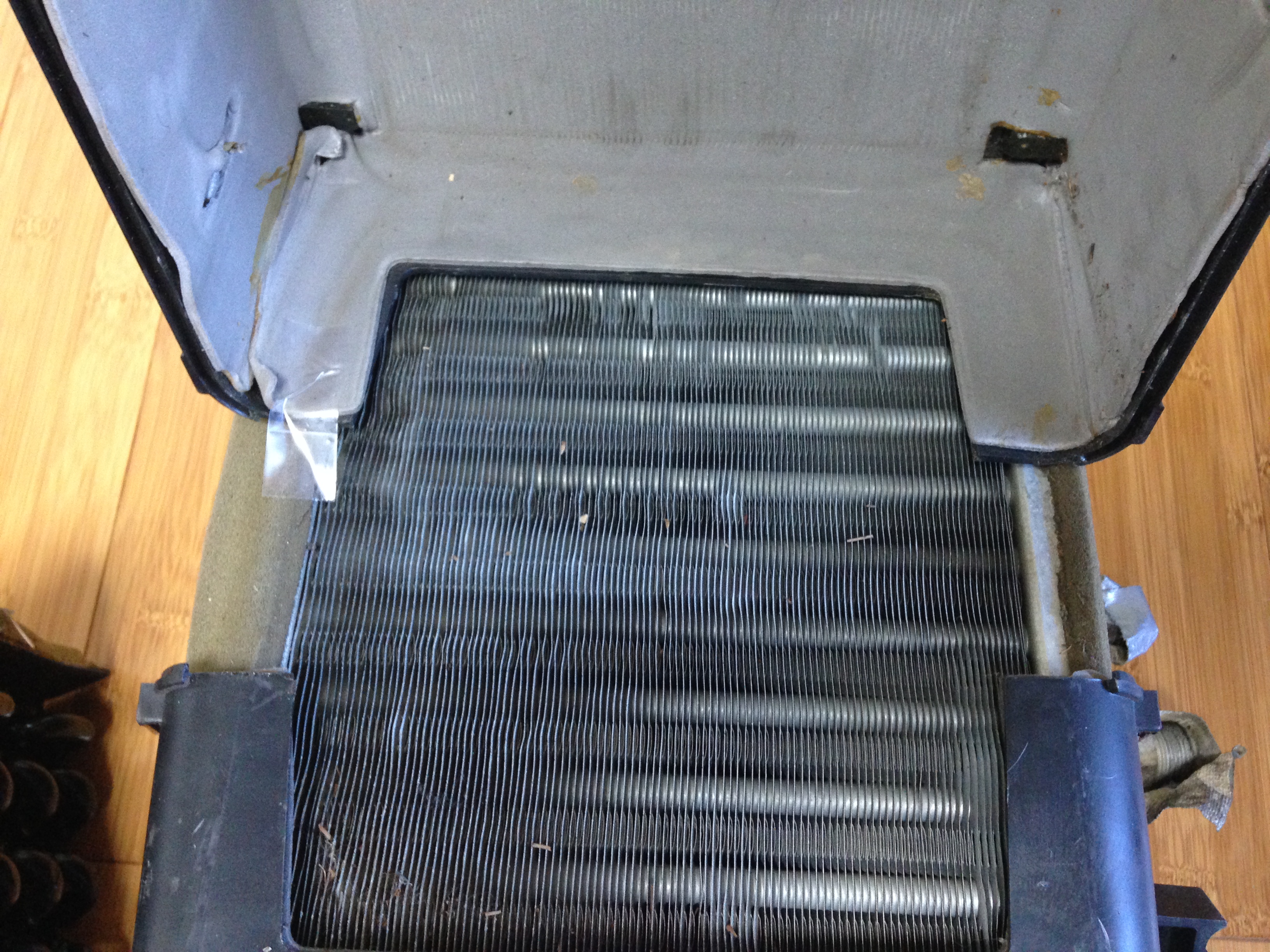

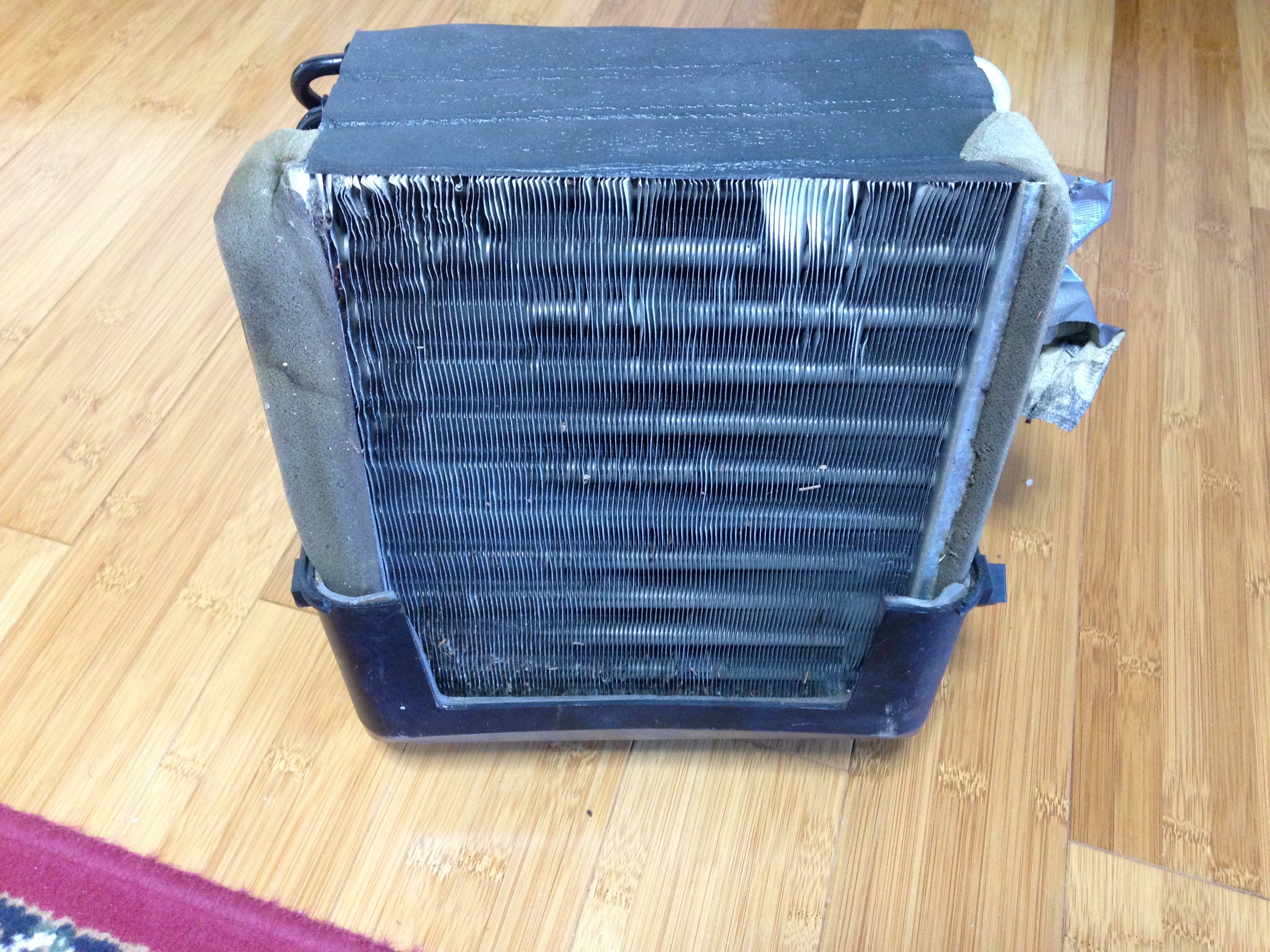

Here is the zx evap in the 280z box. I measured about 3" would have to be added to the height of the evap box. That's simple just cut the top off and splice in some black plastic with fiberglass.  However, there could be problems  with adding 3" to the height. ihave to take a look at some more pics of inside the dashboard to see what it would interfere with.
About 1/4" would also have to be added the width too. It's a bit too tight or you might be able to get away with removing a little bit of the foam rubber on each
side of the evap.

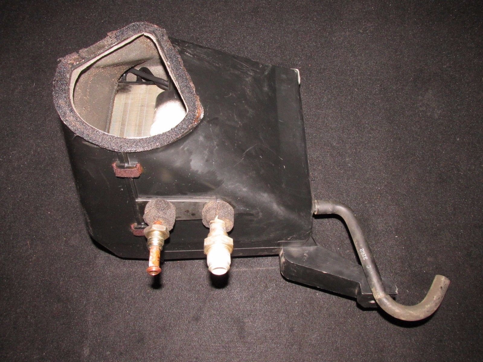

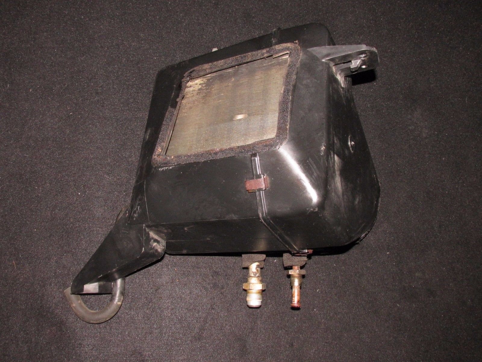

You could also try using the 280zx evap case (last 2 pics)  in the 240z. Maybe better fitting ductwork?
