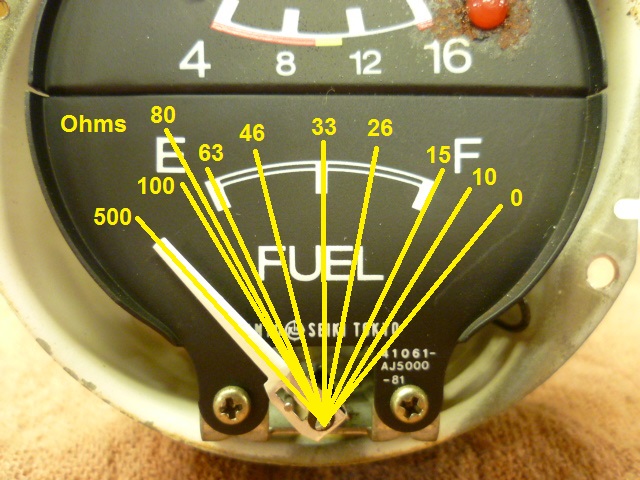

June 3, 20187 yr comment_550340 This just came in very handy. My 1976 Fuel gauge has not been reading accurately ever since I had the fuel sending unit out. Now I know what to do. Also answers, that the Low Fuel light probably does not come on with the bulb check. Link to comment https://www.classiczcars.com/forums/topic/55746-fuel-gauge-accuracy-1975-280z/?&page=2#findComment-550340 Share on other sites More sharing options...
June 3, 20187 yr comment_550354 I took a quick look at the wiring diagram, and I do not believe the fuel warning lamp is activated during the bulb check. @Dave WM do you concur? Also, Here's a fresh copy of the most interesting of the pics from above: Link to comment https://www.classiczcars.com/forums/topic/55746-fuel-gauge-accuracy-1975-280z/?&page=2#findComment-550354 Share on other sites More sharing options...
June 3, 20187 yr Author comment_550368 that is correct the fuel bulb is not checked. I have my fuel check light set up to come on when I have about 4 gallons from bone dry IIRC. I figure once you are down to about 1.5-2 gallons from dry you are virtually empty (car will suck air in left turns cause it to stumble, prob not run at 1 gallon). So I have about a 40-45 mile range when that light comes on. I wonder why every volt meter I see has that corrosion around the charging light? Link to comment https://www.classiczcars.com/forums/topic/55746-fuel-gauge-accuracy-1975-280z/?&page=2#findComment-550368 Share on other sites More sharing options...

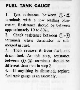

June 3, 20187 yr comment_550369 You'd need a separate circuit with a relay to check that bulb wouldn't you? As I understand the way it works the ground circuit for the bulb runs through a resistive element that doesn't pass current unless it's not covered by fuel. Exposed to air where it heats up and passes current. I've seen the description somewhere but haven't refound it yet. I've never seen my fuel light come on, but have pondered draining the tank to check it. My "E" seems to be set to about 13 gallons. I get too nervous to drive until the light comes on because I don't know if it works. I've wondered the same thing about the Charge light. Maybe it gets warm there. Link to comment https://www.classiczcars.com/forums/topic/55746-fuel-gauge-accuracy-1975-280z/?&page=2#findComment-550369 Share on other sites More sharing options...
June 3, 20187 yr comment_550370 This is the closest I've found so far. But they just say "different". FE-6. Link to comment https://www.classiczcars.com/forums/topic/55746-fuel-gauge-accuracy-1975-280z/?&page=2#findComment-550370 Share on other sites More sharing options...
