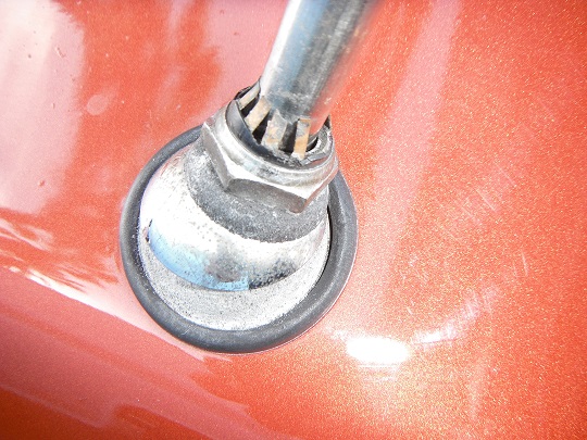

Posted June 17, 20168 yr comment_497043 Anybody know a good replacement ? It cracked and fell off. Don't like the idea of water getting in there. I guess I could used one of those rubber vacuum caps and drill a hole in it, but it's hard to drill rubber. Link to comment https://www.classiczcars.com/forums/topic/55647-radio-antenna-grommet-replacement/ Share on other sites More sharing options...

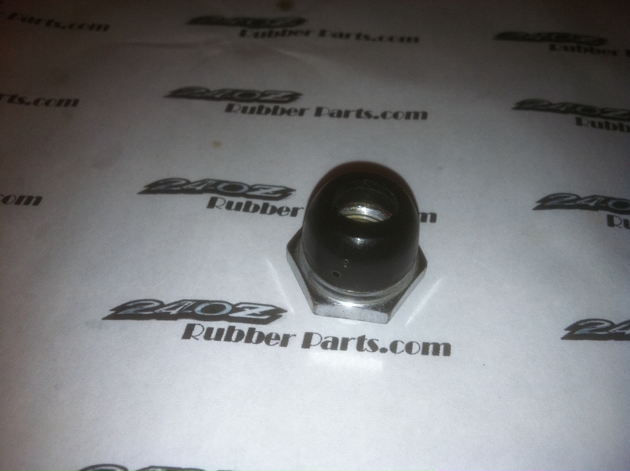

June 17, 20168 yr comment_497047 http://www.240zrubberparts.com/apps/webstore/products/show/6517164 Not sure this is the part you are after Stanley, but maybe it is. I've been after Steve before trying to get him to reproduce all of the rubber bits for the antenna----there are several. No luck so far, but maybe I'll try him again soon. Link to comment https://www.classiczcars.com/forums/topic/55647-radio-antenna-grommet-replacement/#findComment-497047 Share on other sites More sharing options...
June 18, 20168 yr Author comment_497058 I gotta spend more time checking that site. Not the part though, the thing that broke off fits tight on the lowest part of the antenna, then it widens at the bottom to fit around the part that the antenna extends from. Not sure what it looks like since I never paid attention to it when it existed. Maybe it's a standard part on various cars. Link to comment https://www.classiczcars.com/forums/topic/55647-radio-antenna-grommet-replacement/#findComment-497058 Share on other sites More sharing options...

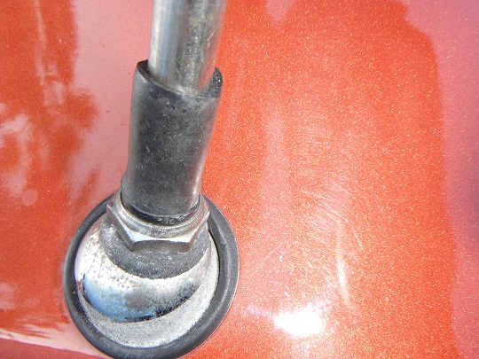

June 25, 20168 yr Author comment_497598 Fixed it, sort of. Cut the end off a rubber vacuum cap with wire cutter, it fit OK, should keep most of the rain and carwash water out. The piece that broke off was plastic, not rubber. Link to comment https://www.classiczcars.com/forums/topic/55647-radio-antenna-grommet-replacement/#findComment-497598 Share on other sites More sharing options...
June 25, 20168 yr comment_497600 Looks better than before and I'm sure you don't leave it outside. Those Haradas that are popping up for sale are like $400, WOW. Link to comment https://www.classiczcars.com/forums/topic/55647-radio-antenna-grommet-replacement/#findComment-497600 Share on other sites More sharing options...
June 26, 20168 yr comment_497656 I do have something that is very similar to the original. The problem is getting the old one out of the nut and installing the new one with the little star looking insert. Steve Link to comment https://www.classiczcars.com/forums/topic/55647-radio-antenna-grommet-replacement/#findComment-497656 Share on other sites More sharing options...
