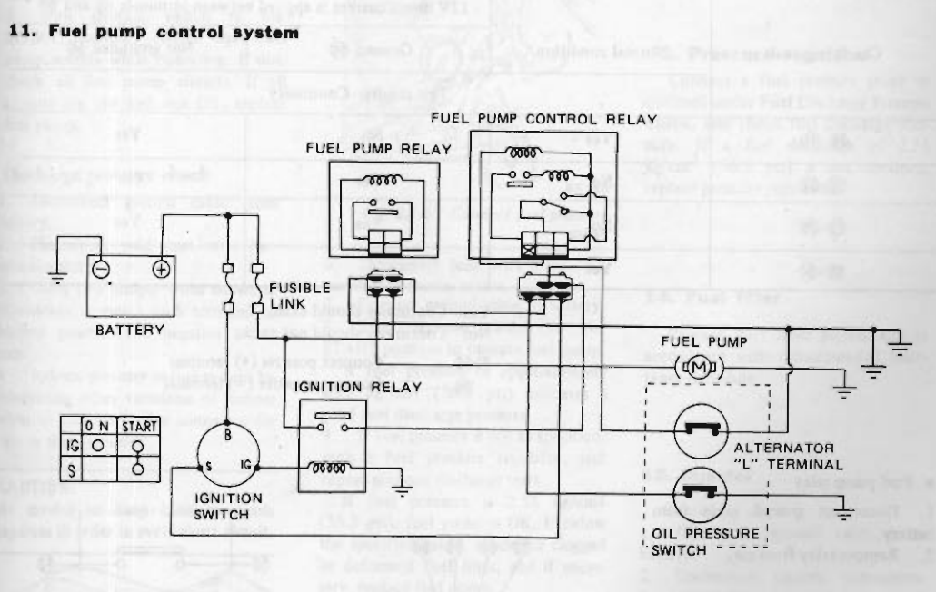

78 has the system that uses a control relay and a pump power relay.  The control relay uses either current flow from the alternator OR current through the oil pressure switch to actuate the pump power relay.  Relay powers relay.  There's a whole thing about how it works and testing on EF-35.
One way people test their pumps with 78's is to disconnect the oil pressure gauge/switch and turn the key to On.  I'd guess that your control relay is sticking, and that won't work for you.

Anyway, I think I was misunderstanding how the fuel pump control relay works.  I had thought the fuel pump relay would close when starting the engine, which once running, closed the control relay via the alternator and oil pressure switches.  With that line of thinking, I wasn't concerned about the control relay since I couldn't get it to start in the first place.  Sounds like I've got it wrong.  I just found this link (for future visitors who may come across this thread) http://atlanticz.ca/zclub/techtips/fuelpump/moreinfo.htm  and after reading through it a couple times, it's starting to make some more sense.

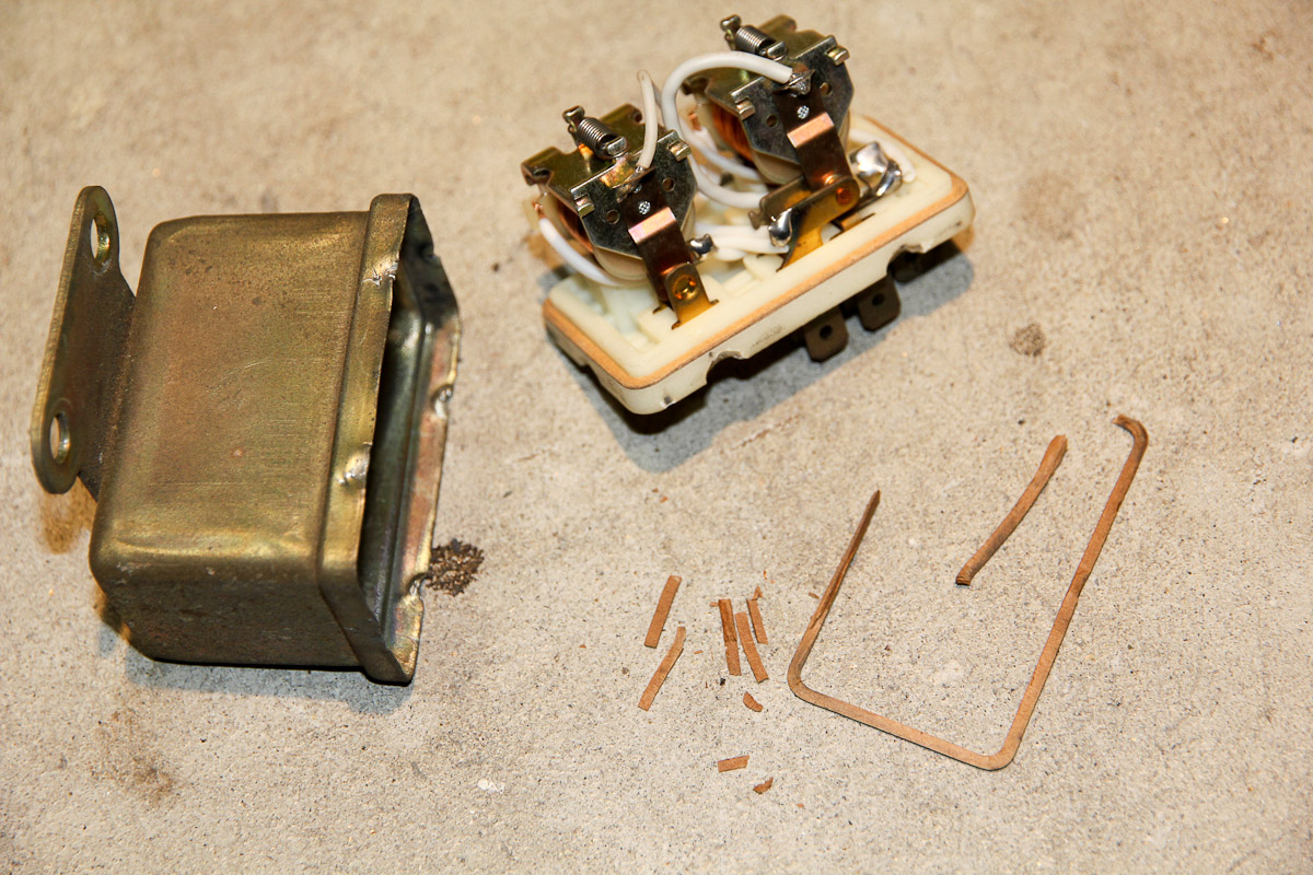

Tested both the fuel pump and control relays and both checked out fine.  The control relay looked like someone opened it once upon a time and I could hear something rattling around in there, so I cracked it open and this gasket-type material came out.
My theory is that by pure dumb luck, a piece of that got stuck between one of the relay contacts and wasn't allowing it to close.  Anyone else think that sounds like A Thing That Could Happen?  Because I'm planning on taking the car out tomorrow and would prefer not to get stranded.:)
I had a fine hair or thread or piece of dust stop my AFM fuel pump relay contact switch from closing.  Never did find the actual thing, I cleaned the contacts with a matchbook striker and it's been fine ever since.  So I'd say yes that can happen.

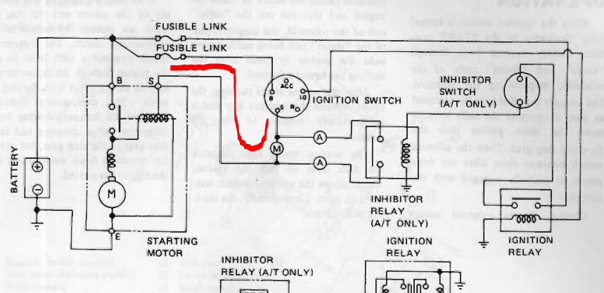

And don't overlook a bad ignition relay.  Can't remember what exactly it powers but I think that the starter circuit might have its own power, independent of it.  Just checked and the manual trans. cars have a direct wire to the starter solenoid.  So the engine can spin with a bad ignition relay.  My ignition relay was full of rust.  One of the Z car vendors out there actually borrowed a pciture I posted of it to help sell his own parts.  They're in a damp location.
