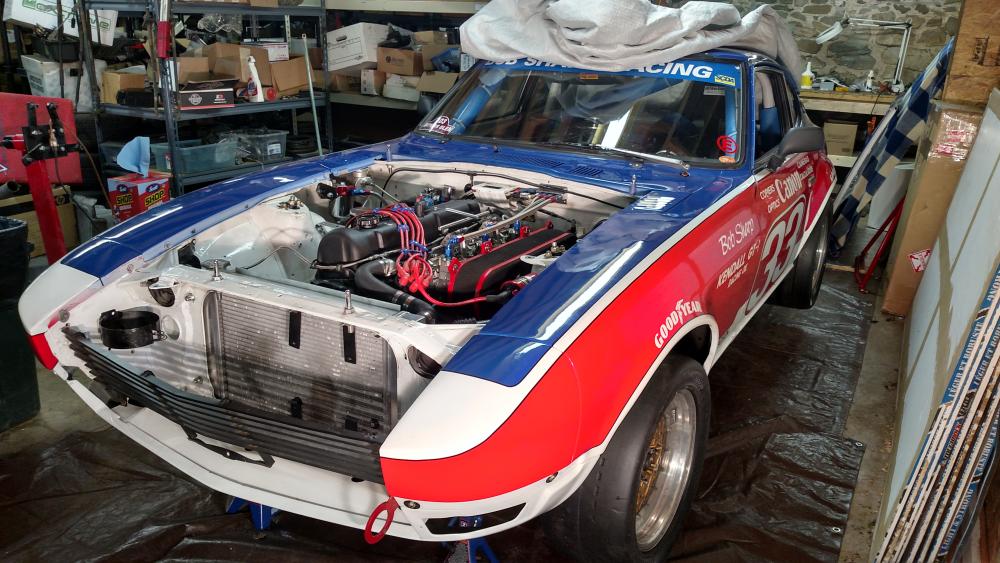

Based on my experience of being pulled at the track I think attaching it to the center of the radiator support would be a bad spot without some bracing. I expect that it would be pulled forward and could end up damaging your radiator. My front hook is attached to the bumper mount on the left side. In the rear it's attached to the right bumper mount. I was pulled out of the gravel using the rear hook and it tweaked the rear panel. In my pictures you can see the red read hook just below the bumper on the right side. In the front pic you can see a big loop under the bumper on the left. That was a home made hook from back when I bought the car. I replaced it with a stronger one but kept it in the same location.

There is just to much nicely-formed sheet metal on the front & back to be able to easily attach a bracket.
I can't remember who I got my front and rear tow hooks from as it's been a good 5-7 years ago but the front mounts to the inside of the headlight bucket and like Chuck's car it can be used with a bumper. The rear is mounted on the passenger side bumper mount and that can also be used with a bumper (I have one on my street car as well with a bumper). My street car has a gnose nose so I use the strap approach which I can reach in to connect should I need to put the car on a trailer or Triple A flat bed if so required by circumstances that hopefully will not occur (yeah right).
