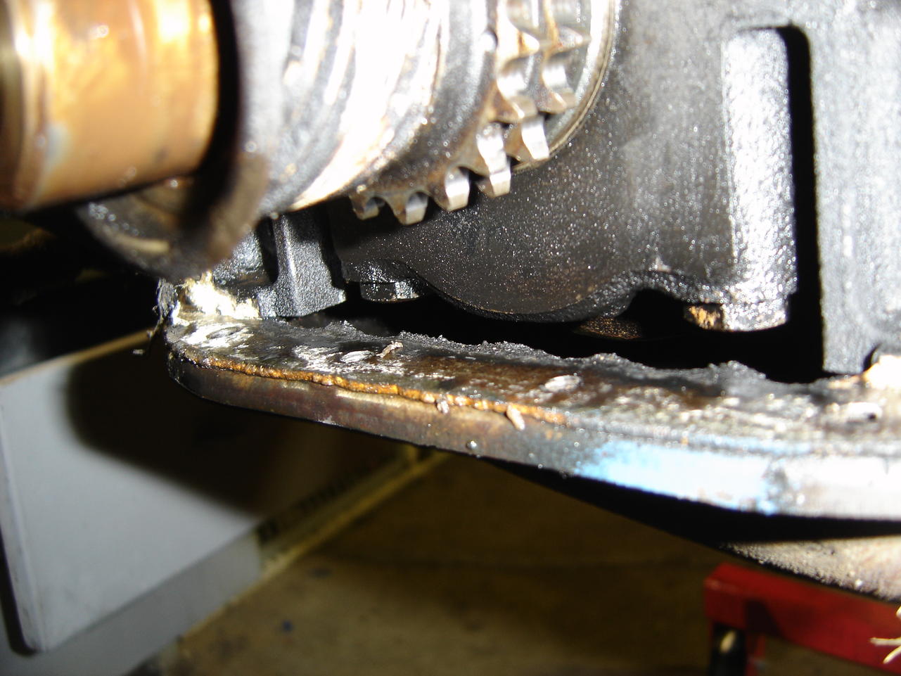

I've been thinking, LOOK OUT :o, about having a plugged PCV system like the OP had to begin with.  Could that have caused his smoke problem or been a band-aid for it?  I've only seen two on here that had them plugged from a high performance builder.
 Give the man a cigar. I hadn't considered the "Band-aid" theory. It's the one that makes the most sense. We screwed around with catch cans, pan baffles and windage trays on dragsters in the sixties. Even tried blocking it all off and sealing the crankcase. Oil started seeping out of any place it could. If the air being pushed and pulled up and down under pistons wasn't enough the added pressure from leakage past the rings all had to go somewhere and it did. The best catch cans were made from a windshield washer reservoir bottle. Slide in, slide out bracket made it easy to clean.
The hose from the valve cover should release plenty of pressure, I'd think.  The crankcase and valve cover are essentially the same cavity.  Hope is good, but that #6 number is pretty low and shows all the signs of bad rings.
Once you seal up the block with the head the only opening is at the front of the oil pan, right?  Seems like the rear main seal would blow out if air wasn't released through that opening to the front cover then to the head.  I'm just trying to figure out why they are plugging the block's PCV outlet.  I don't see a reason for it, but there has to be.
I think that he's basically converting a "PCV" to a "CV".  The PCV brings fresh air in through the valve cover to cause movement of crankcase gases through and out.  The old-style 40's-60-'s era vents just allow overpressure somewhere to go, but there's no "cleansing" action.  No flow, it's static and only the excess gas gets pushed out.  The rest of the blowby just hangs around, dropping its contaminants in to the oil.  Like an old Chevy with the vent on the oil filler tube.
The dip stick always comes to mind when the discussion turns to pressure.  It would get pushed out if pressure was significant.  At least mine would, the seal isn't very tight.  It's basically a gravity seal.

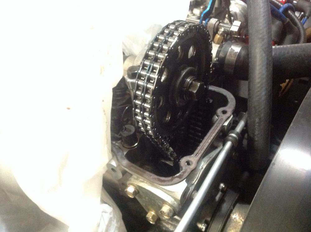

I just noticed or didn't notice something, no oil holes in any of his cam pics and no spray bar.  Please tell me you have holes in the cam lobes and I just can't see them?  You said it was a P79.  The head builder must have opened up that hole for a mechanical pump then someone put an electric one on there for the triples.
Found one.
 I thought for a sec that you were going to get another cigar. The pic of the lobe with the "chip" in it. The next lobe over has an oiler hole.
