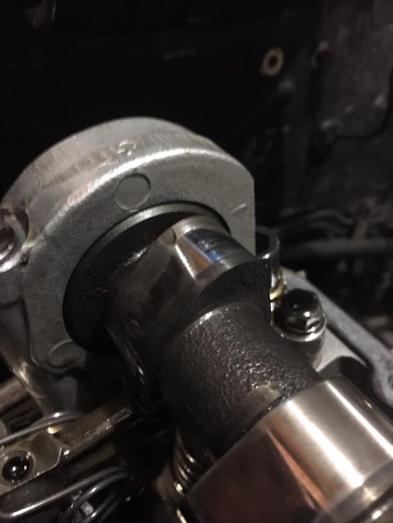

11 hours ago, Mark Maras said:
Found one.
 I thought for a sec that you were going to get another cigar. The pic of the lobe with the "chip" in it. The next lobe over has an oiler hole.
Good eyes!  Give that man a cigar.
