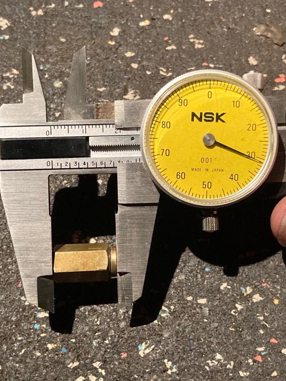

28 minutes ago, Captain Obvious said:
Yeah, I'm measuring including the rounded top portion. Essentially I'm interested in "how far does the valve stick out of the bowl lid", and that includes more than just the hex portion.
So I'm measuring everything from the sealing washer surface to the top of the valve (not including the movable internal bits). Like this:
So this is my (cracked body) 72F valve. I get .806 (20.5mm), That makes sense since the TSB mentioned earlier says they lowered the bowl level for the 72 front carb by 2mm. Both the valve and the bowl lid ears got 2mm longer for the 72F, so all the numbers line up to support that:
So when your eyes get back into focus, let me know.  LOL
.806" Exactly what I have. I'll get a picture in a couple of cups.

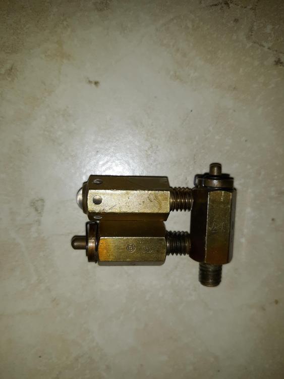

The thing for me was the newer valves you get today are the same length, front and rear. They said to use the washers to make up the difference. I never could get it right so I took the rear off another set and now have two rear lids. I went back to "they should have just left well enough alone".
Also I think the DVD shows how to set the height using the Grose valve but you can't do that with the newer style "needle valves". I wish they would add a sheet of paper in the rebuild kit explaing that. It took me a year to figure it out.

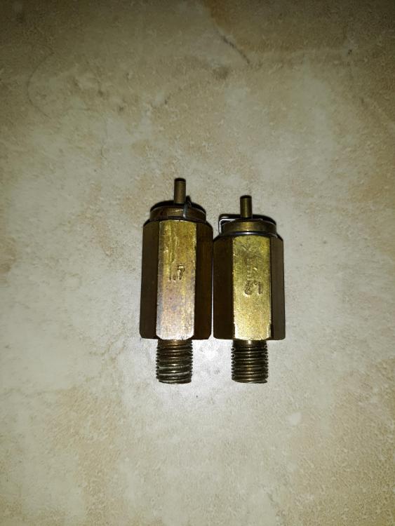

I got the ones that were the same lengths from ztherapy. They're on the car with 2 rear lids, short arms.
Here's the OE front. Looks to be a little more than .806? Could be an eyelash fell on there.

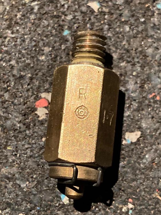

Here's some aftermarket needle type.

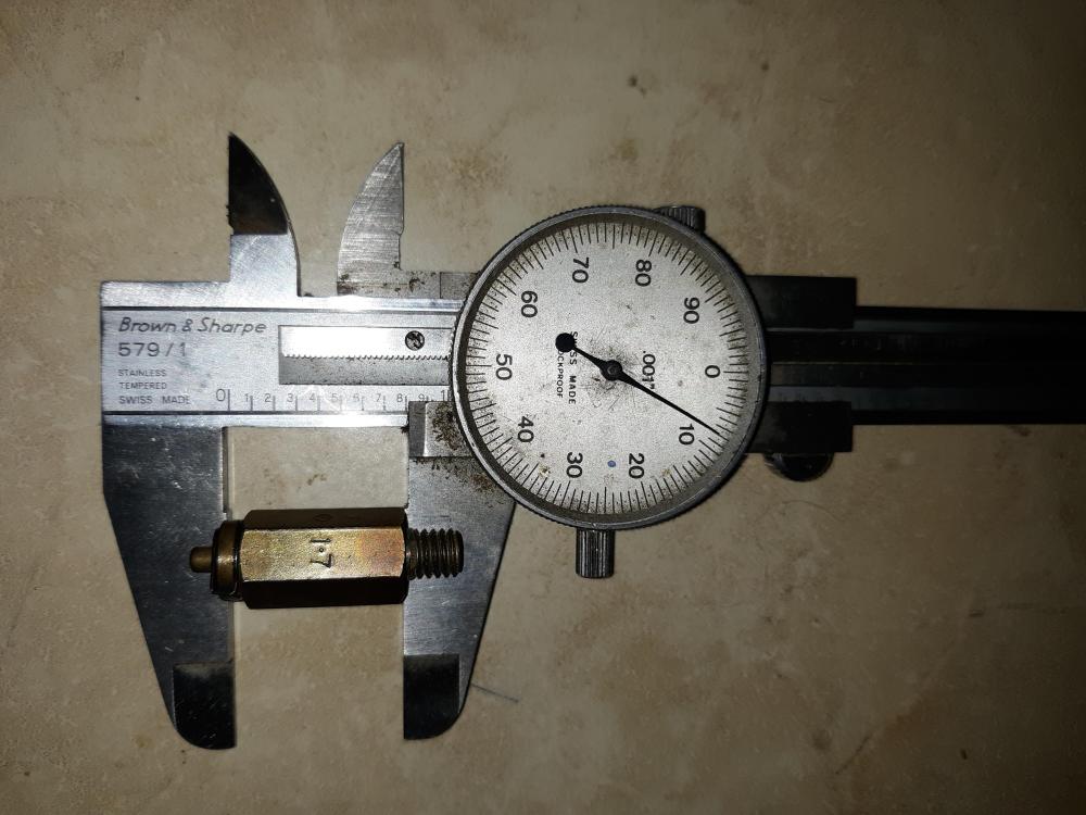

@Terrapin Z, @siteunseen
When you guys get a chance, could I trouble you both to take a caliper measurement of the short valve going all the way to the top of the valve?
Also, do your short valves have the "R" stamped on them? Looks that way in the pics, but just checking.

Terp, Awesome. Thanks for the great pics. And your number matches the Hitachi valves I have here.
So assuming site's 72R valve comes in at the same dimension as what's in your pic, here's a summary of what I have so far. Most of this is old news, but just to put it into a form that my little brain understands...
The float valve for the 72F should be 20.5mm. That is 2mm longer than the previous years and Datsun adjusted both the length of the float ears and the depth of the valve recess of the 72F lid to accommodate that change. The intent seems to be "They wanted the front carb float level to be approx 2mm lower than it used to be in previous years."
The float valve for the 72R should be 18.5mm, and it's interesting to note that this is the same length valve Datsun used on the previous round tops in 70 and 71, but a different part number*. And again, Datsun adjusted both the lengths of the float ears of the 72 R lid as well as the depth of the valve recess to change the float level. The intent seems to be "They wanted the rear carb float level to be approx 2mm higher than it used to be".

7 hours ago, siteunseen said:
Here's mine.
18.5mm and has an "R" on it.  Perfect. You guys are the best!!  @siteunseen  @Terrapin Z
