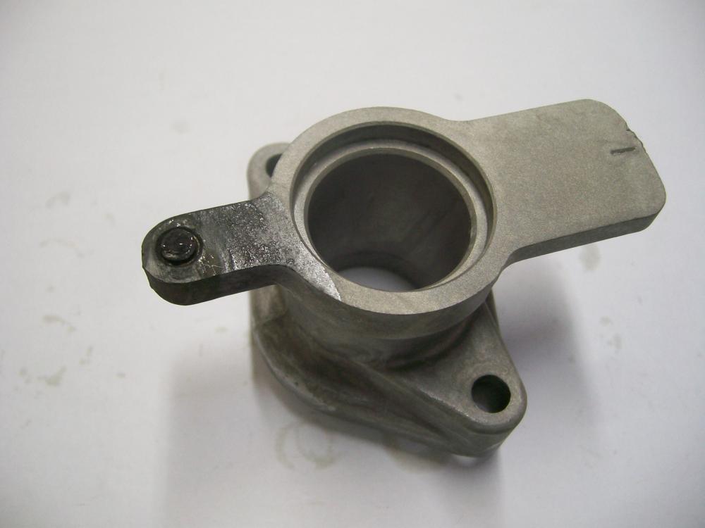

I had high hopes for this treatment but -- like many things that appear too good to be true -- I can now report that, after trying it out, this whole thing is 100% bogus.  My test piece was a spare distributor base casting, complete with the remnants of the snapped-off locking screw. I bought a small can of alum off the grocery store's cooking spices shelf and then dumped it into a small saucepan full of water.  After bringing the water up to just below boiling temperature, I dropped the casting in to see what would happen.
There was a lot of bubbling action, although it all seemed to be coming off the aluminum surfaces rather than from the area of the snapped-off screw.  After watching this for about a minute, I started to get concerned that the process was attacking the wrong metal (i.e. the aluminum, and not the steel).  I re-jigged the casting so that only the 'ear' with the screw shank was immersed in the water, and then let things go for about 20 minutes. There was still no sign of anything really important happening around the steel screw.
After the twenty minutes were up, I pulled the part out of the water to inspect it more closely.  As you'll see from the 'before' and 'after' pictures below, my suspicions were correct.  The aluminum had been eroded (you can see the etching lines from where the water surface was located).  The exposed surfaces of the screw shank were darkened, but that's about it.  I still had hopes that maybe the chemical action had attacked the corrosion between the screw threads and the casting threads, so I took it down to my workbench to see if the screw was perhaps now loose (or, at least, not as frozen as before).  Nothing doing.  It still wouldn't budge, and now I'm back to having to drill it out and re-tap the hole.  In addition, the 20 minutes of full immersion had 'pickled' the rest of the aluminum casting's surface, making it darker and -- well -- not as nice as it looked at the start, fresh out of the blasting cabinet.
End result:  Perfect alloy casting is now not so perfect any more, and the snapped-off screw is still firmly stuck in place.
Conclusion:  Don't waste your time on this 'miracle cure'.  It doesn't work and it will eat your aluminum parts.

Sorry, but those are pix of the same part.  Just turned upside down in the 'after' shot.
No way I was going to leave this part in this solution any longer than I did.  Too much action happening on the aluminum surfaces and I didn't want to damage the machine bore.  In any case, my experiment wasn't really about fixing this part.  Instead, I wanted to see whether this technique had any promise for getting the snapped-off manifold stud out of my car's cylinder head.  The distributor casting was just a guinea pig.
I just had lunch with my my friend the chemical engineering prof earlier this week, but we talked mostly about my zinc electroplating set-up and I forgot to ask about this other process.   If I pick up any insights in a future conversation, I'll let you know.
Exactly.  You talked about erosion but you're showing different areas, one top and one bottom.  And the lines on the bottom are machining lines from when the parts was made.  Show the same area before and after, and after rubbing off the black material.  No offence, but your pictures don't really show evidence of anything but some black staining.
