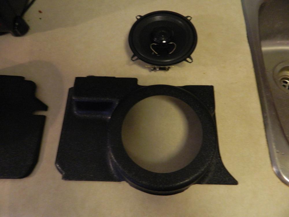

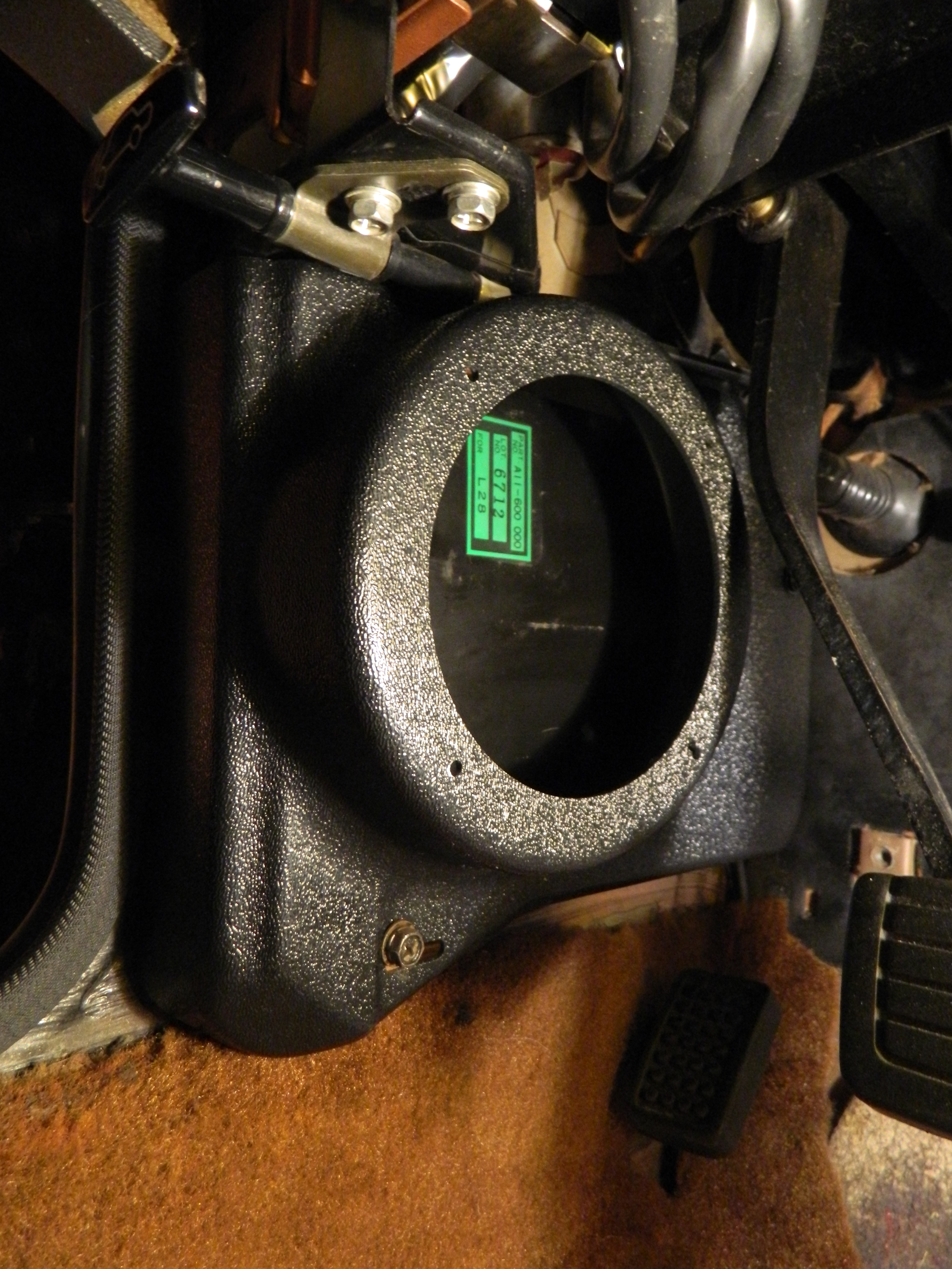

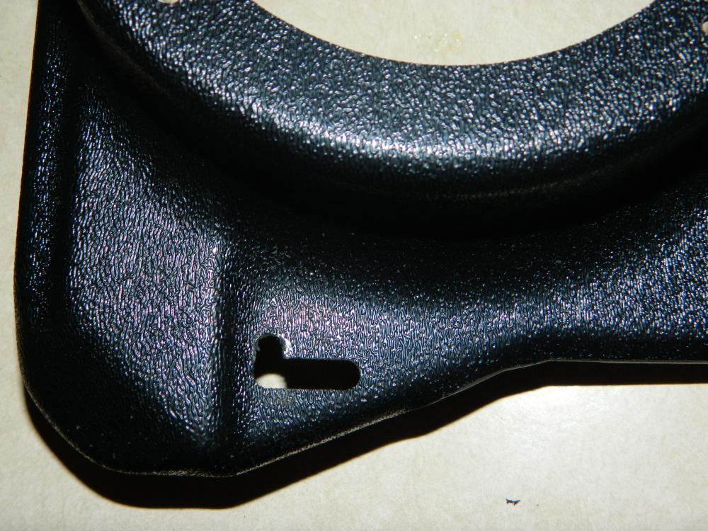

Had to wait for speakers to come in. So here are the first few pictures of the Datsun-Works 280Z front speaker Panels on my 1976 280Z. Fit and finish is excellent. They look factory made. I only had to make one small modification on the drivers side to the lower mounting hole. This may be due to the hood cable being positioned slightly lower on the 1975 and 1976 models than the 77's and 78's. There is a difference in layout between the years.

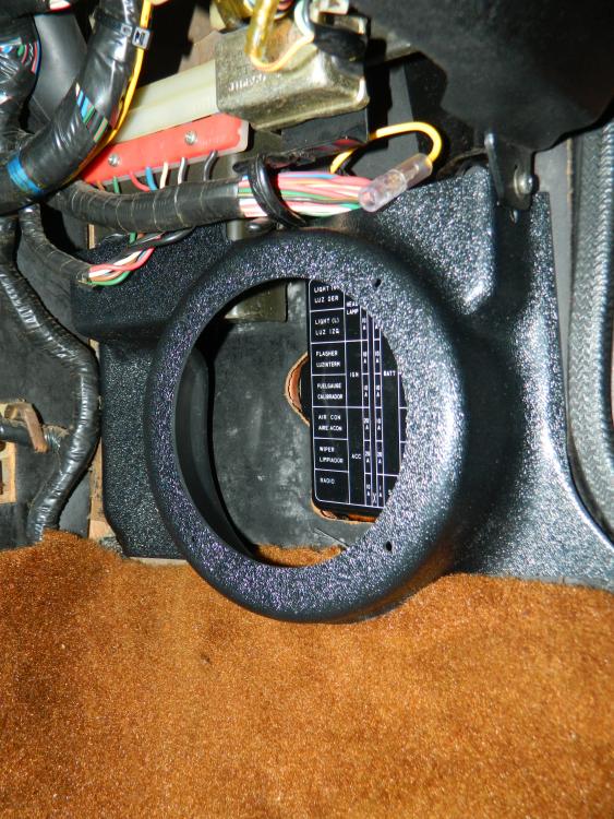

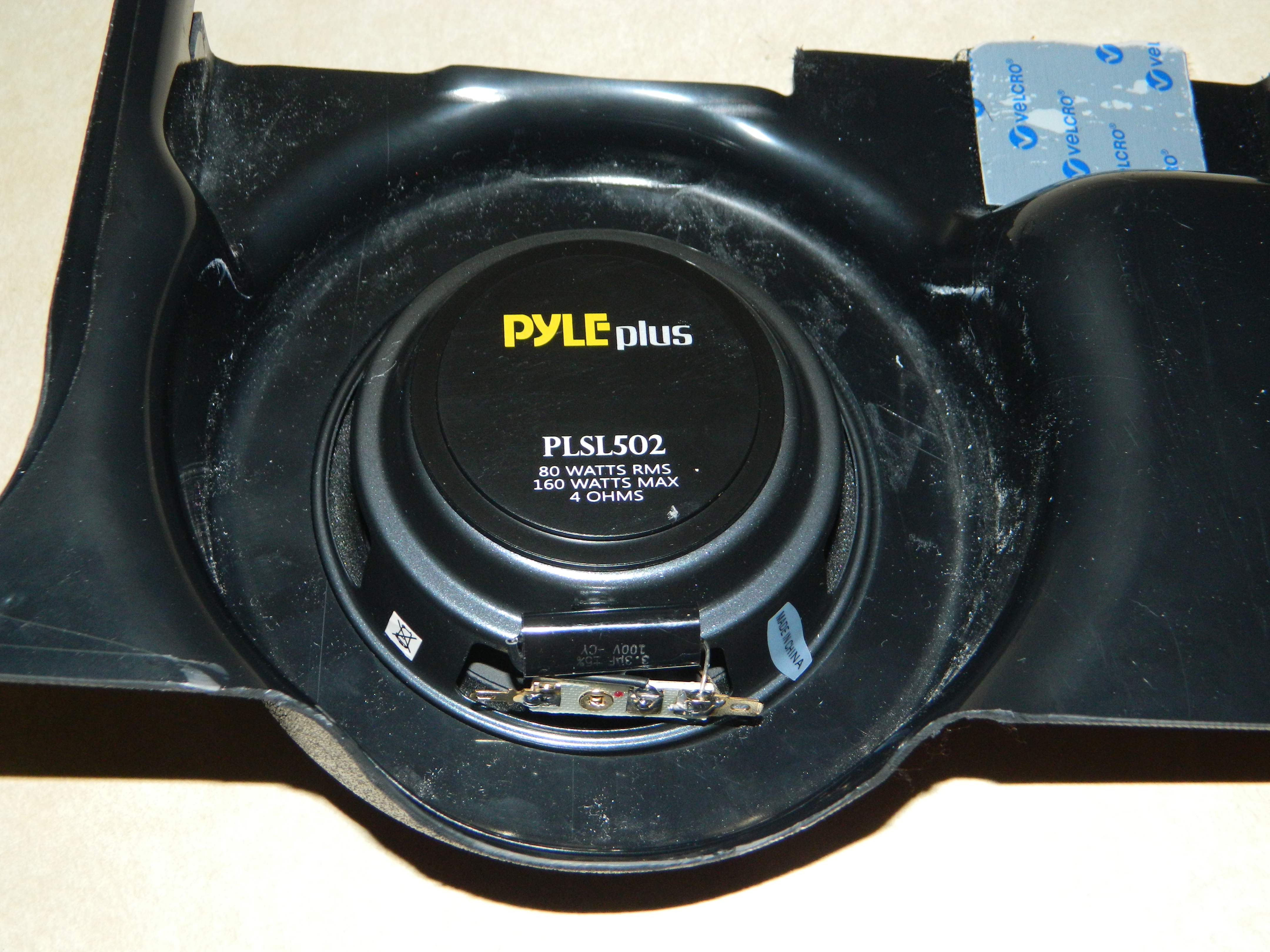

The Pyle PLSL502 fit perfect and are highly rated from what I've read. I got mine on E-Bay for $36 pair USD. The speaker is exact;y 1.643" from the bottom of speaker cone,  to the bottom mounting  lip of the speaker.  On the passenger side panel. there is 1.858" clearance to the top of the fuse box lid.These dimensions may be important to others who may prefer different speakers. There are shallow component speakers available, so now you have the dimensions you need to use alternative speakers.
Didn't get a chance to measure clearance on Drivers side as my back muscles spasmed on me. That put paid to any further work today!!! Suffice to say, that the Pyle PLSL502 speakers will fit.
Edit: On the drivers side there is 1.965" clearance to the top of the ECU.

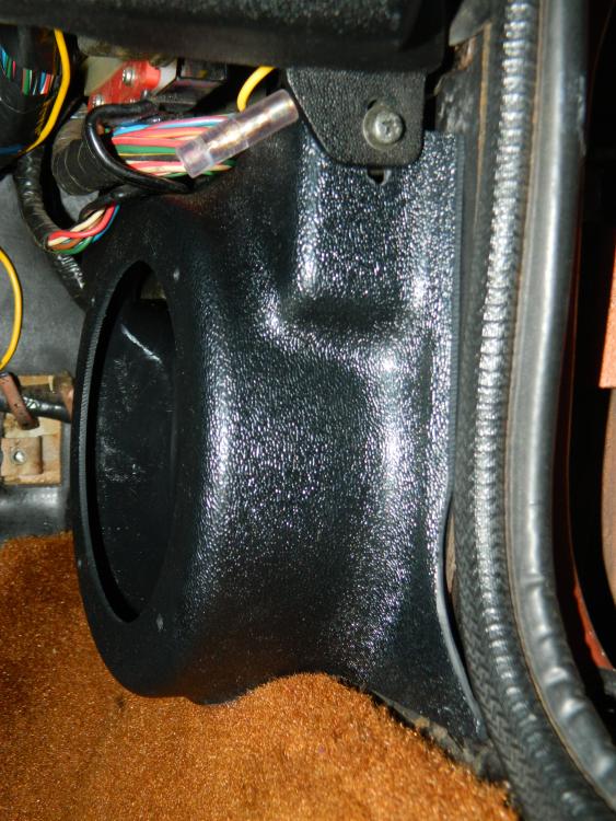

Some more pictures of trial passenger side fitment. Tomorrow I'll fit speakers and run wiring.

Check my updated posts #13 and #14 for install pictures and comments. We've been waiting 40 years for a product like this!!! HooRay for Derek!!!

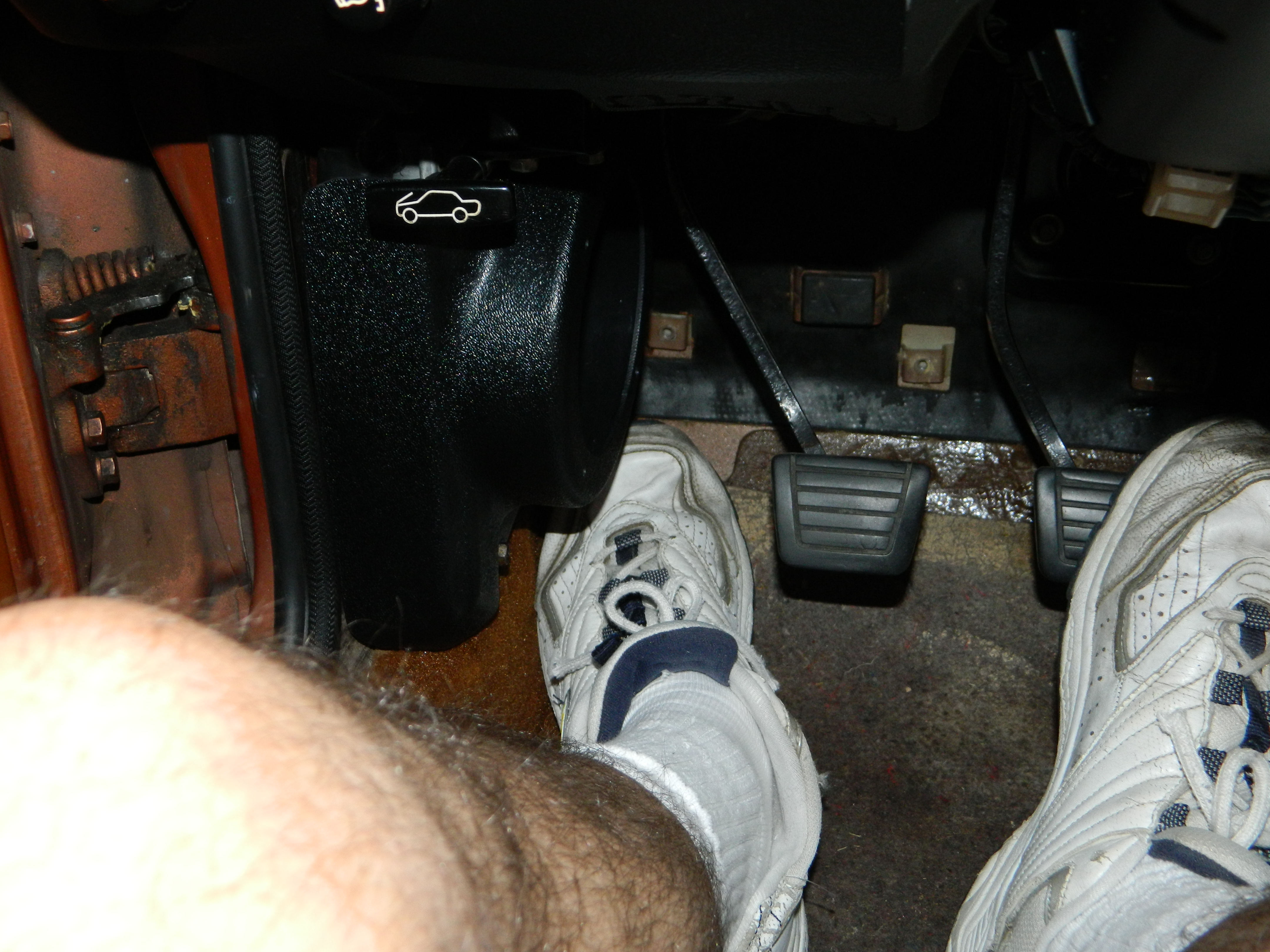

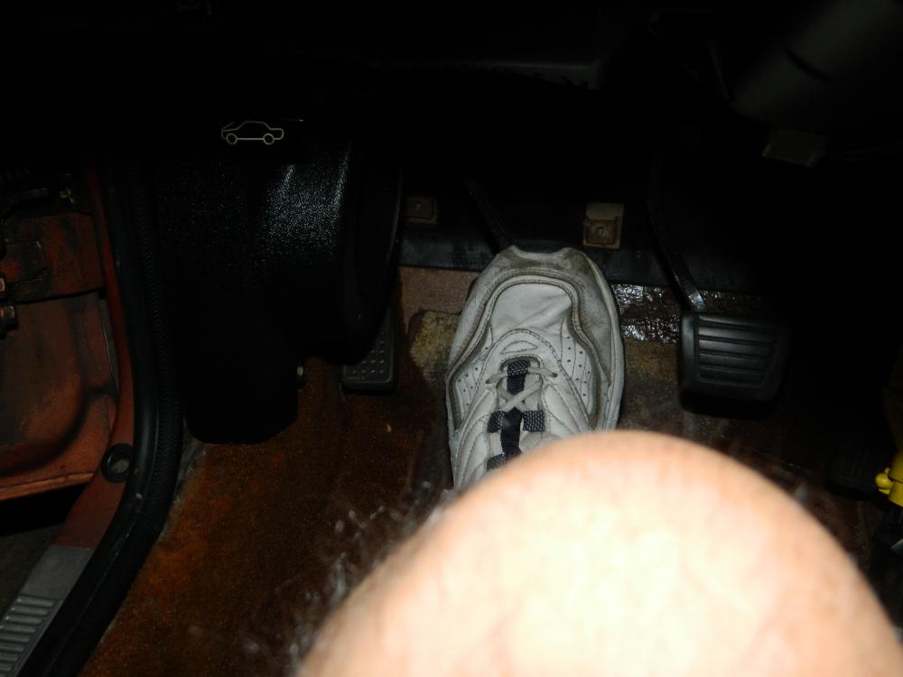

Sorry for the delay, but I've been having some back issues lately and I can't get under the Dash for very long. Here are a few more pictures and some notes.
1: Driver side fits much easier with small notch I made. Derek will likely modify production models based on this feed back.
2: I have included some pictures with my size 12, D width running shoes on. These are the bulkiest shoes I own ( with a big flare on side of soles )  and as you can see, there is lots of space. I have a lot more room with my dress shoes or driving shoes. Access to clutch pedal is a none issue. Access to dead pedal is fine. you just learn to slip your foot back and under. People without size 12 feet would have even more clearance.
I'll update later with speakers in place.
i'm the 1978 that derek alluded to in an earlier post.  i can say for certain these very handily fit a '78!
the clearance is pretty tight with the hood release cable.  i put a very slight bend in my bracket(just a few degrees, probably) and there is zero tension between the panel and the cable.
