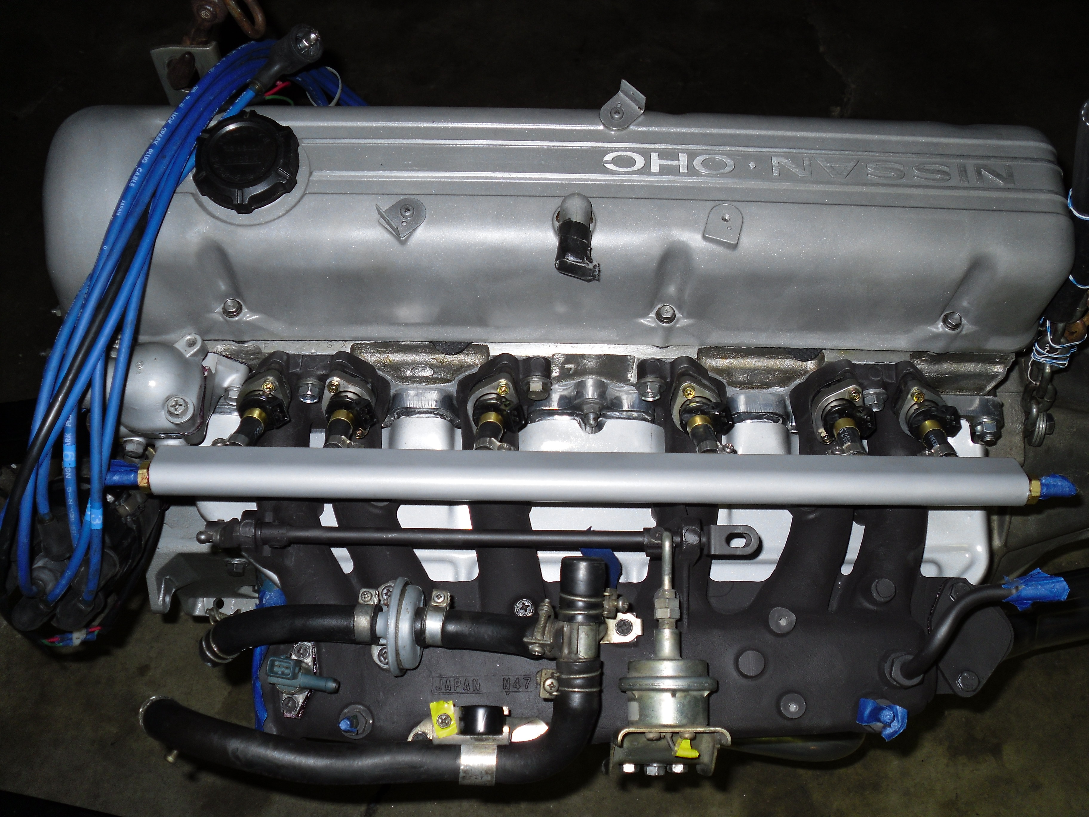

I got a nice raw satin finish with 80 grit coal slag through a suction tube sandblaster, fuel rail too.  220 grit sandpaper for the raised lines and "Nissan-OHC".  Then sprayed it with high heat clear satin.  Looks better in person though, this picture was more for the intake.

Wow both Valve covers look really nice, thanks for sharing.

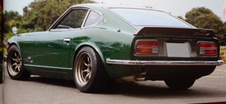

I know I want wheels, and so far am leaning towards 15x8, 0 offset, but i'm still researching to find the proper stance that I like. I'm trying to avoid rolling fenders to not mess with the originality of the car so we'll have to see. My goal is basically a clean, factory looking body with either R Type Watanabe wheels or Minilites, etc.. Clean and simple. Like the one in the attachment minus the rear air dam/spoiler and front fender mirrors..
