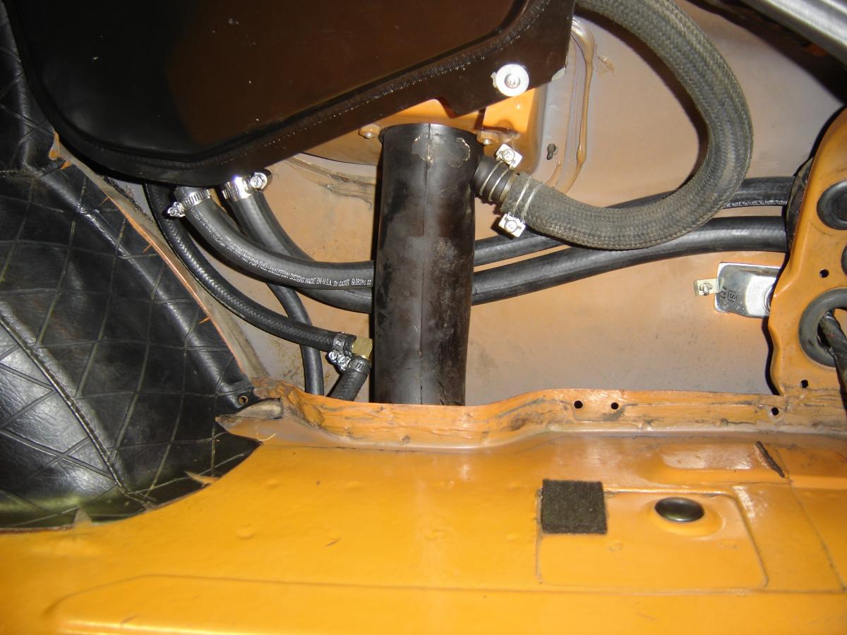

There's a evaporation system in the hatch, passenger's side.  The hoses get hard after some time so that makes dropping the tank a little more of a hassle.  You should replace those as well.  Nissan hoses that are still available are HIGH DOLLAR.  I bought all mine from O'reilly's for $60.  There's a good thread on here showing what I'm talking about.  Let me see...here it is, http://www.classiczcars.com/topic/24181-rating-the-factory-240z-fuel-vent-hoses/
Here's another good read, lots of info towards the end on hose sizes and ways to make the 180 degree bend, http://www.classiczcars.com/topic/17542-treating-insideoutside-of-gas-tank-with-por15-products-and-removing-evaporation-tank/page-3

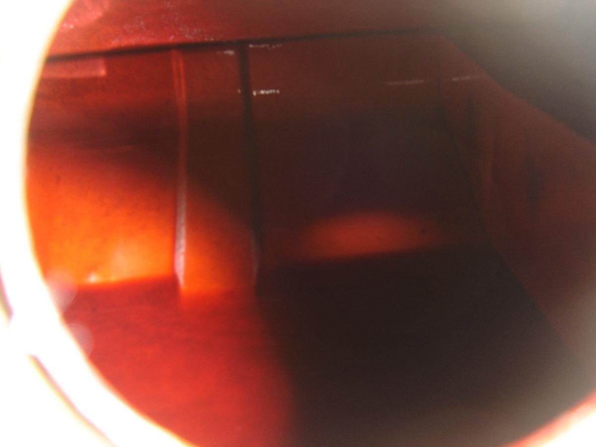

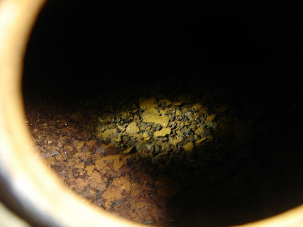

Some photos of mine after sitting with a half tank for many years.

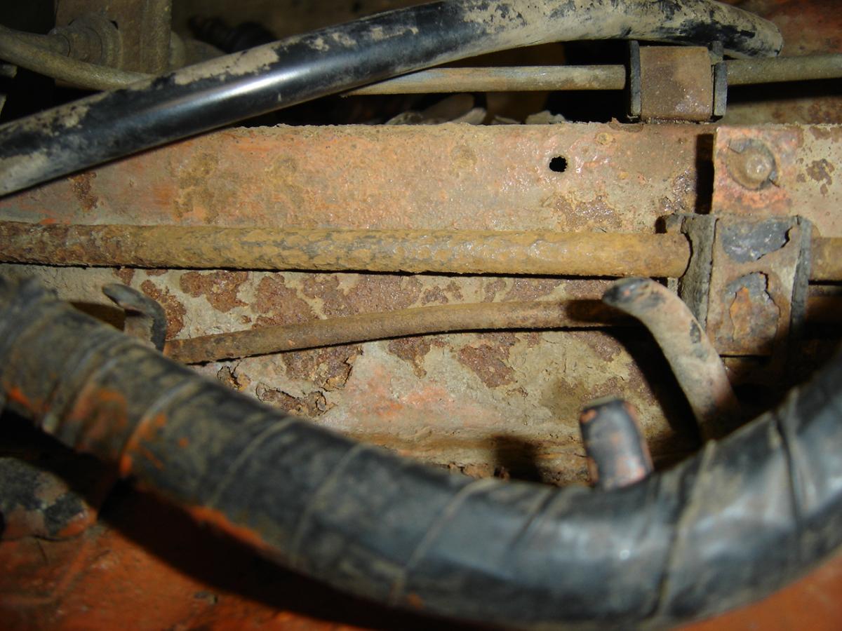

How were the hard fuel lines in the car with the tank damage you had?  Did you have the tank professionally reconditioned inside?

The hardline under the battery is pretty bad on the outside from battery acid dripping on it I suppose.  I'm just going to cut off the last few feet and clamp on some rubber fuel hose up to the fuel filter.  I have a clear filter right out of my gas tank's supply hose, Fram G2 worked best for the 240's smaller hose.  I ran a glass filter at the beginning of the fuel rail for a month or so and changed the stock filter on the passenger's side a couple of times.  It took about a month to get clear fuel up to the glass filter at the rail, I don't drive it much.  If you're brave enough to try it, blow some high pound fishing line through the hardline and pull a .22 caliber brass gun cleaning brush through.  I was too worried about it getting stuck, that's an old trick my Dad told me to do.  I think blowing air and maybe some lacquer thinner through there should be adequate.  I just put extra filters on mine and changed them when they got dirty.
Mostly I was just wondering if replacing the hardlines was a common thing with a car that has been sitting for so long. I guess since the fuel shouldn't ever be sitting in them if they are parked for a while, there isn't a big reason they would be rotted out. Maybe just gunky and in need of a good cleaning.
Good to know.  I was planning to pump some aerosol injector cleaner through the hard lines to get the process moving along quicker, and of course keeping an eye on the filter once it's running again.

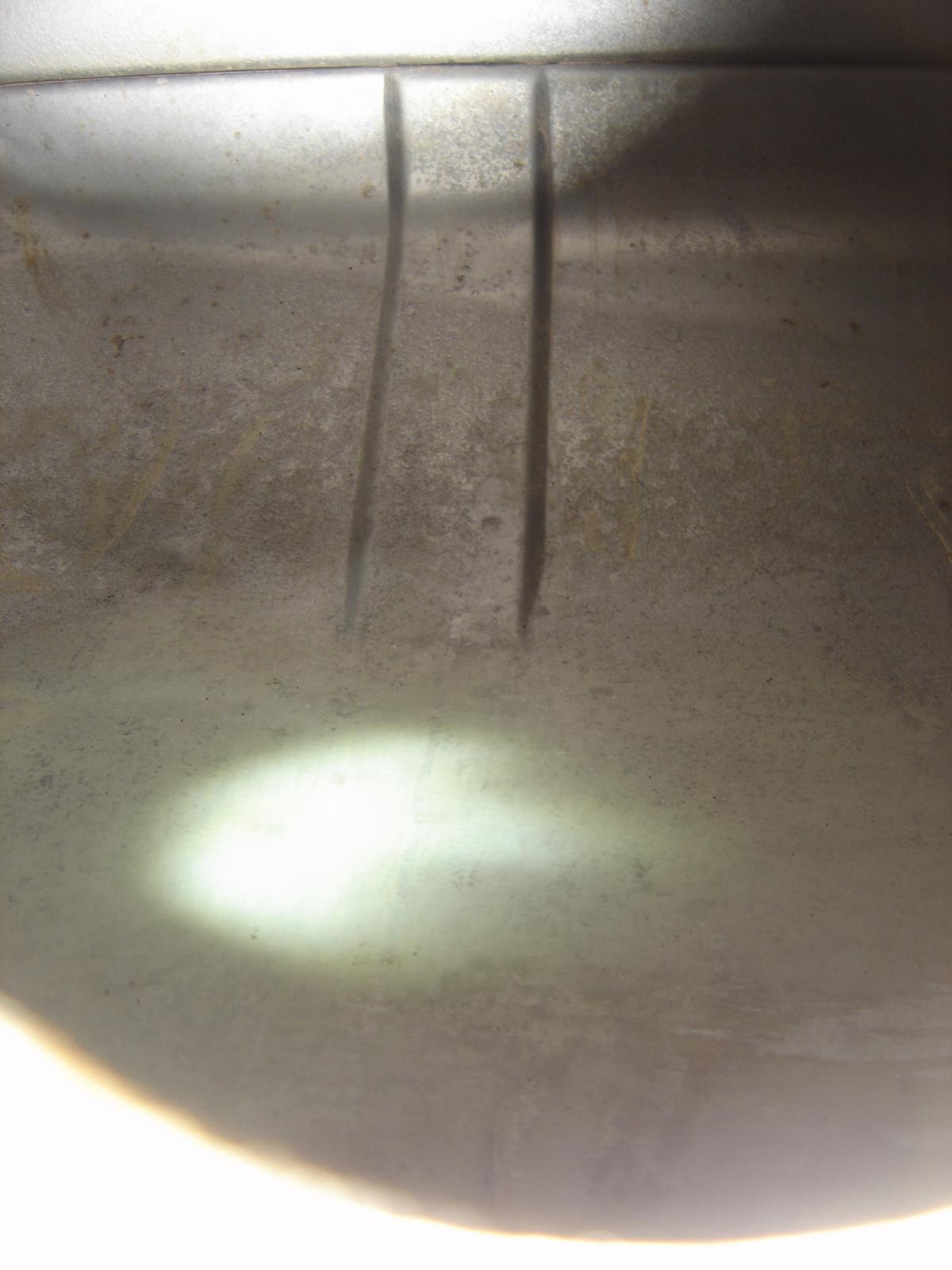

I had cleaned my 280s a few years earlier and learned a few tricks that made it easier.  Muriatic acid cleaned it and Red-Kote was what I used to line it.  Cost about $50 for everything to clean the inside of the tank, $30 for the red-kote, $10 acid and $10 for a quart of acetone.
