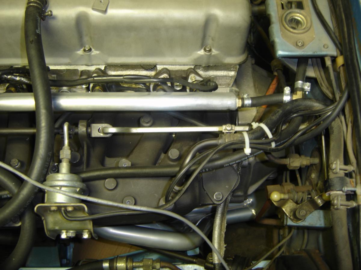

If you have the '78 fpr it has one inlet. The smaller tube on the bottom is the return line. That's the only style I could figure out how to work with my aluminium fuel rail. I teed it off the back end closet to the windshield.
Yeah, I meant a leak-down although I can smell just the slightest amount of fuel in the engine bay when the system is pressurized. It has aircraft fittings, a Russell filter and the aeromotive FPR. I've read the threads that mention the leak down tendency of the aftermarket FPR's and thought "screw this, I'm putting things back to stock", although I will keep the aftermarket fuel rail. I got a roll of EFI hose, a new OEM FPR and filter and had to get on EBAY for the filter bracket. I'm just going to put NPT-to-BARB fittings on both ends of the rail and maybe bolt the FPR to the firewall or something. The lines connecting the pump to the tank and hard lines are new.
I've got mine where the heater hoses go through the firewall, zip tied. LOL
You'll need a long piece of vacuum line too.
Edited by siteunseen
I couldn't remember why I had a "T" on that end, I'd forgotten about the cold start valve.  :wacko:
post-23570-0-56781500-1444476439_thumb.j
And this is all I could find for a thread sealant for brass into aluminum.
