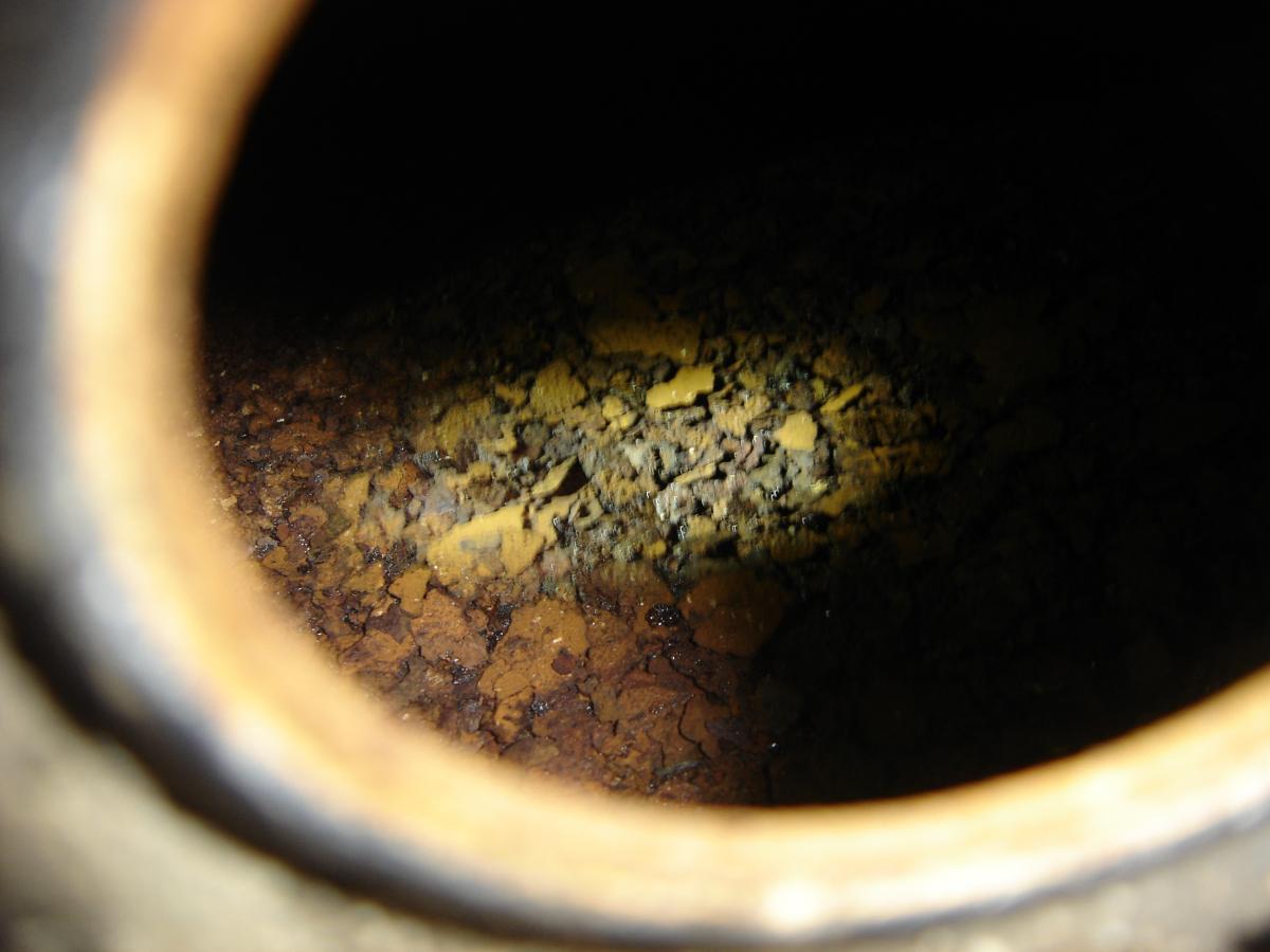

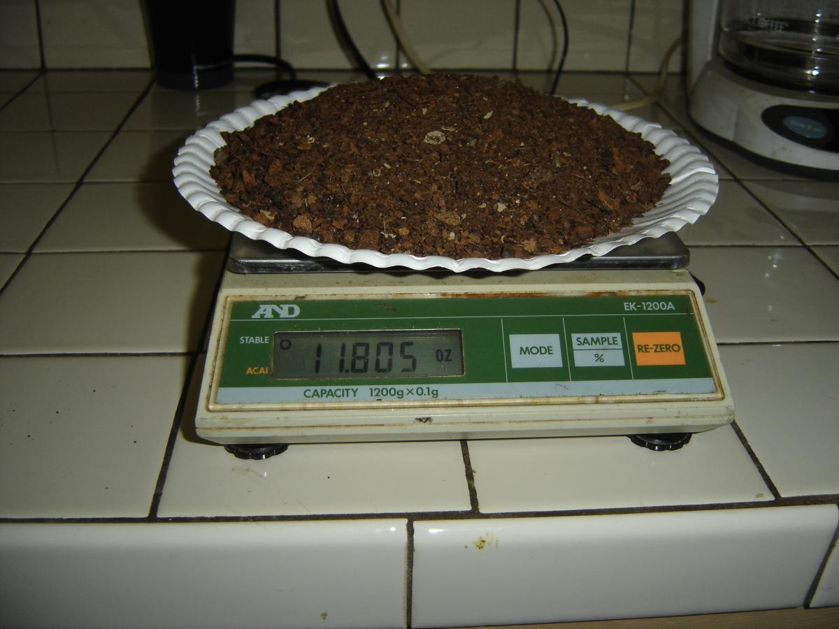

You can bypass the gas tank with a gas can.  Run a hose from the gas can to the "IN" nipple of the pump, then run a smaller hose from the fuel rail's return line into the gas can.  A 2.5 gallon plastic can fits perfect in between the radiator and grill on my 240.  Or when it won't restart, pull the supply hose off and blow into it until you hear gurgling from the tank.  I'll show you what was causing mine to quit after a few minutes then restart after all the crud settled.  Not rust, it wouldn't stick to a magnet, just crud that would crumble like dirt in my fingers.

Wow that is a lot of crud
As of right now we are running rebuilt bell top carbs new fuel pump and new lines running off a clean gas can we took the tank out to have it cleaned out waiting for it to get back then we will run new lines though out
