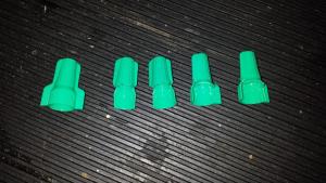

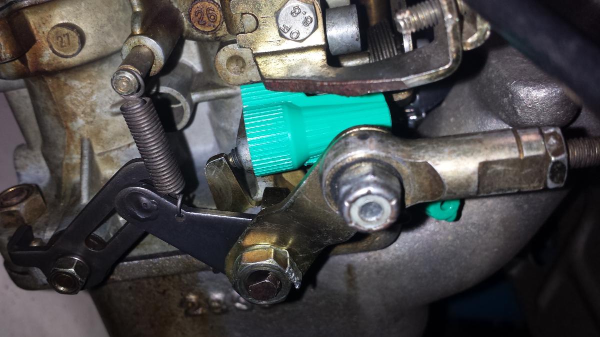

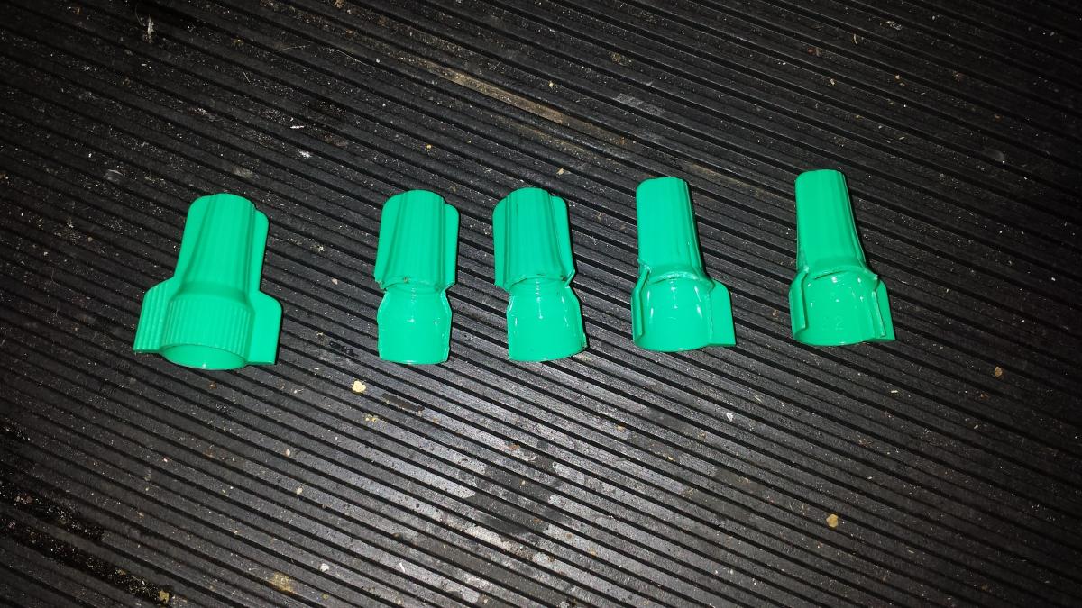

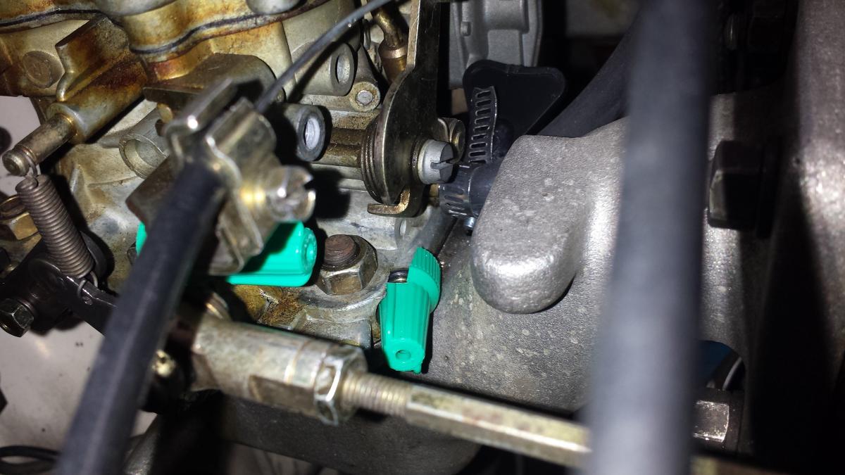

I envisioned making my own caps out of plastic when it occurred to me that a similar piece already exists in the form of electrical wire nuts with shrouds. I purchased some at Home Depot - 2 to 5 # 14 wire size. I punched out the spring locks from the back side with a 1/8" punch and trimmed the shroud to match the screw surrounding. My idle speed screw has a hex head instead of a knurled screw head, so I cut a slit in grabbing area to weaken it.
Here is what I came up with:
