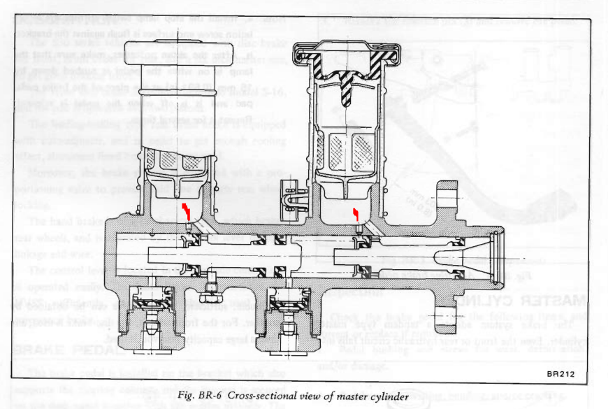

Just for fun, and a reason to study one of these excellent Nissan drawings.  As I understand things, it's possible to adjust the MC rod so far forward that the return hole to the reservoir, which also releases pressure, is never opened.  Brakes are bled cold, fluid heats up and expands, the pads and shoes are moved, car is slowed.
I highlighted the two holes that can get covered.  Never had it happen to me but it seems feasible and has been reported.  You can see how the piston seals are right next to the holes, so that pressure is created as soon as the pistons move.

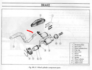

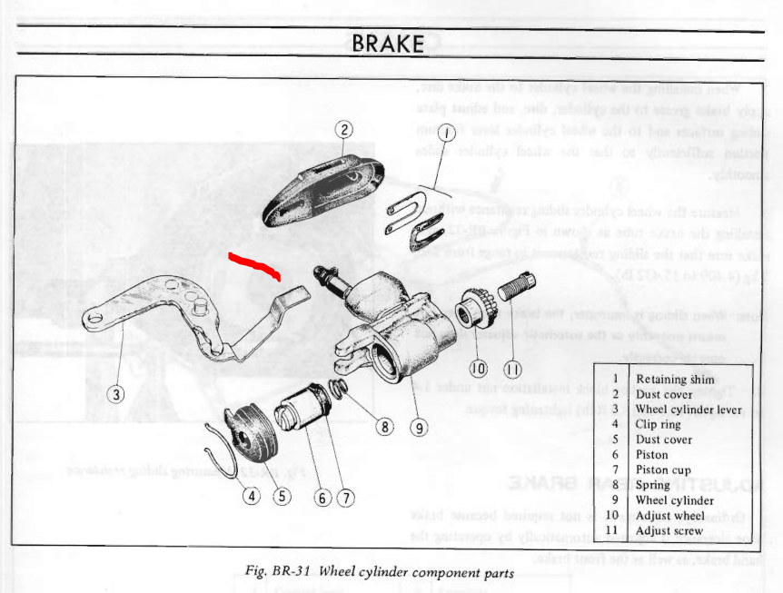

I think that it might be possible for the self-adjusting mechanism to over-turn the wheel in the adjuster.  I've studied it and the little arm that grabs a tooth and moves it is meant to have a certain limited travel.  So that it can only grab the next tooth after certain amount of wear allows the lever's starting point to drop back to the next tooth.  And the width of the arm causes it to ride on top of the teeth until the proper moment arrives.  For many brake lever pulls the adjusting arm just slides back and forth on top of the adjusting wheel teeth.  Until, finally, it can drop down, grab a tooth, and move it forward.
Considering the beating that brakes take when we replace the shoes it wouldn't be a surprise to find that arm malformed or worn.
Could also be that the external stop, or bumper, that determines the starting position of the external portion of the brake lever,  is allowing it to drop back too far, allowing it to grab a tooth early and move it too far.
