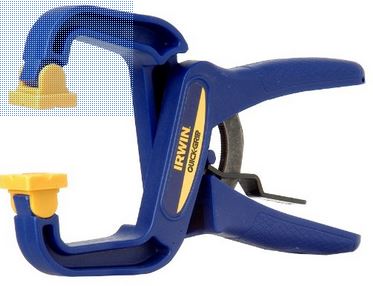

July 11, 20159 yr comment_473620 Jai, I think I read that you said you have vice grips. If you are careful to not crush and damage the hose you could use vice grips on one side and the hemostats on the other. Hemostats are a good idea that I need to remember. I use them to hold wires when I solder. Â Site, the "wood clamps" I was thinking of are the small plastic quick / squeeze clamps. Here is a link to a $5 option. Â http://www.amazon.com/Irwin-Tools-59400CD-Quick-Grip-Handi-Clamp/dp/B00005RHP0/ref=pd_sim_469_8?ie=UTF8&refRID=1G5V56FJVTXBS4NSEJNT Â Â Link to comment https://www.classiczcars.com/forums/topic/51762-to-dream-the-impossible-dream-redwings-z-cars/?&page=7#findComment-473620 Share on other sites More sharing options...
July 11, 20159 yr comment_473621 Actually you only need to stop the flow from the tank, so just one clamp.  Read through this;  http://atlanticz.ca/zclub/techtips/fuel/g3filter/index.htm I'm sorry Jonathan, you're way is safer.  I was typing while you posted. If you have a paint stir stick break off two pieces and put that in the jaws of your vise grips so it won't cut into the hose.  If you could get a pieces of rubber hose over the jaws that would work too. Edited July 11, 20159 yr by siteunseen Link to comment https://www.classiczcars.com/forums/topic/51762-to-dream-the-impossible-dream-redwings-z-cars/?&page=7#findComment-473621 Share on other sites More sharing options...
