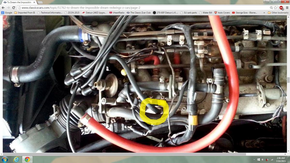

July 9, 20159 yr Author comment_473512 If Jonathan's method works (and he's used it, so he should know), go for it! Link to comment https://www.classiczcars.com/forums/topic/51762-to-dream-the-impossible-dream-redwings-z-cars/?&page=5#findComment-473512 Share on other sites More sharing options...
July 10, 20159 yr comment_473514 Jai,I would say my method has worked for me but I had never really thought about Sarah's until I just looked up your other thread and read her method. The downside to my method is you saturate your air filter (it will dry, fyi) and you will probably use more starter fluid with my method. Sarah's method is just as easy...maybe easier because you don't need to remove the air filter cover bolts which can be a pain in your car. You just remove one of the small rubber hoses that connect into the top of your intake manifold (the big cast aluminum thing on the top driver's side of your engine) and spray in. As she mentioned...you need a straw to direct the spray into a small hole. You could choose the rubber hose that connects your intake manifold to the carbon canister (see fsm). You could use the hose that connects to the brake booster. Lots of options. Link to comment https://www.classiczcars.com/forums/topic/51762-to-dream-the-impossible-dream-redwings-z-cars/?&page=5#findComment-473514 Share on other sites More sharing options...
July 10, 20159 yr comment_473532 I have used both methods and both worked. The manifold test work in one case. I had a lot of water in the fuel and it wouldn't do anything. The other case was a bad ignition module that would stop working when it got hot. I was on the side of the road and the air cleaner was the quickest access.I did take the air filter out and spray down towards the afm while starting the engine.For the manifold method I used the brake booster port. It will mostly run on the back three cylinders with this method (because the brake booster port is at the back of the manifold), but it proves the ingnition is working or not. You are not ment to run the engine on this stuff. Its just to identify what is not working: fuel or spark. Link to comment https://www.classiczcars.com/forums/topic/51762-to-dream-the-impossible-dream-redwings-z-cars/?&page=5#findComment-473532 Share on other sites More sharing options...
July 10, 20159 yr comment_473535 Â I would think it should go after the throttle plate, on the manifold side. Â The hose from the cannister like Jonathan mentioned would be my choice. Â Link to comment https://www.classiczcars.com/forums/topic/51762-to-dream-the-impossible-dream-redwings-z-cars/?&page=5#findComment-473535 Share on other sites More sharing options...
July 10, 20159 yr comment_473542 Ok siteunseen, I see your mark on the photo. One question for the hose when pulled. Is the hose removed from the manifold end or the other end? Ummm, what I am really trying to ask is once the hose is pulled, does the starter fluid go directly into the manifold, or from the other end of the hose? Squirting into the hose end, for it to travel the length of the hose to the manifold? Using a straw natch.Thank you,Jai Link to comment https://www.classiczcars.com/forums/topic/51762-to-dream-the-impossible-dream-redwings-z-cars/?&page=5#findComment-473542 Share on other sites More sharing options...
July 10, 20159 yr comment_473545 I have in my hand the same Polar starting fluid can that you have. I see no provision for attaching a straw to it. I don't think it will matter though. Here is what I would do..... Remove the hose Site circled above at the manifold. This hose is held in place with a small spring type hose clamp. All you need to do is use needle nose pliers or similar to squeeze the two protruding "arms" on the clamp together and then, while continuing to squeeze the arms slide the clamp up the hose away from the manifold. After that, turn the hose at the manifold a few times to free it up and pull off. Once the hose is off, I think you will be able to situate the spray nozzle very close to the fitting opening where the hose was and direct the spray from the can into the manifold. Spray for 3-4 seconds. You can loosely place the hose back on the fitting...doesn't need to be re-clamped yet. Try to start. If not, spray a bit more. If nothing, then you will know your problem....at least in terms of starting....is likely something other than fuel. I say "likely" because you could have a coincidental fuel problem and ignition problem...however unlikely. If it starts, you know you have some sort of fuel problem. Remember, it won't run. You just want to know whether the starting fluid gets the car to start...even for a second or two. Link to comment https://www.classiczcars.com/forums/topic/51762-to-dream-the-impossible-dream-redwings-z-cars/?&page=5#findComment-473545 Share on other sites More sharing options...
July 10, 20159 yr comment_473559 JohnathanShe will start now, but will quit whenever she decides, 1 block, 1 mile...+ --. No reliability at all. So this is done after she quits, right? Best to do is start her and let run until she decides to quit, right? Then rush in and do this test, right?My needle nosed pliers will be arriving in the next few days, and when the are here I will do the test as you described to me.I will let you and all know the outcome! Thank you... Link to comment https://www.classiczcars.com/forums/topic/51762-to-dream-the-impossible-dream-redwings-z-cars/?&page=5#findComment-473559 Share on other sites More sharing options...
July 10, 20159 yr comment_473564 I was sort of under the impression that the car now would no longer start. My mistake. Still, doing what you just described is, to me, the right step to take. I would say...when it stops again 1) confirm that it won't start and then 2) do the starter fluid test. Don't burn yourself working on the hot engine. BTW, it can be any pliars that work...I just typically use needle nose for that particular clamp. And...if you get nervous about removing the vacuum line....go back to the method where you open the air cleaner and spray into it while someone starts the car...pressing the accelerator pedal some while starting. And, someone else mentioned removing the air filter and just spraying without the filter in place (that way you don't saturate your filter). Link to comment https://www.classiczcars.com/forums/topic/51762-to-dream-the-impossible-dream-redwings-z-cars/?&page=5#findComment-473564 Share on other sites More sharing options...
