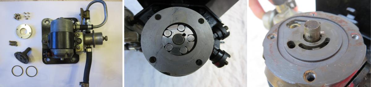

Here is my fuel pump. It will give you an idea what it looks like inside. Its a pretty simple design. Make sure you note the order the parts coma apart so you can rebuild it in that order.

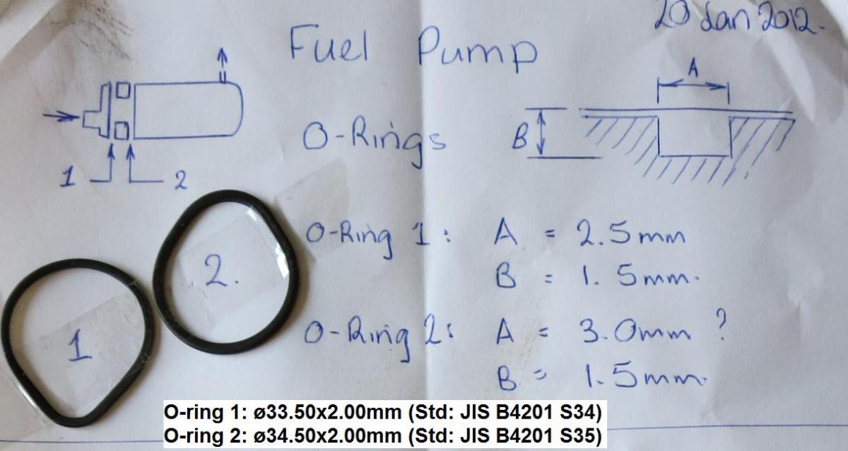

The 2nd photo is a calulation for the o-rings I used on my pump. If you need new o-rings make sure you use Viton or NBR material.
I prefer NBR because of the hazards associated with viton if exposed to very high temperatures like fire. You never know...

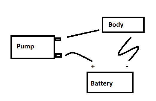

Since you have a wire directly from the battery, you can test the pump separately from the rest of the harness.  Make another shorter jumper wire and connect it directly to the car body.  Then disconnect both wires from the pump, connect your positive wire from the battery to one of the terminals, doesn't really matter which one, then touch the wire that's connected to the body to the other pump terminal.  You should see a spark, showing that the circuit back the battery is complete, through the pump motor.  The pump will either spin or it won't.  If it doesn't, you might as well tap on it with the wires connected to see if you can break it loose.
