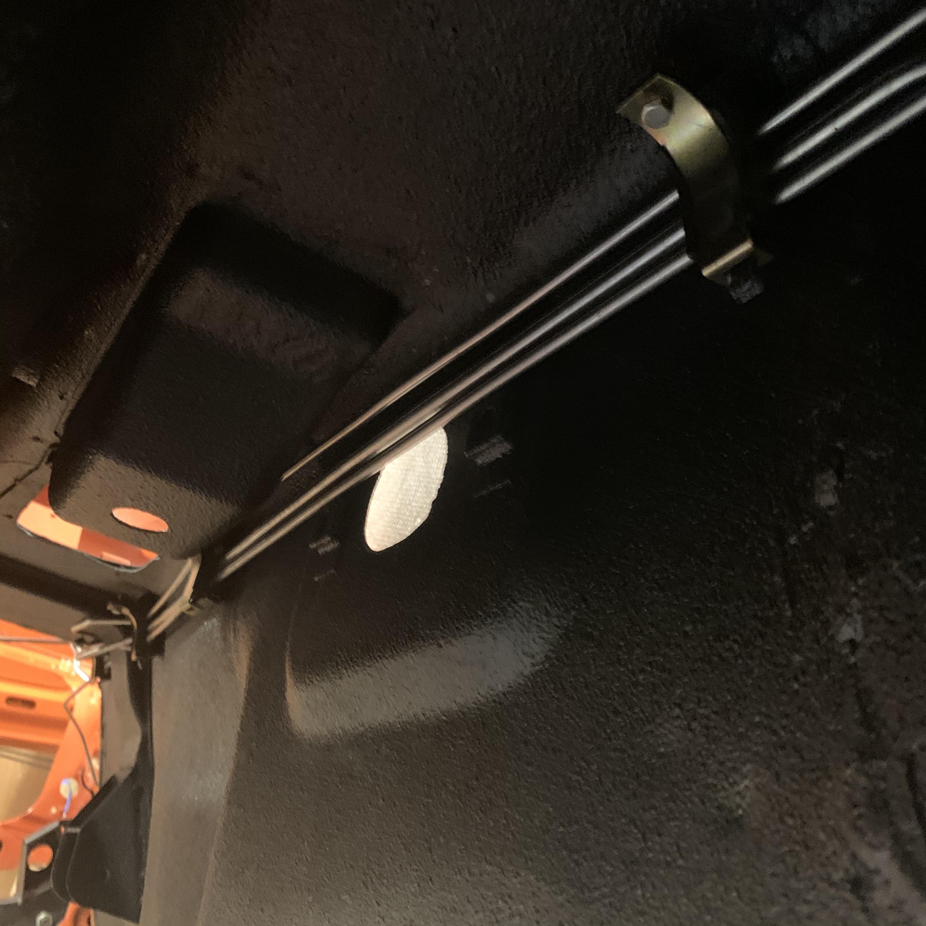

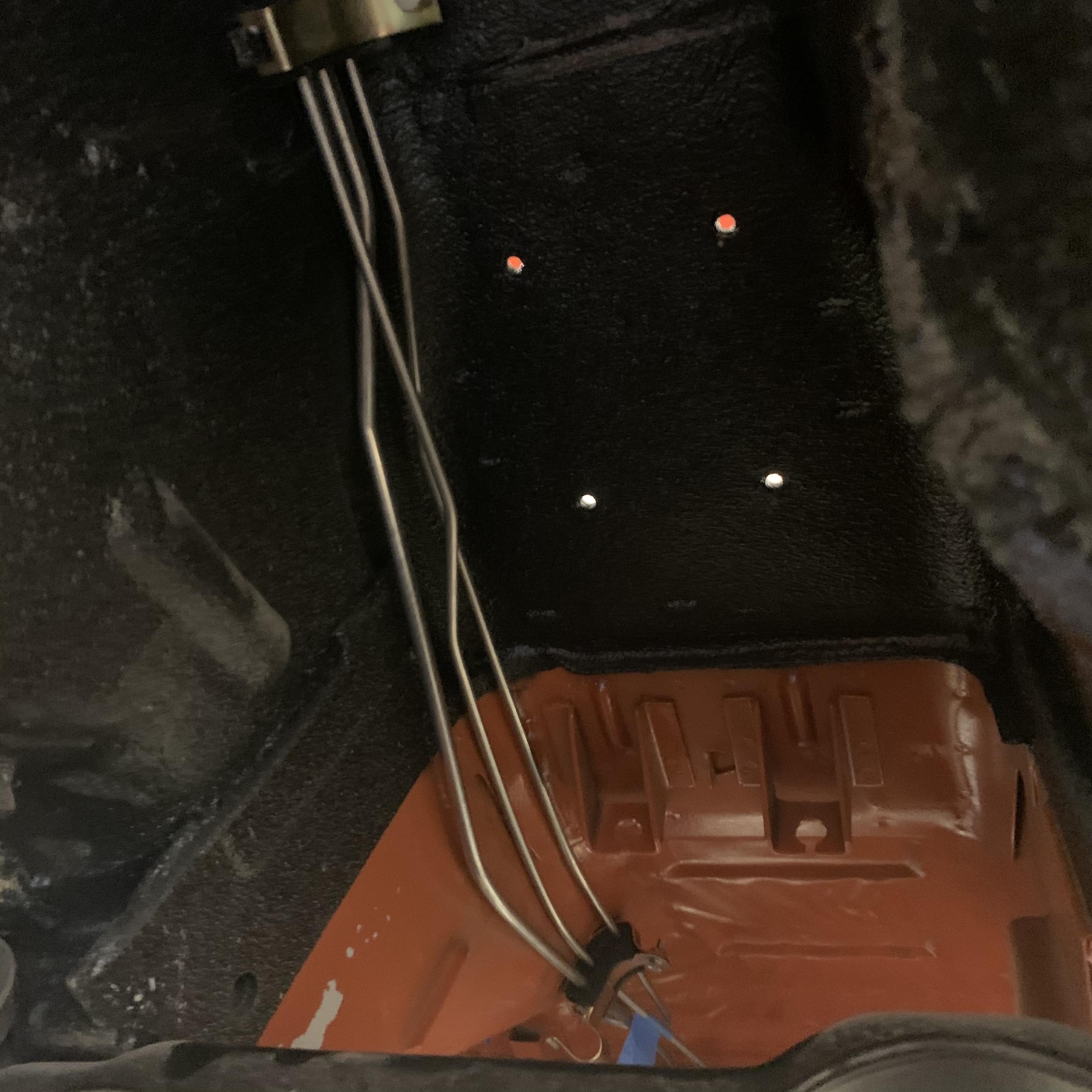

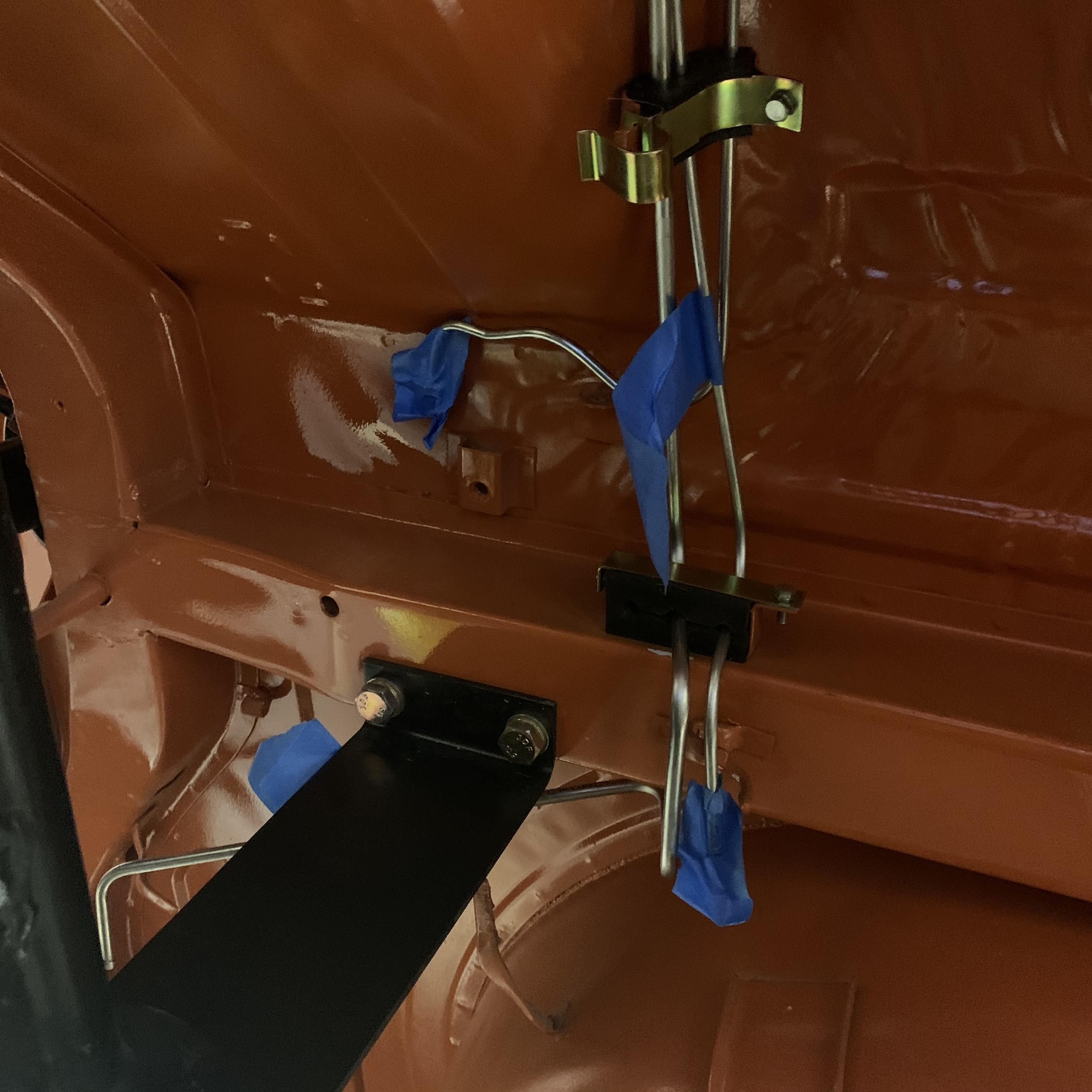

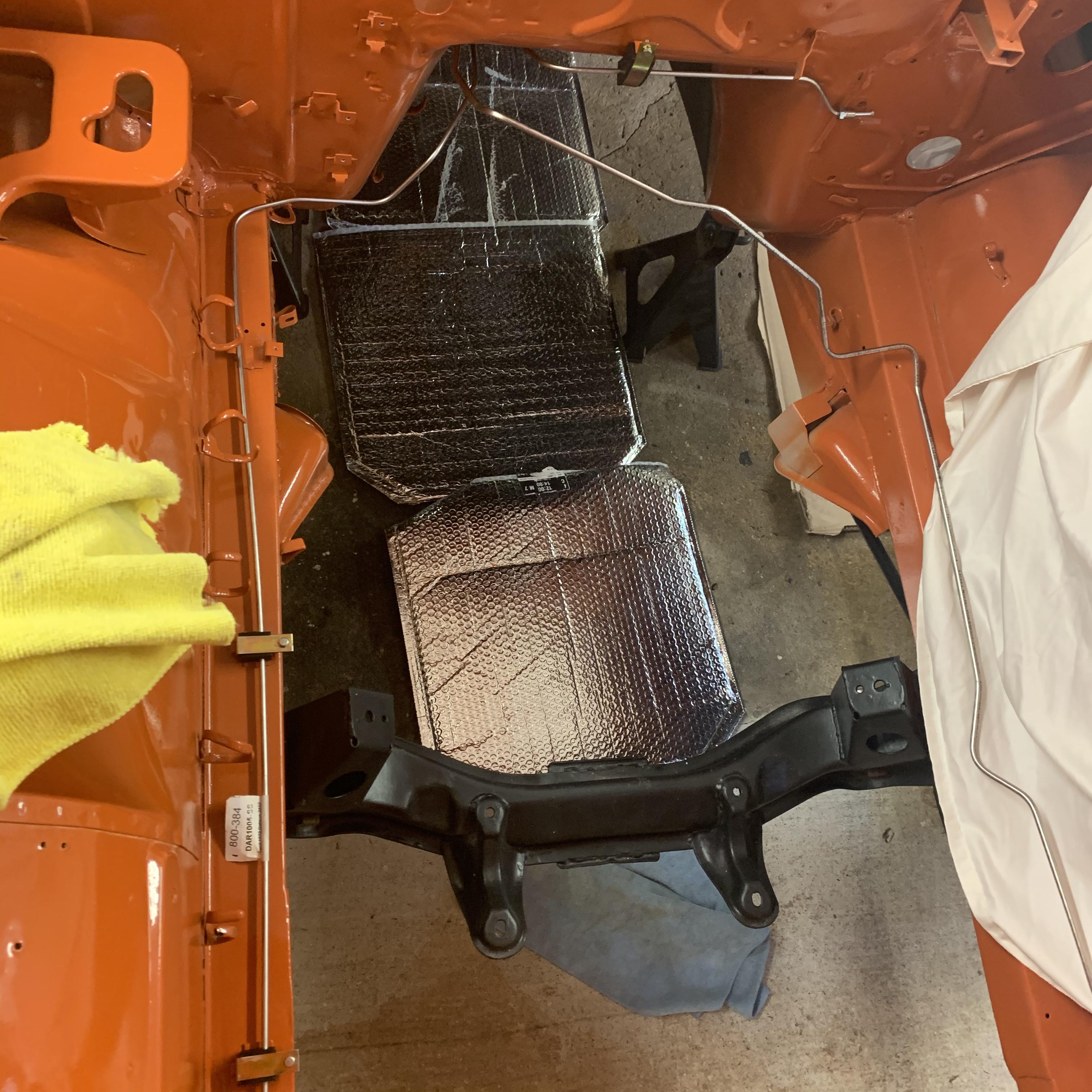

July 19, 20205 yr Author comment_603068 Okay, I’m stuck on something: I bought my stainless fuel and brake lines way back, and now that I’m trying to get them in, they aren’t looking right. Here’s a shot of how I have them right now, but I can’t find any good photos to verify that this is correct. The main fuel line is bent in such a way that it ends up on the left side, but that looks wrong to me. Isn’t that line supposed to go along the right side with the return line? The bends just look wrong to me.   This all looks like a mess to me. This is supposedly the ‘73 kit from Z Car Depot by Classic Tube, which I’m realizing now was probably a mistake because I’m going with a ‘72 Euro configuration for the fuel system. But there are other issues beyond the engine bay. The fit is just poorly. can anyone help me figure this out? Edited July 19, 20205 yr by Matthew Abate Link to comment https://www.classiczcars.com/forums/topic/51541-1973-rebuild/?&page=73#findComment-603068 Share on other sites More sharing options...
July 19, 20205 yr Author comment_603081 Okay, so I think I really goofed it. Looks like I’ll be ordering a whole new set of lines. Z Car Depot has three lines: Fuel Line Stainless Steel Tank to Carb 240Z 70-72, $179.00 Fuel Line Vapor Stainless Steel 240Z 1972, $179.00 Fuel Return Line Stainless Steel 240Z 70-72 , $149.00 Major bummer. ___ The questions I have now are these: Can I use the ‘73 return line I have? Do I need the vapor line? What do I do with the lines I have? Edited July 19, 20205 yr by Matthew Abate Link to comment https://www.classiczcars.com/forums/topic/51541-1973-rebuild/?&page=73#findComment-603081 Share on other sites More sharing options...
July 19, 20205 yr comment_603083 I'm not sure what a Euro configuration should look like but this looks like you are missing either the supply line or return line completely. The line running to the left side should be the fuel tank vapor line that connects to the flow guide valve mounted below the coil. The diameter of the line on the right side will clue you as to what is missing - the supply line is significantly larger than the return line. http://www.carpartsmanual.com/datsun/Z-1969-1978/engine-240z-260z/fuel-piping Link to comment https://www.classiczcars.com/forums/topic/51541-1973-rebuild/?&page=73#findComment-603083 Share on other sites More sharing options...
July 19, 20205 yr Author comment_603085 Yeah, I’m missing the main supply line. The euro setup deletes smog stuff. Does anyone know if this line crossing to the left is the right vapor line or will work? Pretty sure it’s the ‘73 one, but my car didn’t come with this line and I don’t see the mounts. I’m having trouble finding clear photos or diagrams of where that line mounts and attaches to the engine. Edited July 19, 20205 yr by Matthew Abate Link to comment https://www.classiczcars.com/forums/topic/51541-1973-rebuild/?&page=73#findComment-603085 Share on other sites More sharing options...

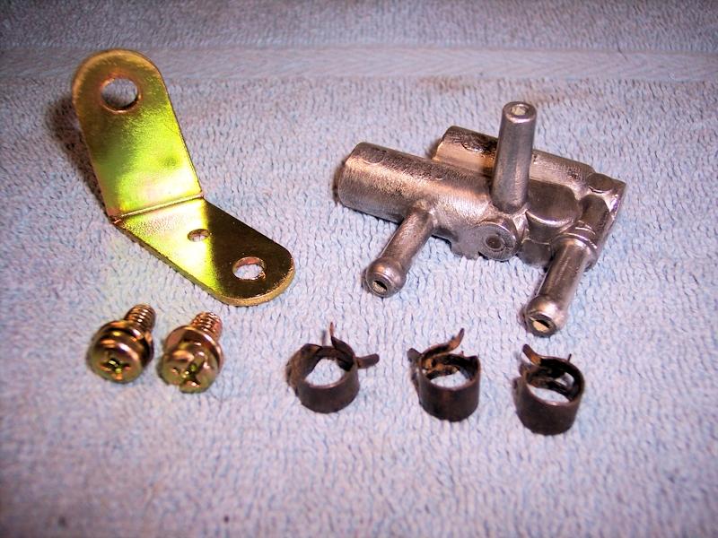

July 19, 20205 yr comment_603092 Matt - here's a pic of the flow guide valve, slightly diferent versions on each year but essentially the same. It mounts to the inner fender wall beneath the ballast resistor. Check this diagram for the hose routing - one line from the small tube on the crankcase breather pipe, one short hose from the tank vapor line in your pic, one line to the back of the air filter to feed the vapors into the carbs. The valve is #57. http://www.carpartsmanual.com/datsun/Z-1969-1978/engine-240z-260z/emission-control-device Link to comment https://www.classiczcars.com/forums/topic/51541-1973-rebuild/?&page=73#findComment-603092 Share on other sites More sharing options...
