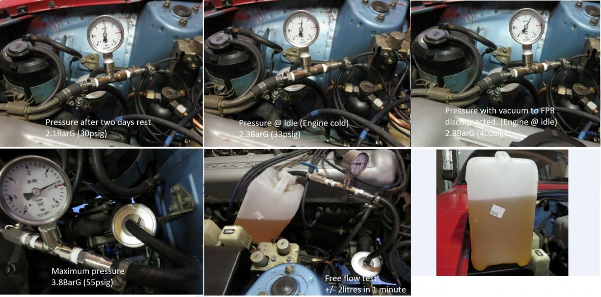

April 27, 201510 yr comment_468697 Just to add to FastWoman's post. If you scroll down the xenons30 page you will find the 280Z/ZX Electronic Fuel Injection Guide, 3.8MB PDF File. Its well worth reading and the trouble shooting guide is good for finding faults. Â As for your starting problem: You could have problems with flow and low fuel pressure. A simple pressure gauge will tell you a lot about the system. I used a fuel gauge to iron out some problems I had. Link to comment https://www.classiczcars.com/forums/topic/51385-throttle-issues-and-now-car-wont-start/#findComment-468697 Share on other sites More sharing options...

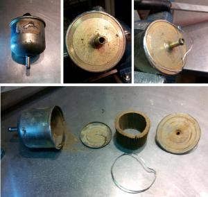

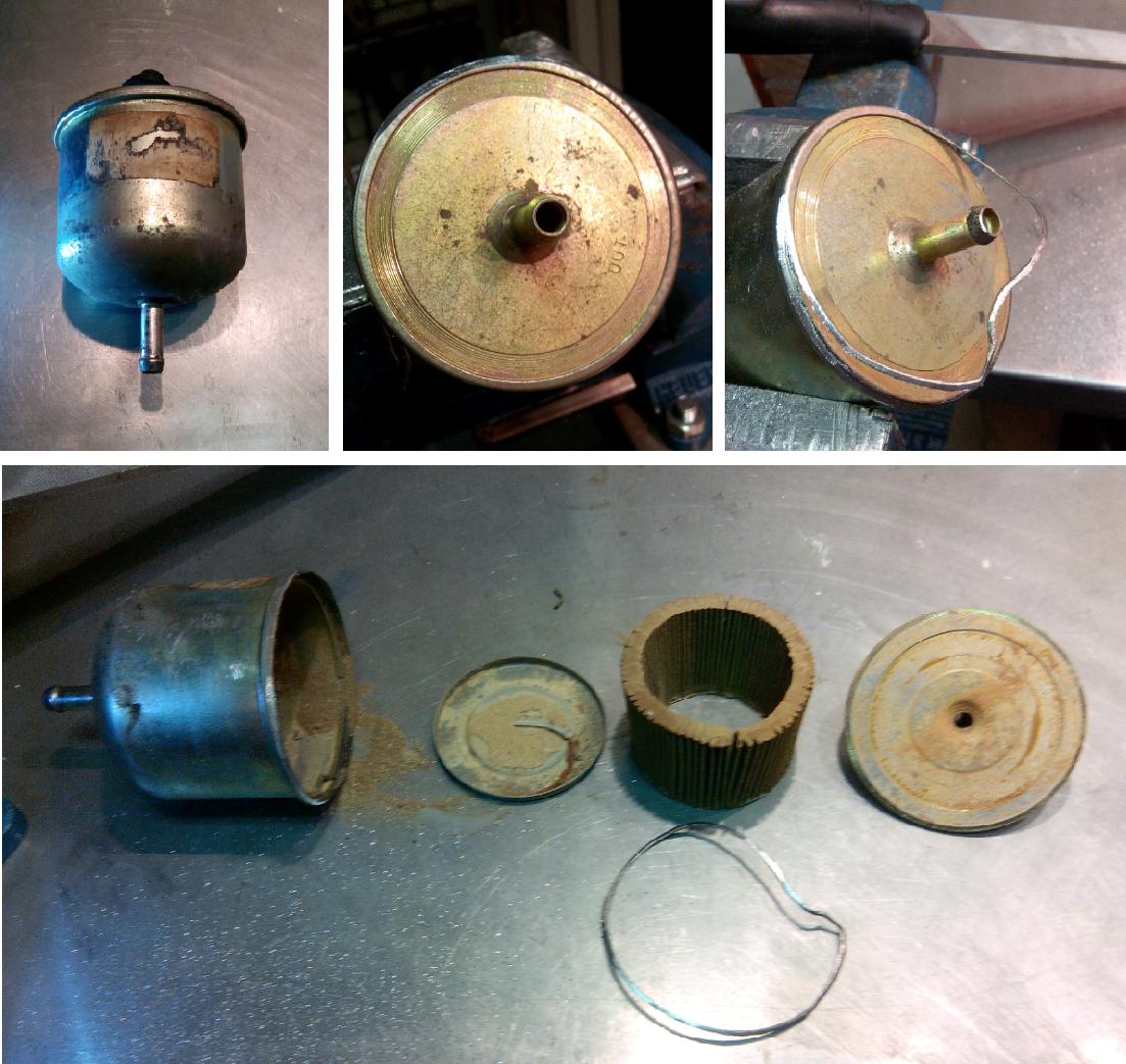

April 27, 201510 yr comment_468698 And btw if it has a really old filter chances are its failed and allowed a lot of crap through to the injectors and FPR. They could be bloked and or the FPR could be stuck open with crap in it. I changed my old filter when I got the car. The car was sitting for a long time. This is how it looked when I cut it open. Â Link to comment https://www.classiczcars.com/forums/topic/51385-throttle-issues-and-now-car-wont-start/#findComment-468698 Share on other sites More sharing options...
