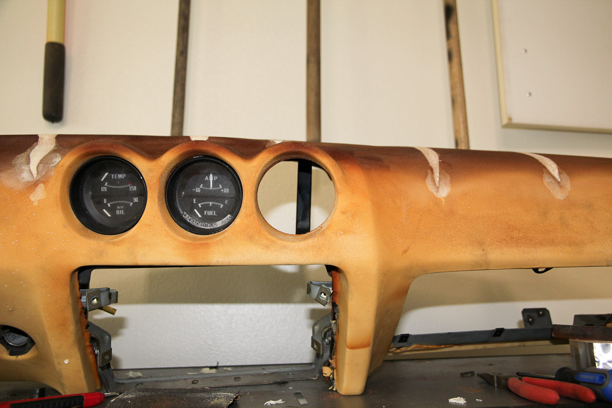

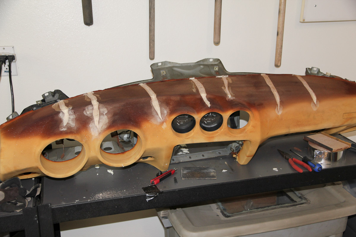

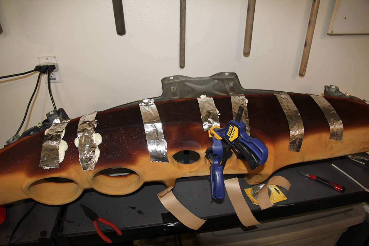

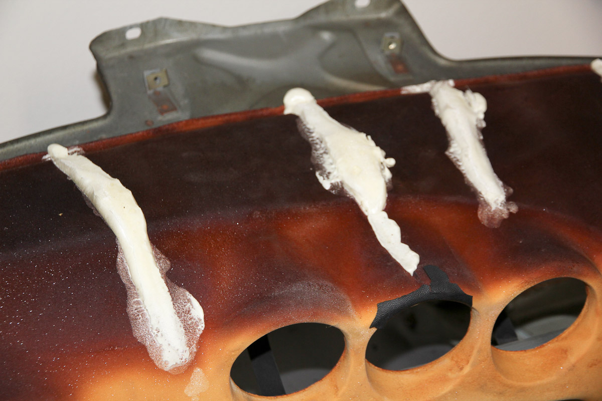

So far, so good.  Working first to fill the cracks and get the dash back into shape.  Like others, I've used the Great Stuff foam to fill the cracks.  I stuck some galvanized wire into the largest crack over the center gauge since it's thin and has nothing else behind it.  I put tape over the cracks thinking it might reduce the expansion and make it denser, but I don't think it made a difference or was worth the effort.
Side note: I'm a little surprised people have had good and/or long lasting results with the Great Stuff foam, given how much more compliant it is than the rest of the dash.

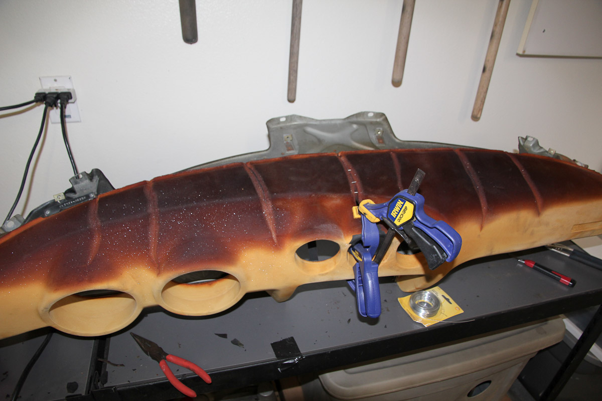

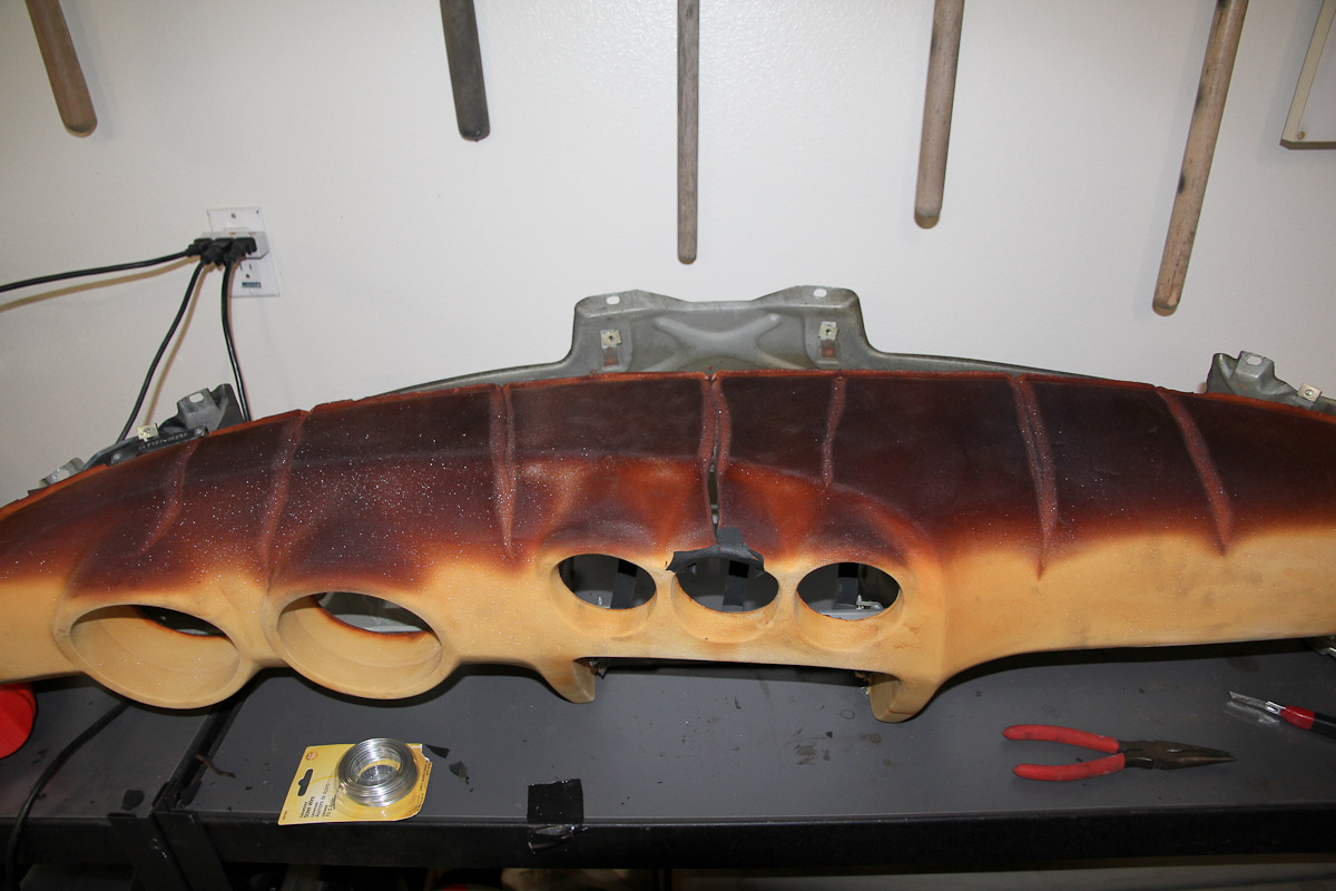

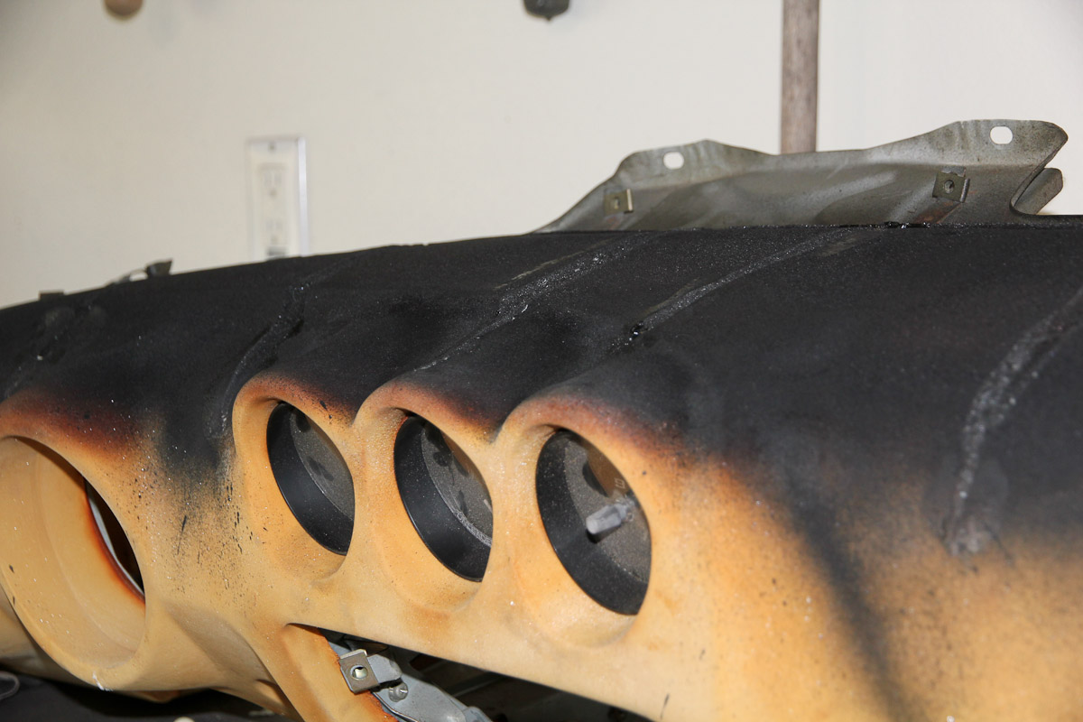

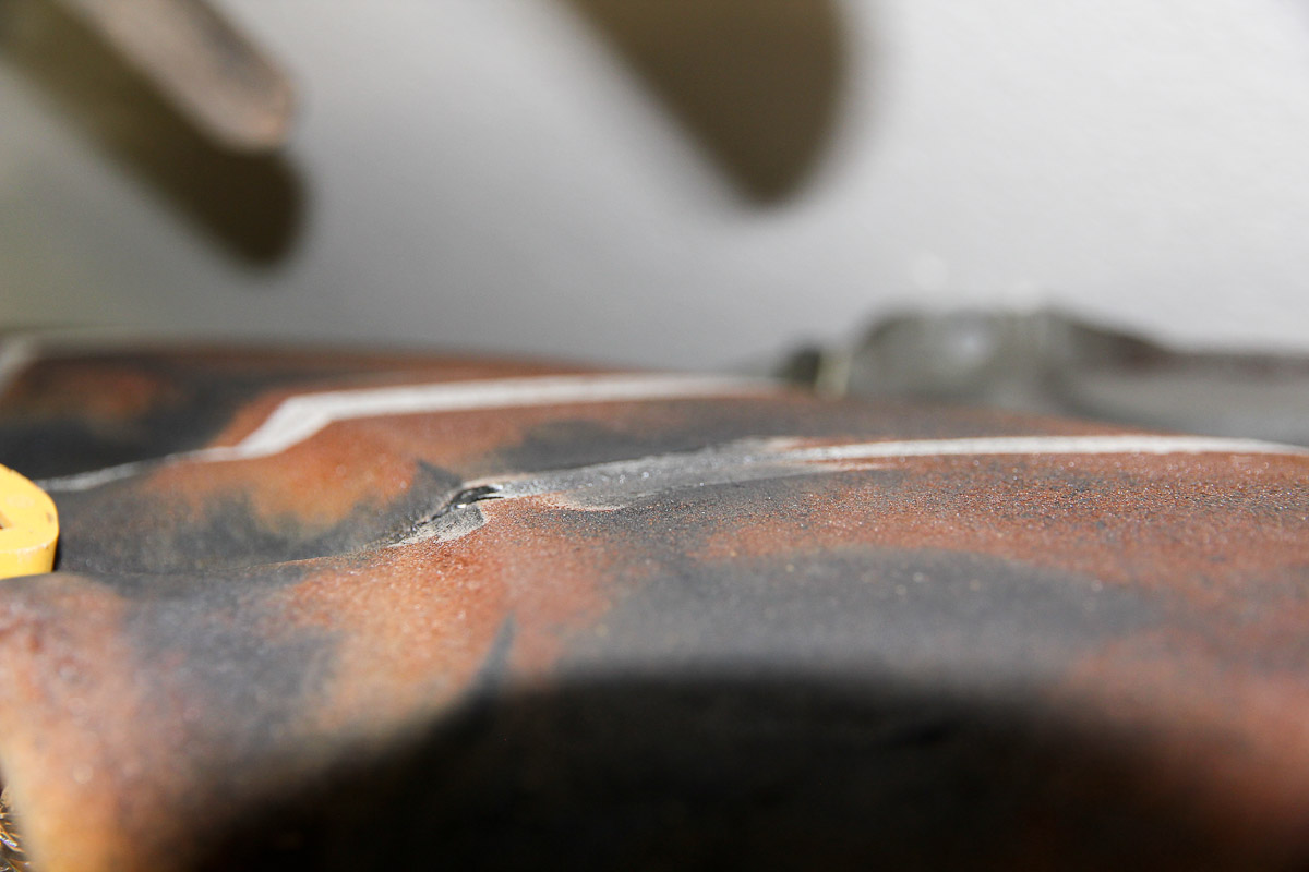

Trimmed off the excess and started with rough shaping, then continued sanding to try and level everything out.  Shot a light coat of black paint to try and highlight trouble spots.  It's looking pretty good: still some bumps to smooth out and I need to clean up the curve around the gauges.  I'd like to get the small gauge housings a bit closer to round as well, especially the clock.  Might be able to lay the first layer of glass by next weekend...if UPS can move fast.
I think that the compliancy of the Great Stuff foam may actually be a plus rather than a minus.   After 40+ years, the original foam has about zero compliancy left, so the stuff that goes in to fill the cracks has to be able to give as the dash surface grows and shrinks with radiant heat and changes in interior temperature.  For my repaired dash, my biggest fear is that the top, skim coat of 'Bumper Bite' repair compound won't have the same degree of compliancy as the foam underneath it.  The top coat is only bonded to the original vinyl skin by the width of that skin, and if the bond fails, a crack will emerge.   I beveled the OE vinyl skin so as to increase the width of the bond line, but that still only makes the bond along each seam about 3mm in width.  Only time and sunlight and temperature will tell the tale.  Since I completed the repair, my dash has been stored in the basement for 2 years, waiting to be re-installed in the car.

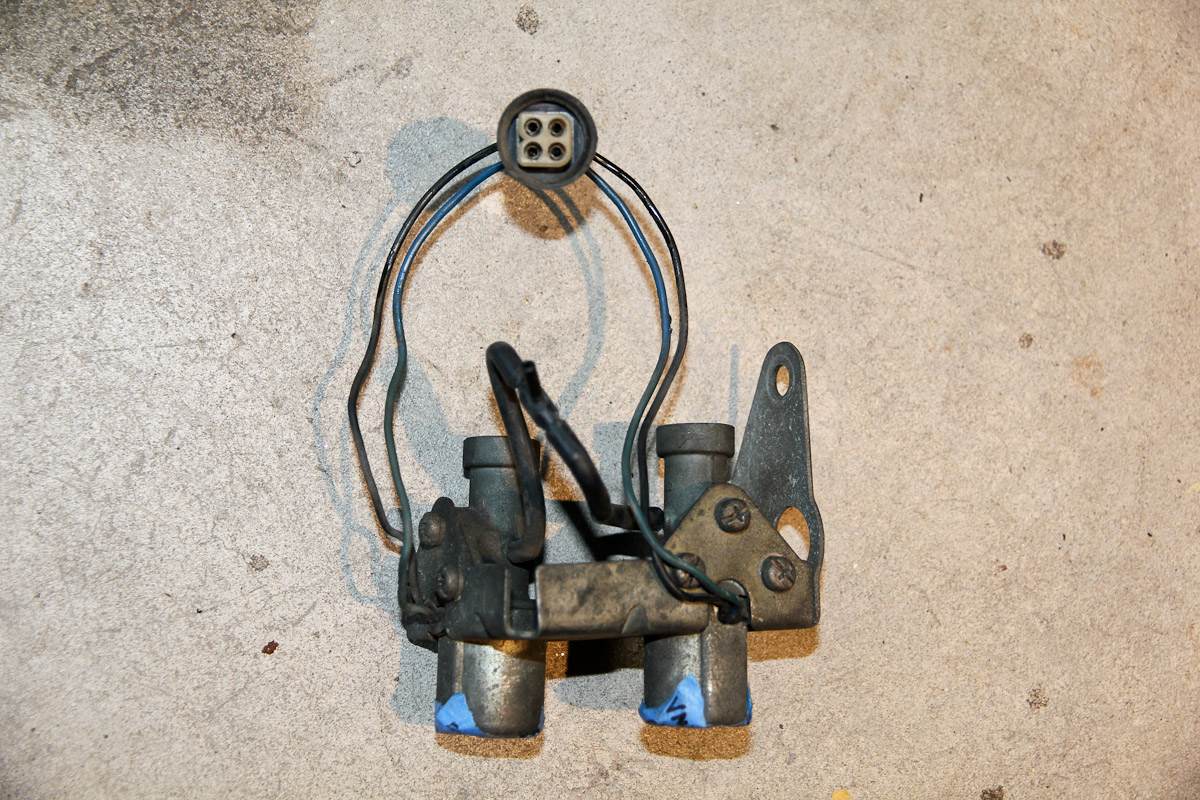

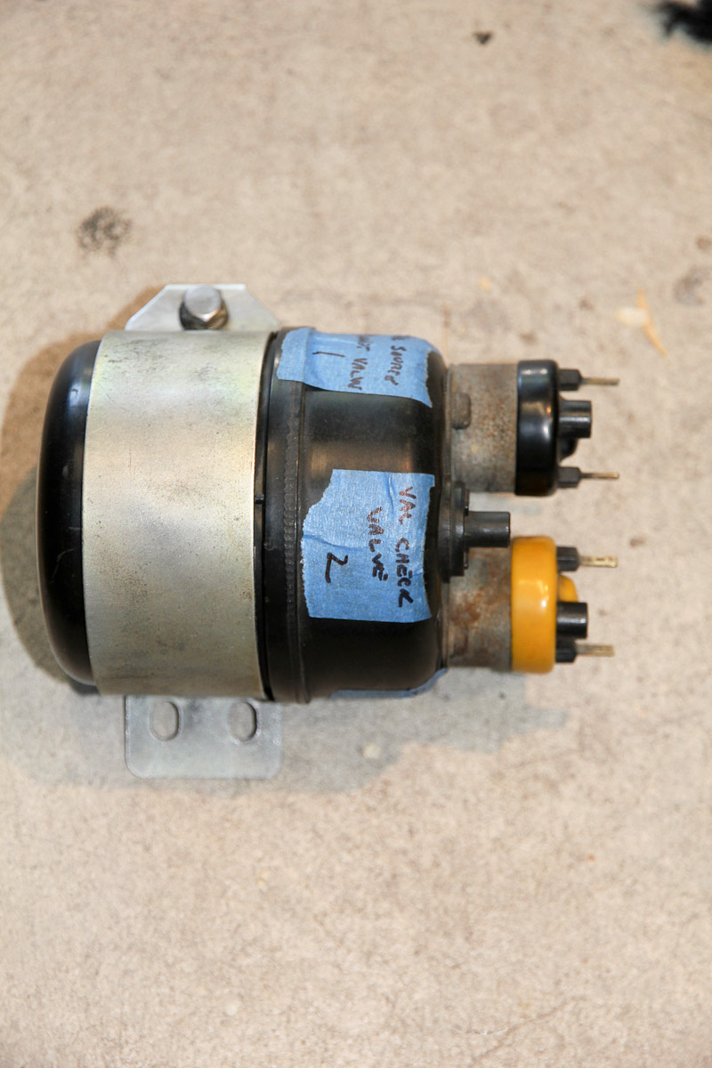

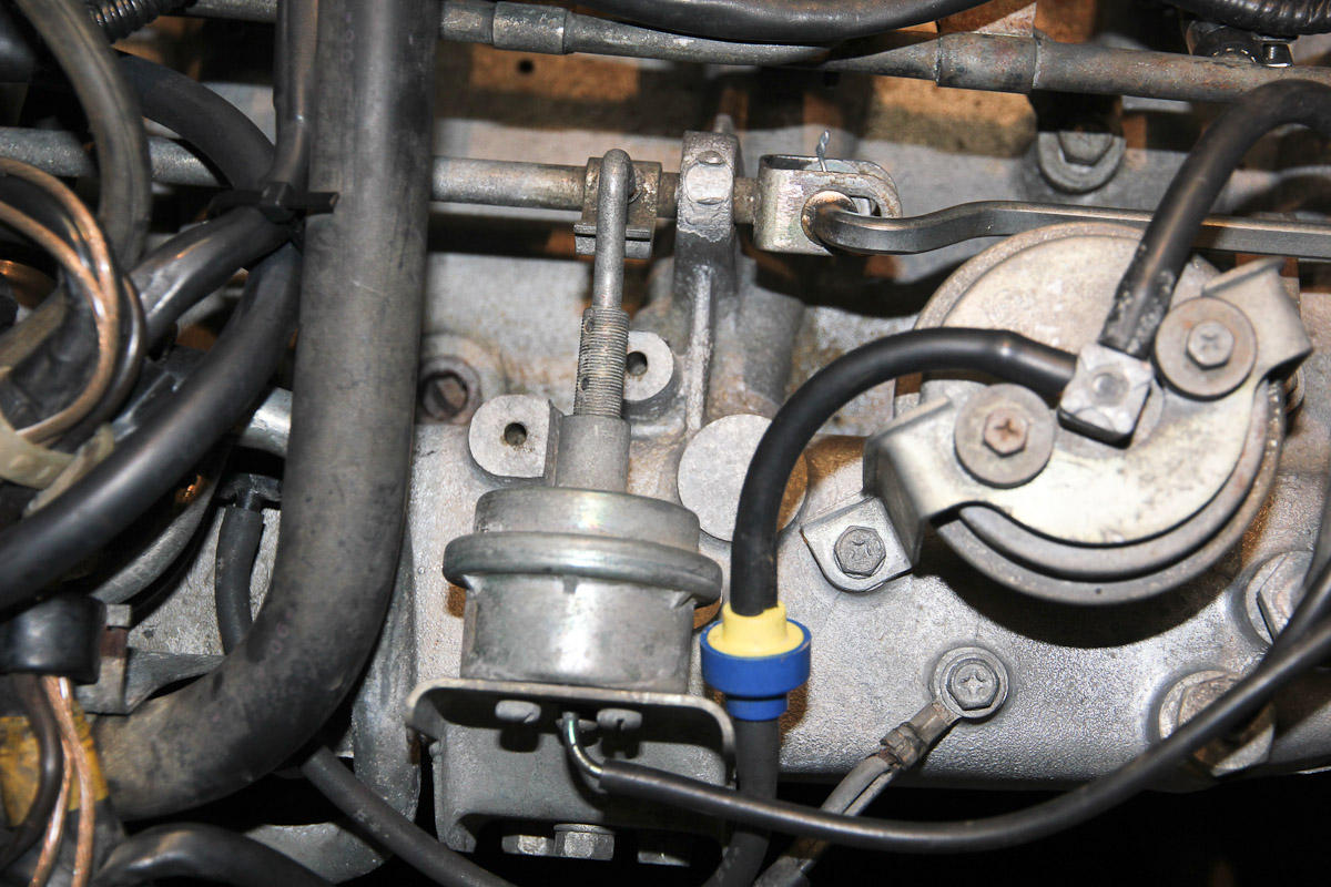

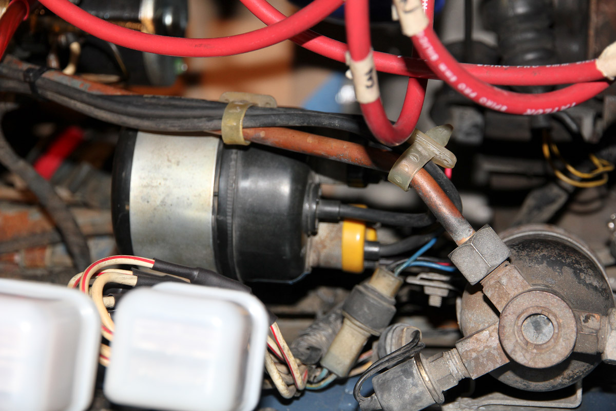

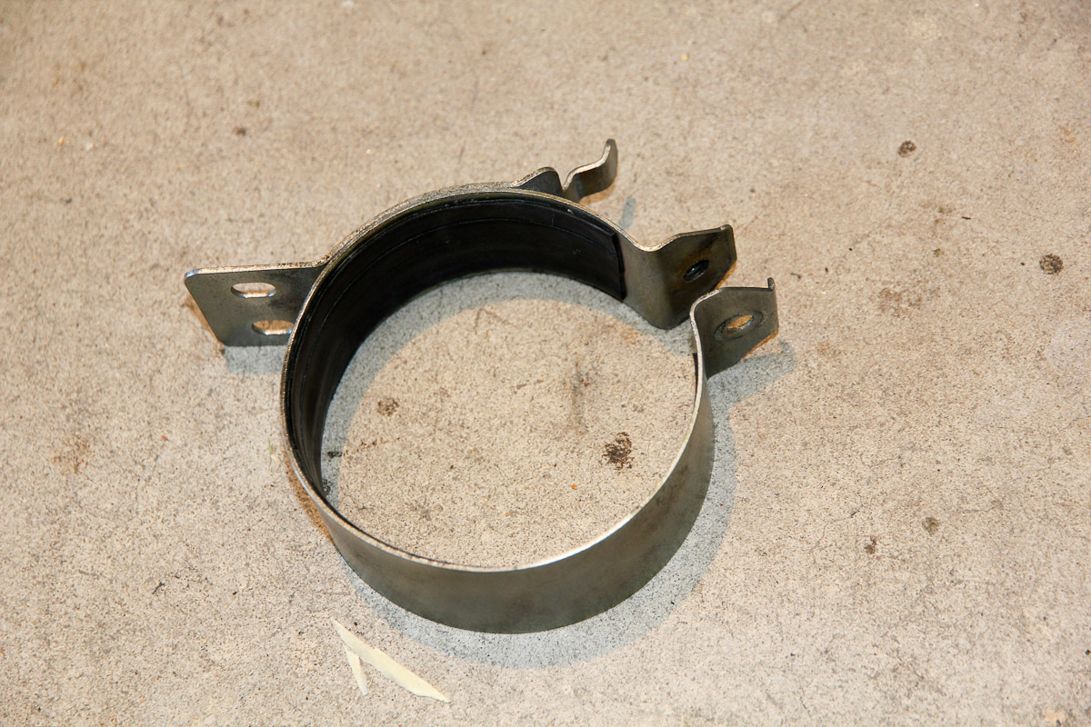

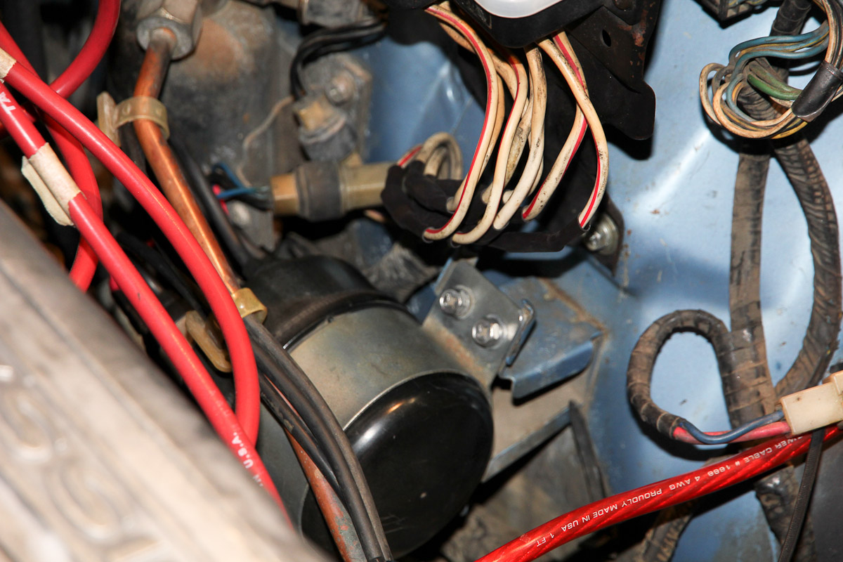

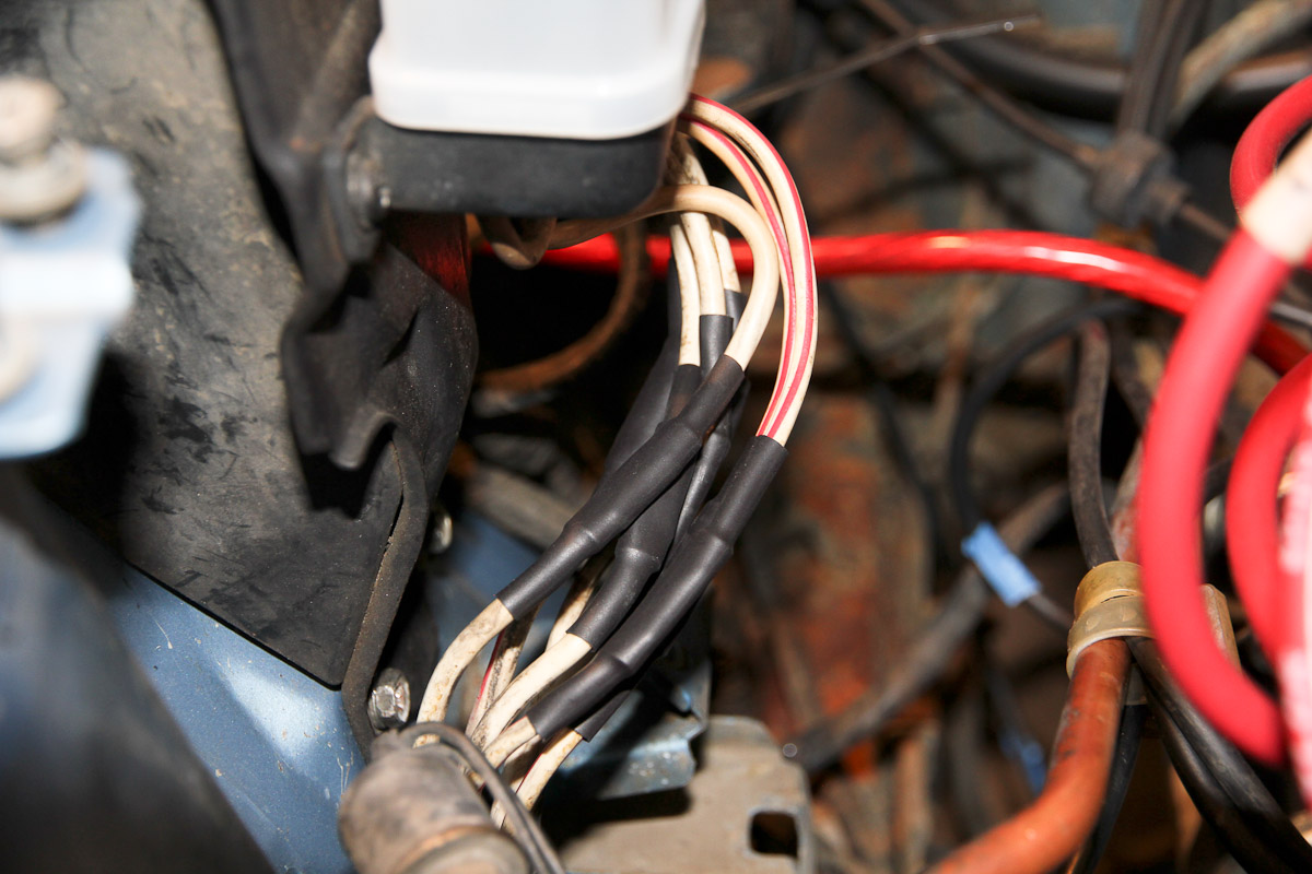

Fiberglass materials haven't arrived yet, and this weekend was shot with my kidlet's birthday party and the start of football season, so I only had time to deal with a minor diversion that I've had in the back of my mind for some time now: I finally swapped in the 280ZX vacuum tank.

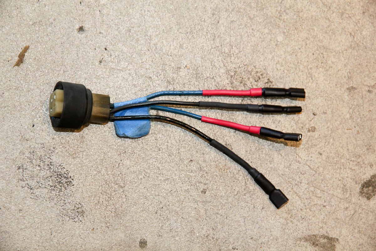

Well, first I dealt with the nasty fusible link wiring that I inherited.  General laziness -- as usual -- got the better of me and while futzing around with the vacuum tank, one of the hot wires arced across one of the poor butt splices, so I took them all out, spliced and heat shrunk them properly.  I may still replace all this one day, but at least one fire/electrocution hazard is reduced, and I got my helpful semi-annual reminder to just take the extra 10 seconds and disconnect the battery before futzing around with anything electrical.
Anyway, the tank swap.  I picked up a vacuum tank from a junkyard for about $7 several months ago and always though it would be worth swapping in since the stock one is big and ugly and the hoses are rather convoluted (and those solenoids up there on the shock tower...eww).  It was a surprisingly simple affair: I reused the stock bracket (just lined with some rubber from an old bicycle inner tube) and the harness didn't even need to be extended (just crimped on some disconnect terminals).  Everything works as it should, though it did lead me to discover that the FICD has a stopper nut that mine -- surprise! -- is missing, so I'm on the hunt for an M10x.75 nut.  If there's any interest, I can do a proper write-up on the process...I feel like I owe this community something :)

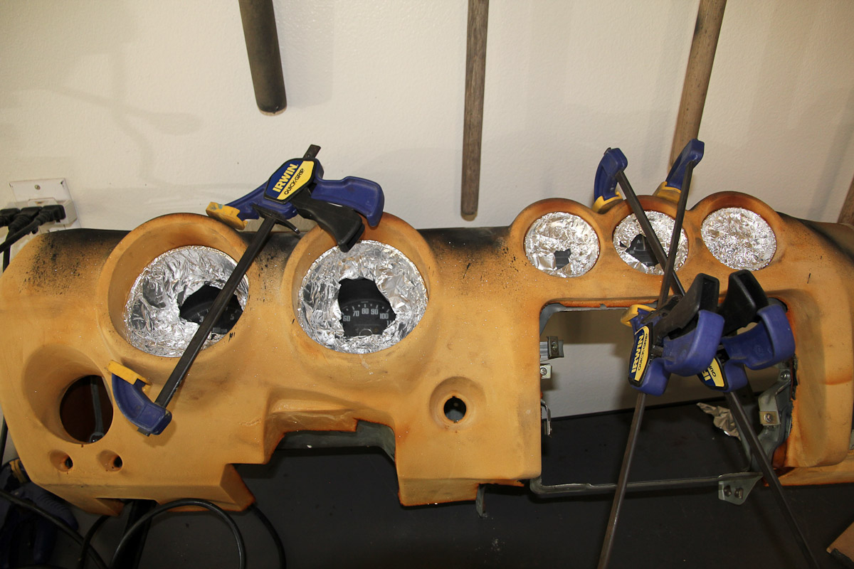

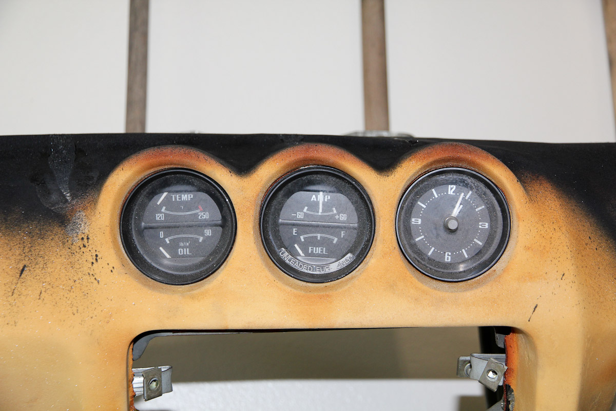

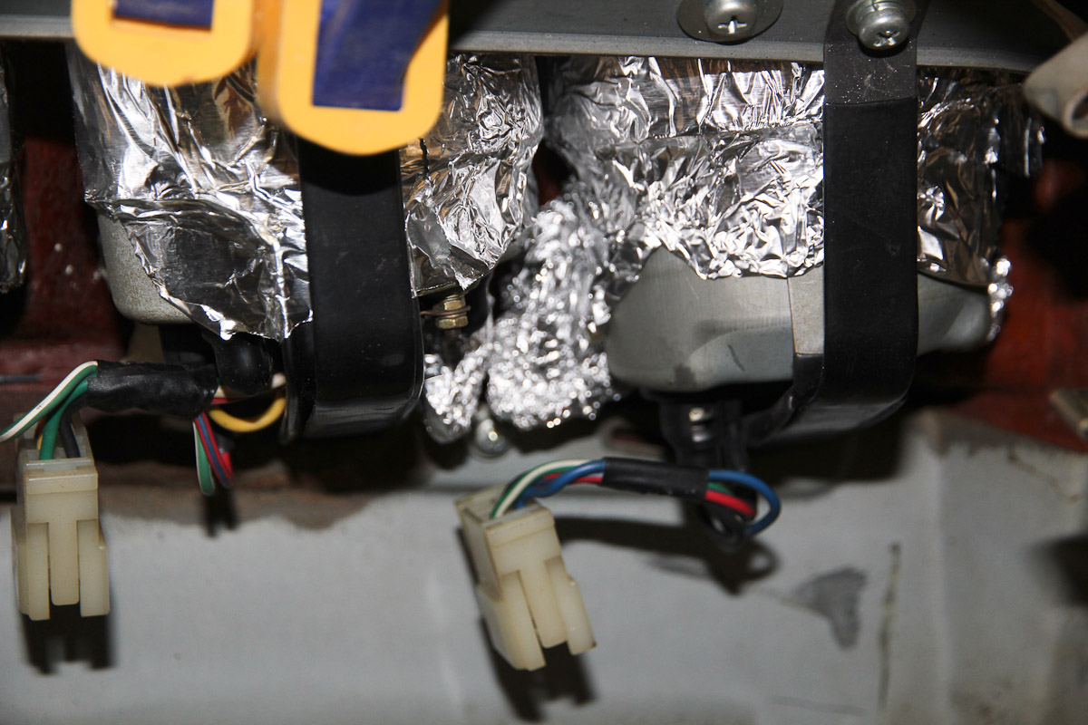

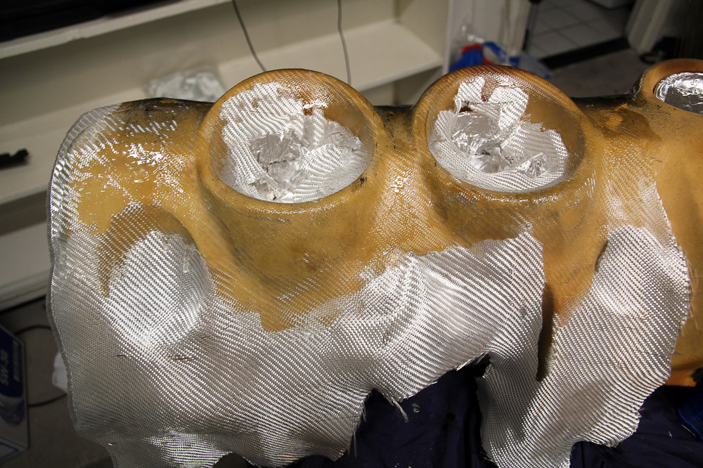

I did a bit of final shaping on the top of the dash and tried, with maybe a little success to get the gauge pods into just a little better shape.  The curved section behind the small gauges had collapsed a bit over the years so I stuffed some crumpled aluminum foil under it to push it back into shape.  Everything looks good, so here goes nothing!

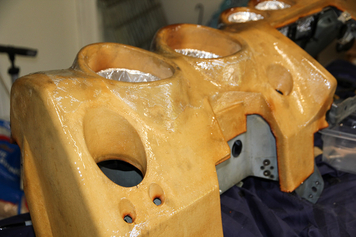

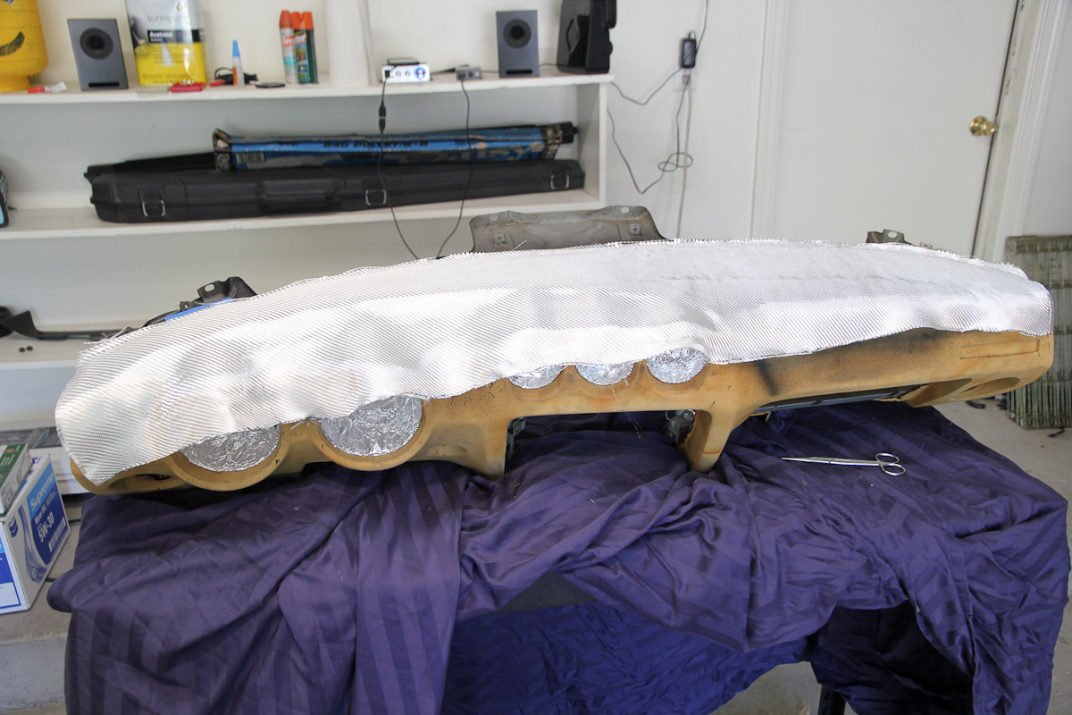

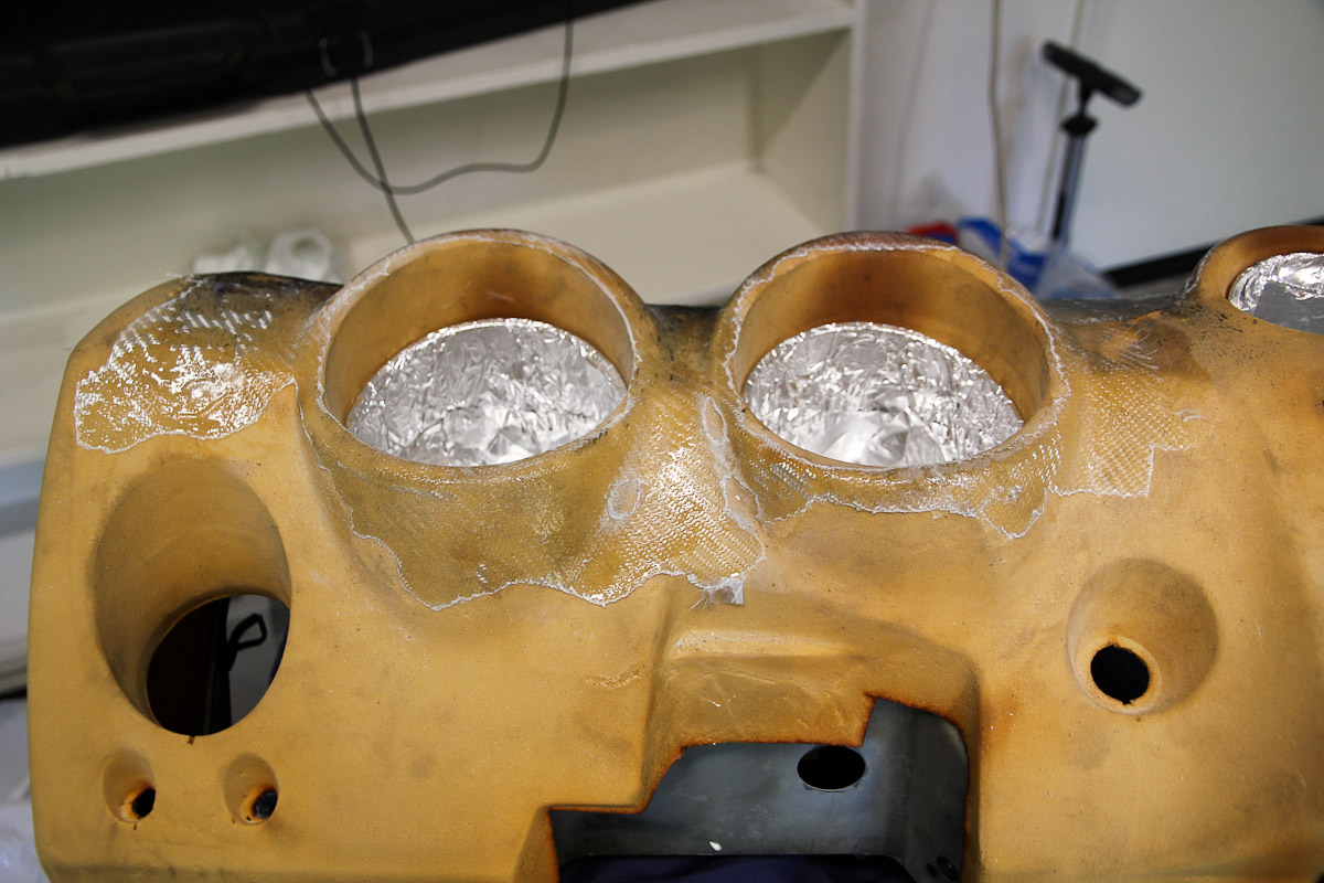

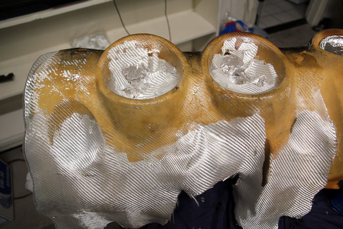

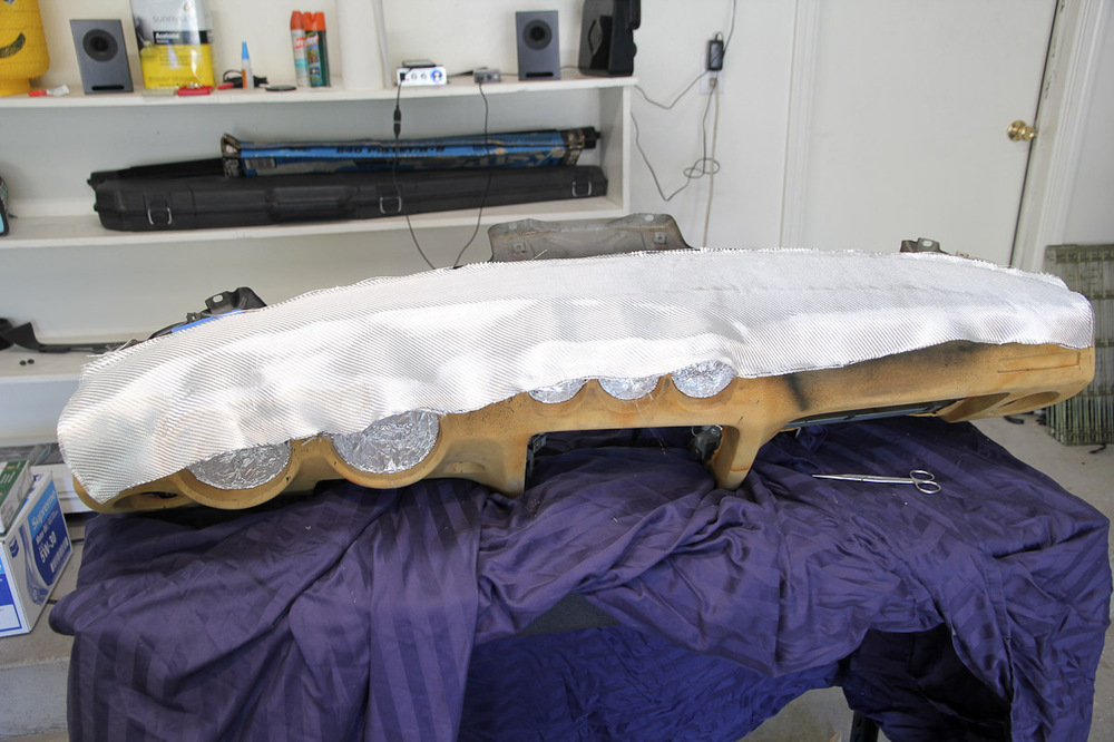

I exchanged some emails with the US Composites people and they didn't recommend epoxy resin for this project and suggested this stuff instead, which is usually used for surfboards.  Polyester resin eats polystyrene foam but is safe for urethane, and I did a test on a small part of the dash to confirm beforehand anyway.

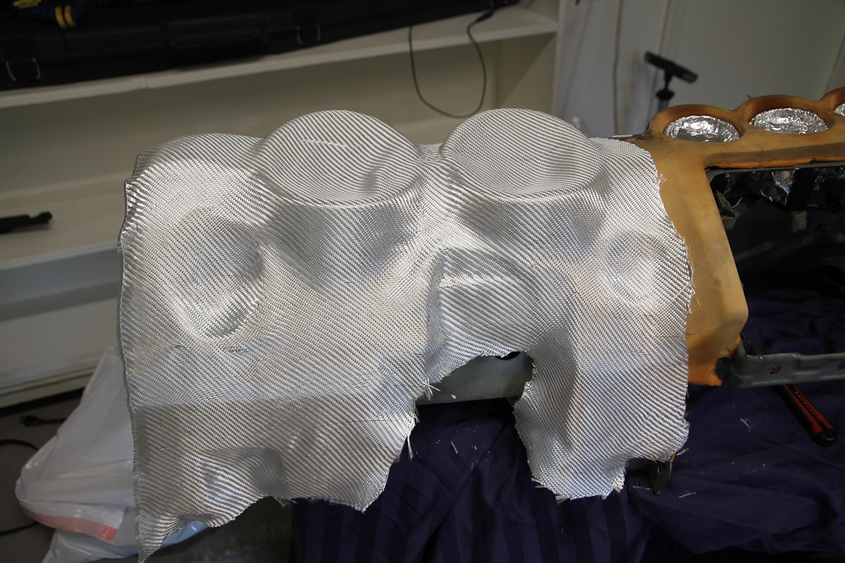

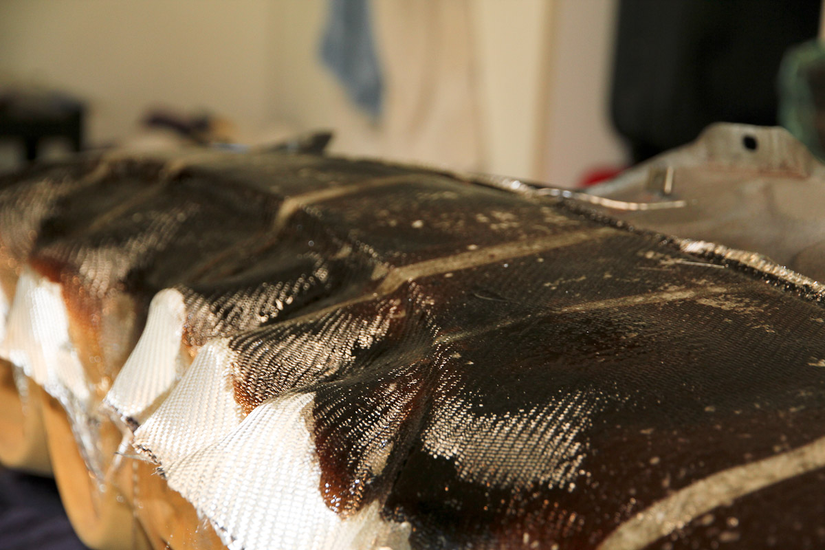

Started on the top for the first layer of glass, and things went sideways pretty early on.  Composites experts, feel free to snicker under your breath now :)  This resin's thicker than the stuff I've used before and the fiberglass cloth wets out much differently than chopped mat.  It also doesn't conform to complex curves as well as I thought it would, AND the resin didn't impregnate the foam anywhere near as much as I expected (basically it didn't).  Because of all that, I had a fair amount of glass that I had to cut or sand away, but lesson learned: smaller sections moving forward.
Well, lesson partly learned.  The curves on the gauges are a pain, the resin kicked early, and I didn't even get half of it covered.  More cutting and sanding.

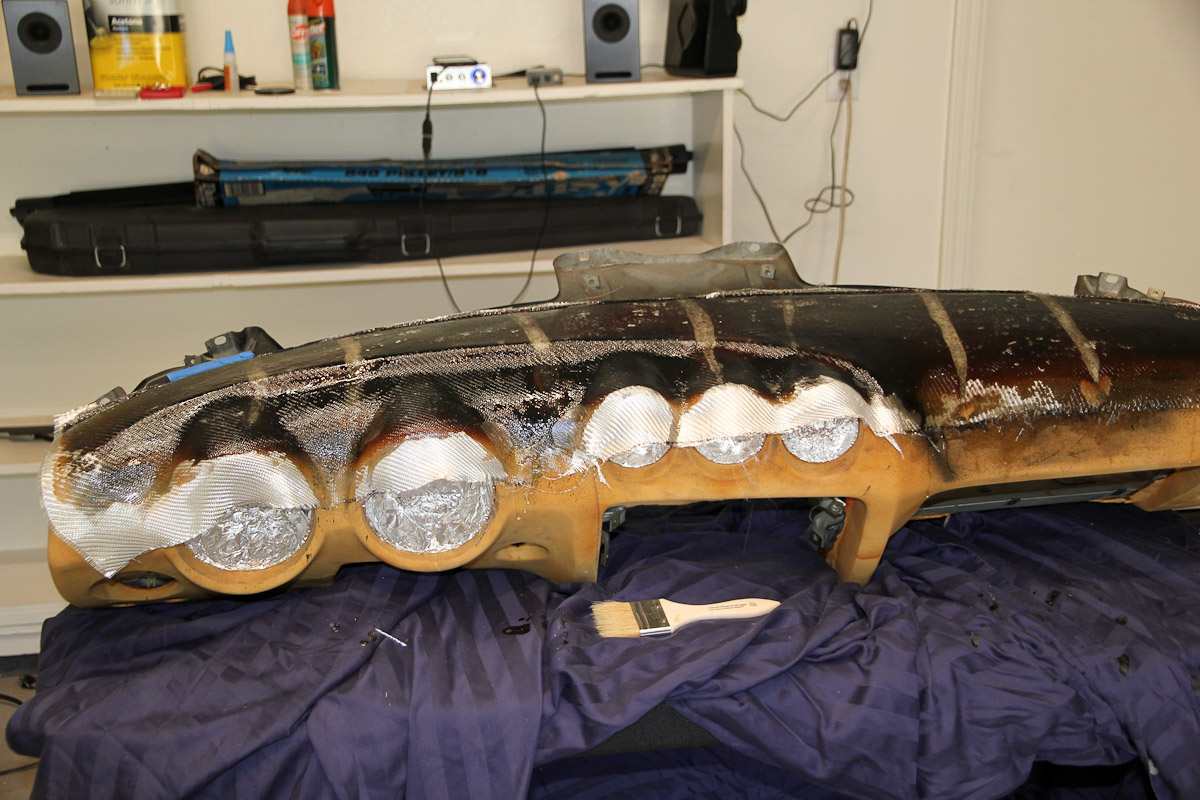

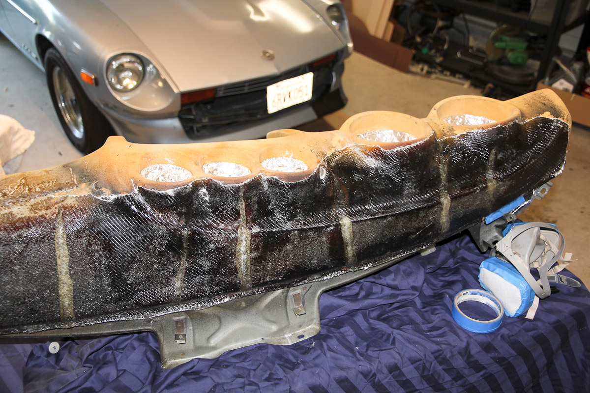

And now, a new plan!  I figure what I really want the glass and resin for (aside from structure on the top) is to provide a suitable substrate for whatever covering I ultimately decide to go with.  With that in mind, I brushed a coat of resin over the uncovered parts of the dash.  I'm going to go back over that with some small strips of cloth instead of large pieces and hope that works a little better.
So the whole thing isn't exactly going to plan yet.  On a scale of 1 to Fiasco, this is a currently rating at Minor Annoyance.  Nothing's irrevocably borked by any means, but it is a bit more work than I expected.
