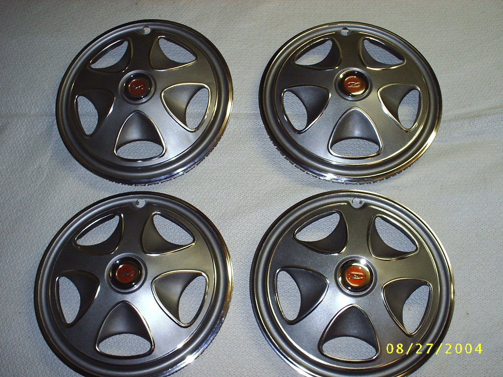

I used Dupli-Color WP 102 Graphite wheel paint. Got it at Advance Auto Parts for $5.00. It's REAL close and alot cheaper than $22 a can................Keith
Here's a picture of 4 hubcaps I restored for my 72 using WP 102 and a matte clear to tone down the sheen. I also did my grille as well.
