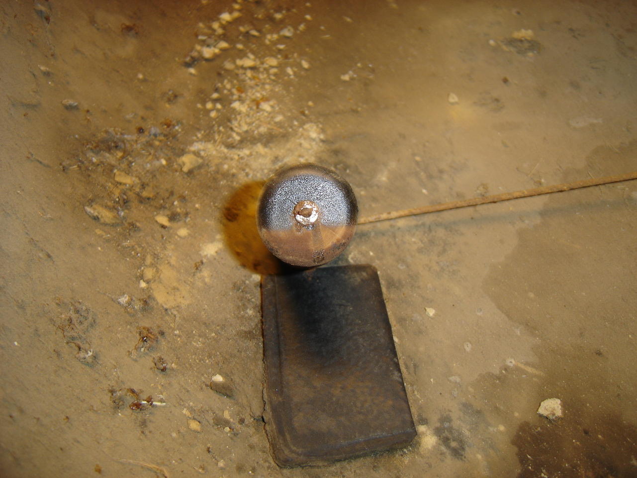

I think Madkaw is saying you can remove the fuel gauge sending unit in the tank and snap some pictures.
See the crud line on my old one.

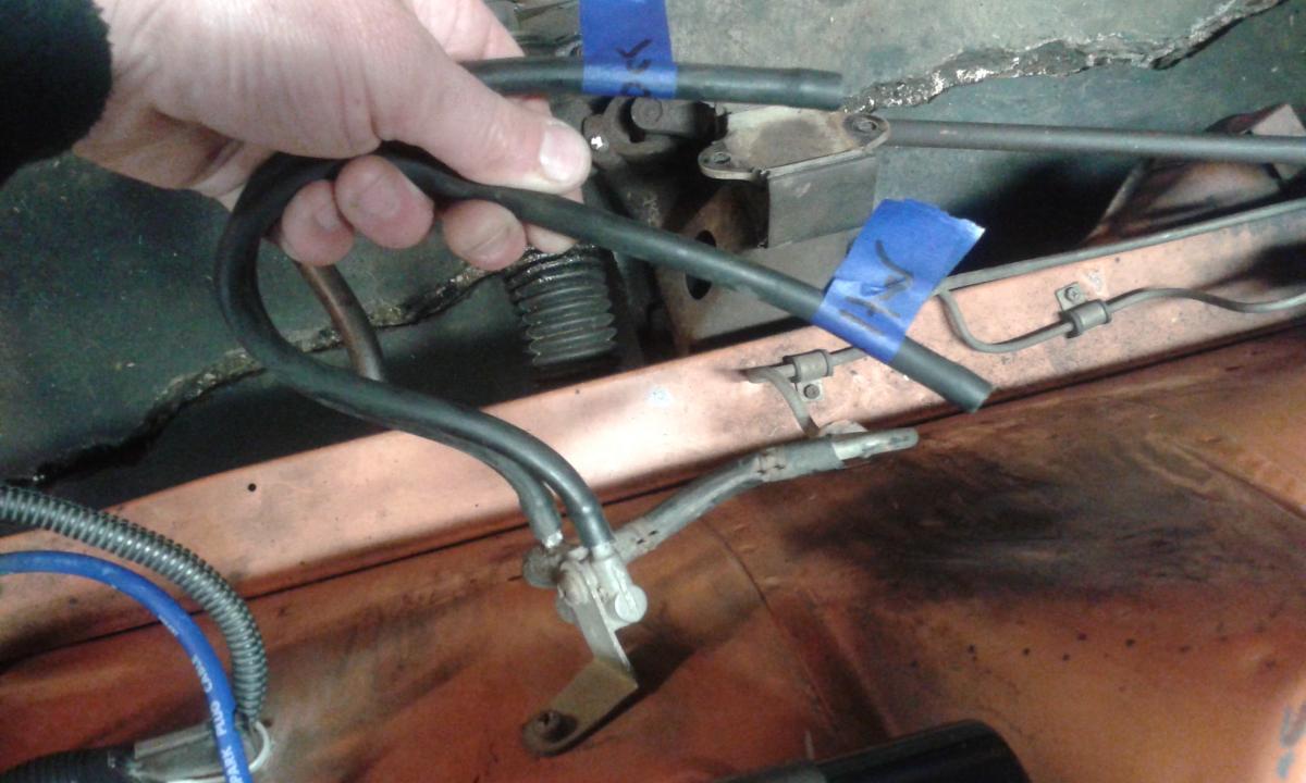

I messed up! The vent from the tank is the middle backside. One top hose goes to air filter housing, bottom hose goes to pcv tube. Sorry for the late EDIT
post-23570-0-82884300-1429308388_thumb.j
@siteunseen  no problemo  I'm going to post some engine bay shots, as this girls is wearing mostly new hoses and all new fuel and brake lines.  As I said engine & carbs were rebuilt 5k ago.  So, lines to tank from filter blown out and A OK.  Fuel filter crystal clear.  So I figure, what the heck start her up.  She has always been tough to get out of bed in the morning.  Usually takes lots of choke and manual foot to idle to get her to warm up and then she's perfect.  (no don't there re girlfriends).  So today, after emptying tank and lines to filter, I touch the key and she fires right up. Choke off, idles perfectly with no help from me and warms right up.  Then she does what she does best, and runs perfectly.  I mean, screaming fine, accelerating, no stumble, I mean purrfect.  So I let her sit and idle for 20 minutes.  Still perfect.  Engine temps normal.  So I bring out the voltmeter, the good Fluke.  I notice the coil is very hot and the dropping resistor too hot to touch.  Measurements as follows @ 750 rpm;  into resistor 13.3v   out of resistor 10.3v  into coil 9.53v  out of coil 6.56v  So, in lieu of getting fuel pressure gauge, I'm going to put in an coil once I verify its a 1 ohm coil.  Somebody correct me here if I'm wrong.  I know the 3 ohm Flamethrowers are a no go with the resistor.  I think madkaw might have put me back to electrical.  My schematics don't show the cap value coming from the coil to the chassis or maybe I'm missing it.  That could also be an issue.  So, until I can measure fuel pressures, I'm playing with electrical.  BTW, my fuel pump, looks in no way like the replacements they sell.  @siteunseen thanks agin for the pics, I checked my hoses and all good.  Andy
