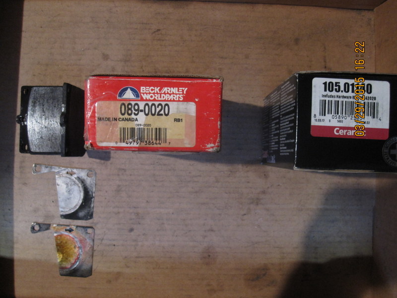

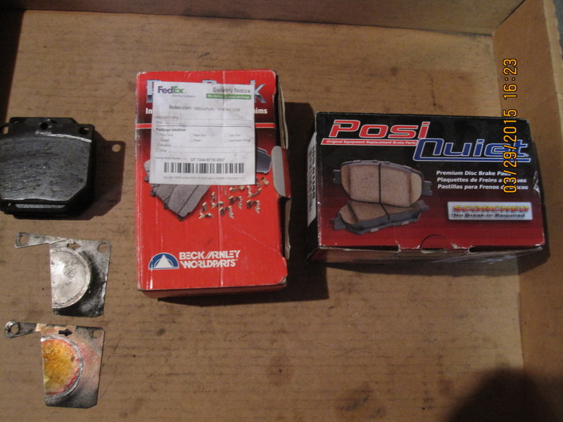

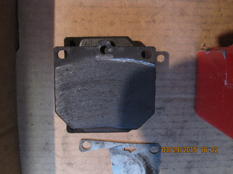

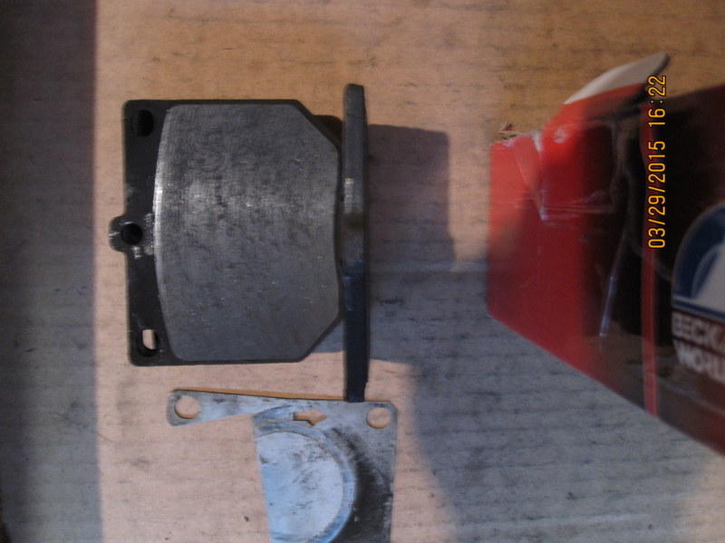

I've had this nagging thought that I should check the wear on my front brake pads but haven't done it.  Recently I started hearing a mild crunchy noise while braking, especially at low speed.  I tried braking with just the parking brake and no noise so took a wheel off.  And decided it was time to install my new Posi Quiet ceramic pads.  See pictures.
The Posi Quiets have their own, already glued on, shims and are not supposed to need more.  So I left the factory shims off and haven't heard a peep except for a touch of squeal when braking in reverse.  But the stock shims did that too.
So if you have squeal and can't get the factory shims, these pads seem to do the job.  Everything needed is in the box, pads, pins, cotter pins, and anti-rattle hardware, and the shims are already attached to the pads.  The Beck Arnleys did work great with the factory shims but squealed badly with the shims they came with.  I got maximum usage from them.
